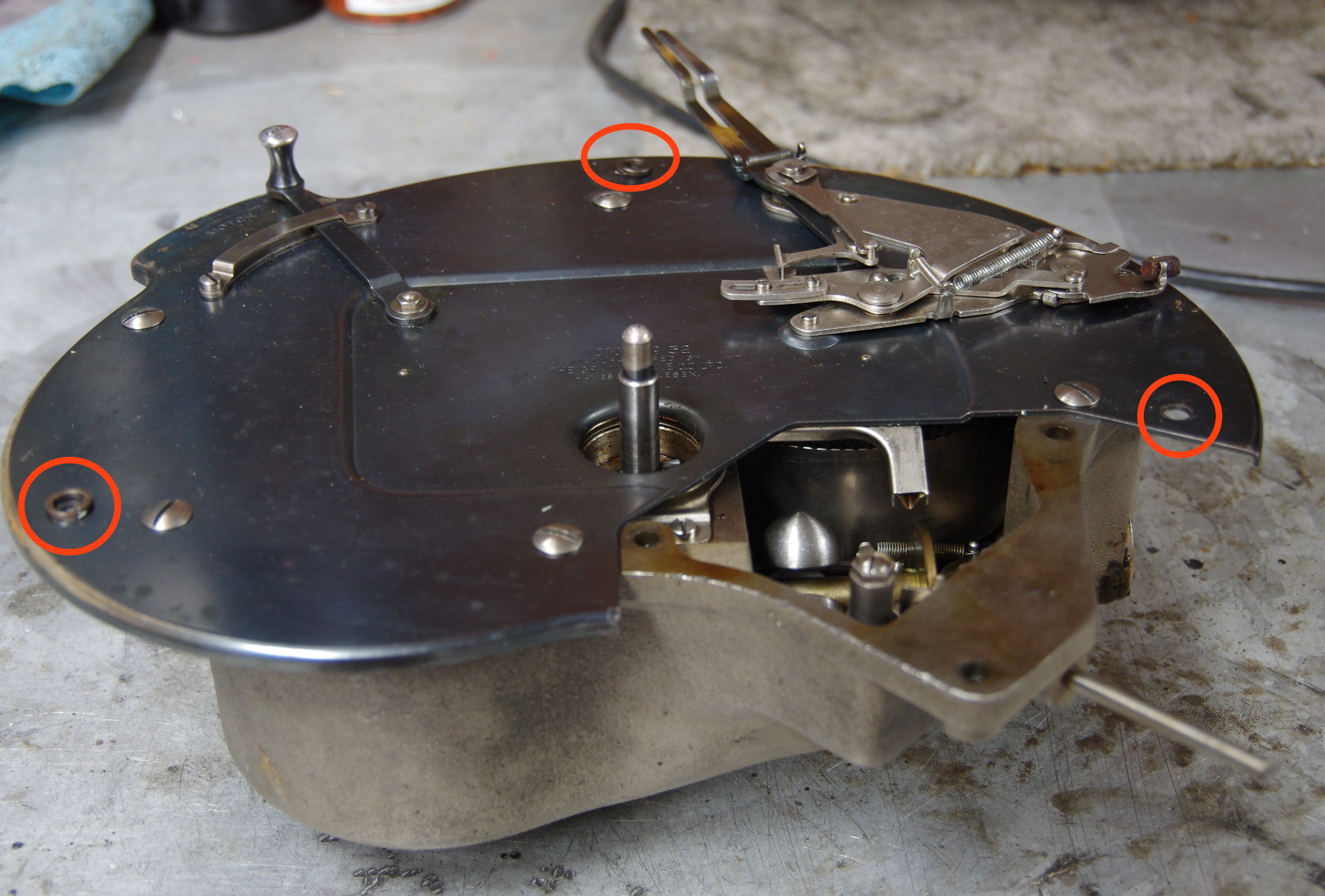

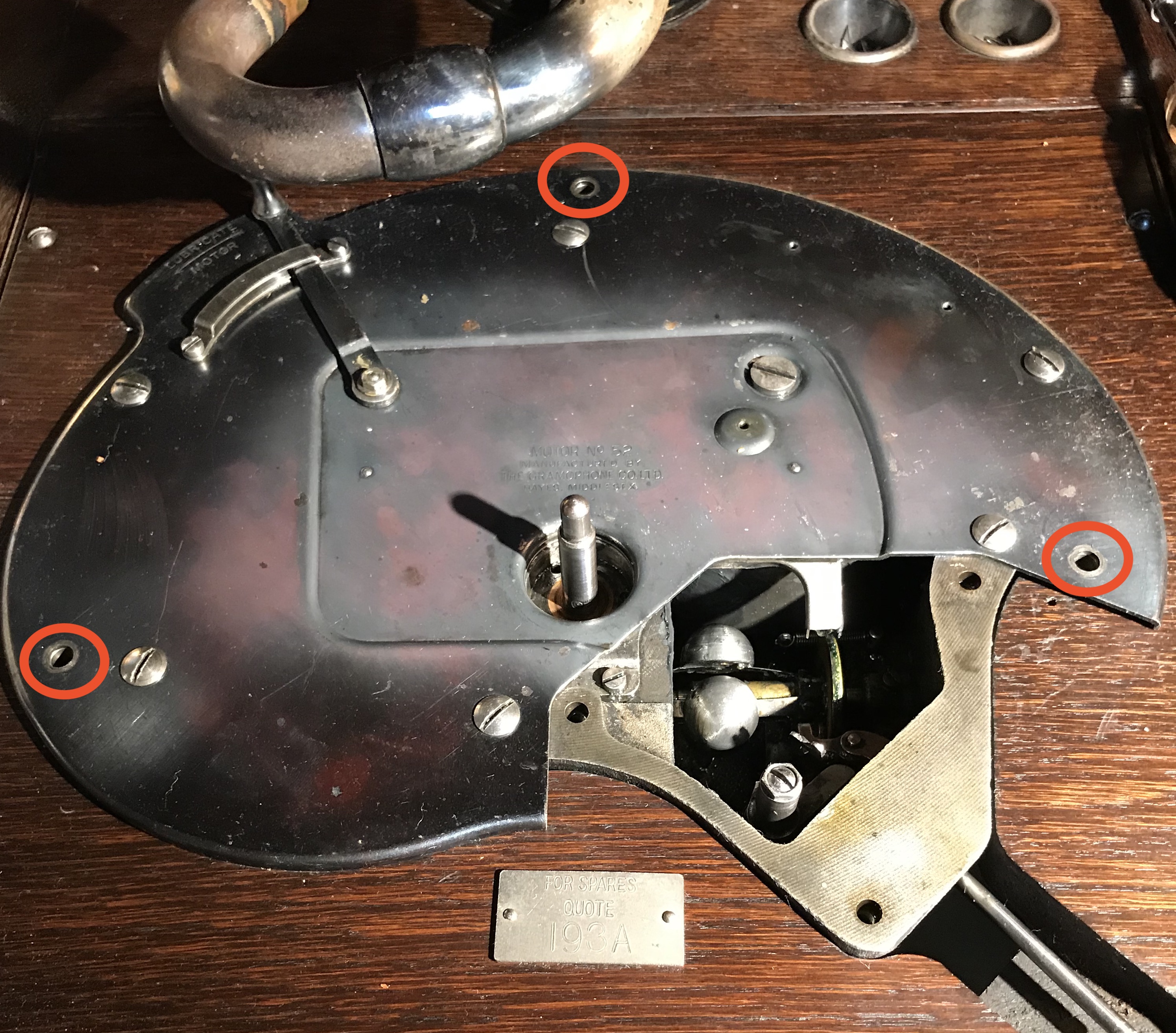

Re: Help! Removing Oil Bath Motor from 193
Garret,
Here are two images that should help. The motor hangs from the top plate which rests on the motorboard. I remove my motor by removing the top plate's three retaining screws as well as the speed control plate and mechanism.
The motor is heavy and I slightly raise each side and then slip large zip-ties under the plate and up through the vacant retaining screw holes. I then thread the zip-tie through it's latch, leaving three large loops that can be easily held and which easily lift the motor/plate assembly out of the motor board.
I've replaced springs and serviced the oil pump in mine, so if you would like other images, send me a PM and I will forward them to you.
Robert
Robert
Robert,
Thank you so much for these clear images.
The machine isn't mine, but belongs to a collector in Singapore that is having a terrible time with it.
Garret
Garret

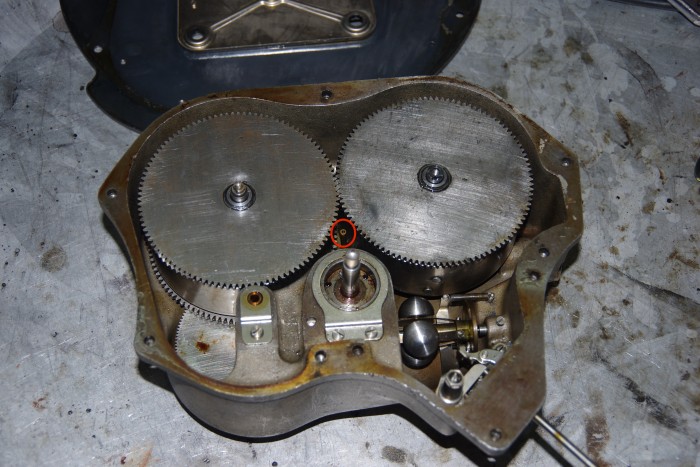

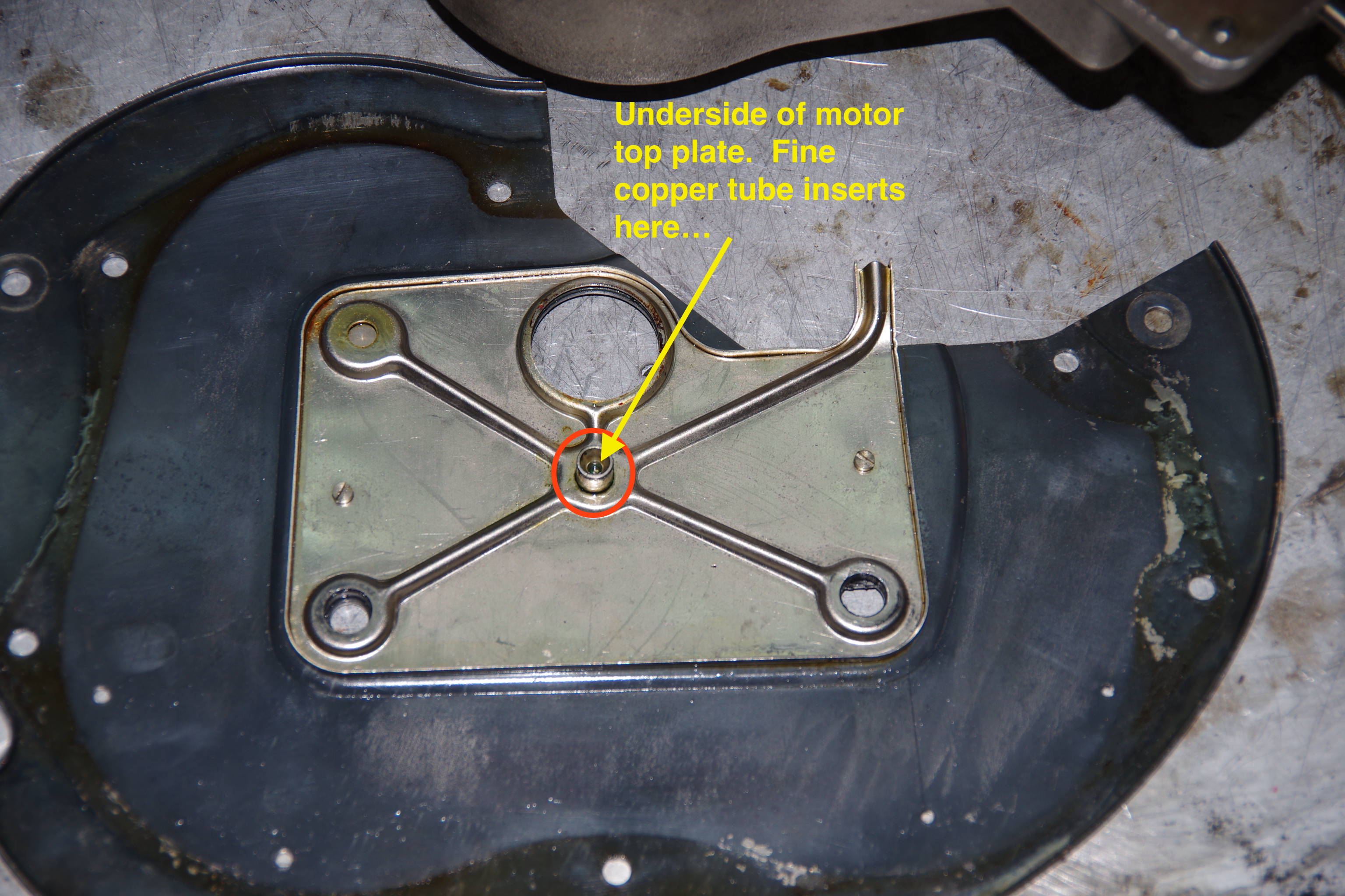

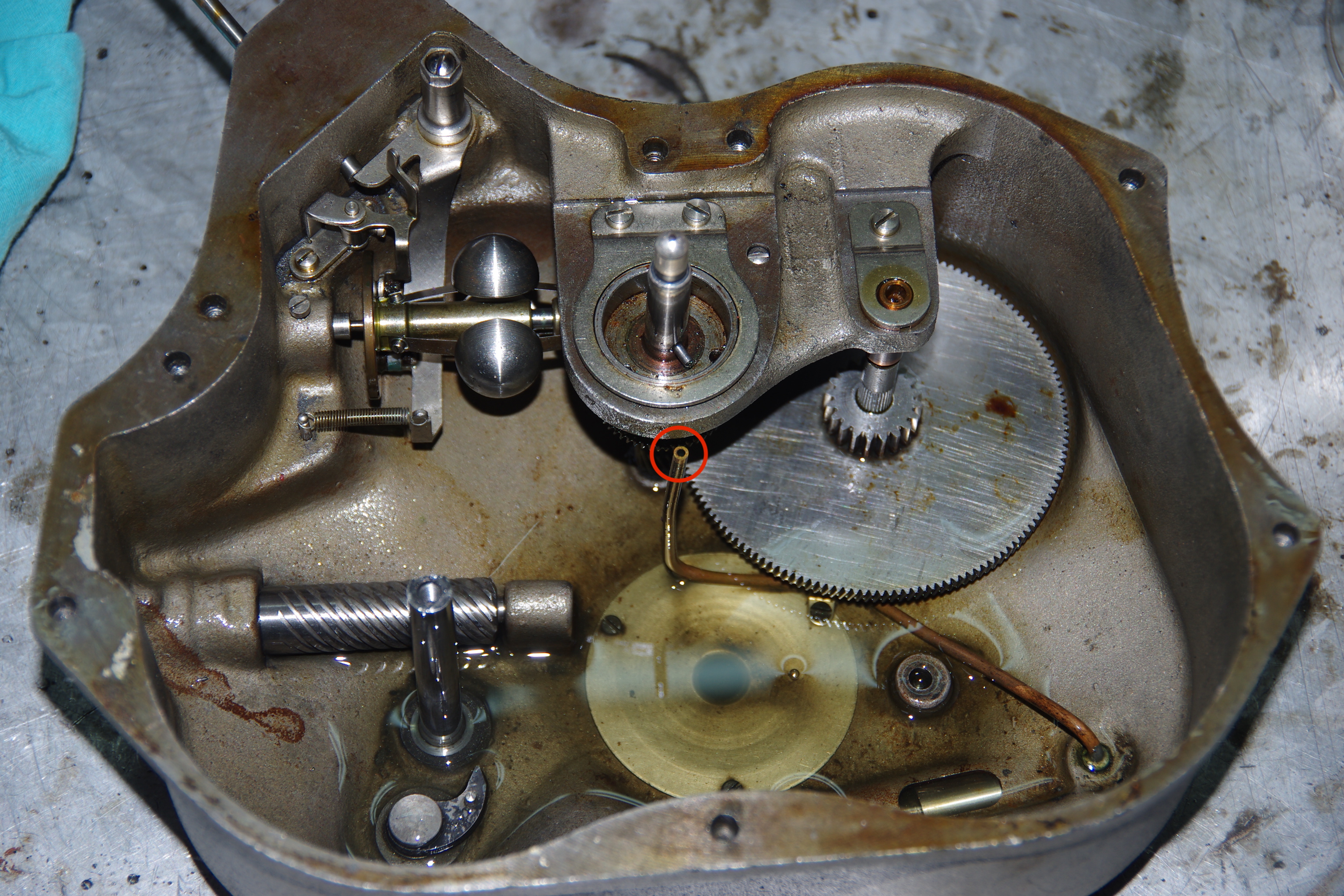

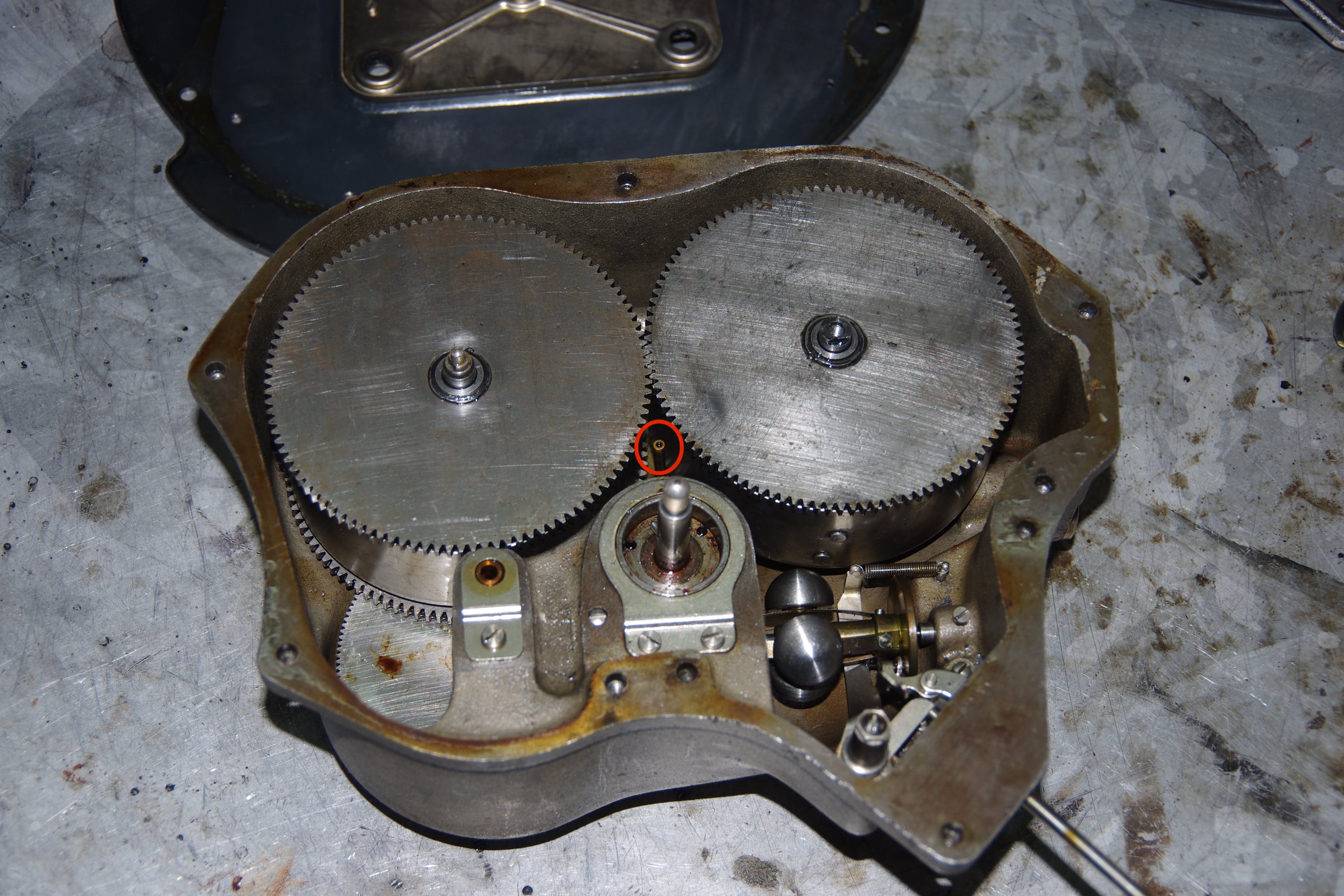

When replacing the top of the motor (lid) be sure to take care to not damage the tiny upright oil lubricating tube which also has to be lined up with the corresponding hole in the top. It's not particularly easy and took me a while to figure it out. You have to almost have the top in place before you can judge the distance by eye, by which time its difficult to see anything as it gets dark quickly!
HMVDevotee
- Posts: 175
- Joined: Thu Aug 15, 2019 1:26 pm
- Personal Text: Spin'em Fast!
- Location: Western North Carolina
Steve makes a good point! Here is what he is talking about:
