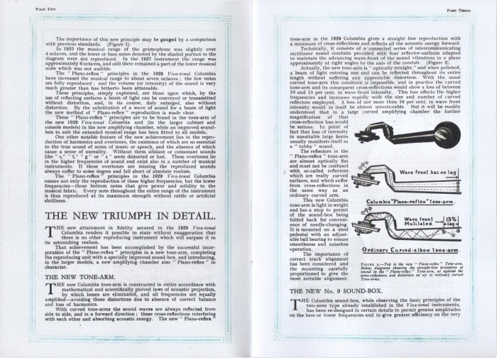

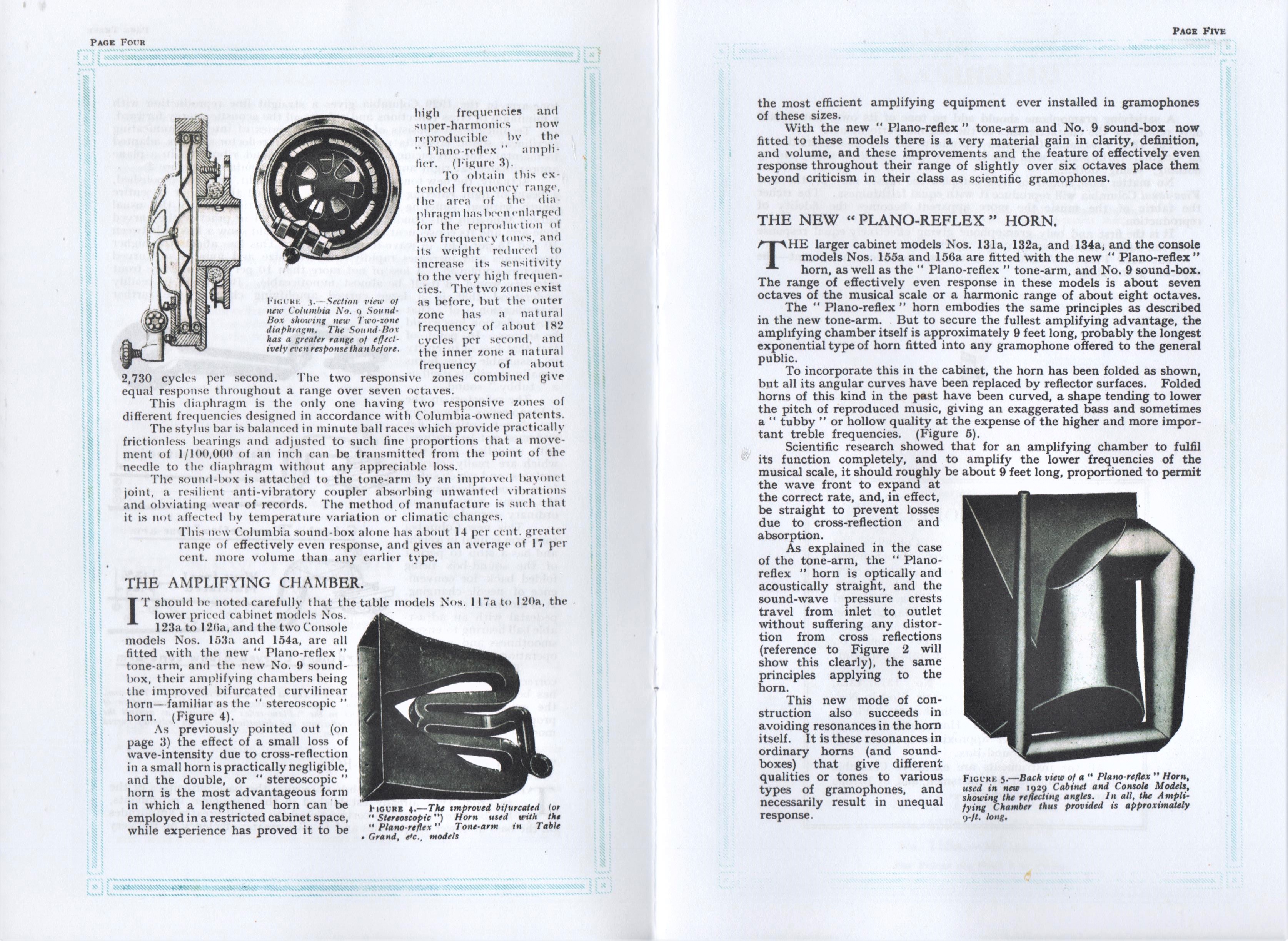

The "a" suffix on both models denotes the introduction of the Plano-Reflex system in 1928/29, shown in these catalogue images.

Thanks for the information about the Plano reflex arms and horns. I had taken them to be somewhat of a gimmick, but maybe there is something to the design?
What is the source of that document? I’d be interested to read more.
Thanks!
Thanks!

Columbia never had a horn that even slightly resembled a Re-entrant horn.
They were only ever used in Victor/HMV machines.
IMO, Columbia horns were pretty much a gimmick, just like their Plano-reflex arms.
I think any sound improvement over other lesser models probably has more to do with increased overall horn length rather than any actual scientific design principles.
