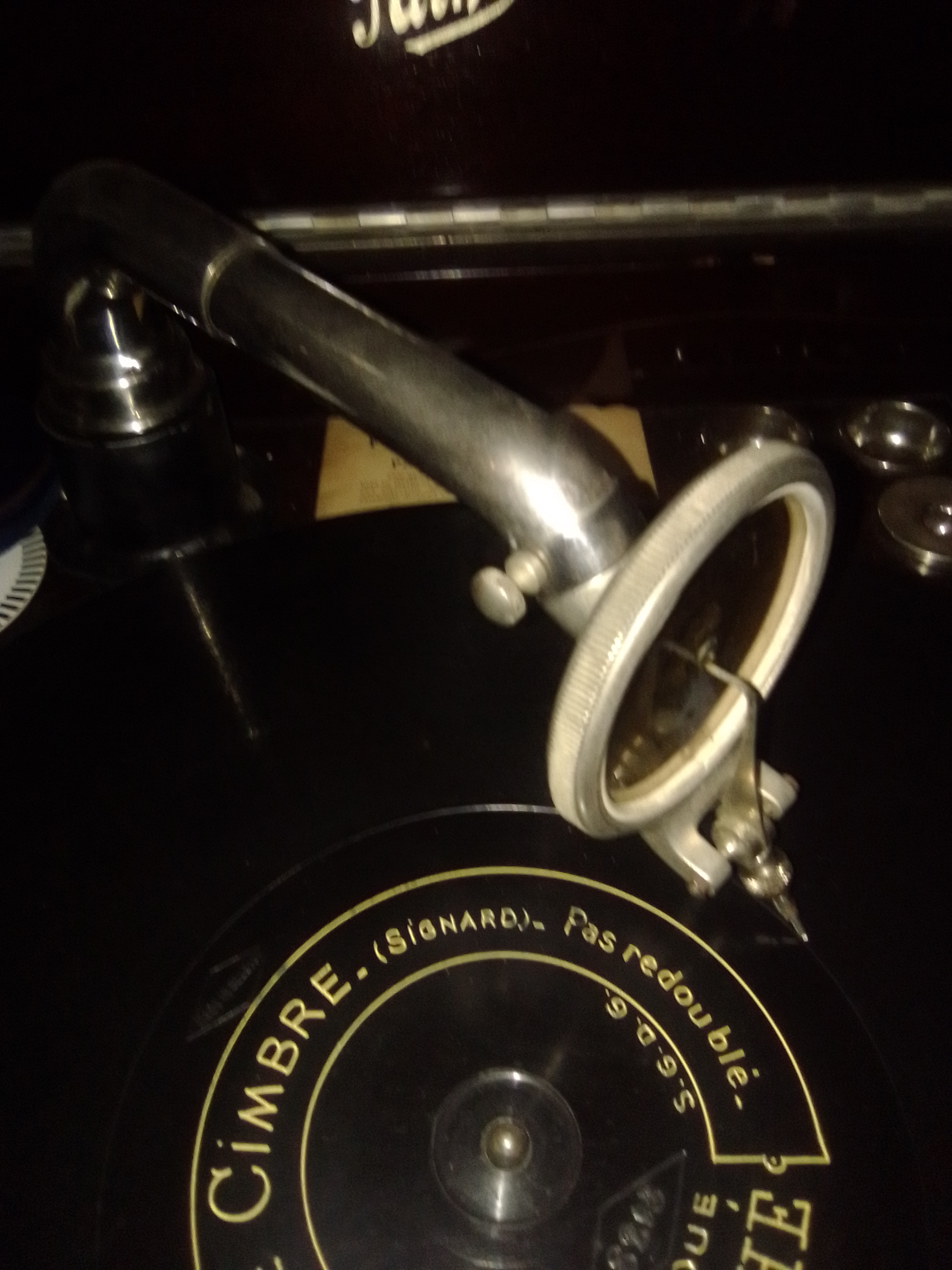

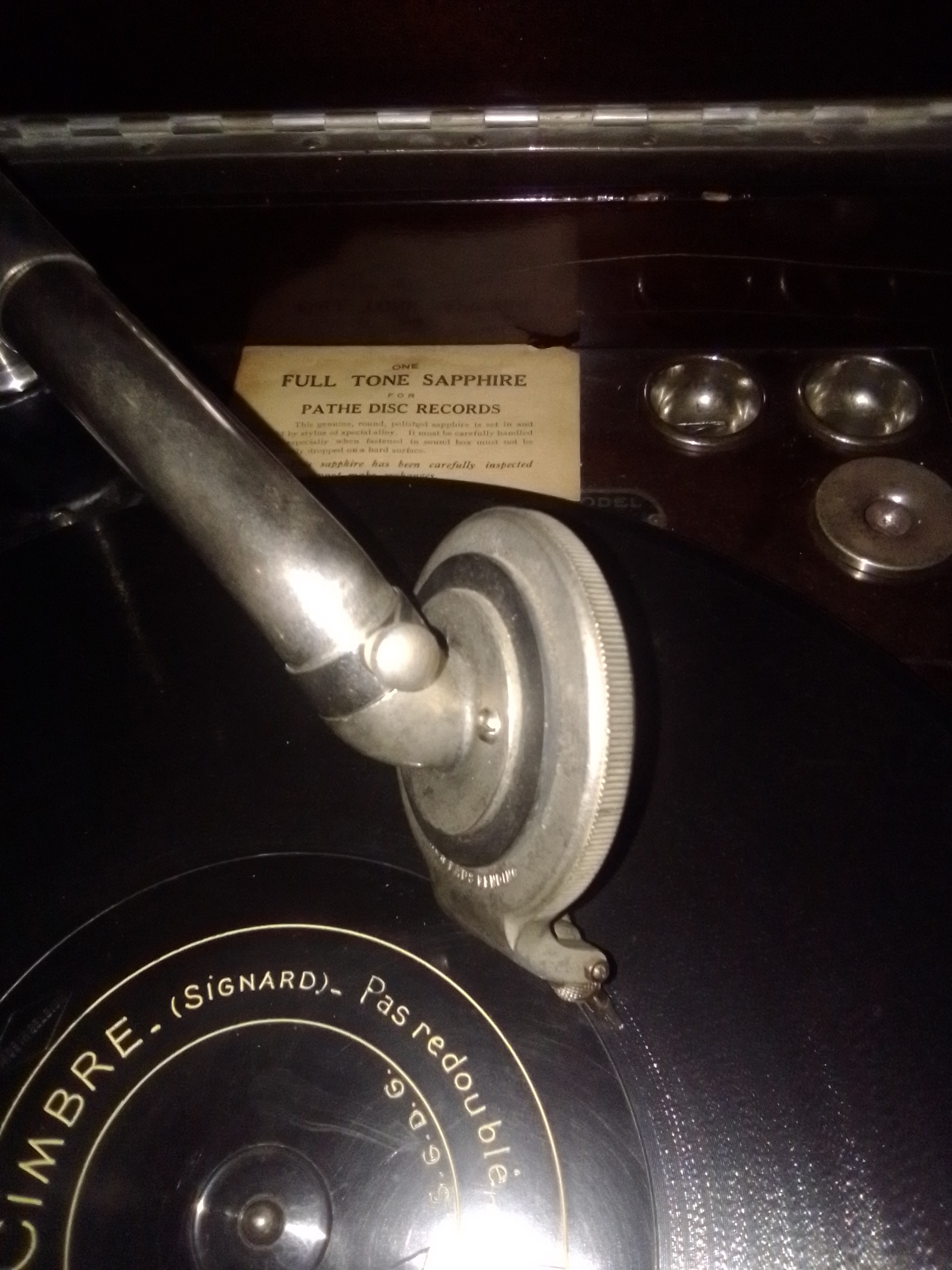

If your friends X is like mine, it'll have a thumb screw on the tonearm near the soundbox as pictured below.
Just be careful turning the soundbox because these American tonearms have pot metal components that can break if you use too much pressure turning it.
I grip the main straight section of the tonearm before turning the soundbox otherwise the whole arm will twist and can easily be damaged.
I'd also recommend using some penetrating oil or WD40 on the joint before attempting to turn it because it may not have been rotated for a very long time, if at all.
You may even want to remove the tonearm from the motor board and remove the soundbox to turn it the first time, so the base isn't anchored down and you can make sure the small section of the tonearm rotates freely.
Be sure to tighten the thumb screw again once it's in the position you need.
Loosen off the thumb screw, and you should be able to turn the soundbox and short section of the tonearm clockwise as far as it goes until it's positioned as pictured below.
The angle the soundbox sits at looks a little weird, but in that position the needle and needle bar are lined up in the correct position to play lateral cut discs.Just be careful turning the soundbox because these American tonearms have pot metal components that can break if you use too much pressure turning it.
