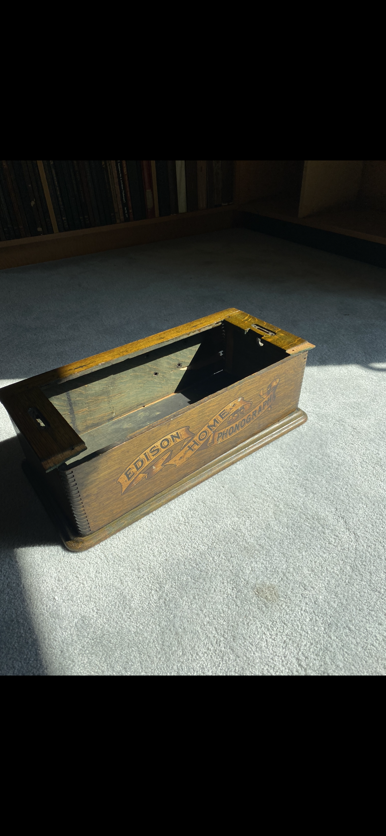

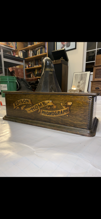

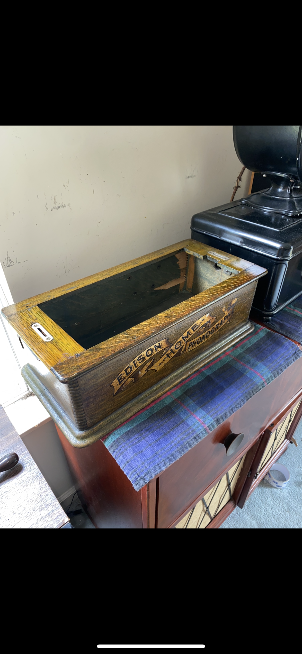

I bought the edison cabinet parts from Brad a few weeks ago and started messing around with them this week. I started with the nice banner decal board because I wanted to see if I could restore the finish on it and use it as a display. The finish came right back to life and looked amazing. So I tried the two sides, the back, and the baseboard and everything came out really well. (Also shout out to VanEpsFan1914 for messing around with this last night for me).
So here is the cabinet for my new project. If anyone here has a correct motor, motor board, carriage, cygnet bracket, and the other misc parts; please send me a PM. (I do have a carriage for this machine). I am not ready to purchase them now... but I will be in the near future.

That was a lot of fun to work on. I like the light you put over the work-bench; that really highlighted just how green the dye was under the finish. That almost looks like the thick layer of waxy grime on it might have been protecting the finish.
The alcohol treatment to re-amalgamate the stuff was pretty great. I was thinking we'd end up having to mix a light coat of shellac for it but everything seemed pretty good under all the dirt & mess. And I don't often go visit friends, but when I do, I enjoy visits that end up with everyone out in the barn at midnight pulling 120 years of dirt out of a piece of wood and putting stuff together.
I suspect your machine is a Model A Home. I worked on a 1904 Home A that looked like it had come out of a time mchine and needed very little to put back in service for recording and playing back 2-minute cylinders. The nice thing is, you'll have an external speed control; the not-so-great thing is that there's a complete Home bedplate on eBay right now with 2/4 gearing--and it is the Model B. The top frame on yours is the big one that'll need to fit the long iron frame of the old type Model A bedplate. I would have suggested putting an early B mechanism in it if there were Home B's with the bottom of an A case fitted, but that's not something I'm sure would be authentic-looking. A lot of work to show off that great banner decal but it should be worth it. Will be looking around to see if a bed plate comes up. Unfortunately I don't have one; my bedplate is for my own Model B Home which will be completed when I get back up to it and pull all the nickel off and take it to the plater's.
Since your backboard is drilled for a cygnet horn I wonder if the original bedplate ever got altered to fit the combination gearing.
Love the pictures you took of it; no one would guess what it looked like when you started!

I have been offered a nice bedplate and upper casting to complete the project. It is geared for 2 min only records.. and I think I will leave it like that. I don't have a 2 min only machine, so it might be nice to have one devoted to strictly 2 min records. I will be making a decision and purchasing parts as soon as monday. I found a replacement frame... so hopefully I can match the new piece to the green on this cabinet. Should be a fun little challenge

A two-minute machine set up with that 10-panel should be ideal. Wax cylinders, especially those good band recordings, deserve a nice loud horn. I personally would put a Model B reproducer on it, since you have those softer black wax Columbia cylinders, and they can't be played on the BKT Graphophone with the Lyric.
The upper casting for a Model A should again have that external speed knob which should make playing the Columbias a lot easier. Meanwhile I still have to decide what to build around that Searchlight horn, once I get the rust off and put some paint on. (It'd be nice to refinish that in the original style with the tulip petal motif inside the bell; I am also tempted to go with the exterior in a copy, using less toxic materials, of that wonderful old "Paris green" finish that was so popular back in the old days. Besides I like the color green.)
I do not know if any of the modern upgrade type diaphragms will give better performance in the Model B reproducers. Thin mica or glass might be pretty interesting, though.

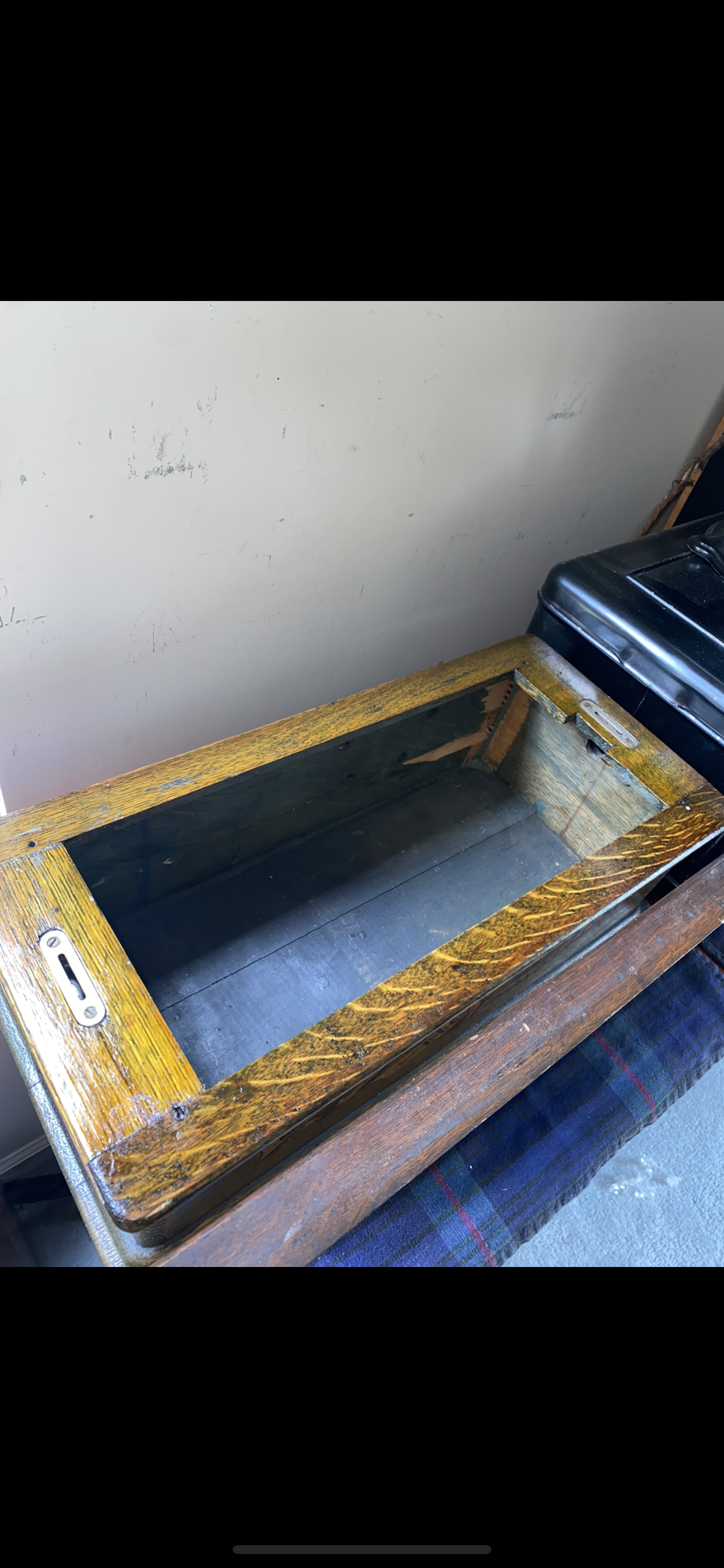

Received the missing piece of the frame earlier this week and had some time to day to refinish it to match the rest of the frame. I think I got it pretty close!

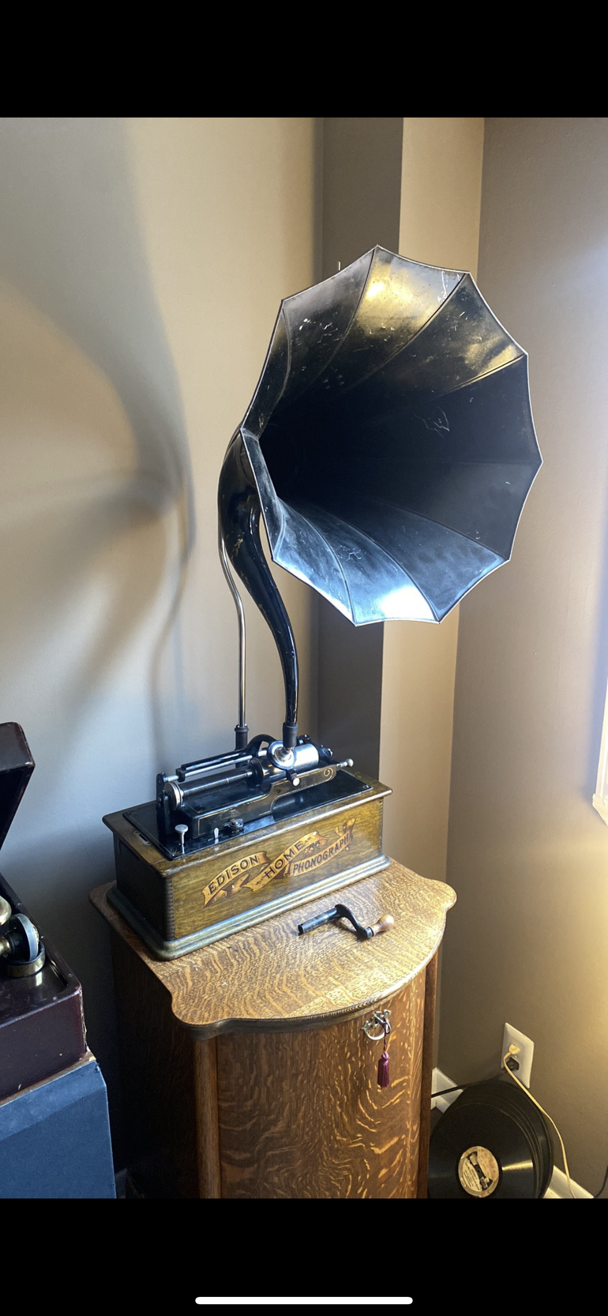

Through Brian P and a fellow forum member I got almost all the parts I need to complete this Edison home! Just thought I’d share a photo.
David

Hey David-- That looks great--- You did a great job pulling together all the parts you needed..... and it all started with me cleaning some case parts off my shelf

David, you may be proud of it ... It looks magnific...!

Thanks Inigo, I am really happy with it. I always wanted a green oak Edison Home but didn't imagine this would be the way I would end up with one

Well I finally got all the parts together and it’s runnin great!
Here’s a video: https://youtu.be/tFIdWkN93V8
