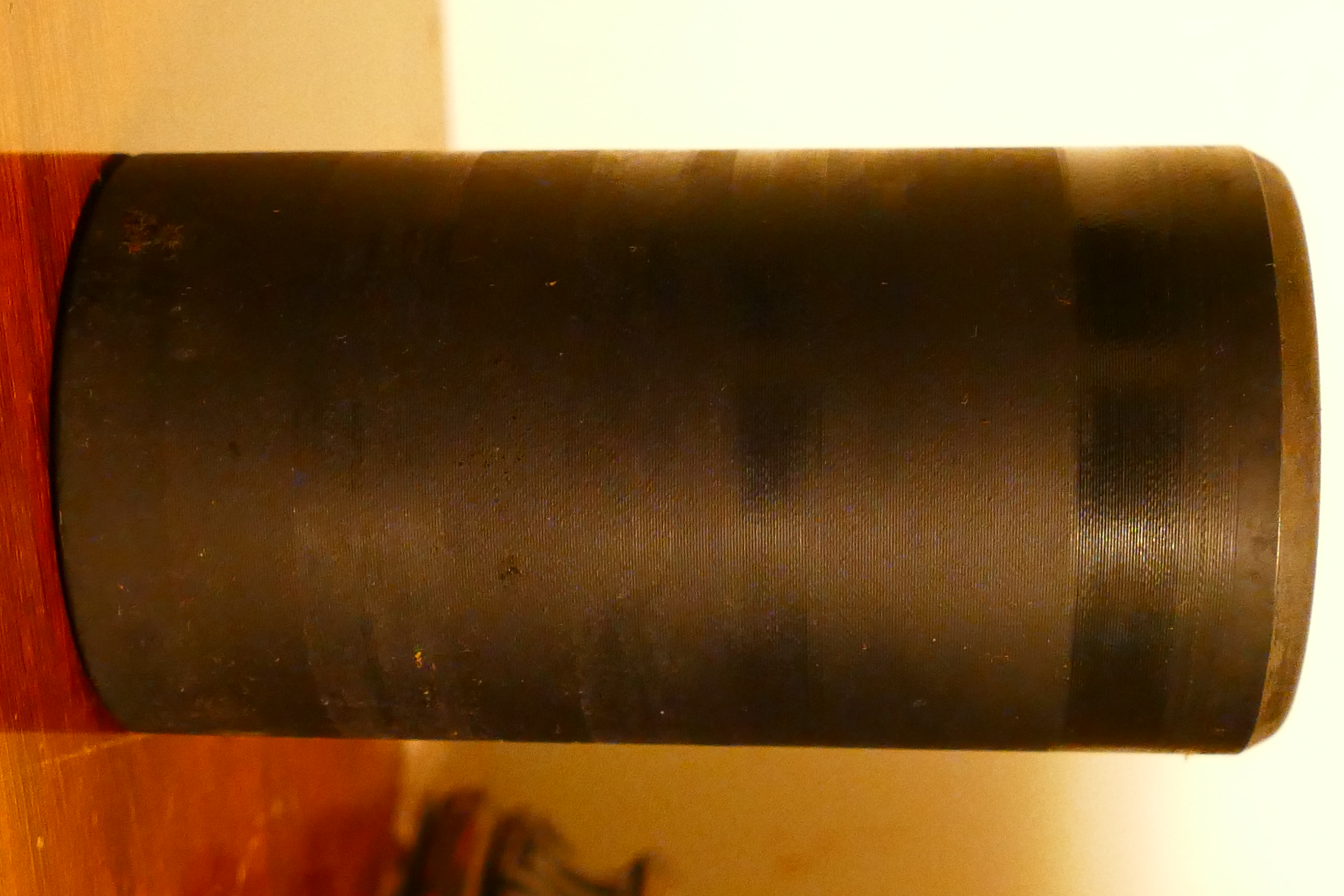

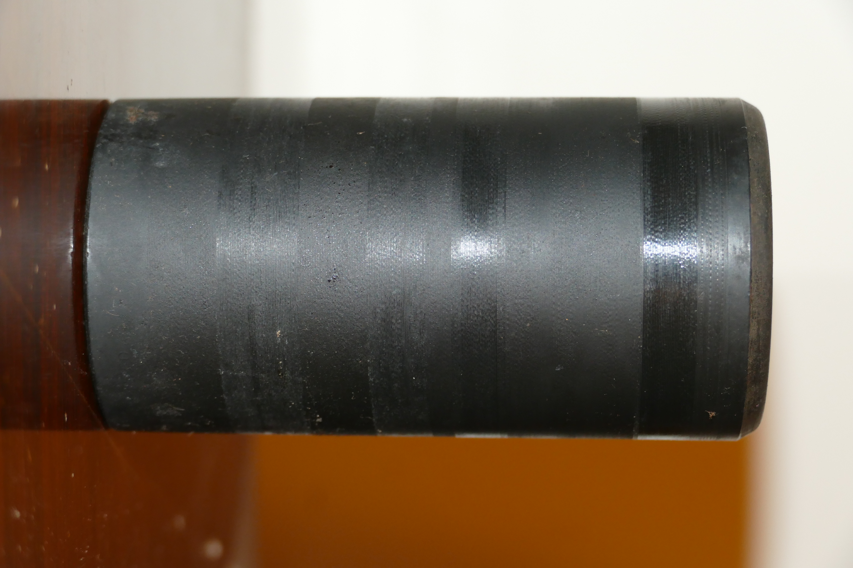

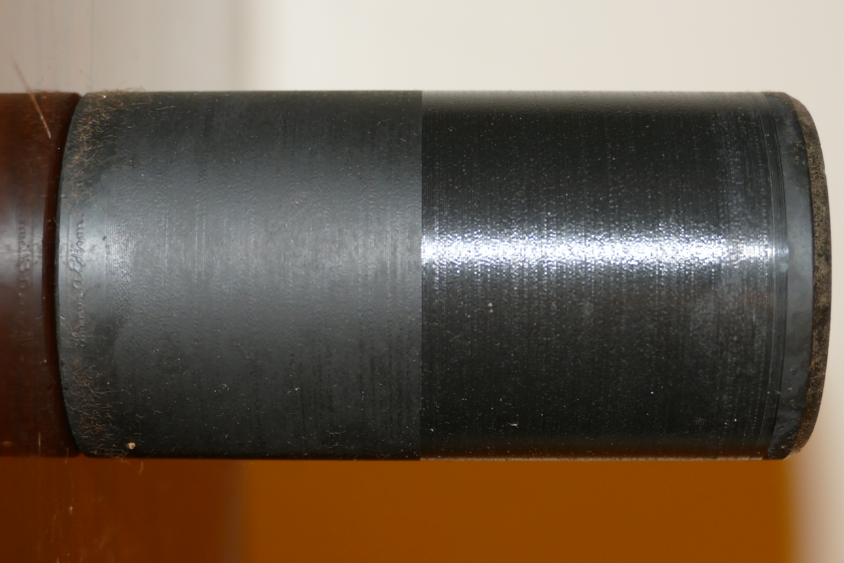

Thanks, everyone. I do clean the stylus after each play, and the sound is equally bad on two different kinds of reproducers. I've attached three pictures of the same cylinder from the same angle, with different lighting; the dark areas, like the one up toward the top (or the right, as the photos are oriented before you click on them), is where the cylinder has been played recently. I hope this helps you all pinpoint the issue.

eighteenbelow
Posts: 157
Joined: Sun Dec 16, 2018 6:57 pm
Re: Why don't my clean early black cylinders sound very good?
Post by eighteenbelow »

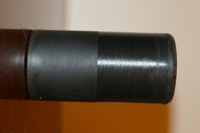

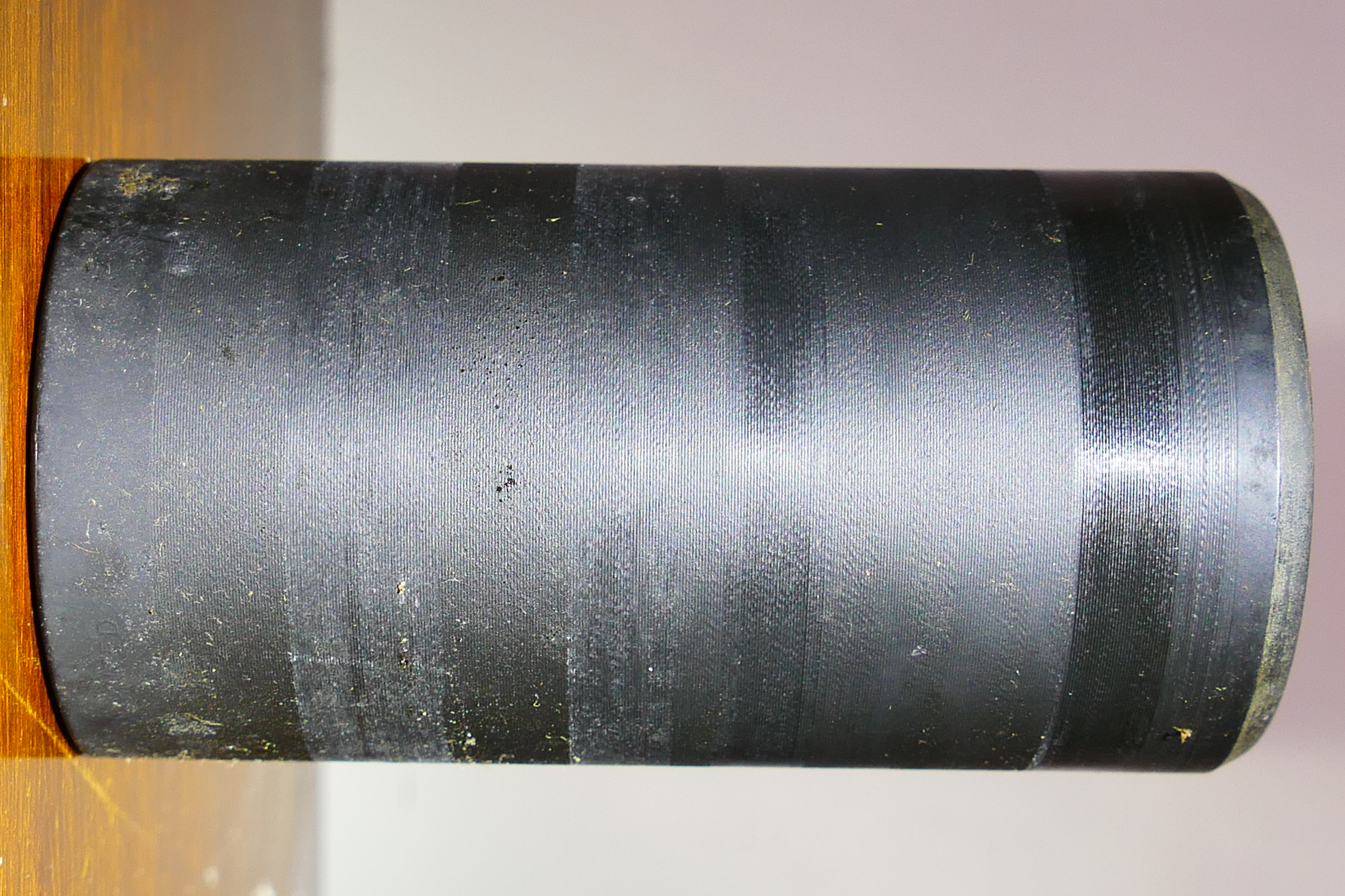

I just took out another cylinder that I hadn't played yet, and played the first half. These pictures show the contrast even better.

Post by AudioFeline »
Have you thought of washing the cylinders to clear out any muck that might be at the bottom of the grooves (similar to washing dirty records)?
Orchorsol
Posts: 1792
Location: Dover, UK
Post by Orchorsol »
I freely admit that I'm a novice with cylinders and cylinder machines. However, I can't help worrying that this might be a damaged stylus, a possibility that someone has suggested in a post above. And that the changed visual appearance of the cylinders might be permanent damage. I have a cylinder phonograph which is doing a similar thing, and I won't use it again until I get the reproducer rebuilt or source one in good order. Is yours producing any dust as it plays, or fine particles on the cylinder surface? Even just a little? To my mind, that would make this hypothesis pretty much definite.
