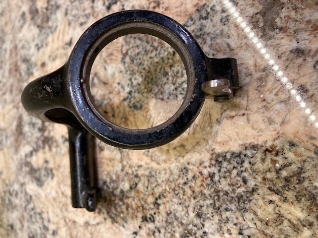

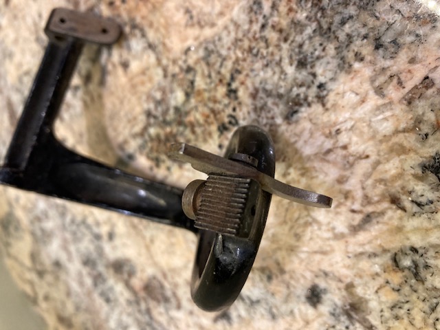

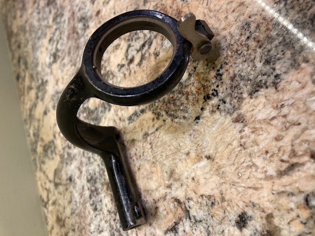

I found this in a box of parts , does anyone know what it goes to ? Notice the threads on the front side of the carriage. Thanks Larry

- phonogfp
- Posts: 8279
Re: EDISON CARRIAGE WHAT DOES IT FIT?
This carriage is for use with an ICS repeater. It appears to be a Gem carriage.

- Mormon S
- Posts: 756
- Joined: Mon May 07, 2018 6:27 pm
- Personal Text: "phono_fluff" on instagram
I have seen an ICS gem with the large upper pulley, but never one with a repeater. The gem carriages also have the threaded holes in the center for the downward facing half-nut, since the feed screw on the gem is below the carriage rod. Looks to me like a standard C carriage.Pathé Logical wrote: Sun Jul 10, 2022 10:48 pm Still learning --- I've never seen a Gem with an ICS repeater. Time to hit the books...
- phonogfp
- Posts: 8279
It may indeed be a carriage for a Standard.Mormon S wrote: Mon Jul 11, 2022 12:34 am I have seen an ICS gem with the large upper pulley, but never one with a repeater. The gem carriages also have the threaded holes in the center for the downward facing half-nut, since the feed screw on the gem is below the carriage rod. Looks to me like a standard C carriage.

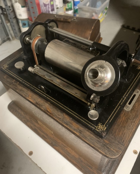

gsphonos
- Posts: 427
- Joined: Wed Feb 24, 2010 11:33 pm
That appears to be for a Standard Model C or later. I just found a picture of my C and attached it here. It would also work on a later Standard ICS machine. It can’t be used on an earlier Standard A or B ICS machine.

gsphonos
- Posts: 427
I’ll try again with the picture—didn’t get it posted the first time.
