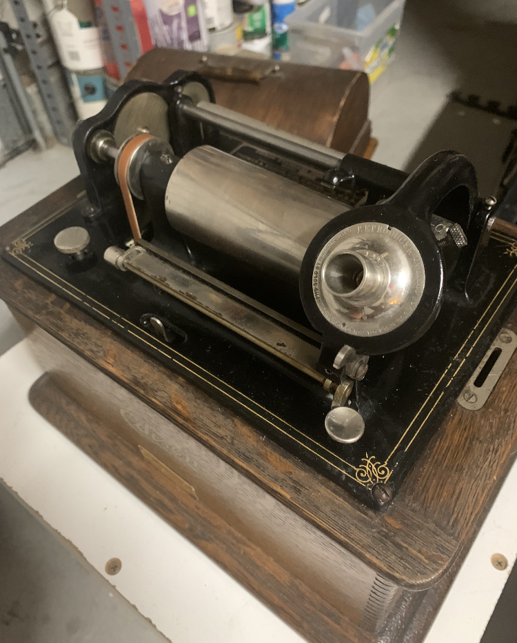

A Standard C or later carriage for a C or an H reproducer is also not backwards compatible—they will not fit on an earlier A or B because the A and B have an end gate. I just posted this picture of a Standard Model C ICS machine. The ICS carriage is adapted for ICS repeater on that machine, but the carriages on non-ICS machines are the same—just not modified for ICS use. Then, of course, you have the carriage on a pure 4 min Standard E, that is for an N reproducer, the special carriage on an F Standard used for a Model S or R reproducer, and then all sorts of adjustable carriages to “amberolize” your Standard to use a Diamond reproducer, etc! A lot of different carriages for the Edison Standard!
