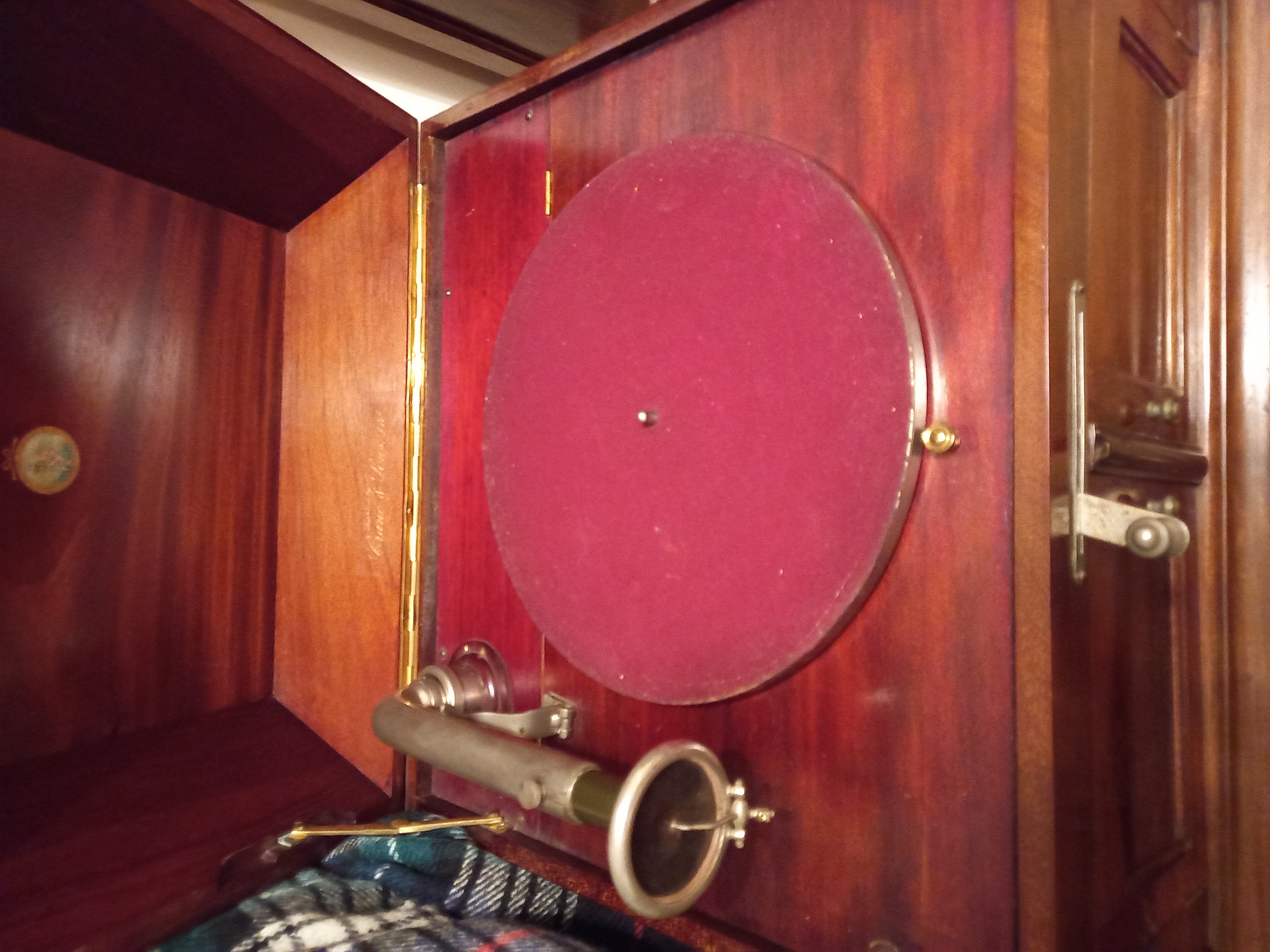

Hi all am looking for a Pathé adapter to play 78s on my Pathé tabletop. Have the Pathé soundbox and fitment but not the equivalent to play with a normal needle soundbox. Any advice or places I may source one? Thanks!

I don't know that I've seen a lateral adaptor for a Pathé machine. The machines sold in the USA, AFAIK, mostly (if not all) had a rotating head that swiveled from vertical to lateral position. In lateral position, it looked odd, but it worked. If your tonearm has a thumbscrew and collar behind the reproducer, in theory you can rotate the reproducer to play laterals. In practice, the pieces are usually pot metal that has swollen to the point where this won't work. There's no single way of freeing it. Sometimes heat works, sometimes cold works, and if you're very lucky, yours will rotate after using penetrating oil.
You may want to post good photos of your tonearm and reproducer so we can better answer your question.

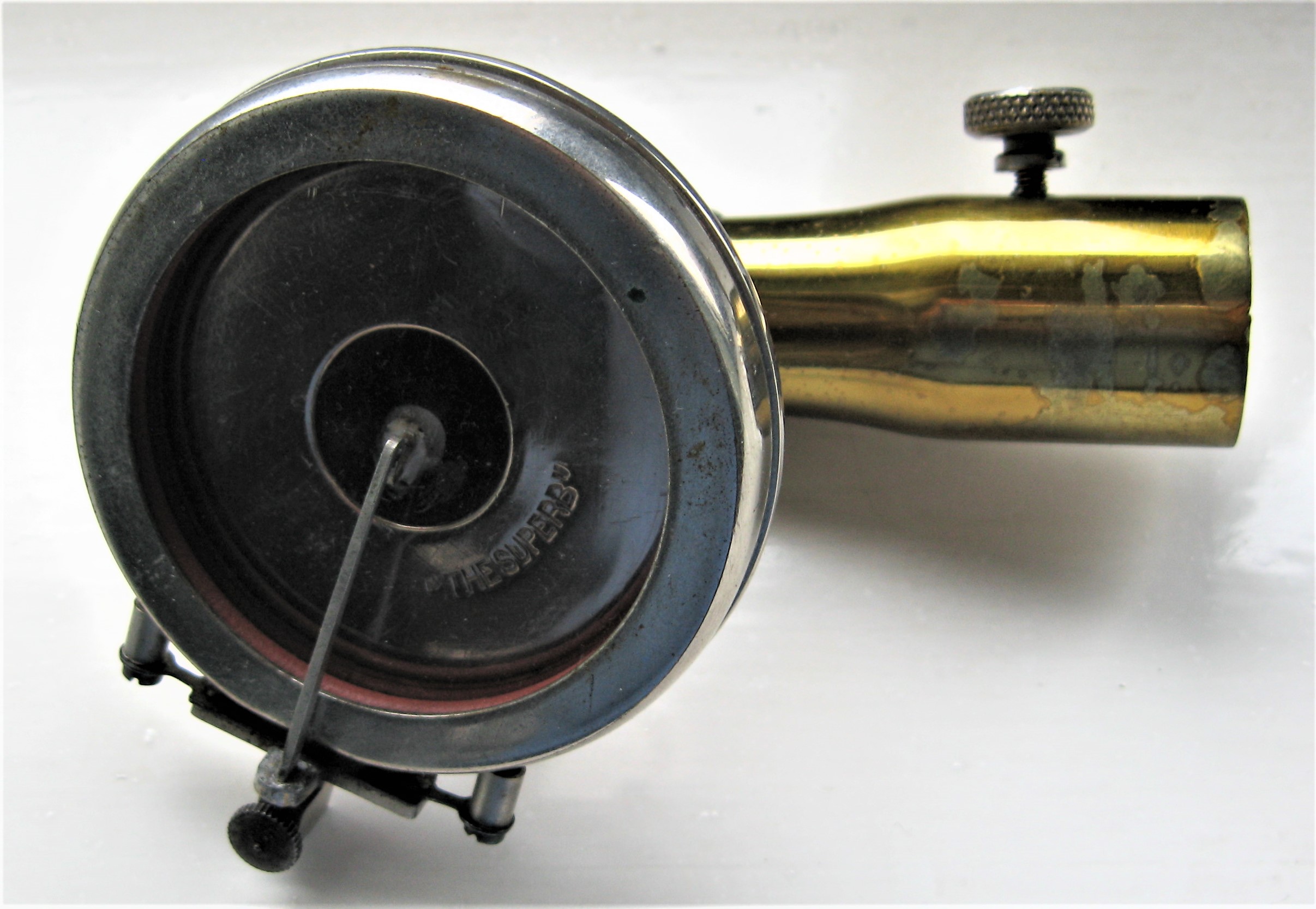

Not for sale, but this is a typical example of what you are looking for :
BlackcatJJ
- Posts: 11
- Joined: Sat Jul 02, 2022 7:23 am
Re: Pathé 78 adapter
Thank you, that's really helpful.
