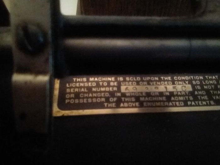

The serial number on this Standard was the first thing that drew my attention (other than a very well preserved patent plate.) It is Number 693815C.

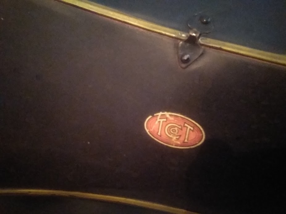

The horn decal is in as good of shape as the rest of the horn--bright, crisp, and correct. The gold pinstriping is good and so is the deep black paint. I think this one is going to be a really presentable horn with a bit of a cleanup; even if it would've been a less interesting machine I would've bought it for the horn.
A patent plate that isn't all discolored and missing its silver? And one that an antique dealer hasn't gotten hold of & polished to brass? Nice.
I like this; I'm going to have to take it off & see if the number on the plate matches the number on the casting. This one doesn't have the serial number in the knife-edge for the carriage, so it should be underneath the patent plate cast into the metal. At least it was like that on a 1911 Standard E that I had apart. (Mormon S still has it now, I think, & promptly took it apart again to restore it a second time--I think he really did justice to the machine. It was sounding a lot better too.)
But anyway that serial number is pretty neat.

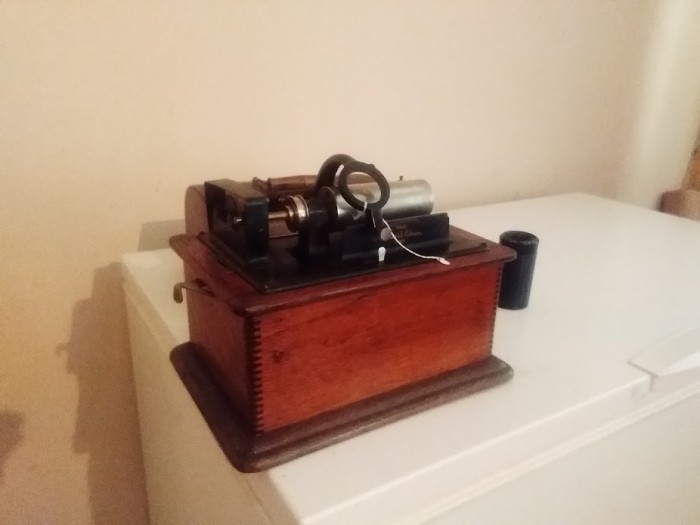

I found inside the lid the "Change of Reproducers" label from a Model D phonograph. Either someone put a Model D lid on it, or they were using up D lids at the Edison plant, or--maybe they just made all the lids alike & didn't bother changing it for the Model C? I would really love to know some of the lore on the Model C phonograph, because I've personally never seen one like this--it has so many transitional features from the B to the D style that it combines all the neat qualities of both machines. Sure it'd be nice if it had been Amberolized but I'm ok with having a really nice 2-minute player in the collection as well. 2-minute machines entertained a lot of people back in the old days even without a long playing attachment.
So far to make it correct it will need a new mandrel bearing, a crank, a gear cover (the one on there now is a homemade thing that started life as exactly what it is--just a bent piece of sheet-metal daubed up in black paint, & I'm going to check if it should be the early cast iron type, or the kind on a Model D.) Also I will have to source a crane, drive belt, cabinet decal, and a Model C reproducer with a good sapphire. Other than that, and re-plating the feedscrew cover which is a bit rusty, it is not going to take much to freshen up this machine; it doesn't have a lot of damage or wear on the motor and top works, and the motor actually starts & runs great.

The horn looks great--I took it out in sunlight on the way to store it in the barn for a bit & the pinstriping appears to be red and gold together. I think they laid down a ground of red paint and then brushed a slightly thinner gold stripe over the top of that. It is a very pretty effect up close and I have never seen this before on either a repainted or original horn.

I've already begun doing a slow evaluation of the machine to get ready to restore it. So far the piece of crudely bent sheet tin over the topworks is gone, to be replaced by a correct cast gear cover. The nut on the motor winding shaft is gone too, and so is the poorly tapped crank handle from a large cabinet phonograph. I'm probably going to just go ahead & put the crank in scrap metal recycling.
The case is messier than I thought. It has a very bad job of repairing done on the front; the part where the horn crane would have attached appears to have been glued back on after being torn off. (This might explain why it didn't include a horn crane support.) Also, thanks to incorrect screws on the side where the motorboard lift latch goes, there's now a sheet-metal screw protruding through the side of the case. Also the baseboard is cracked.
I think it would be simpler to set that case aside in the parts bin & find a complete late-style Standard D case to put the topworks into. It's unfortunate but I think I would like to have this thing presenting in the best possible way.
There's a rolled twist of paper in the bottom of it which was someone's business card. I think the machine was restored some years ago by someone with an AOL email address in the State of North Carolina. Considering the worksmanship is frankly embarrassing, I don't want to share their contact information with the world.

Since the original cabinet is the earlier Standard B/C style, I'd suggest replacing it with one of the same design (low base).VanEpsFan1914 wrote: Thu Jul 28, 2022 12:38 am I think it would be simpler to set that case aside in the parts bin & find a complete late-style Standard D case to put the topworks into. It's unfortunate but I think I would like to have this thing presenting in the best possible way.
