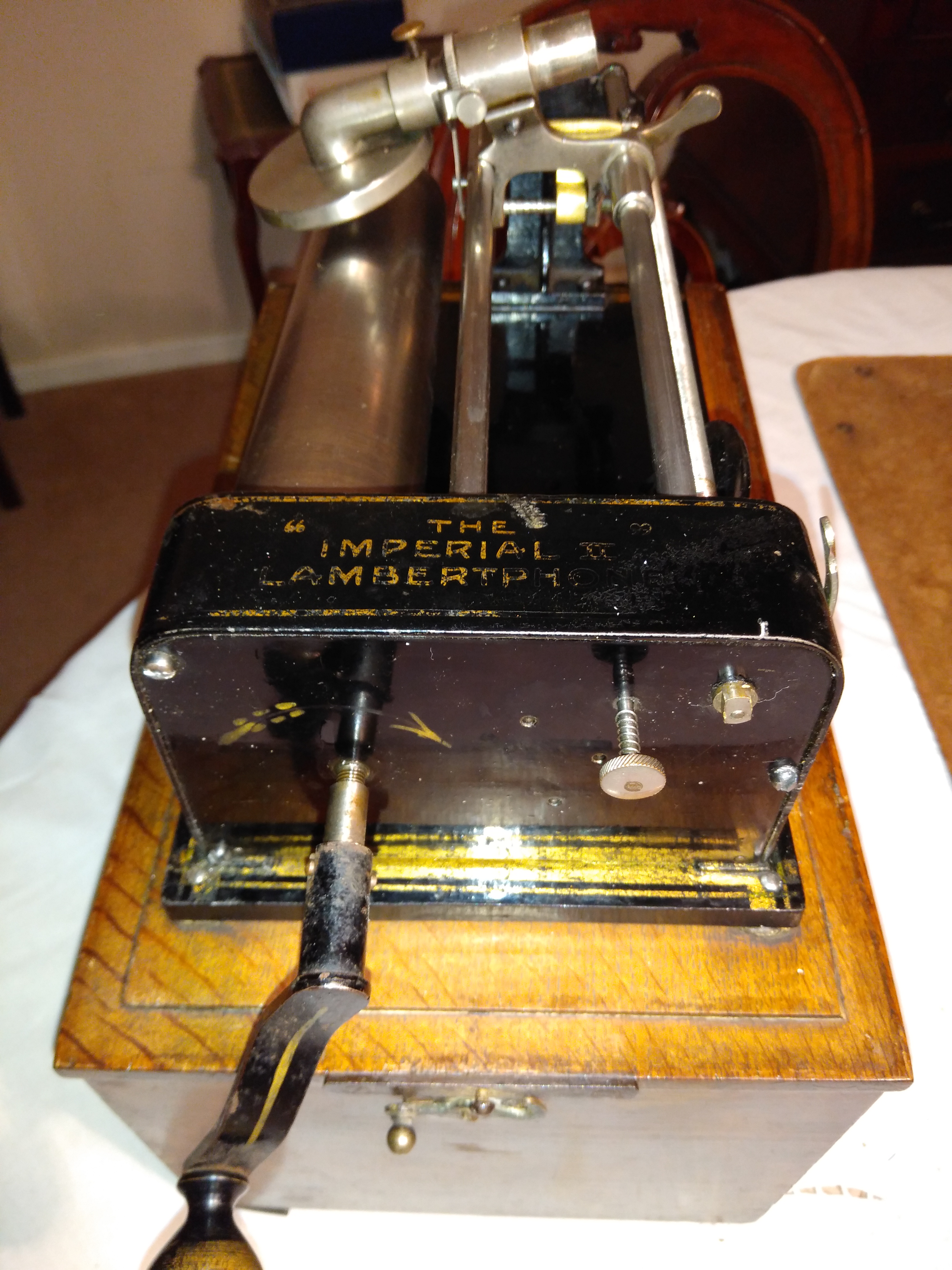

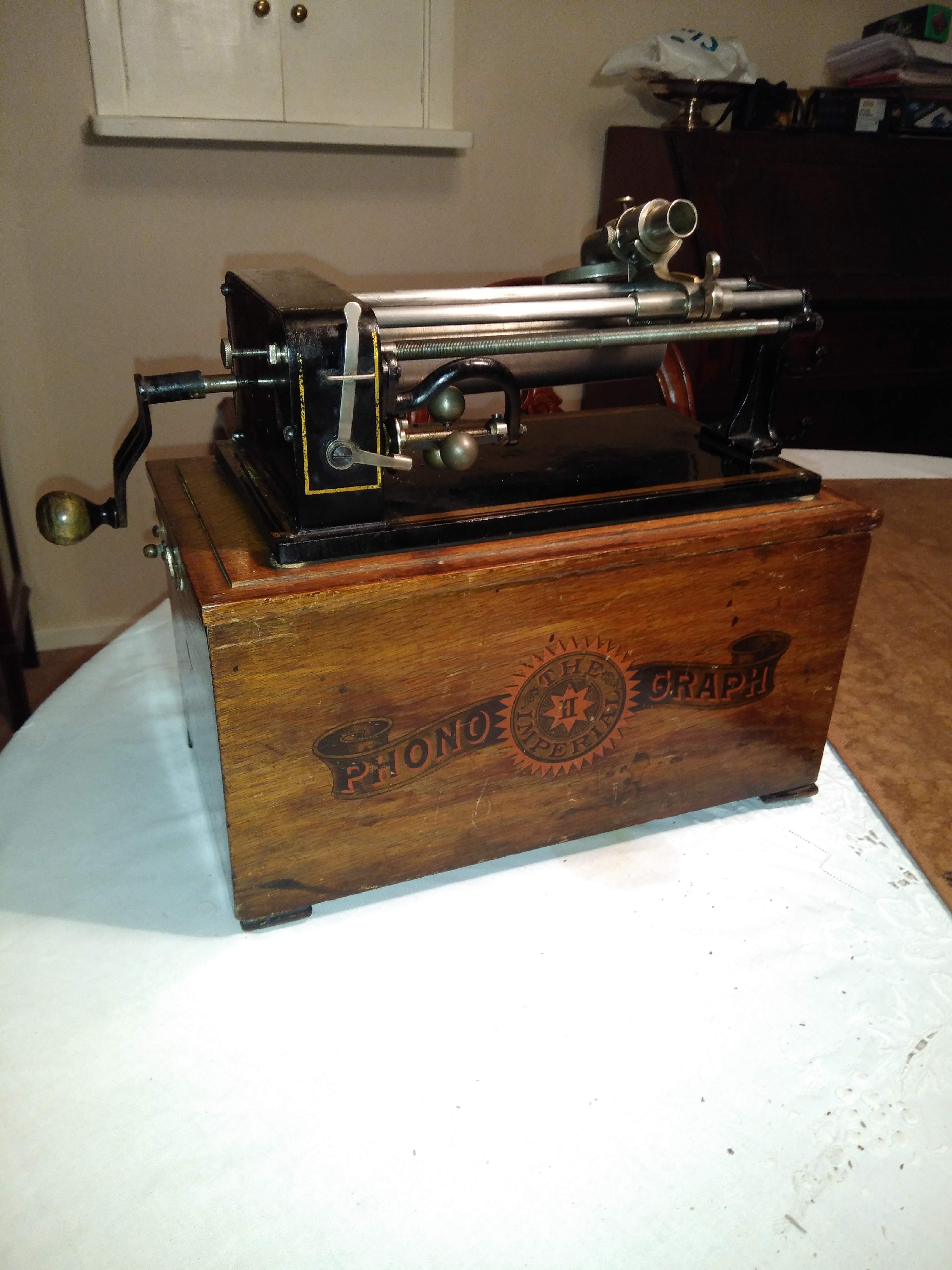

Anyone know where a spring for a Lambertphone Imperial ( Excelsior Werke ?) spring can be obtained looks to be 16mm according to the Vulcan price guide

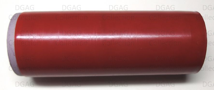

Now you also need this. Unfortunately, it is my only "Lambert Imperial Record":

As your machine is the single - spring model , one avenue worth considering is to find another Excelsior phonograph of the same layout ( as they nearly always are ) in poor condition to donate the main spring . i would think that most single spring Excelsior models would use the same mainspring. I have seen many examples of Excelsior phonographs turn up over the years , often just the mechanisms , indeed I have had several examples myself, also often their reproducer carriages are made from pot metal and have partially disintegrated as a result , so therefore can be bought in at a modest price . The remains can always be sold on as spares as someone will want it for the mandrel , or other useful parts. I did have to replace one spring in my double - spring Excelsior phonograph and I'm sure from memory the spring is slightly thicker than a standard gramophone spring . I can't remember where i obtained the spring I required as it was some years ago now , I may well have fitted a gramophone spring as naturally in a double spring motor , it is not so critical , but I think you will certainly need a thick ( i.e stronger ) spring in your single spring model to give the required power . Regardssoundgen wrote: Wed Sep 07, 2022 1:08 pm Anyone know where a spring for a Lambertphone Imperial ( Excelsior Werke ?) spring can be obtained looks to be 16mm according to the Vulcan price guide
