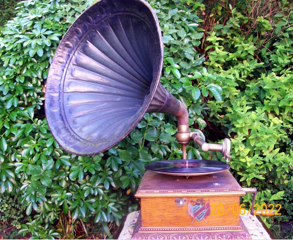

Hi, What does anyone make of this ? Obviously nothing to do with Victor and the wrong horn but a very interesting tone arm/back bracket set up. I know there are plenty of Leo Phone fakes out there but never seen a Lion o phone and the transfer looks to have some age to it ??

Gramtastic wrote: Mon Sep 12, 2022 10:53 am Obviously nothing to do with Victor and the wrong horn
Are you sure it's the wrong horn and if so, what horn should it have?

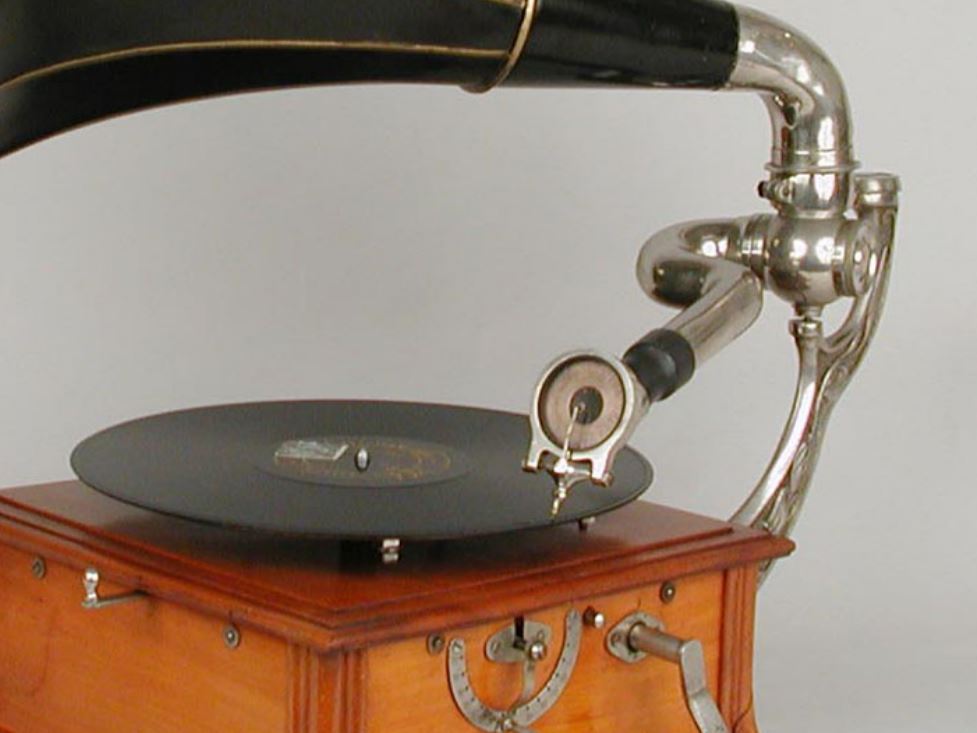

The tonearm is interesting:
Too bad there's no taper.
OF

The peacock feather pattern horn was widely used in Europe, especially on Swiss/German machines.
Two 90 degree angles on the tonearm do not bode well for sound quality, and it is difficult to see how it connects to the horn.
I suspect that it may be the work of an enthusiastic amateur.
Posts: 4686
Re: Lion-o-Phone ??
These Swiss machines used to have a standard tonearm... I'm with you that this is a later patchwork...

Looking at the angle that the soundbox is to the record, I suspect the arm is the result of a few copper plumbing fittings and a fertile imagination! I could be horribly wrong, of course.......

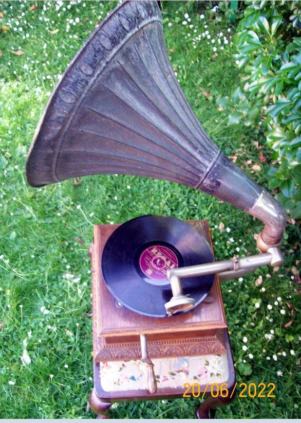

The center part of the back bracket must rotate to let the tone arm move , bit sophisticated for an amateur perhaps it was made to overcome tapered tone arm patents ?

soundgen wrote: Tue Sep 13, 2022 10:11 am ...The center part of the back bracket must rotate to let the tone arm move , bit sophisticated for an amateur perhaps it was made to overcome tapered tone arm patents ?
Some Pathé' gramophones used a similar rotating mechanism, though the tonearm's design was far more sophisticated:
(FROM: https://78rpm.club/gramophones/Pathé/ )

I'm sure it's not home made as it's far too well done. it's strange that Google can't find any reference to Lion A Phone as the transfer looks genuine .....
