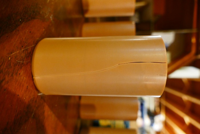

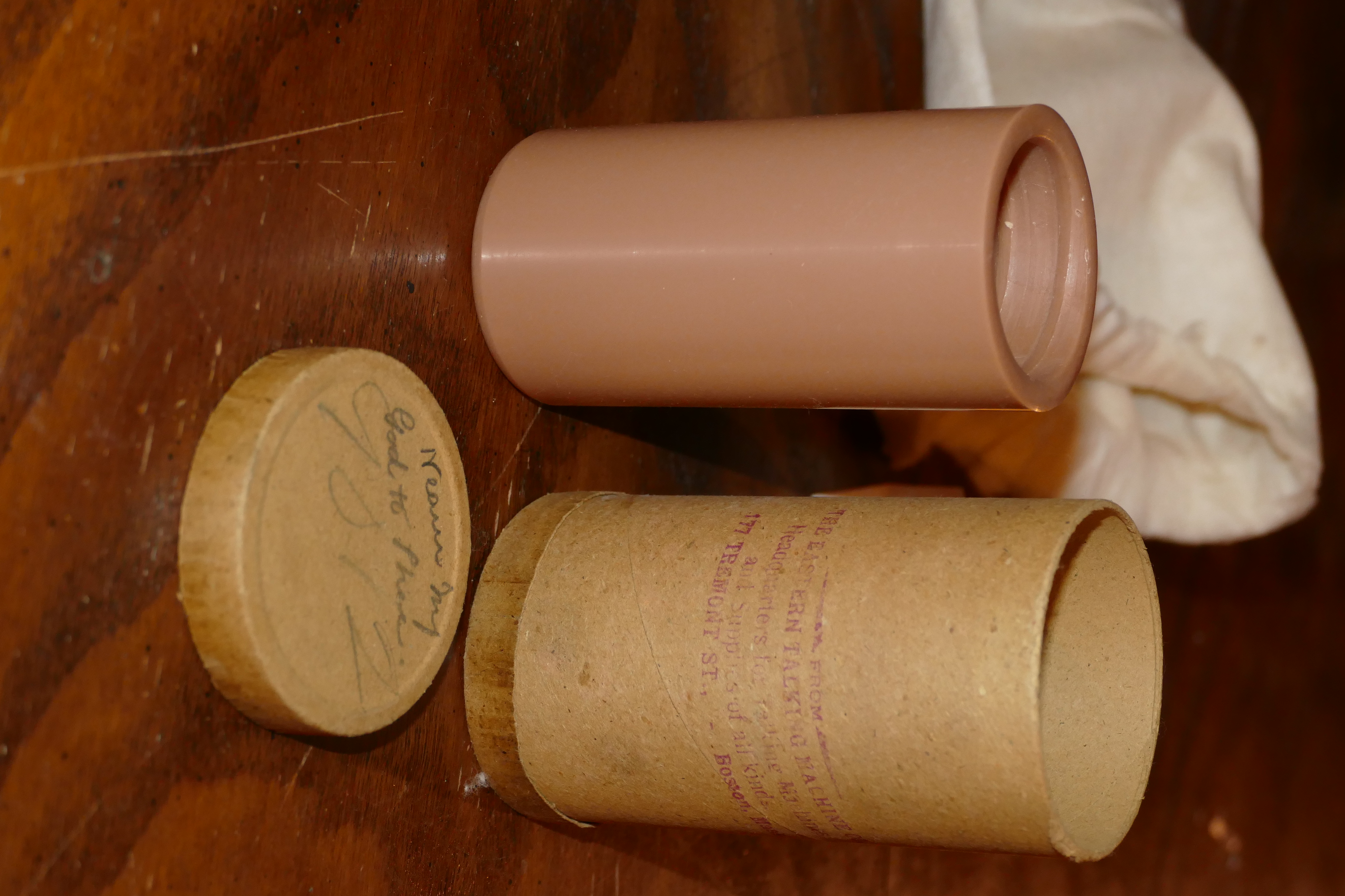

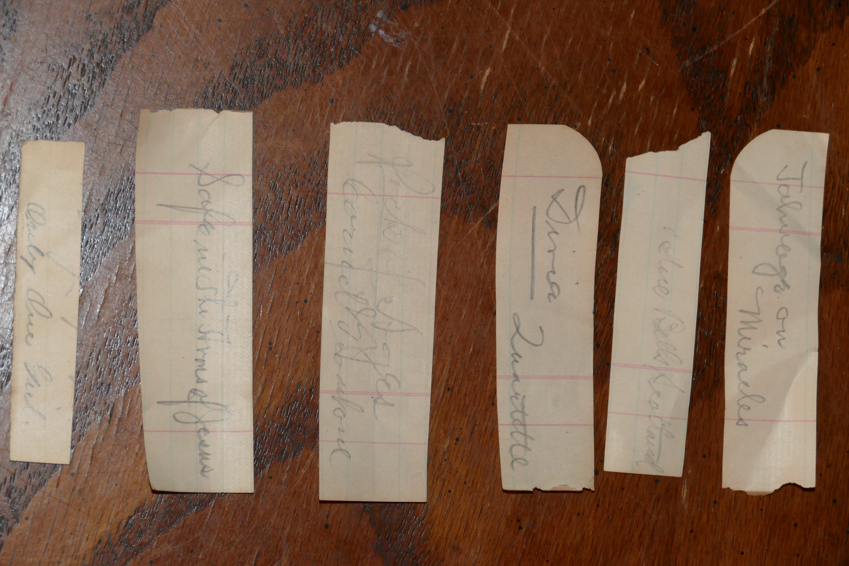

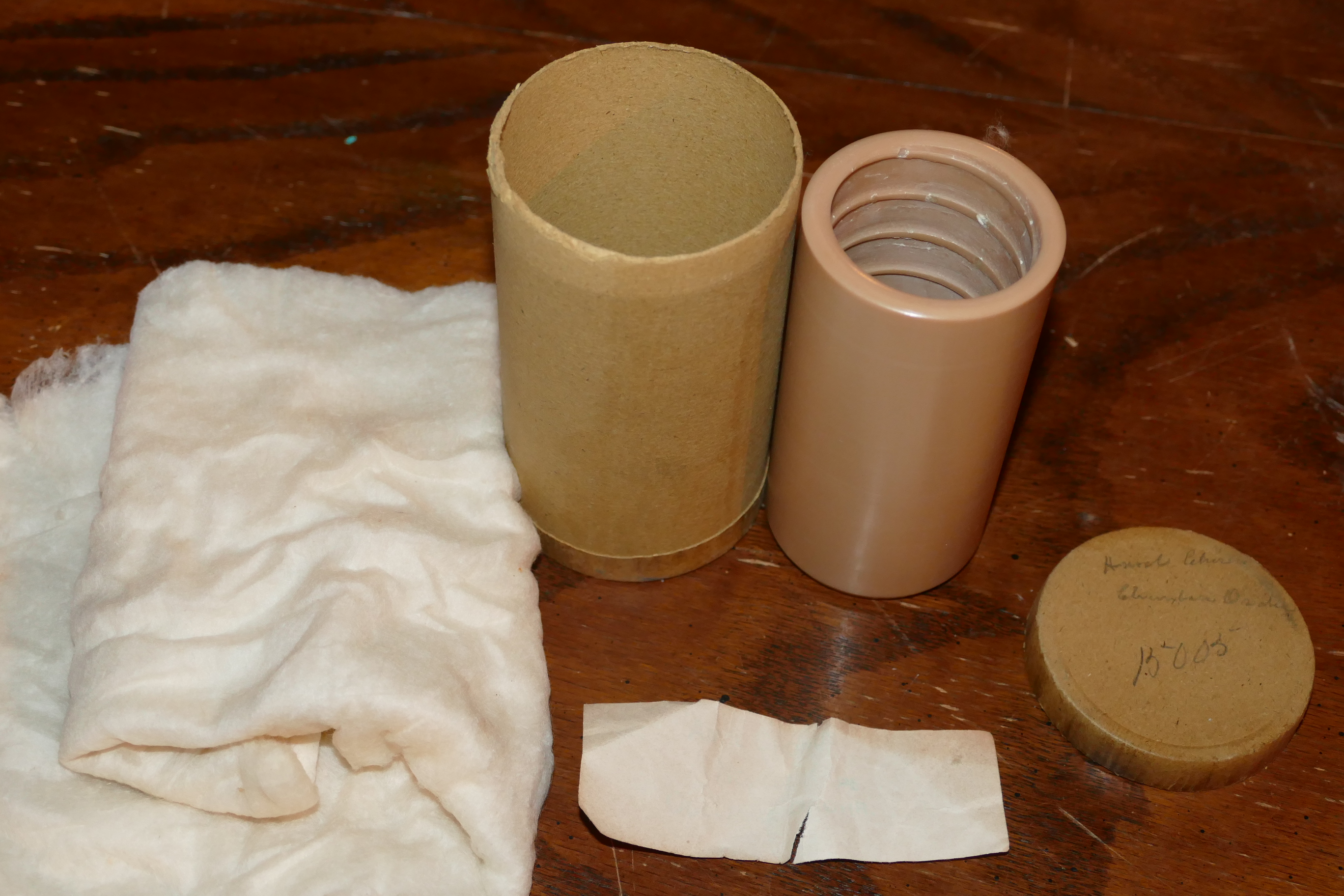

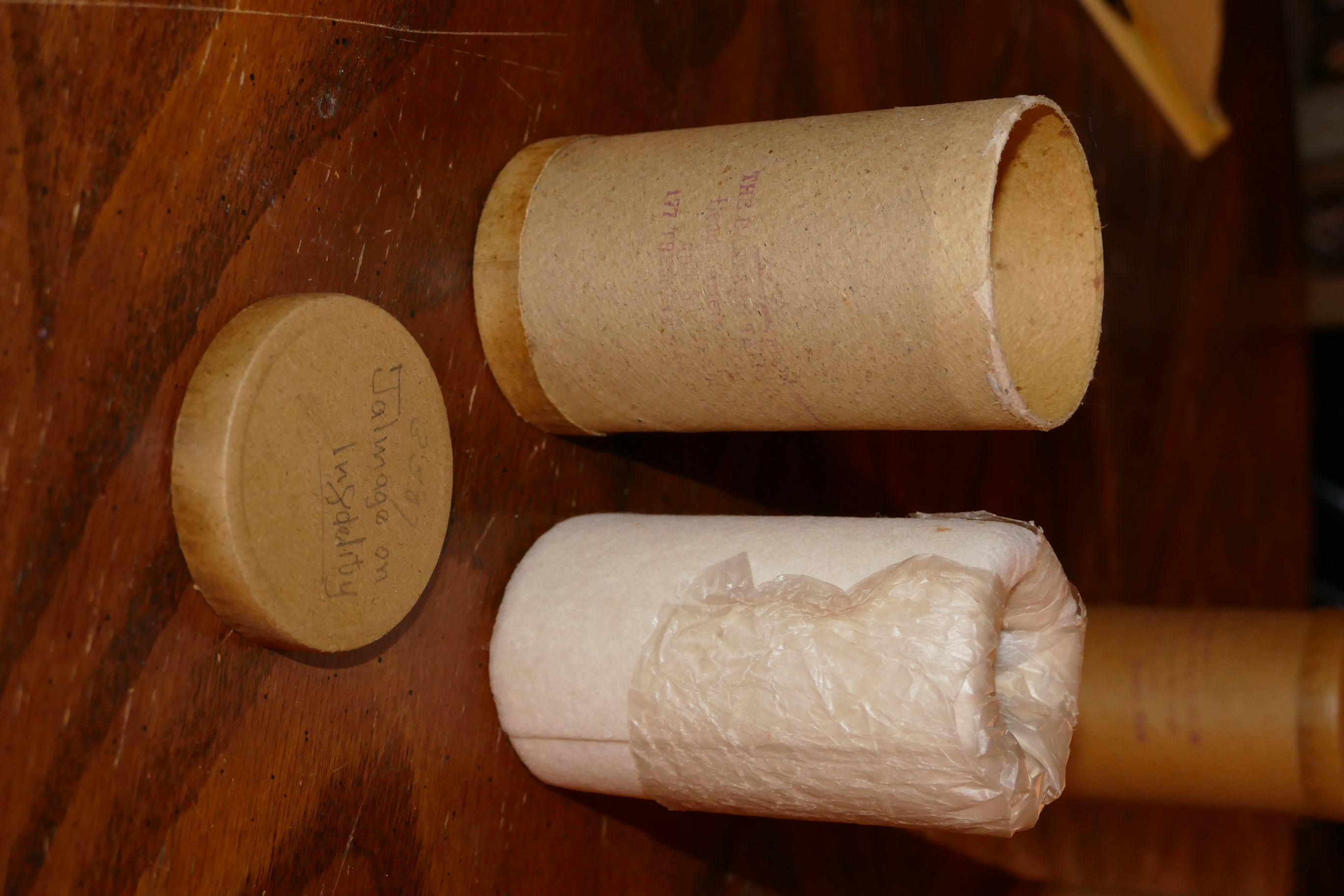

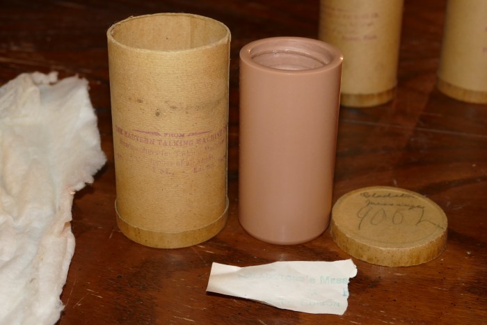

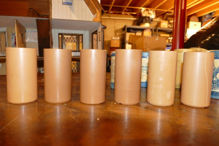

Greetings, everyone. I went to an estate sale this weekend and picked up what I thought were 10 intact brown wax cylinders, and three broken brown wax cylinders. (I also picked up 15 black wax cylinders in a cardboard cylinder box.) When I got home and looked them over I discovered that one of the "good" cylinders had a crack running its entire length. (Oh, well; at least I know it was there when I bought it, and that it didn't happen on the way home.) If anyone has any tips on "fixing" that crack, please share. I know from other posts that brown wax is very tricky to repair (some say impossible), and though I have heard Dr. K does great work, I probably don't want to sink that kind of money into repairing a 2" cylinder, contents unknown. So, unless I can figure out how to do it myself, it will probably stay cracked. Again, any and all tips welcome.
So: I have found thousands of cylinders in the wild over the past few decades, but only a very few are brown wax, and of those, maybe a dozen (all found without cases) aren't moldy; so yesterday's find almost doubles that number. (Fun fact: One of the ones I have from a previous find is President McKinley's inaugural address.) It was a good day. Five of the nine intact cylinders did not have cases -- they were in a carrying case, along with the cracked one and the broken ones -- but four of them did. (For now, I am storing the uncased ones in later Columbia cases; all were empty for years, and hopefully none had any mold still in them.) However, they are unlike any cases I have ever seen, and I am hoping to learn more about them.

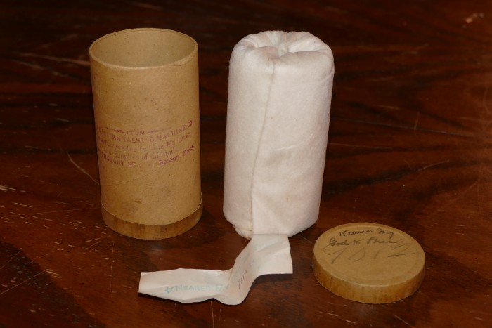

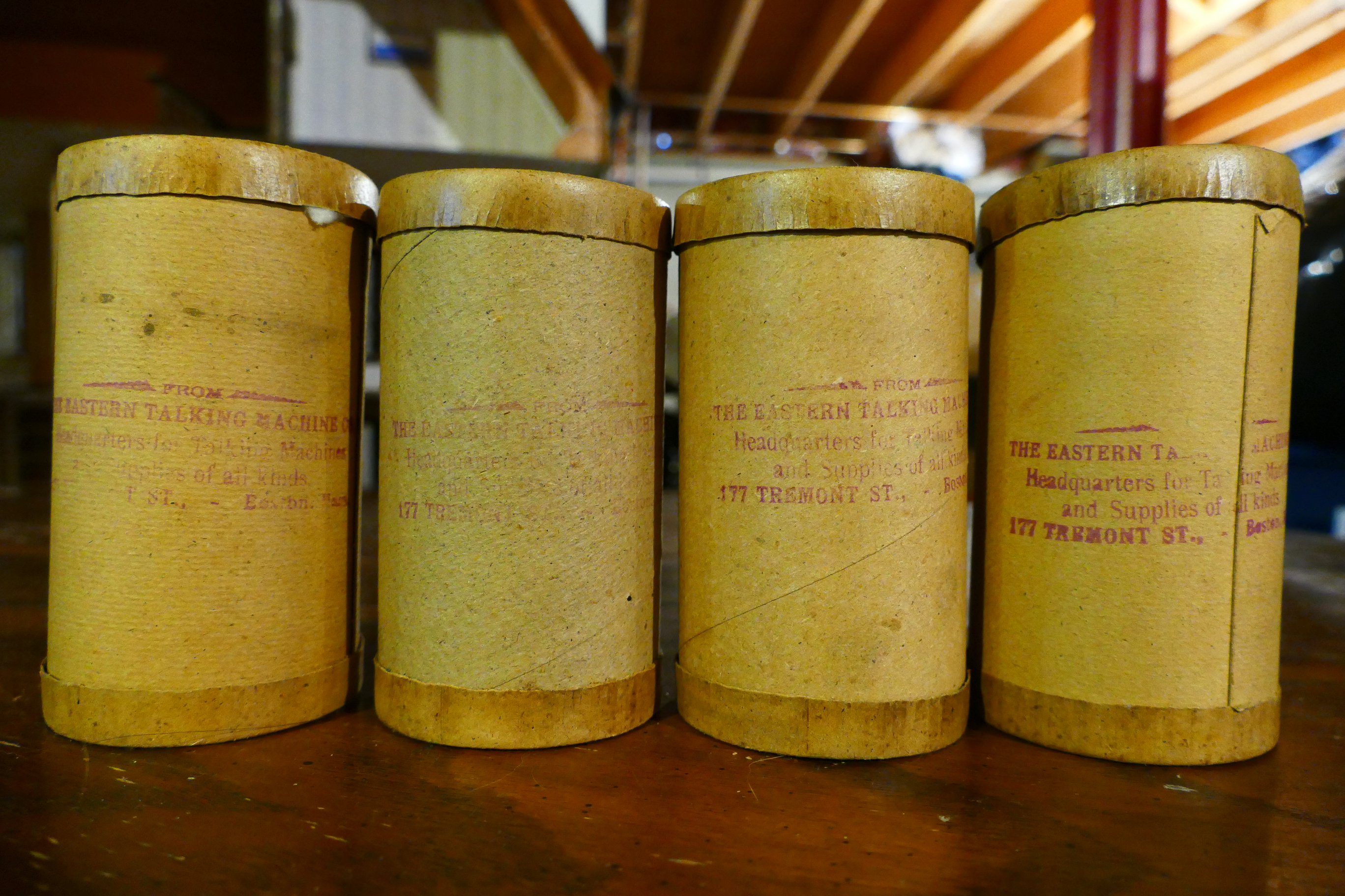

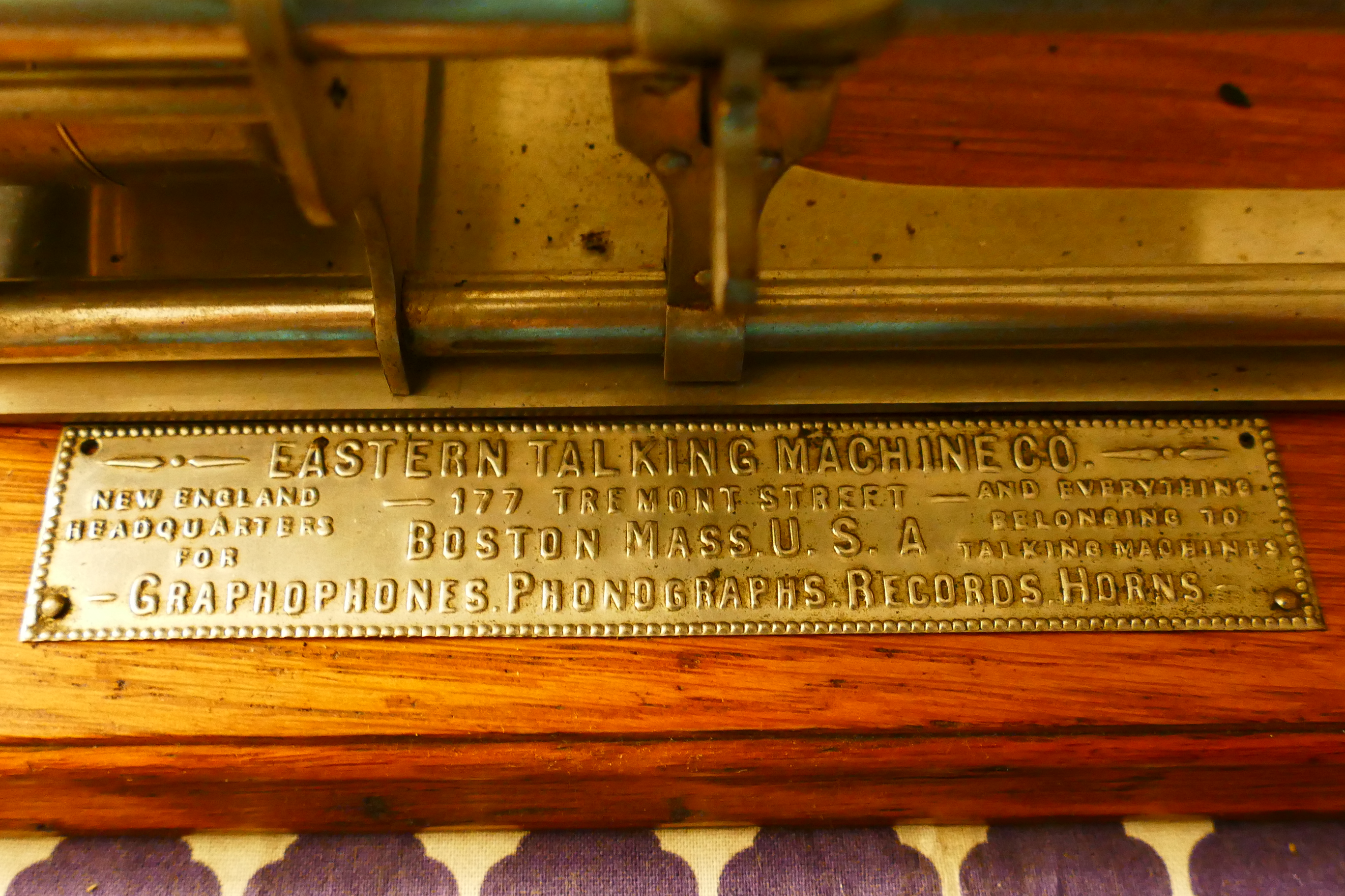

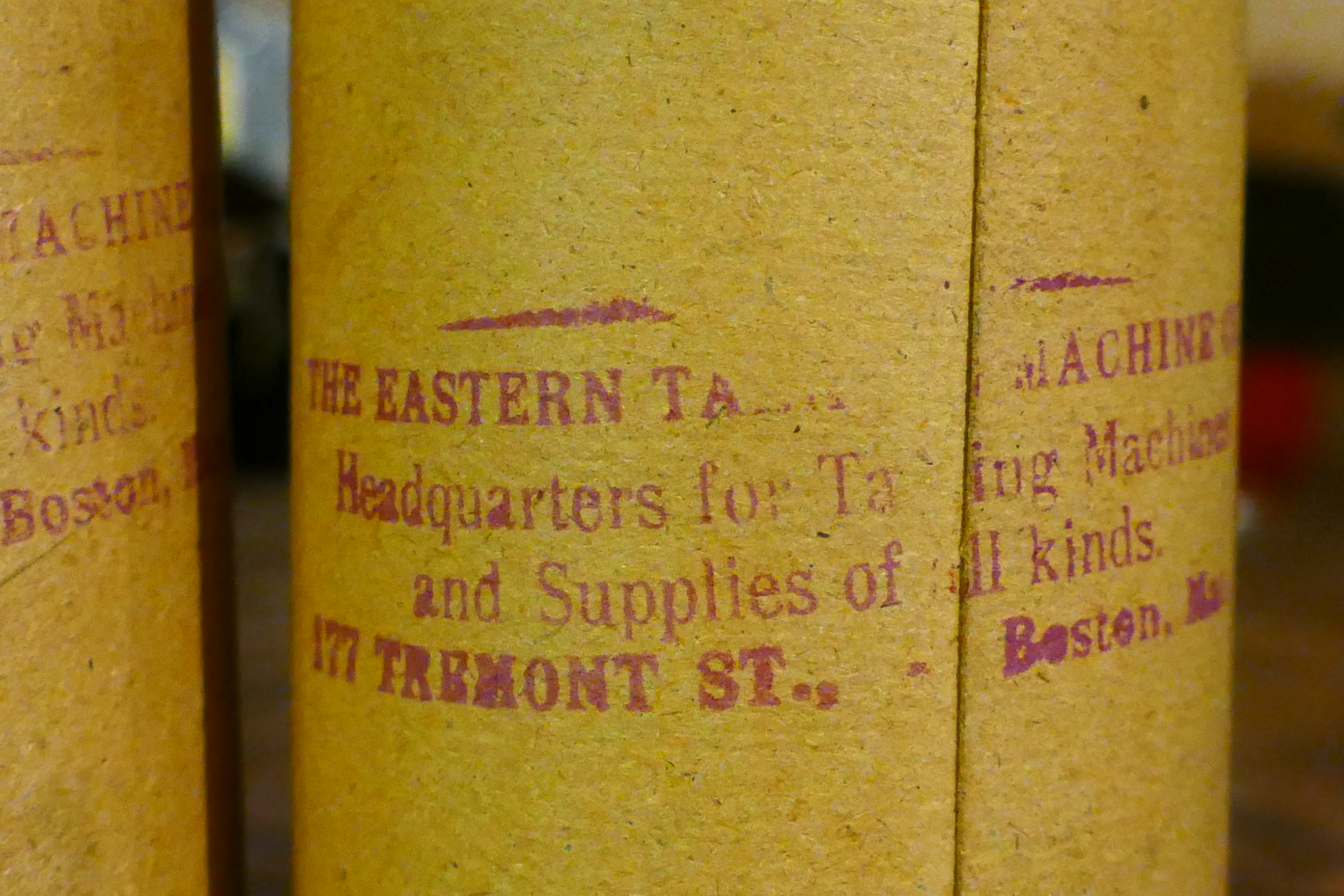

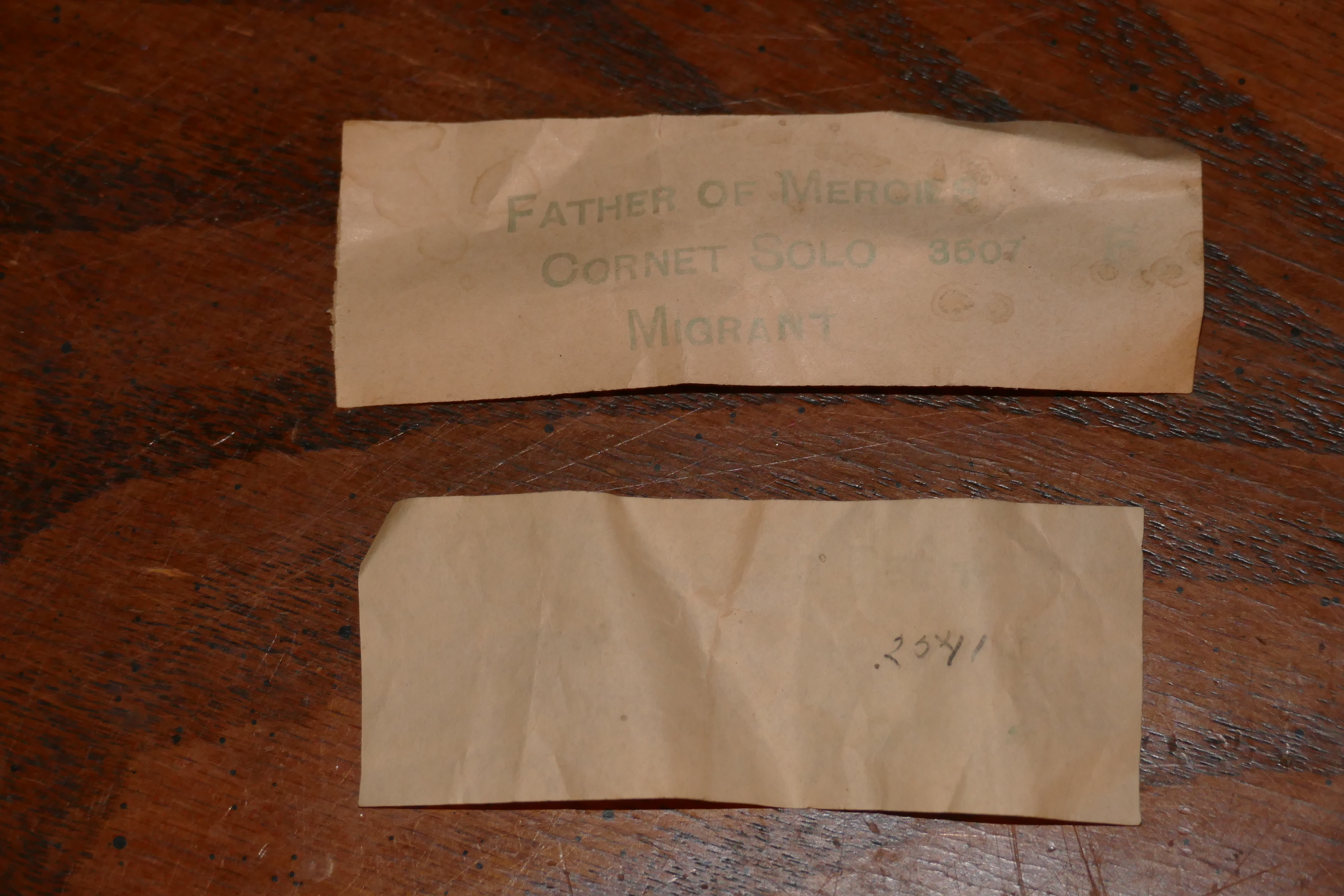

As you can see, they have no labels, and are stamped with the name and address of the Eastern Talking Machine Company, and early phonograph dealer in Boston. I happen to own a pretty early Columbia Eagle (see last picture for serial number) that was sold by the same company, which replaced Columbia's nameplate with its own (see second-to-last picture). I know nothing else about the company and can't find any information about it online; if anyone knows anything about them, I hope you will consider sharing!
On to the cylinders: I have listened to all nine, now, using listening tubes. Some are very faint, and some are surprisingly loud and clear. All seem to be Columbias, although one or two have no opening announcement at all, and one or two have an announcement that identifies the song and artist but not the company. Of those that do identify the company, all say The Columbia Phonograph Company; some add "of New York City," at least one adds "of New York," and at least one adds "of Washington, D.C." I don't know if that can help date them or not.

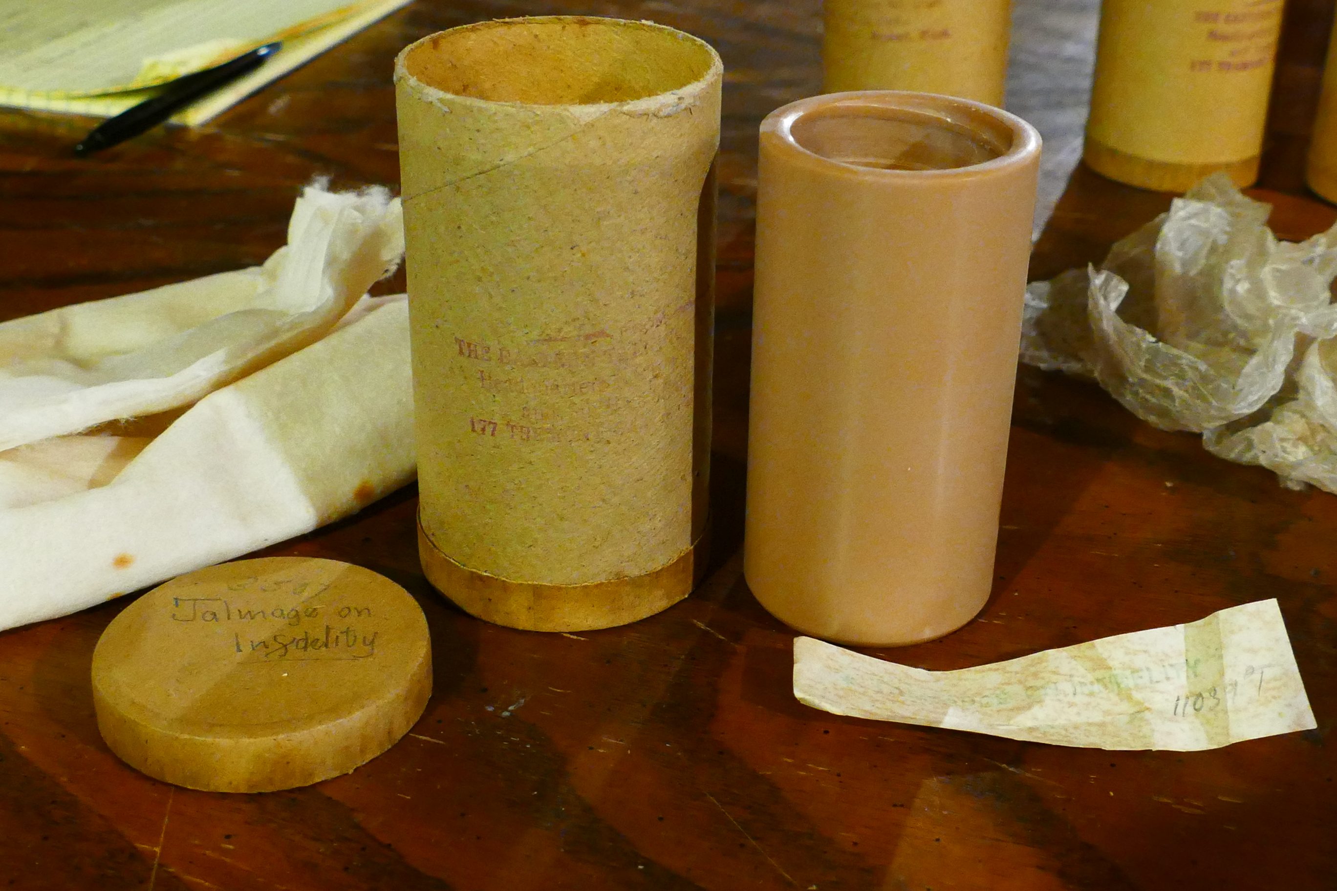

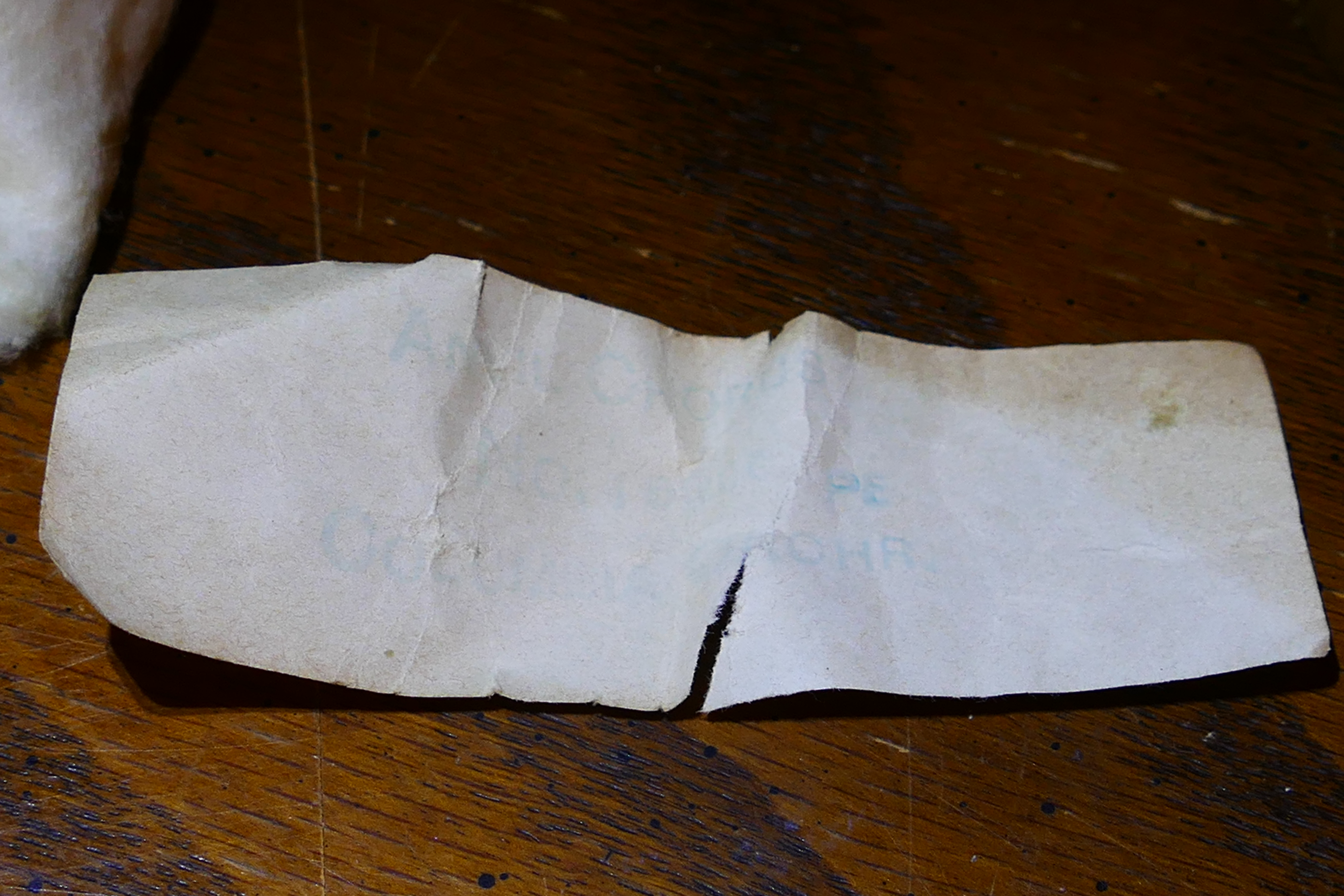

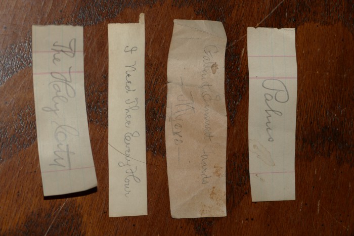

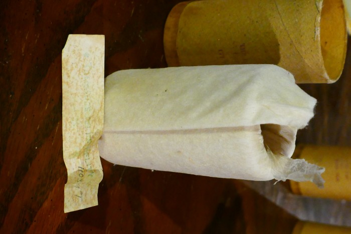

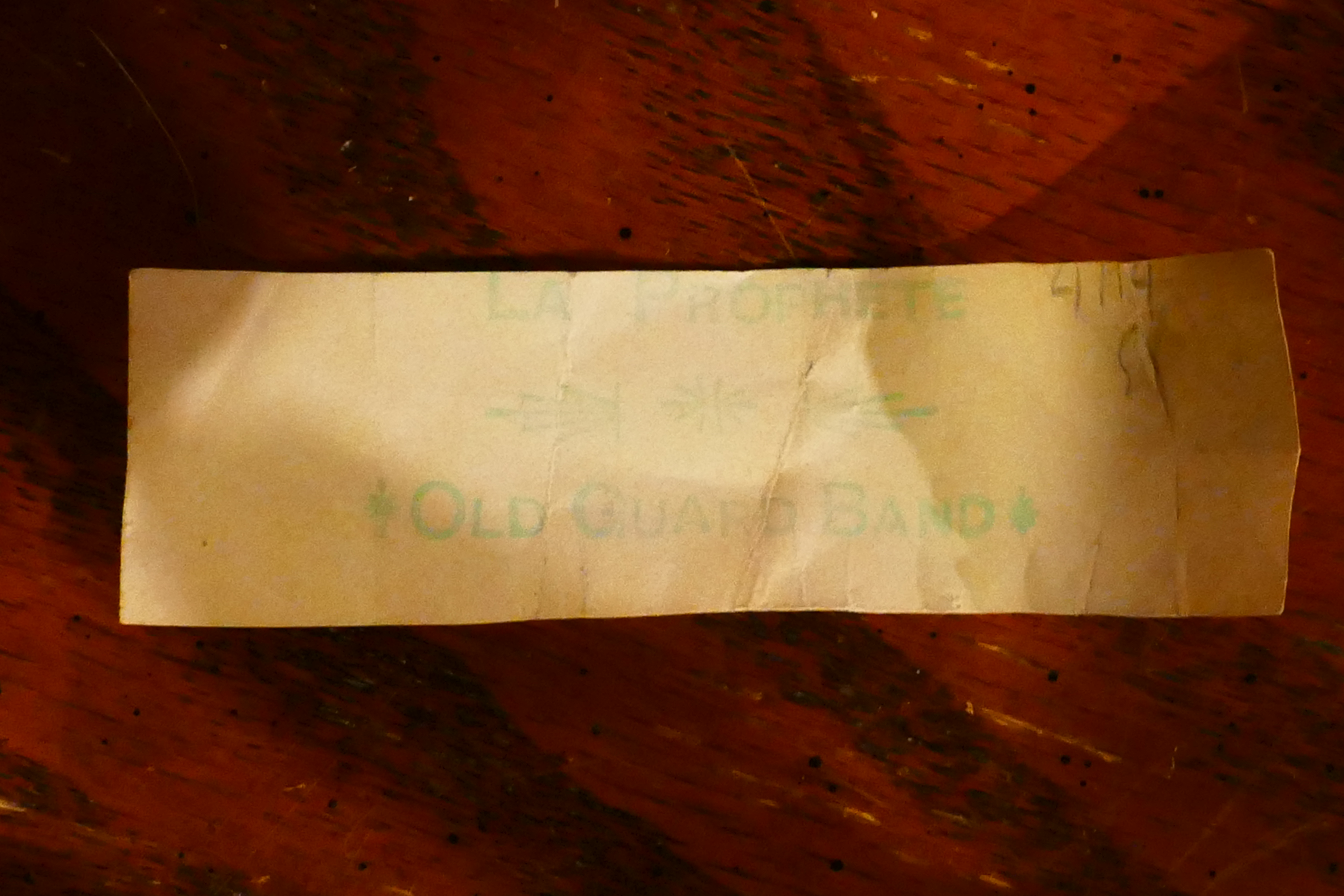

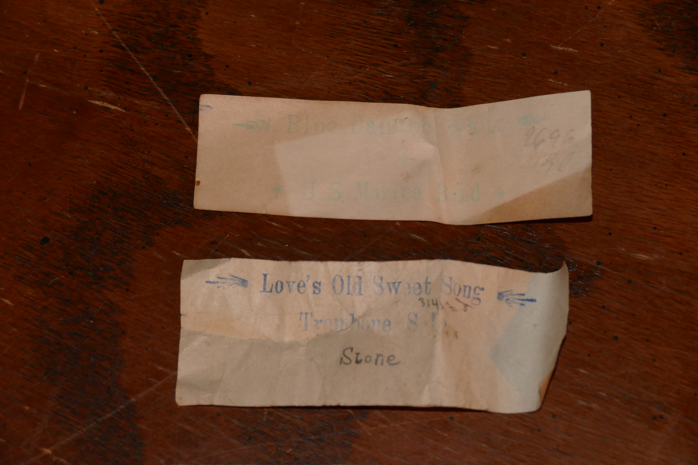

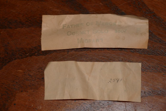

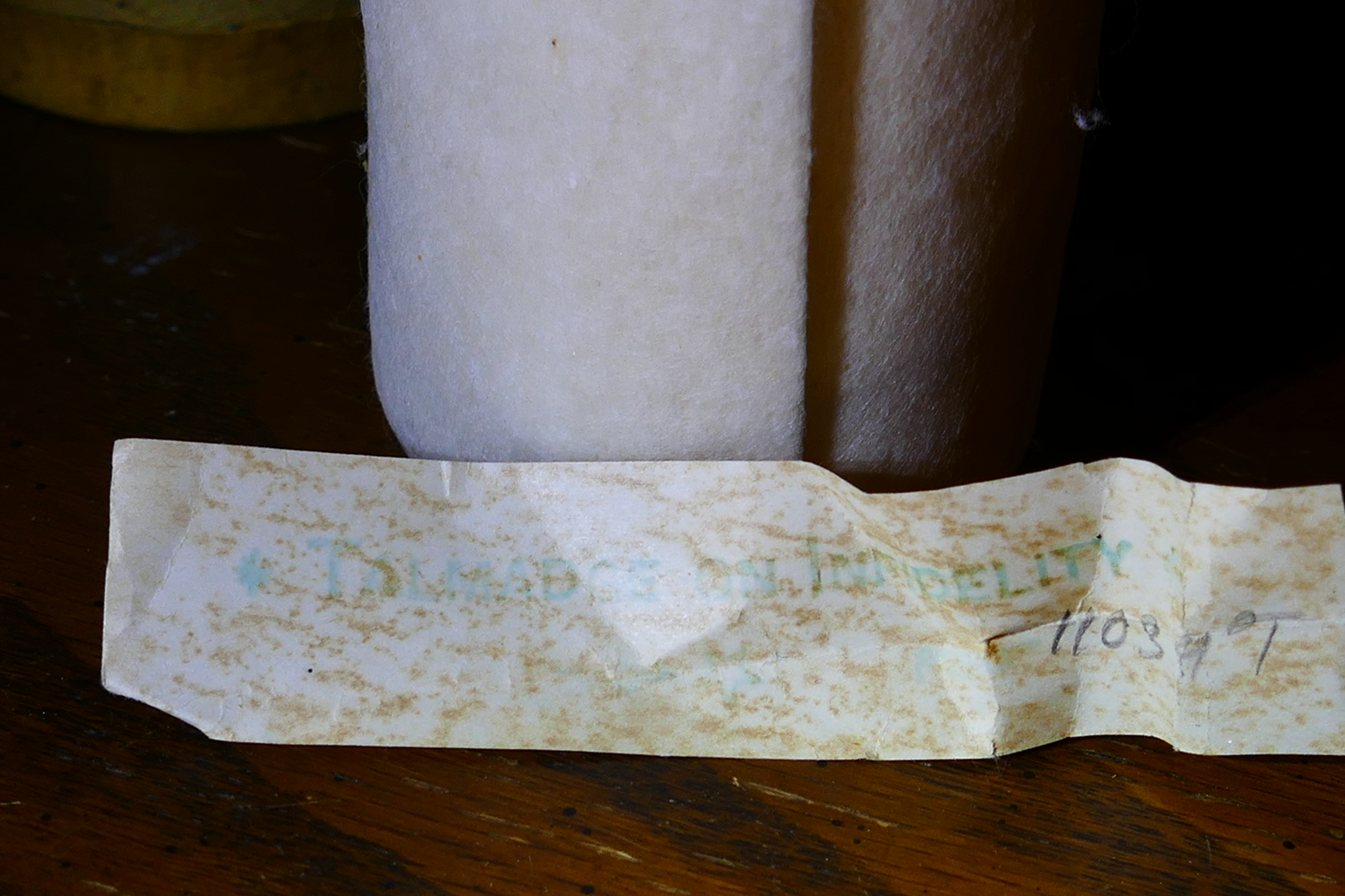

Most, maybe all, of the four cylinders in the cases appear never to have been opened. One had the cotton wadding wrapped in something like cellophane. There was also wadded up cellophane (?) in the case. (I didn't buy the case -- they were asking much, much more for it than they were for all the cylinders put together, and it wasn't anything special.) The case also had a lot of title slips in it -- many more than there were cylinders -- some printed, some handwritten. (See pictures.) I assume some of them go with the uncased cylinders I have.
The four in cases all had their wadding and original title slip. (Side note: If anyone has figured out how to successfully slide a wrapped cylinder back into its case, please let me know!) They are:

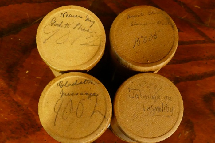

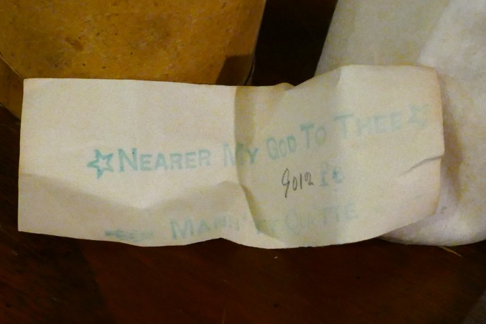

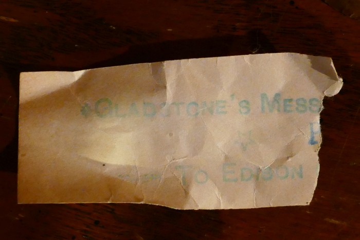

1. Anvil Chorus -- Columbia Phonograph Company of New York City
2. Nearer My God to Thee -- company not identified
3. Gladstone's Message to Edison -- no announcement
4. Talmage on Infidelity -- no announcement
I have so many questions about this find that I don't know where to start, or really what to ask. My first question would be: When were these made? Do recordings of any of them exist online somewhere? For that matter, is there a resource somewhere listing Columbia brown wax cylinders? Is anyone familiar with any of these particular records? Does anyone know if it was common for cylinders to be cased like this? That is, did dealerships often sell cylinders in plain cases with their name stamped on them, rather than a company (Edison, Columbia, etc.) label? Did these pre-date company labels? Did the dealership write the names on the lids, or the company, or the customers? If anyone out there has others like these -- either from Eastern Phonograph or another dealership -- I hope you will consider posting pictures. And if you should have an answer to a question I don't even know enough to ask (like the best way to preserve these, handle them, store them, listen to them, etc.), please share that, too.

There's a mention of the company in this 1996 article. Info may have been revised since then?
https://archive.org/details/V78J10/page/n41/mode/2up
Here's some discussion from an old threads.
viewtopic.php?t=31439
https://forum.antiquephono.org/topic/32 ... e-b-eagle/
A bit more from Tim Gracyk...
https://www.youtube.com/watch?v=gz7uaBfbOFY
"A catalog issued in 1898 by Columbia's New England headquarters--the Eastern Talking Machine Company at 17 Tremont Street, Boston..."

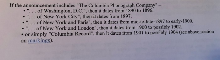

Re: Interesting brown wax cylinder finds raise questions
Here’s some information for dating the Columbia cylinders from the Tinfoil Resource Center.
Rich Gordon
Rich Gordon
52089
- Posts: 3836
I know of many recordings of McKinley's last public address before being shot, but this is the first I've heard of a recording of his inaugural address. Of course, McKinley himself never recorded anything; there records are all made by actors.
What you're describing as cellophane is almost certainly wax paper. Brown wax cylinders were first wrapped in cotton batting, then in wax paper. The wax paper made it much easier to slide the cylinder and cotton out of the box. Unfortunately, the wax paper was usually so thin it became torn quickly and was generally discarded. Some of the early Edison black wax records were also packaged this way.

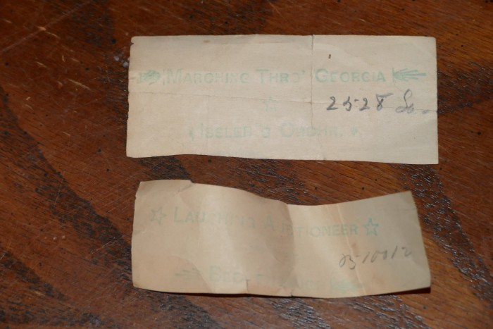

Thanks for the links, and the info! This is a real mystery to me, and every clue is very helpful. I played part of one of the broken cylinders -- it's in 3 pieces, but all are clean, with no missing chips -- and it's another Washington D.C., so I would really like to get that one "fixed," if at all possible. Other than Dr. K, are there other people out there doing this work? I hear he has a very long waiting list.
I remain surprised at how little info there is online about ETMCo., especially considering how much business they seem to have done, and how long they were in business. As these are the oldest cased cylinders I have ever come across, I'm also wondering if it was a common practice for jobbers to "brand" cylinders themselves like this. Does anyone have similar boxes from other jobbers?
