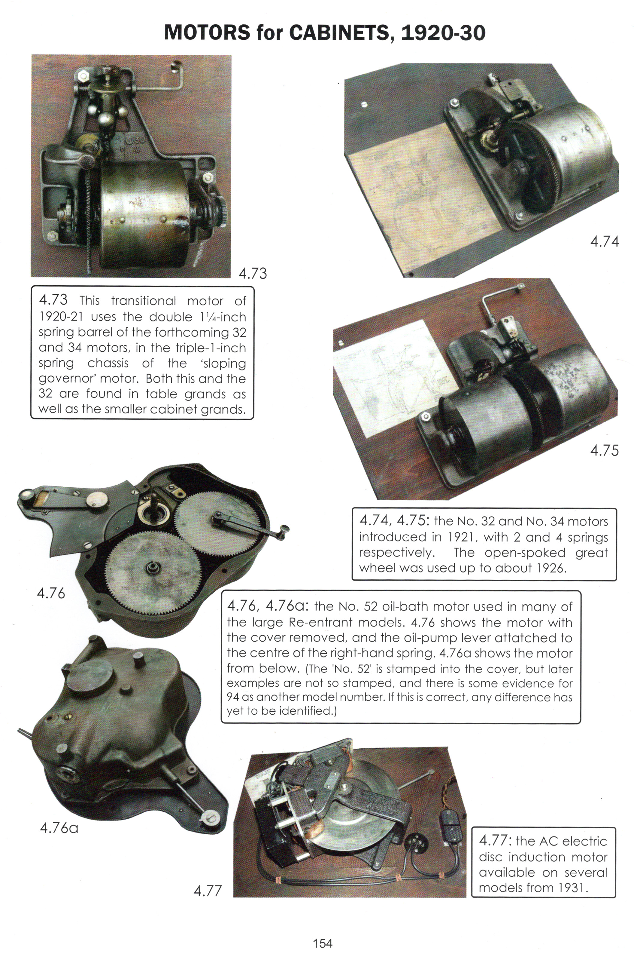

I have a friend who lives in Singapore and has an HMV 193 gramophone with a No 52 motor (sometimes referred as an oil bath motor). He is needing to service the motor and is seeking advice and if possible, a service manual. I have been able to provide him with an article in "For the Record" which is helpful but is seeking more information particularly on the type of oil and the depth it should be in the sump. Any help would be most appreciated. Thank you. Rodney
The attached is from His Master's Gramophone by Brian Oakley and Christopher Proudfoot
