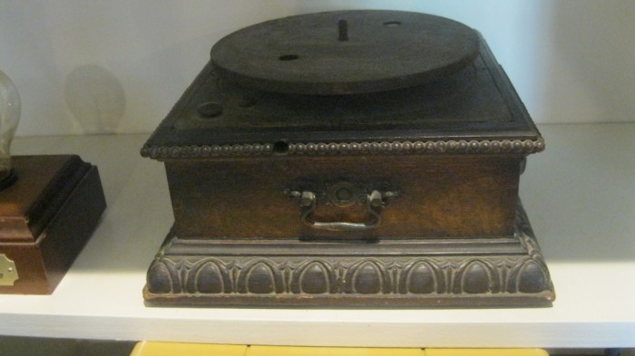

The title says it all. I have had this kicking around for decades, after pulling it out the trash as a kid. From what searching I've done, it appears to be a Columbia 'AJ' model, circa 1901, but that's a guess.
There are no markings, numbers or decals anywhere on the case. It is the vertical crank style.
Any help is appreciated, thanks.

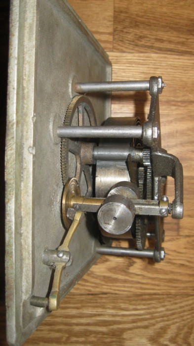

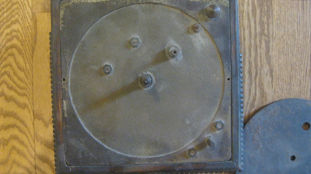

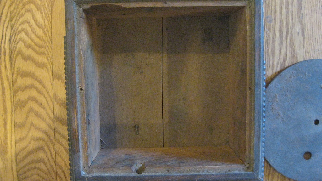

Here are some additional photos, thanks. What's interesting, the hole on the side which appears to be for a crank. Perhaps this case was switched at some point.

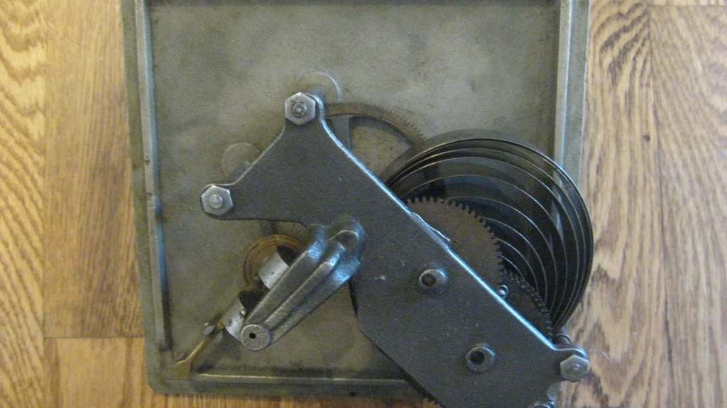

The crank goes through a hole in the turntable and connects to what looks like a dimple with the dot in the middle, north east of the spindle, in line with the speed control knob, in the downward view of the motor plate.
I think Mike was actually questioning why there is a redundant crank hole in the side of the wooden case, and whether The case may have been a replacement?
At least that's my take on it :?
I'm wondering if it is a crank hole, or if it's where a bracket for the travelling arm was attached?
Yes, you are correct sir. The crank is on the top side.
I have noticed those equipped with a functioning side crank, the hole is much larger in diameter, although the one on this case is roughly the same diameter as the top crank. Very curious.

Maybe the hole in the cabinet is a place to store the crank when not in use?
Even if this cabinet was from some other phonograph, the location of what might be a crank hole, would be way too high up on the case. The crank would be located almost directly beneath the top plate of the motor, allowing little to no room for any kind of winding gears or ratchets.
