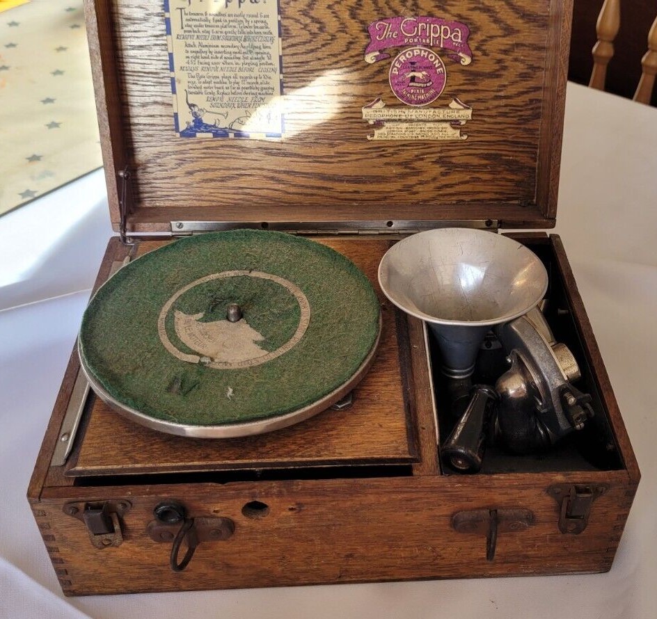

After breakfast I usually check my emails and saved eBay searches, most of which are gramophone related.

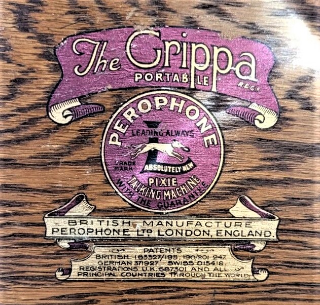

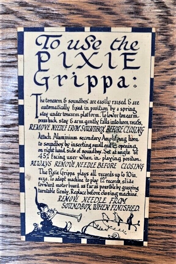

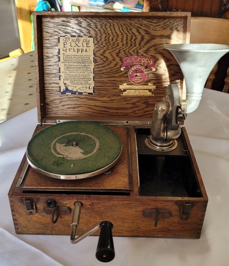

Yesterday morning up popped a Pixie Grippa on eBay just 30 minutes drive from my home. The all important auxiliary horn was present and the case appeared to be in good condition, including the lid transfers which are often damaged. The carrying handle, winding handle escutcheon and speed control knob were missing.
Portables form a large part of my machine collection and I had always wanted a Pixie Grippa, but more often than not the examples for sale lacked their auxiliary horns or were expensive. The starting price of this example was a modest £70 but I did not waste time bidding. Instead I hit the "Make Offer" button with £100 which was immediately accepted. I collected the machine the same afternoon and have already started work on it.
The pictures are from the eBay listing.

A very interesting design and well preserved.
Very good indeed.
Very good indeed.
- Orchorsol
- Posts: 1812
- Location: Dover, UK
Re: A Perophone Pixie Grippa.
Congratulations Roger, that's lovely. Please show us again when you've worked on it. I've always been attracted to these!
- Posts: 4648
It's a tiny marvel! Oh, and these instructions written in gothic lettering... Remind me of those Walt Disney films which start with a book reading a legend...

Very nice case. A great find and local!
In case you were unaware there should be a slotted recess at the rear of the motor board to house the winder and a needle tin.

Thank you for pointing this out. I had no idea that there was a part missing there.flying500 wrote: Sat Nov 05, 2022 5:07 am Very nice case. A great find and local!
If it is easily removable could you please post pictures to enable me to make one.

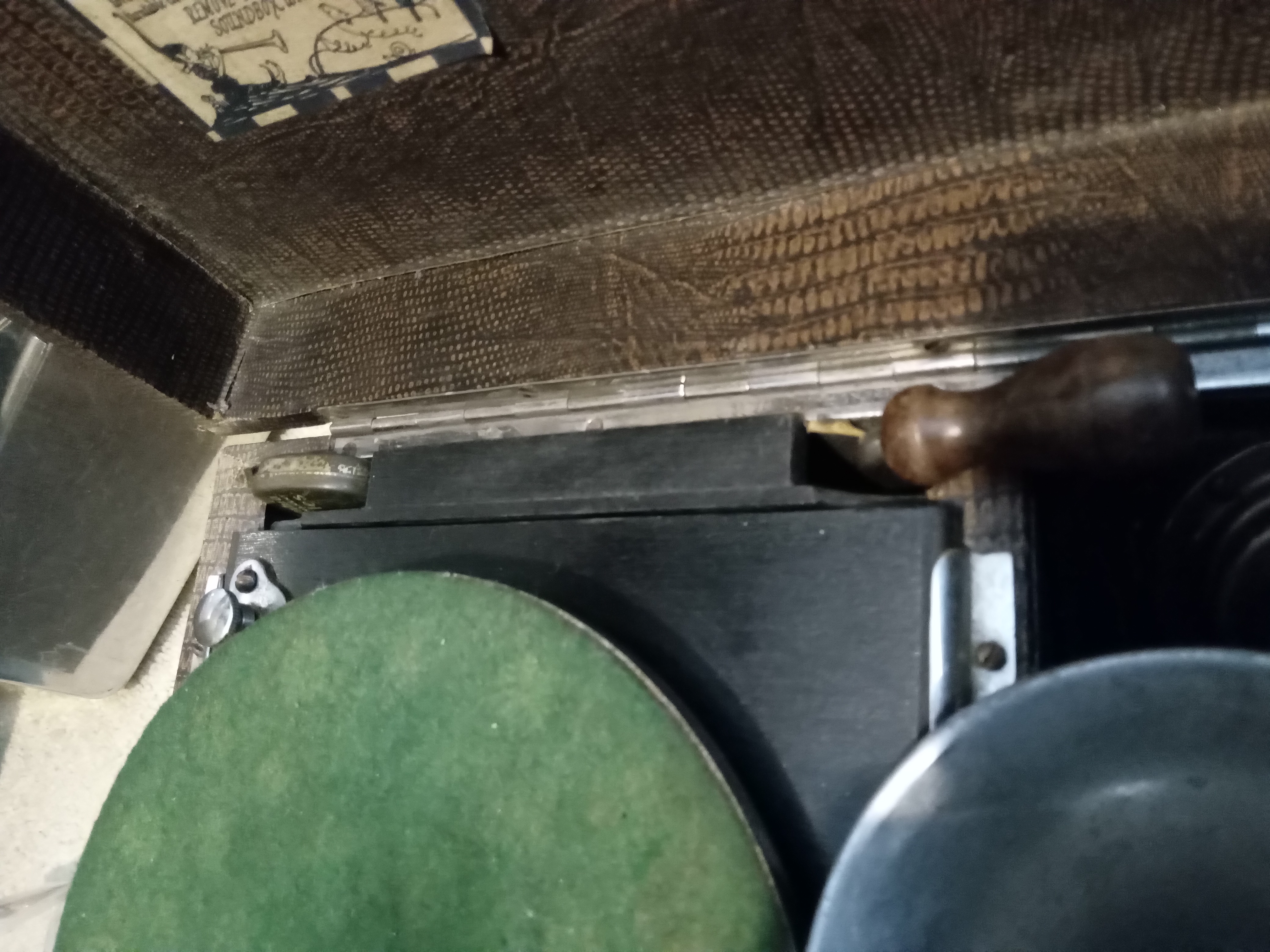

Of course I will.

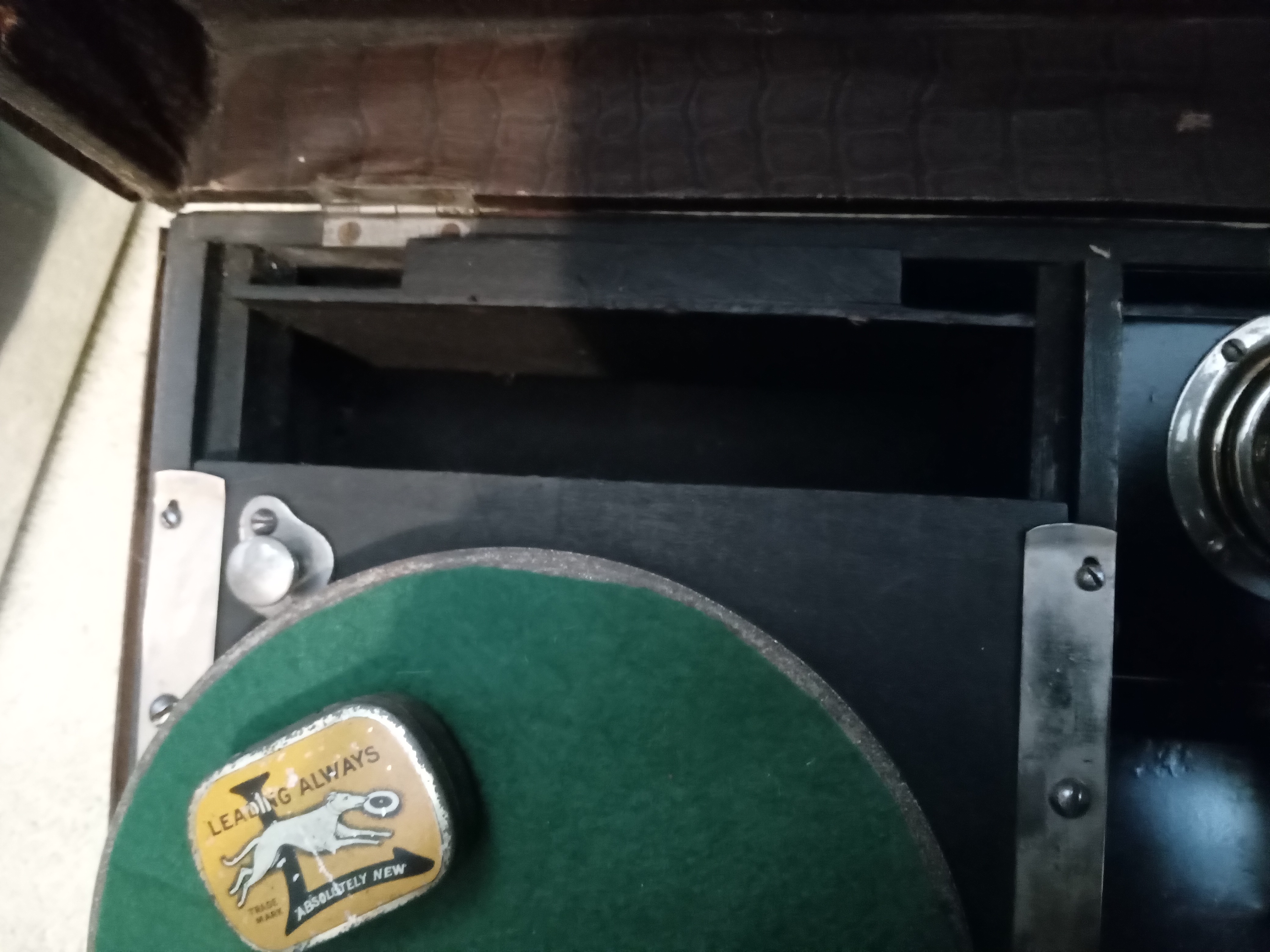

I attach a picture of the compartment and will post the dimensions later this afternoon.
Are you also aware that the motorbaors should slide forward to facilitate the playing of 12" records?

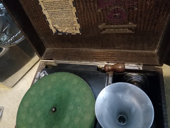

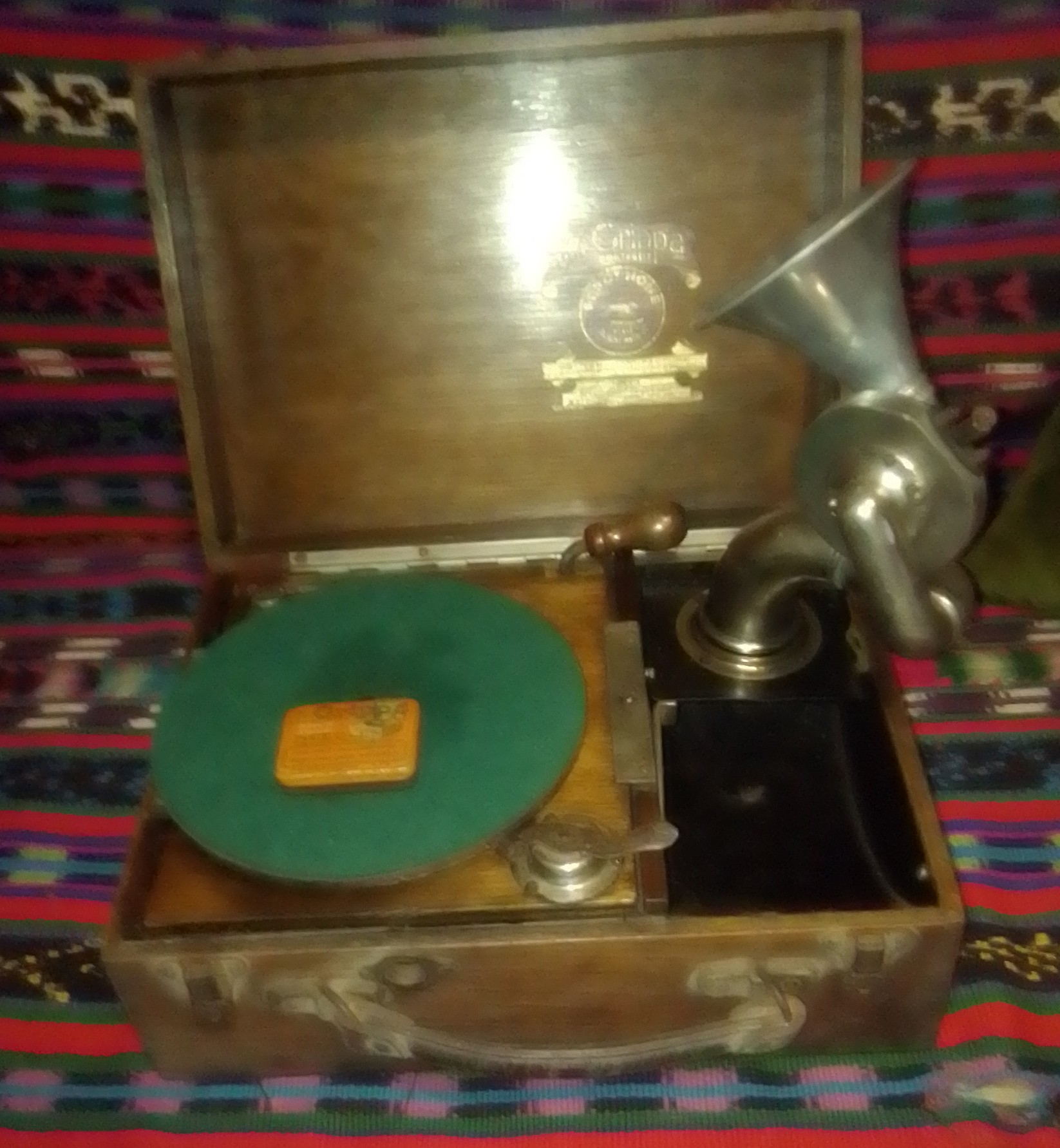

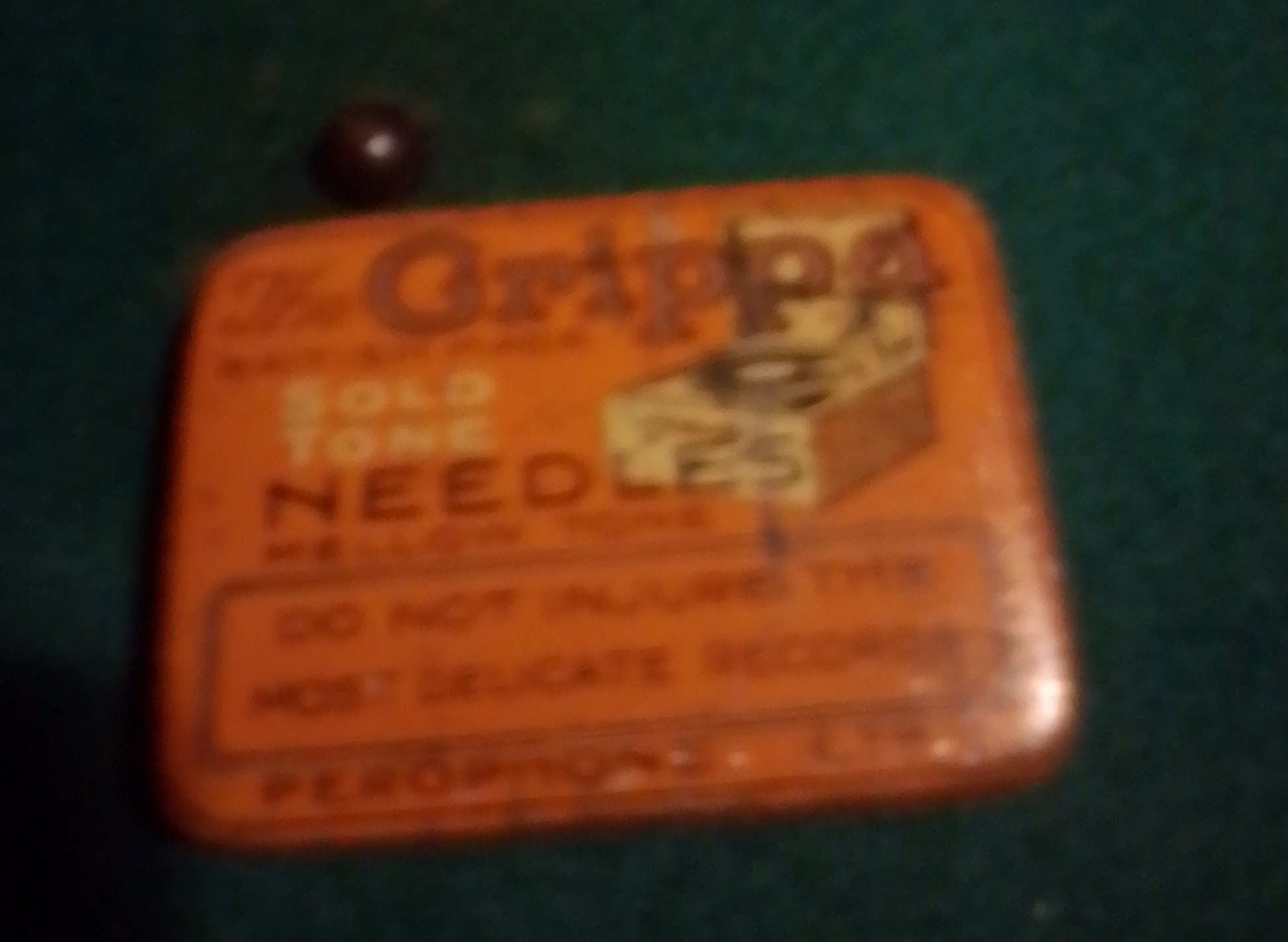

My Pixie Grippa is unfortunately missing the printed paper instructions in the lid.
I do however have a Perophone needle tin advertising "The Grippa" portable gramophone, containing solo tone needles mellow tone (what a mouthful).
The machine that is pictured looks similar to the Pixie except it has no auxiliary horn.
Does anyone know if there was a tin picturing "The Pixie Grippa"?
Please excuse the poor quality photos taken with my poor quality phone.

Roger, all that's missing is a piece of wood 3 ½ inches long. ½ in. wide and 1 ⅜ in deep. The gap at the left hand end (for the needle tin) in 1 ½ in, leaving 13/16 at the right hand end.
Mine doesn't have a brake on the motor board; it is combined with the speed control, like an Edison Gem. Maybe this was troublesome, and that's why yours has a separate brake, though I wonder how the speed is controlled!

PS just realised I was looking at the wrong picture - it is Gramophoneshane's that has a turntable brake, and a separate speed control on the motor board, so presumably a different motor. There were various finishes available; mine is covered in red lizard-skin cloth, many are brown, I think think there's a calf skin one, and I know there is a pink leather one.
