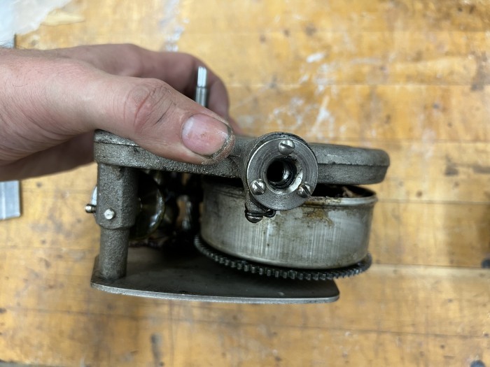

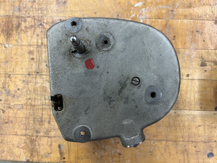

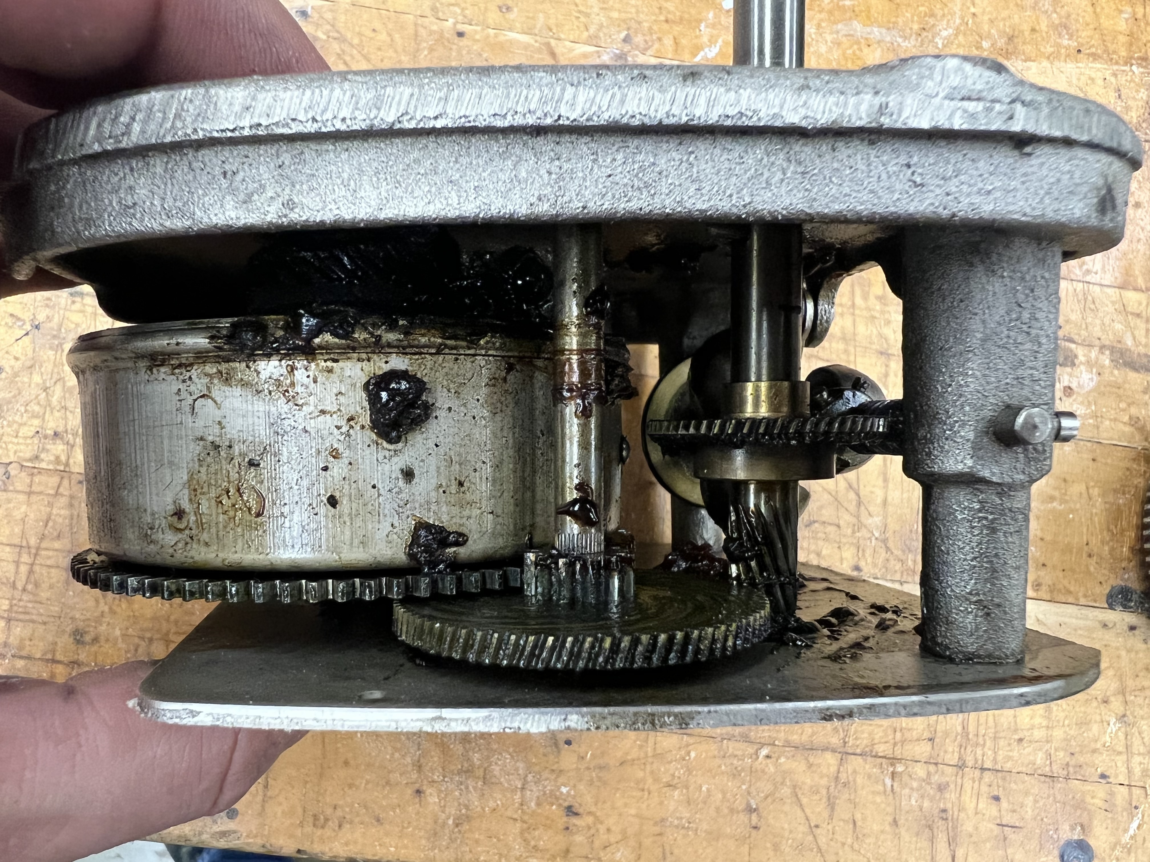

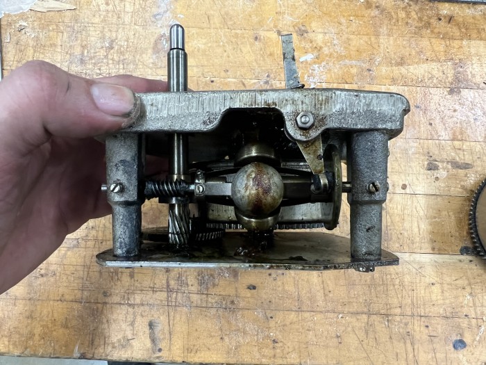

I am currently also working on documenting governor spring and weight sizes in the various motors I have in order to share that information with Brian Parlier from the Phonograph Shop. Today I took apart a columbia 202A portable to have a look at the motor. It fortunately has an identical spring barrel to the HMV 271-c motor, and since I am closer to done with the electrola, I'll be stealing the spring barrel for now. The motor for this machine is unlabeled, but it is mostly identical, other than having a horizontal crank rather than sticking out at an angle as they do on the HMV machines. I took a bunch of pictures, which I will post for posterity later. The columbia motor has a cast iron frame, which to me is a nice touch, despite the extra weight it adds to a portable.

Re: Electrola/HMV 102 springs - motor 271-C
Some pictures of the Columbia 202 motor, which is for all intents and purposes identical to the HMV 271-c… except for the winding crank angle.
