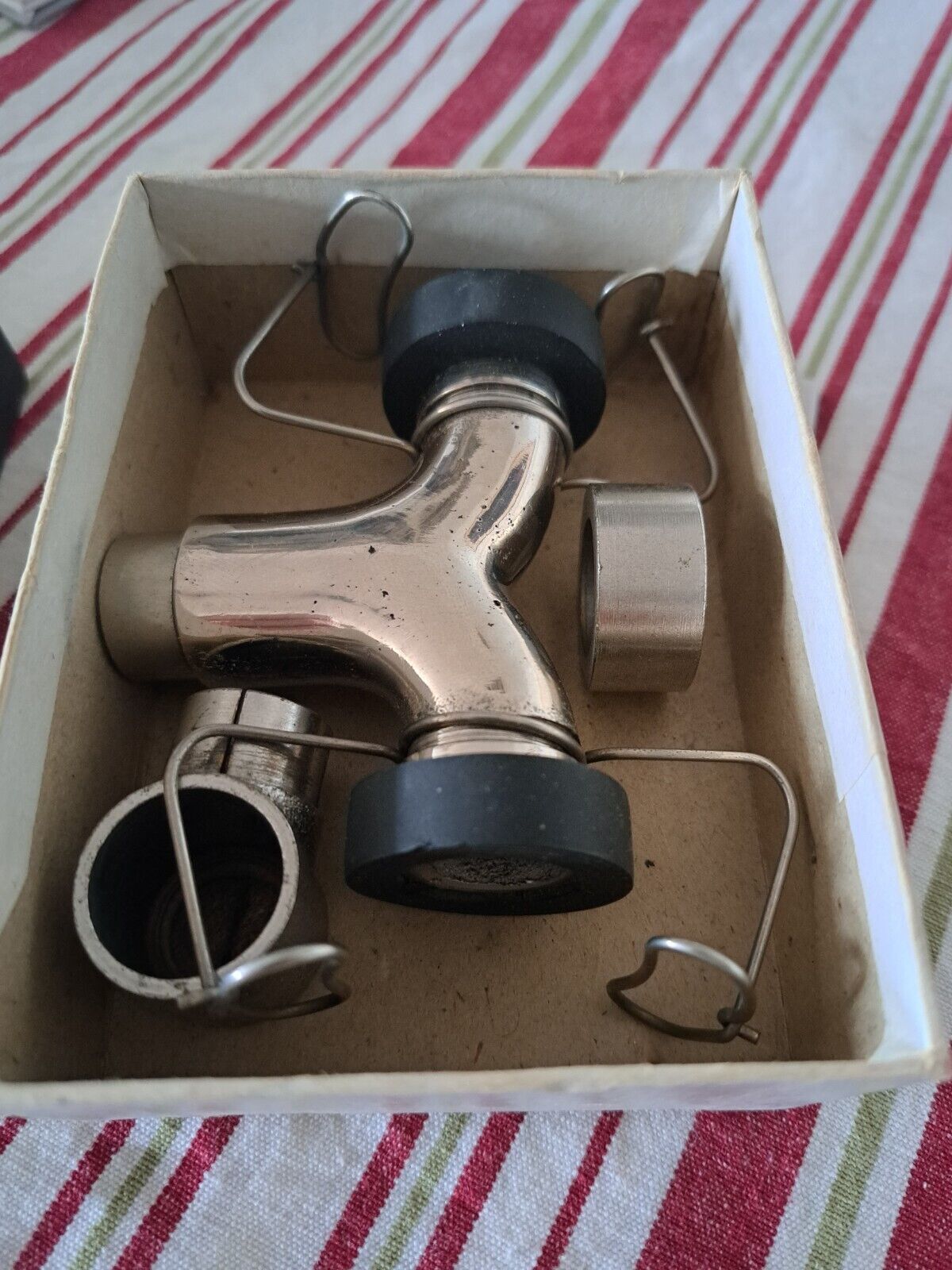

So, what is it ?

Isn't it to put a set of radio headphones on so they can be amplified through a horn? I'm pretty sure that's what it's meant for.
