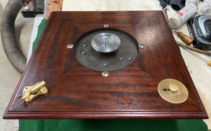

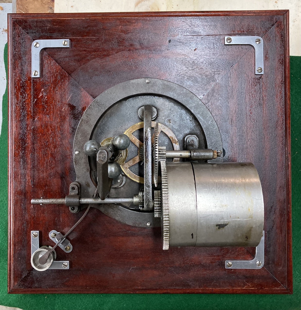

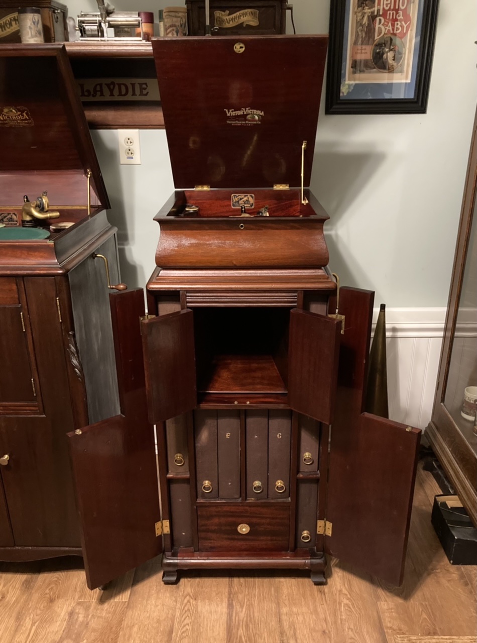

With a motor transplanted from a Victor D, the liquor cabinet is a phonograph again, The motor came from Craigslist in CA, (thanks CharliePhono for setting me up). The bell of the horn came from Jerry B.
I made the back third of the horn, machined a new spindle and parts to convert the Victor D motor to a yielding turntable, serviced the motor, made the motor board from the remains of an old table, (the hardware, dimensions and edge profile of the motor board were copied from Skihawx’s Pooley VTLA, (thanks Jeff). The dimensions and joinery for the drawer were also copied from Skihawx’s machine. Thanks to John Duffy and Jerry B for advice and encouragement.
I guess that’s about it. The picture of the motor board was taken prior the the addition of the rubber bumpers. Some may consider it a Frankenphone. I would have preferred to use all original parts, but that wasn’t likely to happen. It’s not all original, but I think that it will have to be close enough for now. It sounds good and plays well, so I am happy.

The pictures of the motor board are under fluorescent lighting, so it is a bit harsh. I had a difficult time getting the color and finish right, (four attempts). They didn’t grain fill the motor boards and the underside generally has minimal finish. The metal corner pieces position the motor board in the cabinet and are copies of an original.
