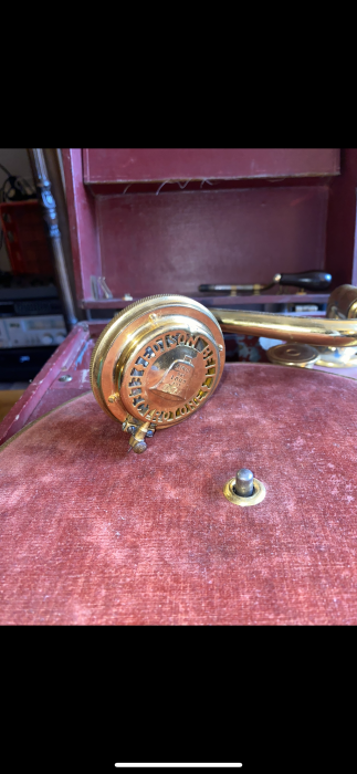

Edison Bell reproducer
I saw this on ebay and was wondering what kind of reproducer this is and what it could be used on since its only the reproducer. Thanks
tomb
- Posts: 1426
- Joined: Sat Oct 24, 2015 10:46 pm
- Location: riverside calif
Re: Edison Bell reproducer
That looks similar to one I saw on a Edison crank disc portable. Tom
gramophoneshane
- Posts: 3463
I think it's pretty obviously an "Electrotone" soundbox by Edison Bell.
AFAIK they were used on not only portables, but the whole range of EB models made during the late 20's electrical recording era, including those with a Saxophonic horn.
I'm fairly certain they were also available separately as an upgrade soundbox for older machines with the standard size bayonet fitting type soundbox, such as the Exhibition, No.2 & 4 etc..
BigC
- Posts: 279
- Joined: Sat Apr 24, 2021 2:13 pm
- Location: Blythe California
Thank you. I thought it was a very interesting piece for a Edison phonograph but didn't know if it would fit anything else. There are so many reproducers out there that someday I would like to make a shadowbox to display some in my studio.

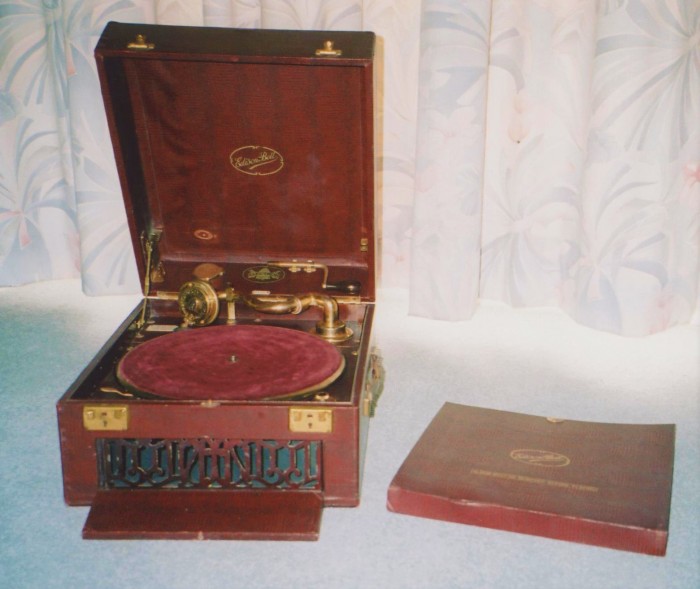

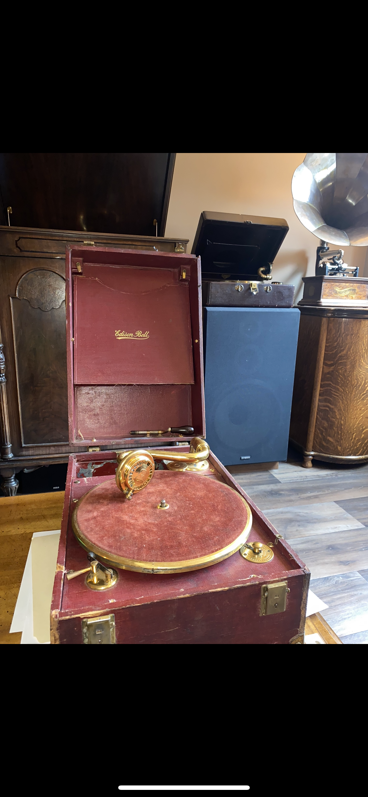

- dzavracky
- Posts: 1623
- Location: Washington DC
Here’s one of phonographs this goes to:
viewtopic.php?f=2&t=52376&hilit=edison+bell
Here's another video of it: https://youtu.be/NdMzJ82tpcA
I believe that Edison Bell made a larger portable. I will have to look around and see if I can find the photo. As a side note, I do have the mesh cover for the inside of the reproducer. It is removed because it causes the reproducer to buzz.
EDIT: found the photo. Here is a photo epigramophone posted on the original thread regarding my machine.
Cheers,
David
Cheers,
David
BigC
- Posts: 279
Wow that looks like a very elegant machine for a portable. How does it sound now that the wire mesh is gone. If i get this im going to see how it sounds and maybe Wyatt Markus can check it out and make sure its 100 percent ready to use. Can't wait.
- dzavracky
- Posts: 1623
I tried to put this reproducer on my credenza and the fitting is slightly smaller than the exhibition..so it didn't fit. I am not sure if it would be possible to modifiy it to fit a victor back flange size.gramophoneshane wrote: Thu Dec 08, 2022 1:04 am I'm fairly certain they were also available separately as an upgrade soundbox for older machines with the standard size bayonet fitting type soundbox, such as the Exhibition, No.2 & 4 etc..
David
gramophoneshane
- Posts: 3463
That surprises me because they were supposed to fit a standard bayonet fitting.
Then again, didn't the Credenza have an Orthophonic soundbox, so an Exhibition wouldn't fit anyway?
