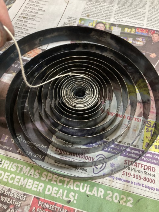

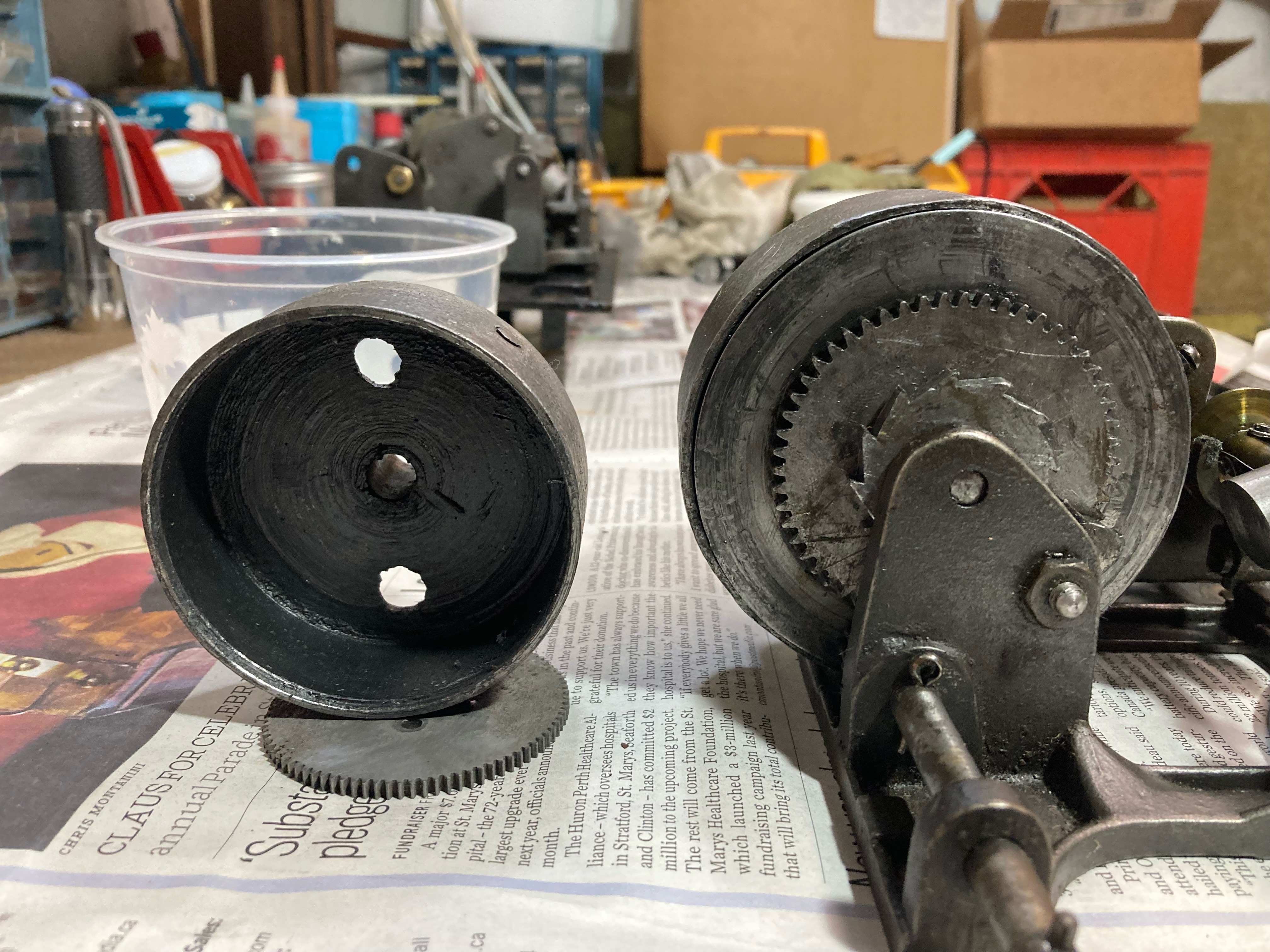

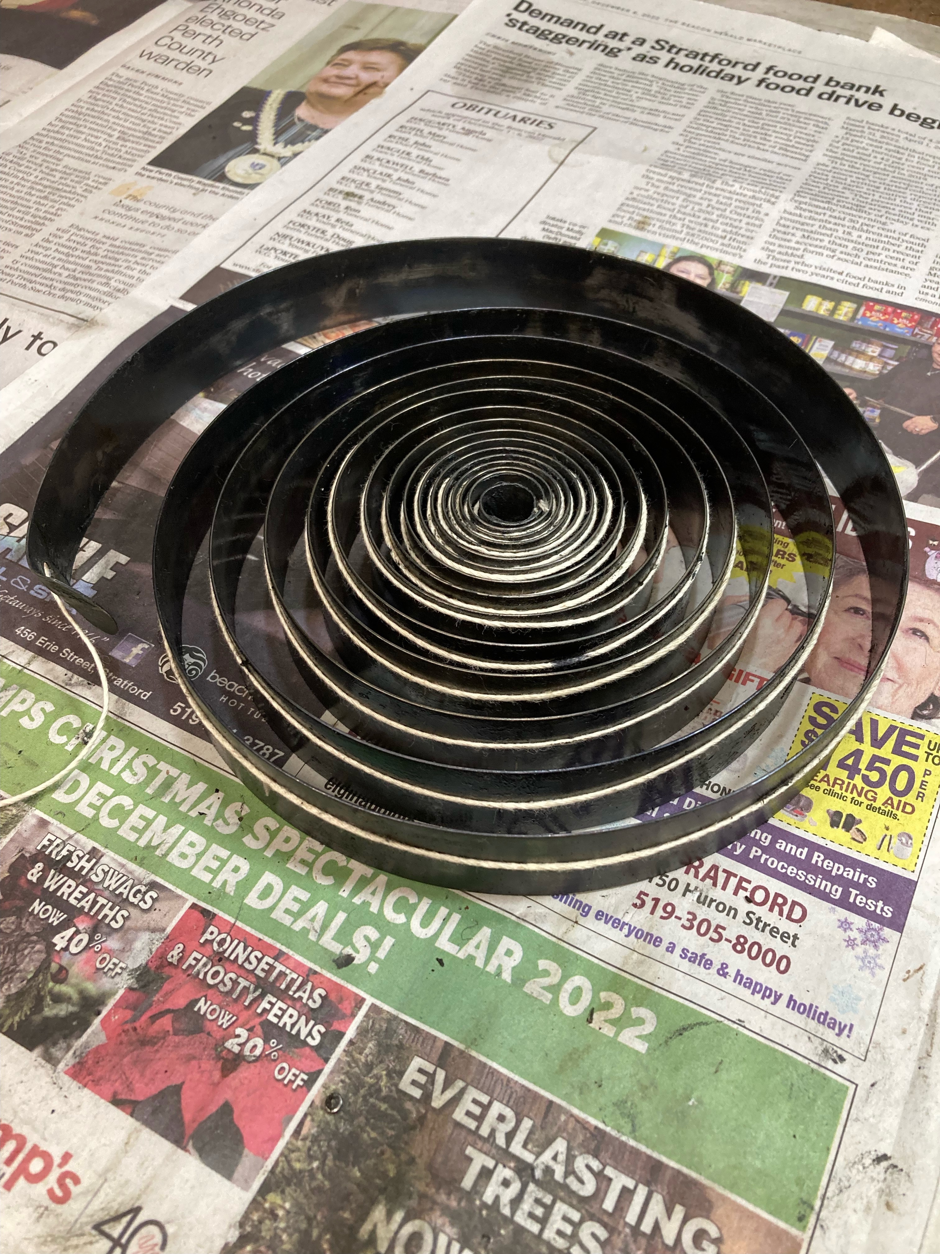

I managed to get my hands on a virgin early suitcase Standard model that was only 500 serial numbers younger then the machine I am working on. The belt disintegrated but I removed the spring and discovered that the main spring was 10 ft. long, 1 in. wide and .027 gauge. The spring barrel was full, and the cover plate on the spring barrel was extended past the edge off the spring barrel but it all fit and ran.
I had an old Edison spring that was 11 ft, 1 in, .027 gauge, so I cut 1 foot off, made a new hole and it went in the spring barrel very nicely. The machine seems to be running properly now, even with 3 nibs only for the teeth on the gears.
I have more work to complete before I can run a cylinder but I think we might have this machine almost fixed.

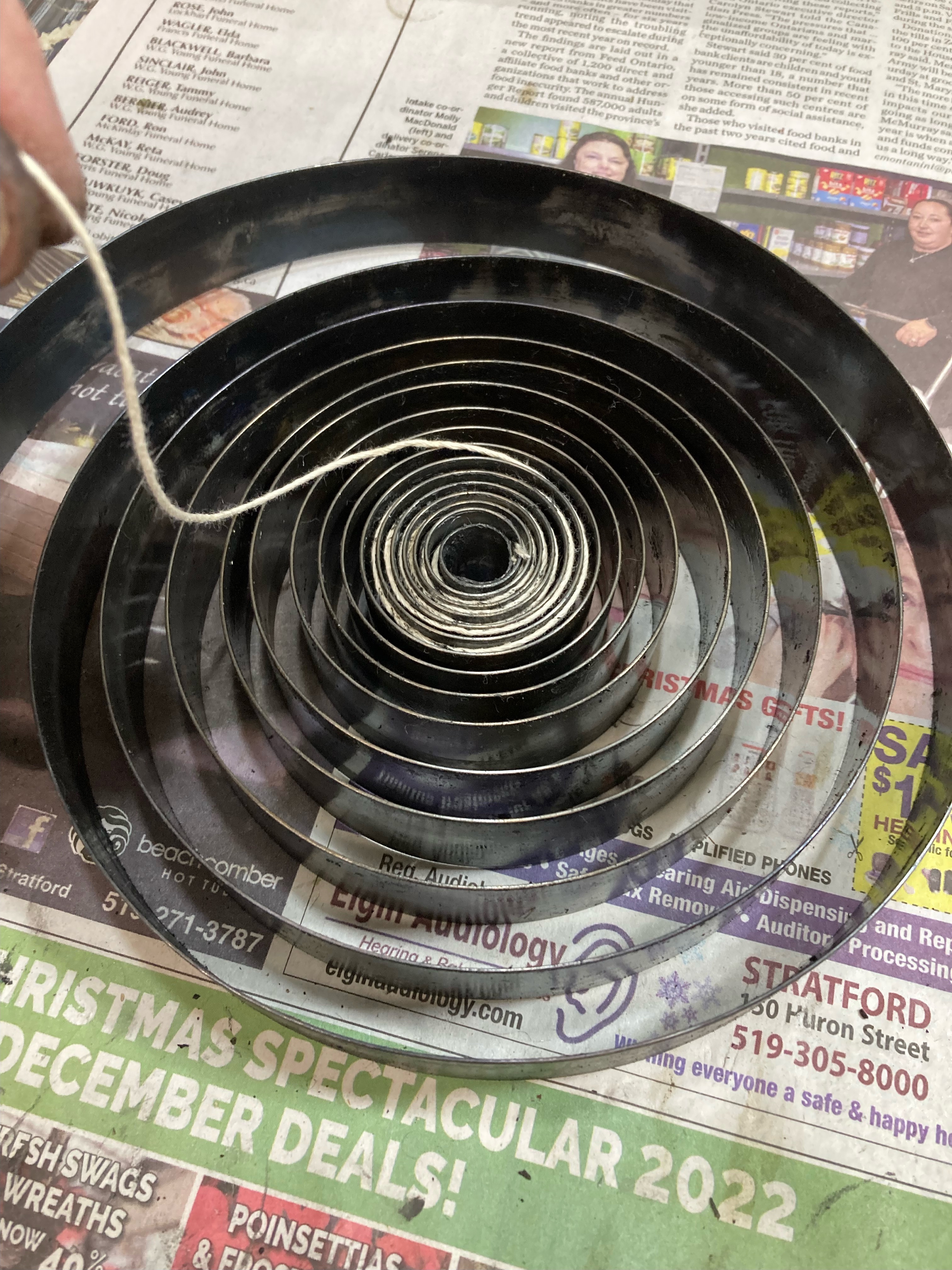

Thanks to Darren Wallace, I included some pictures of how to measure a main spring by using a string.
Jerry, thanks for your advice and help.
Blain

Blain, thank you very much for sharing the string method to measure a mainspring. I've tried with a measuring tape before, but that didn't work well. Will try the string next time. Glad you got your spring problem solved.
Happy New Year!
Andreas
Happy New Year!
Andreas
- Phono-Phan
- Posts: 2908
- Location: Plover, WI
Re: Edison Standard early Suitcase model
Nice idea to use a string to measure the spring length. I will have to remember that.

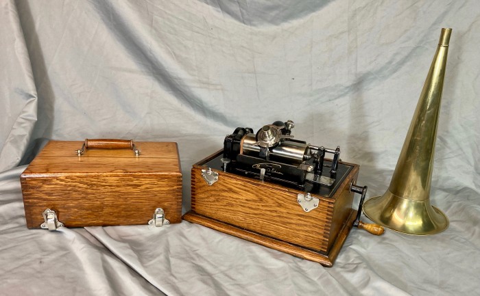

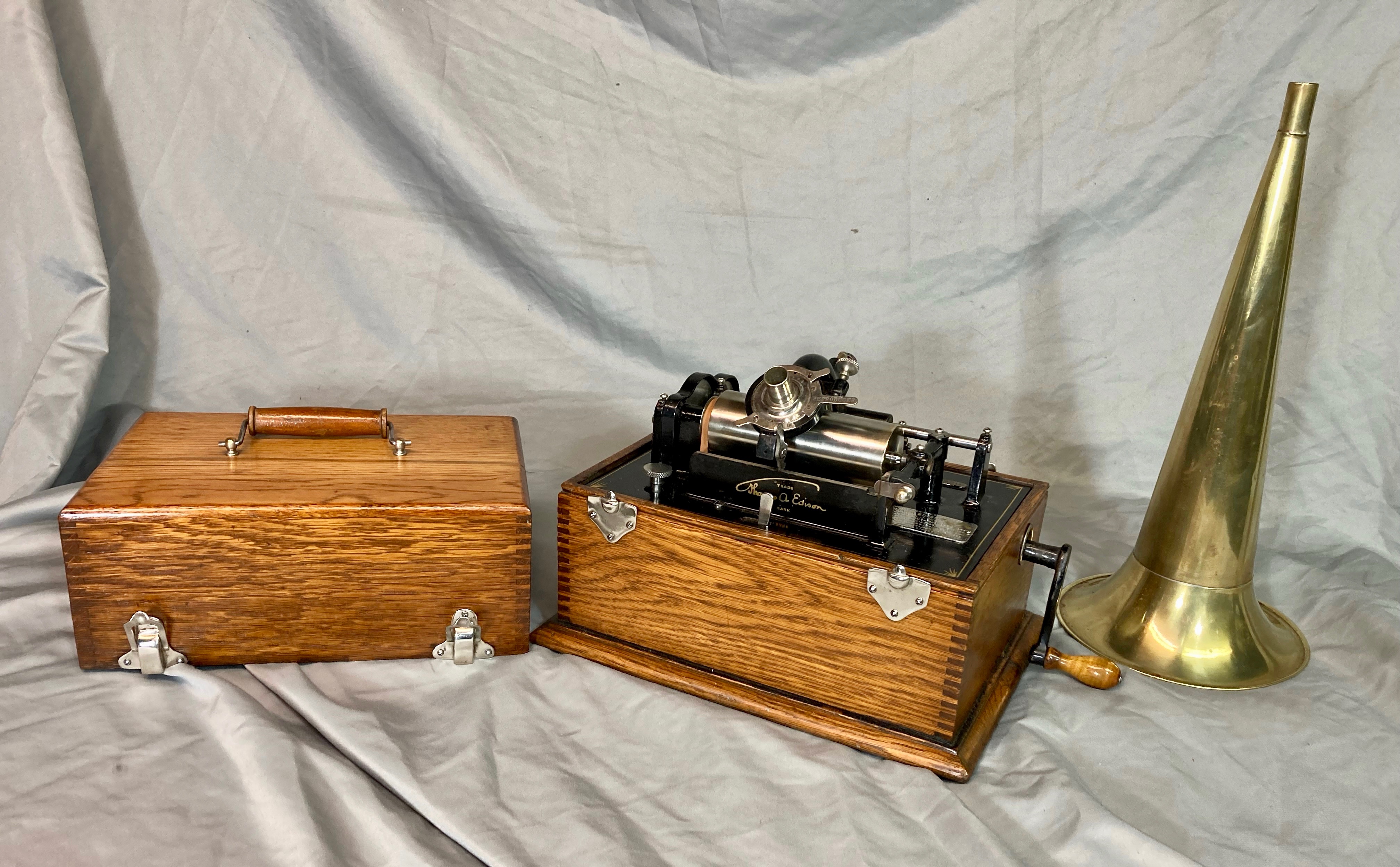

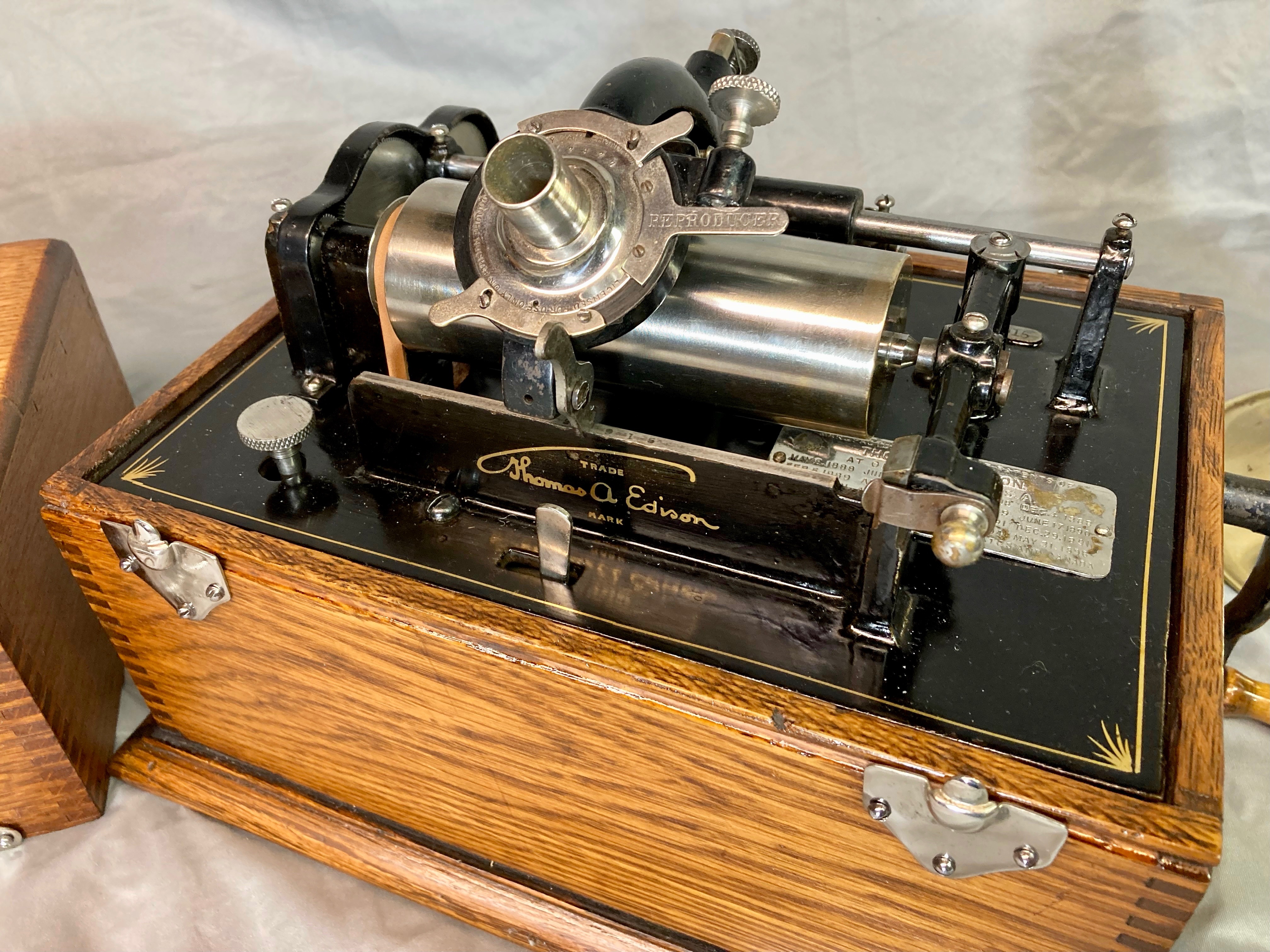

Completed and I just wanted to thank all the people that gave me advice, helped me with parts or technical support.
It was a challenge for me and I was happy to learn from it. I could not have done this without the support of friends and the Talking Forum community.
Thanks again,
Blain
Thanks again,
Blain
- Posts: 6899
Wow! That's beautiful! Nice work!
