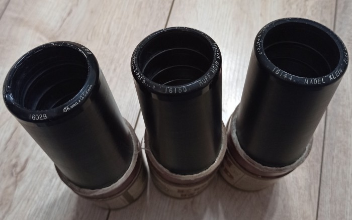

Hello,

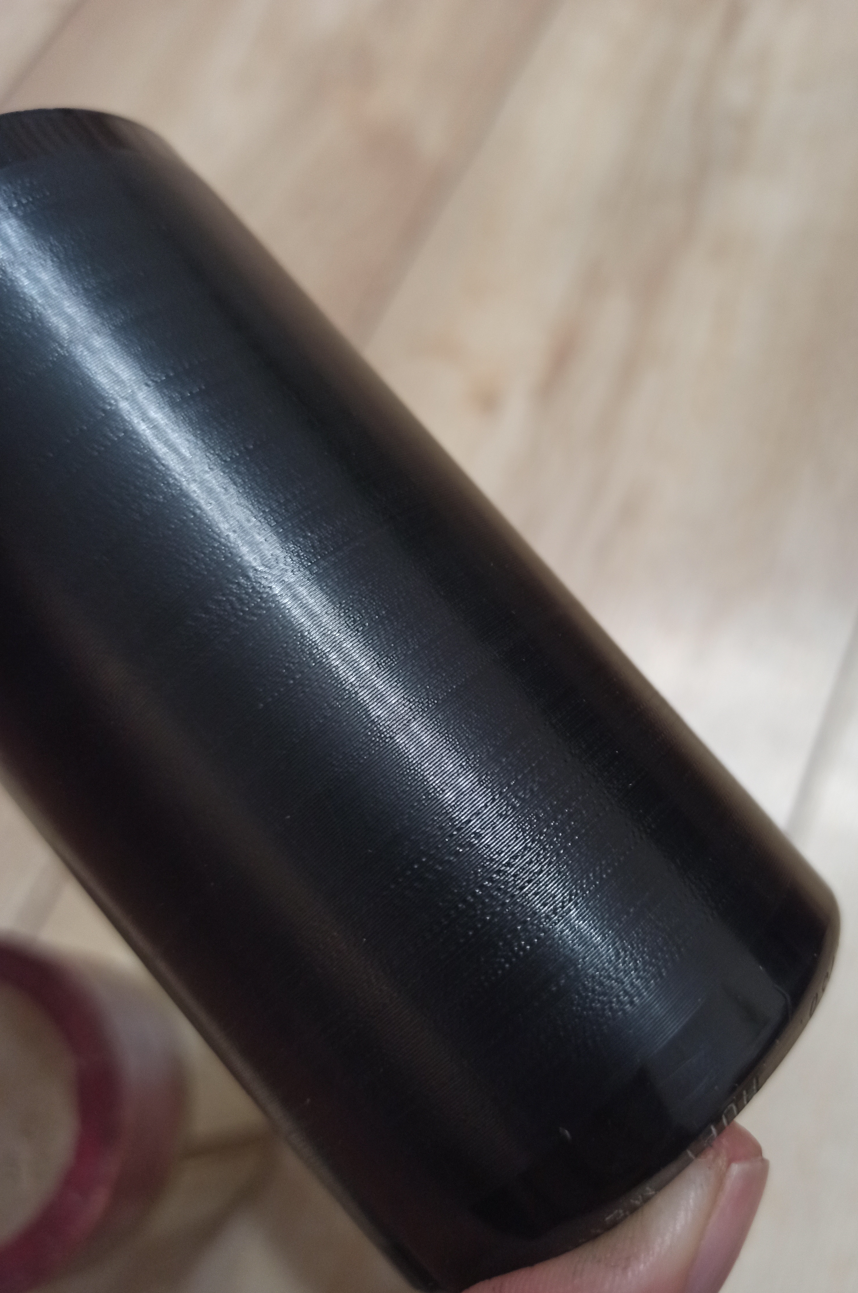

I recently noticed that a few late-production 2 min. cylinders have a different "wax" compared to standard gold moulded cylinders.
They are distinguished by a greater mass, a very shiny and smooth surface and are very hard, not resistant to chipping.
The recordings are also completely different - they are very loud and no longer have introductions.
Surely if I didn't know I would say it's a black Amberol but they are 2 minute !
Is it possible that edison in the last years of production produced 2 minute cylinders from amberol wax?

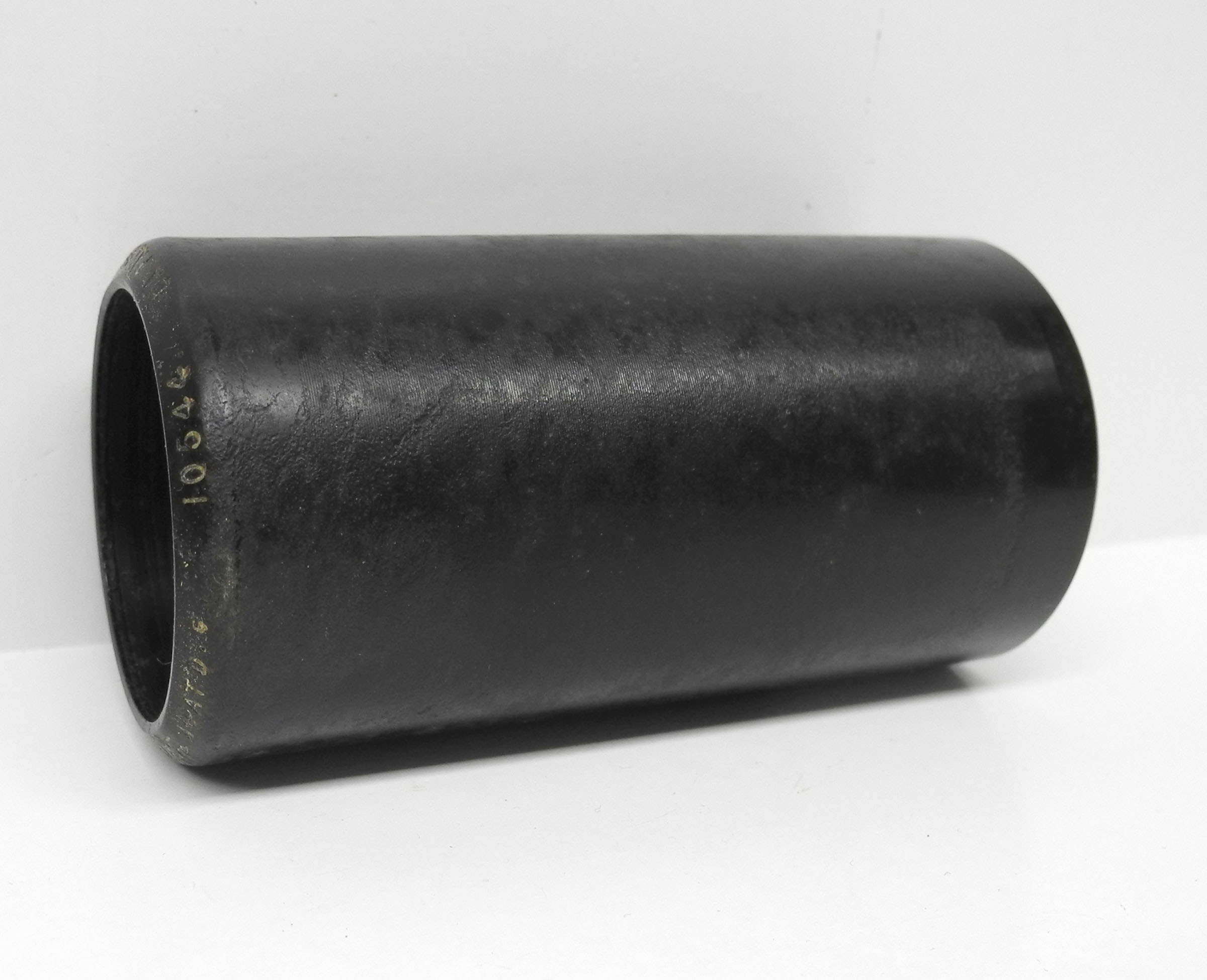

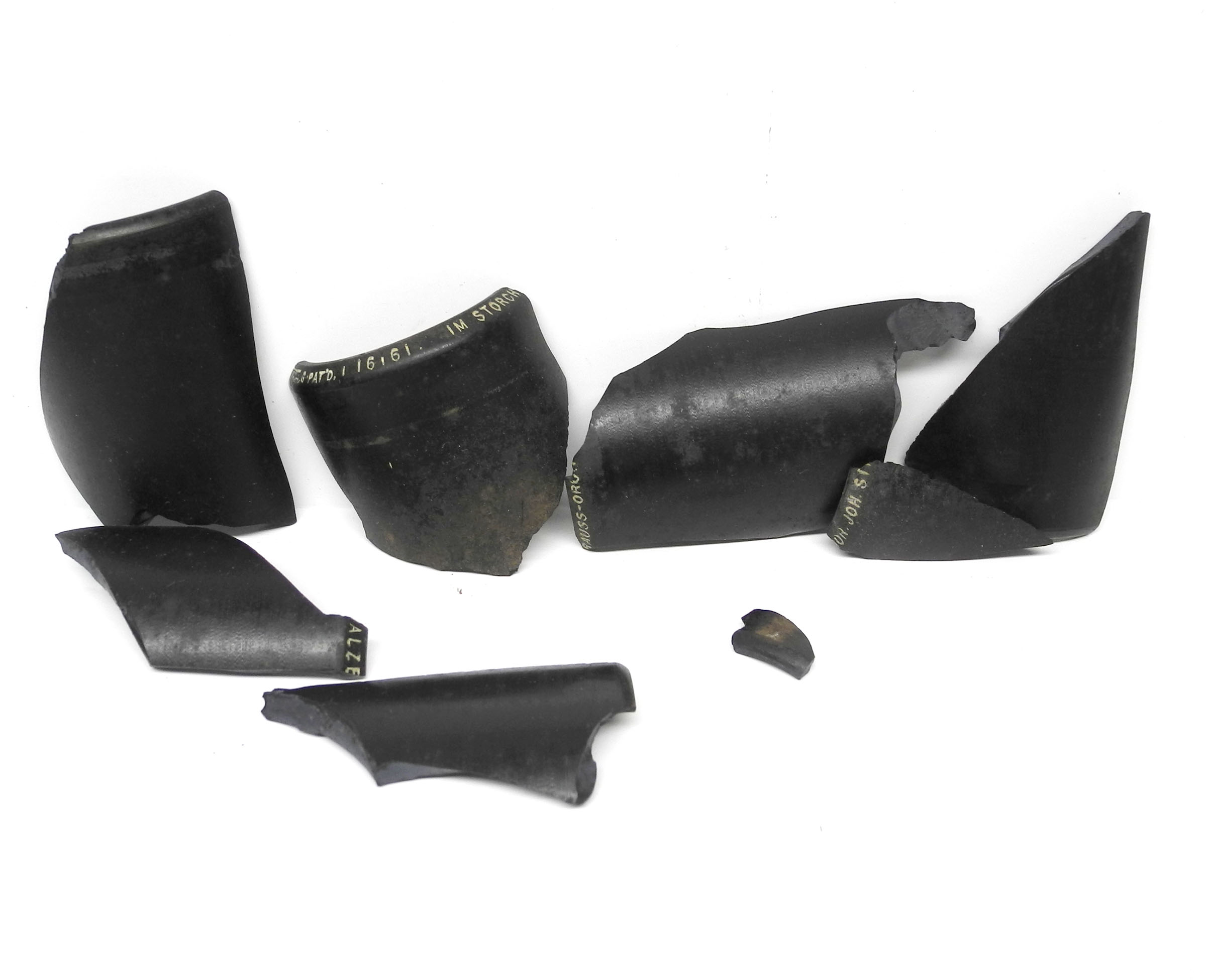

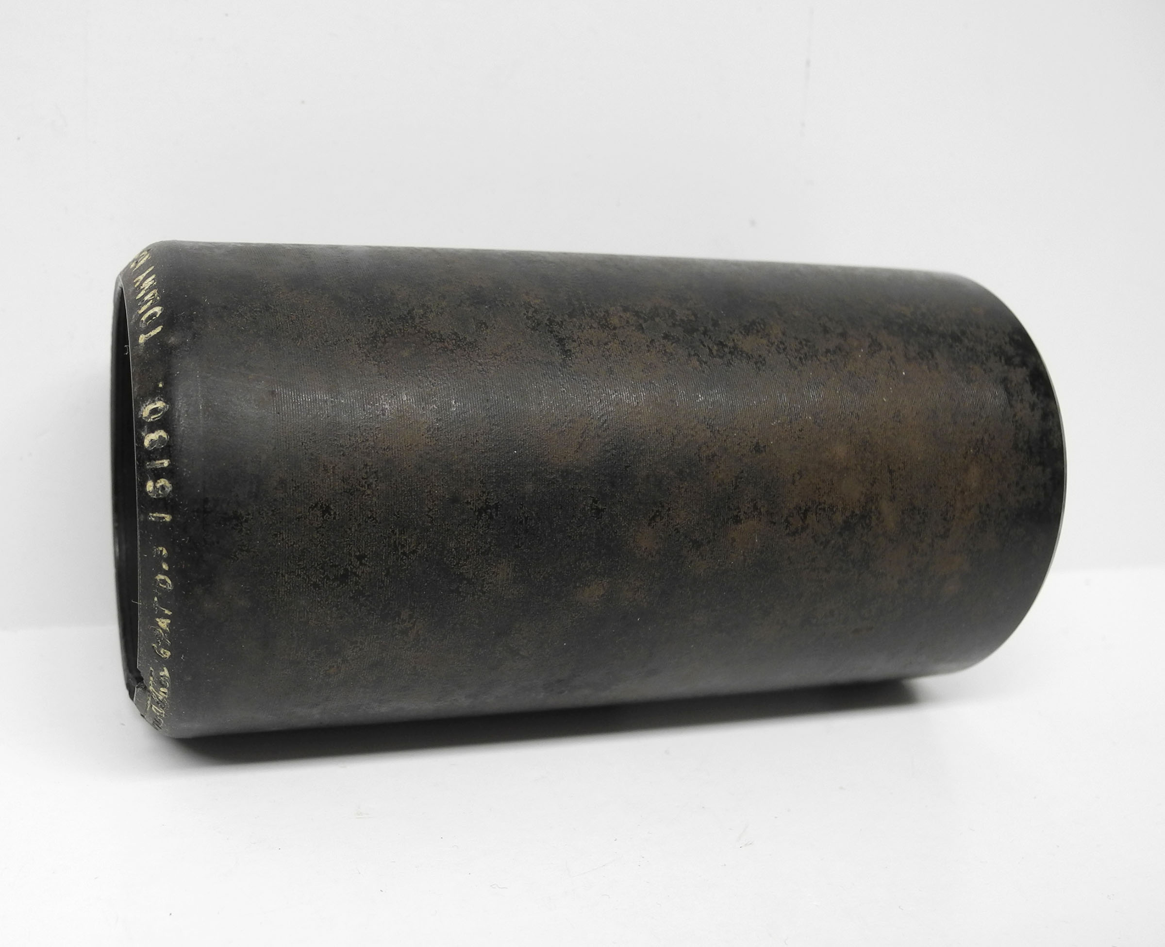

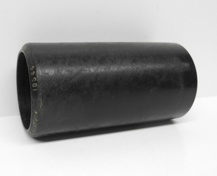

I discussed this topic with "kropton" directly some days ago. Actually I can't confirm that late Edison black wax are more susceptible to mold than earlier ones. Attached are photos of some examples of moldy very late American and German ones.
