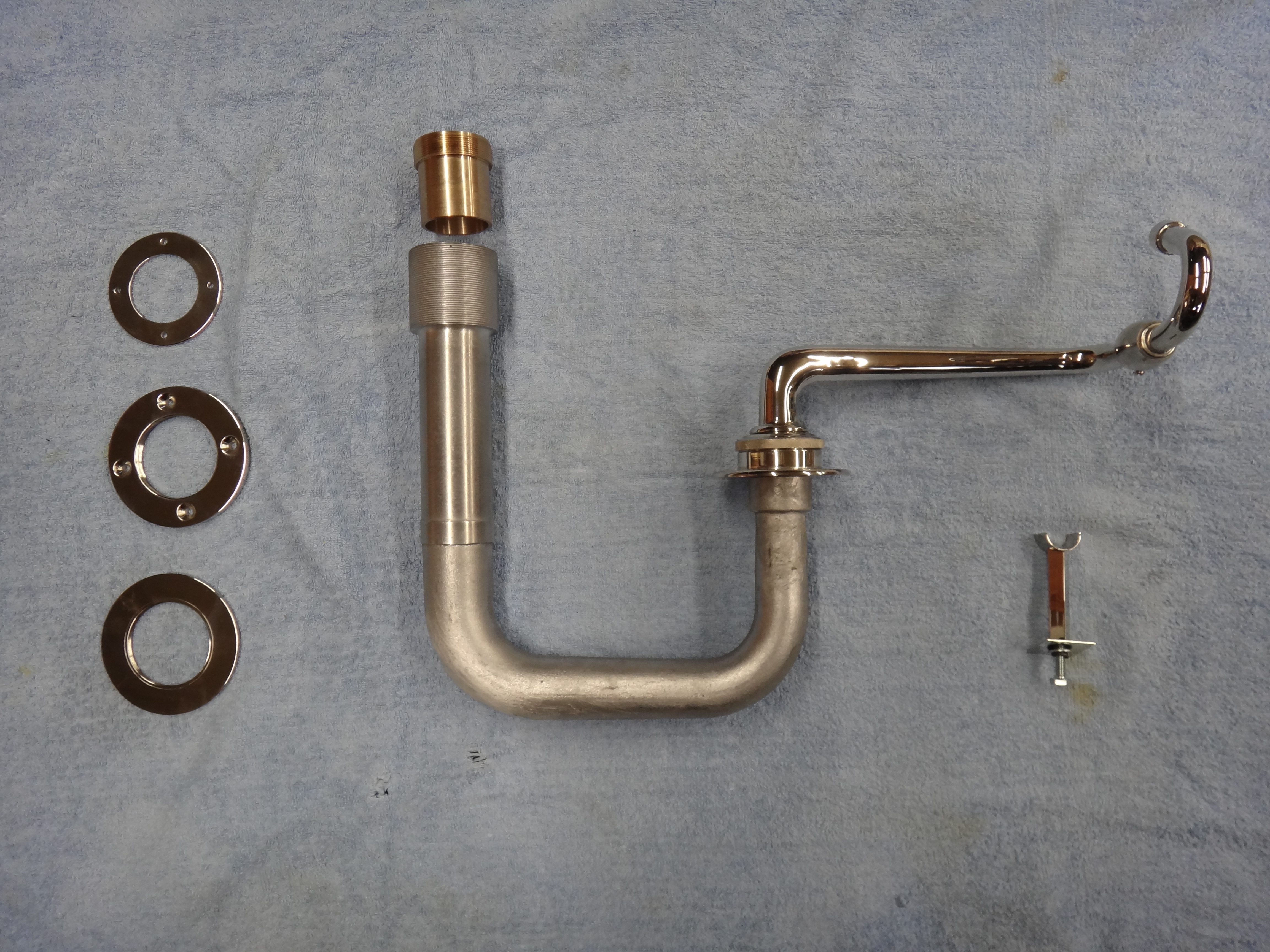

Maintenance of the position of the core and therefore wall-thickness was the main concern, thus the first sand casting was sacrificially drilled in several places to prove requirements. Machining was the next phase which, again, was tricky in view of the awkward shapes involved. Silver-soldered additions of previously machined items could then be made to both ends of the arm. The swinging section of the swan-neck was made and bent in copper tube with brass additions at both ends. It is worth noting that cast brass/bronze was not used for these items so as to allow flexibility of fine-tuning when setting individual “offset” of the finished item---prior to nickel plating. This is absolutely vital for accurate tracking purposes. A jig had to be made to achieve this.

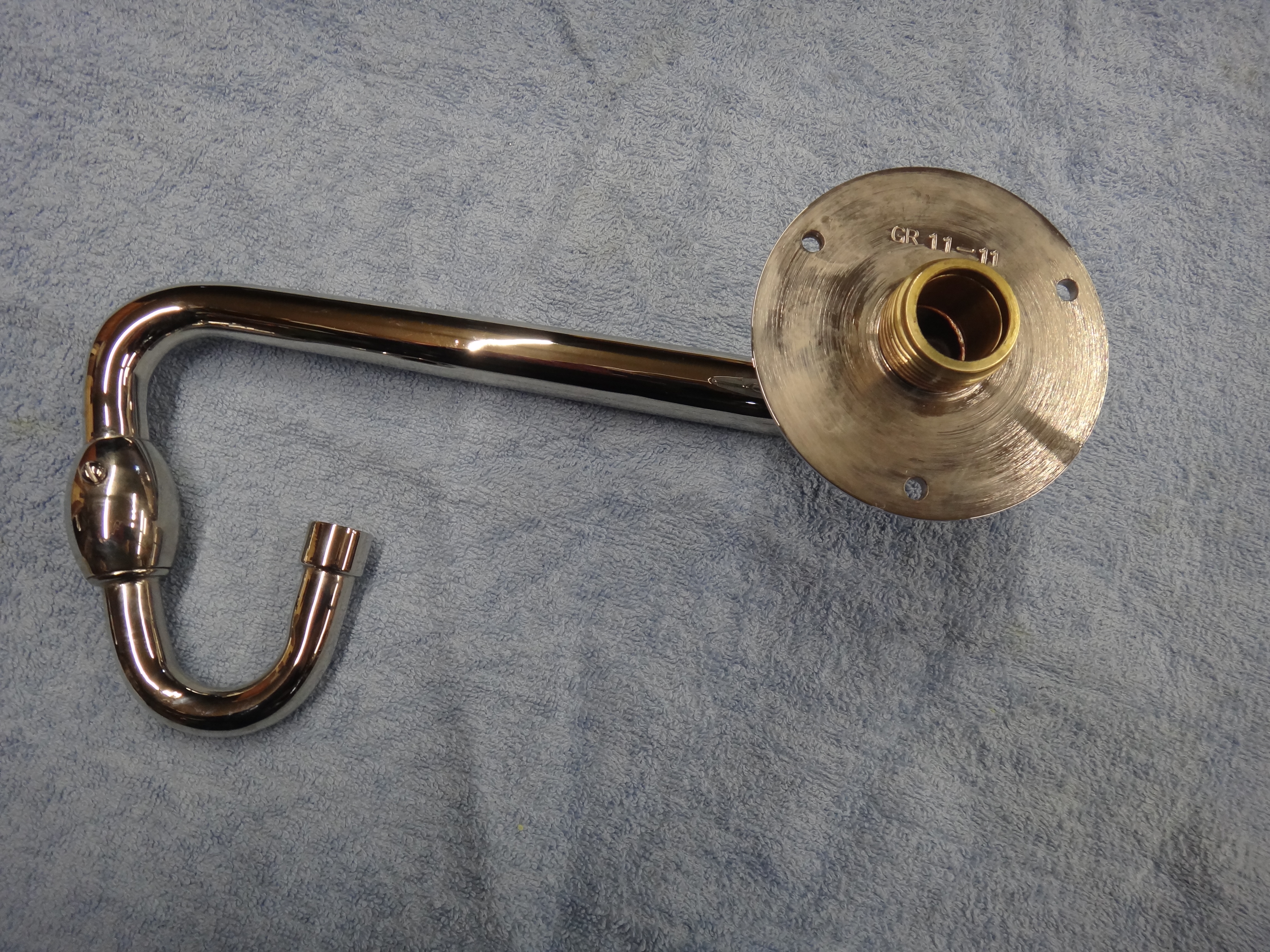

Machining of the bearing housing complete with knurling and threaded section to allow connection to the conduit was relatively straightforward. I am always at pains to avoid plagiarism and have thus stamped my initials and the production number out of eleven which can be seen on the underside of the bearing flange to avoid confusion for posterity---see photo No.5.

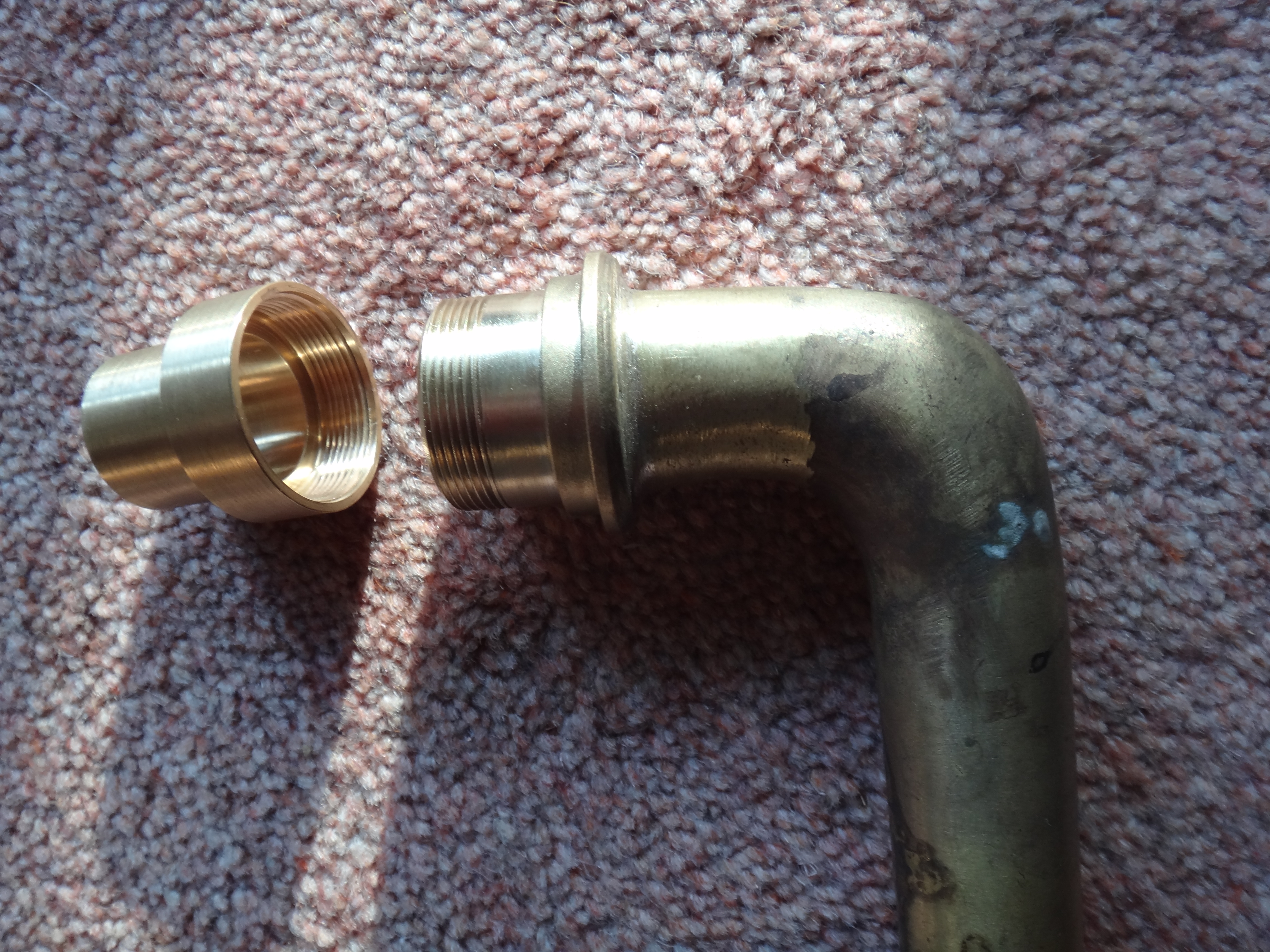

A final point of note is that EMG improved the swan-neck tonearm over the years, in particular with reference to the joint between the underside of the ball bearing and its mating housing. Originally this was merely a butt-joint and the bearing was secured by a narrow threaded collar but this design did not allow for air-tightness. The final well thought out modification involved a long threaded spigot (seen in photo No.3) which, when lubricated with grease, ensured no escape of air and thus safeguarded/promoted the reproduction of the all-important bass frequencies.

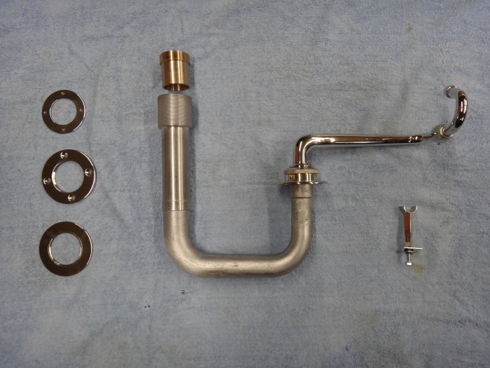

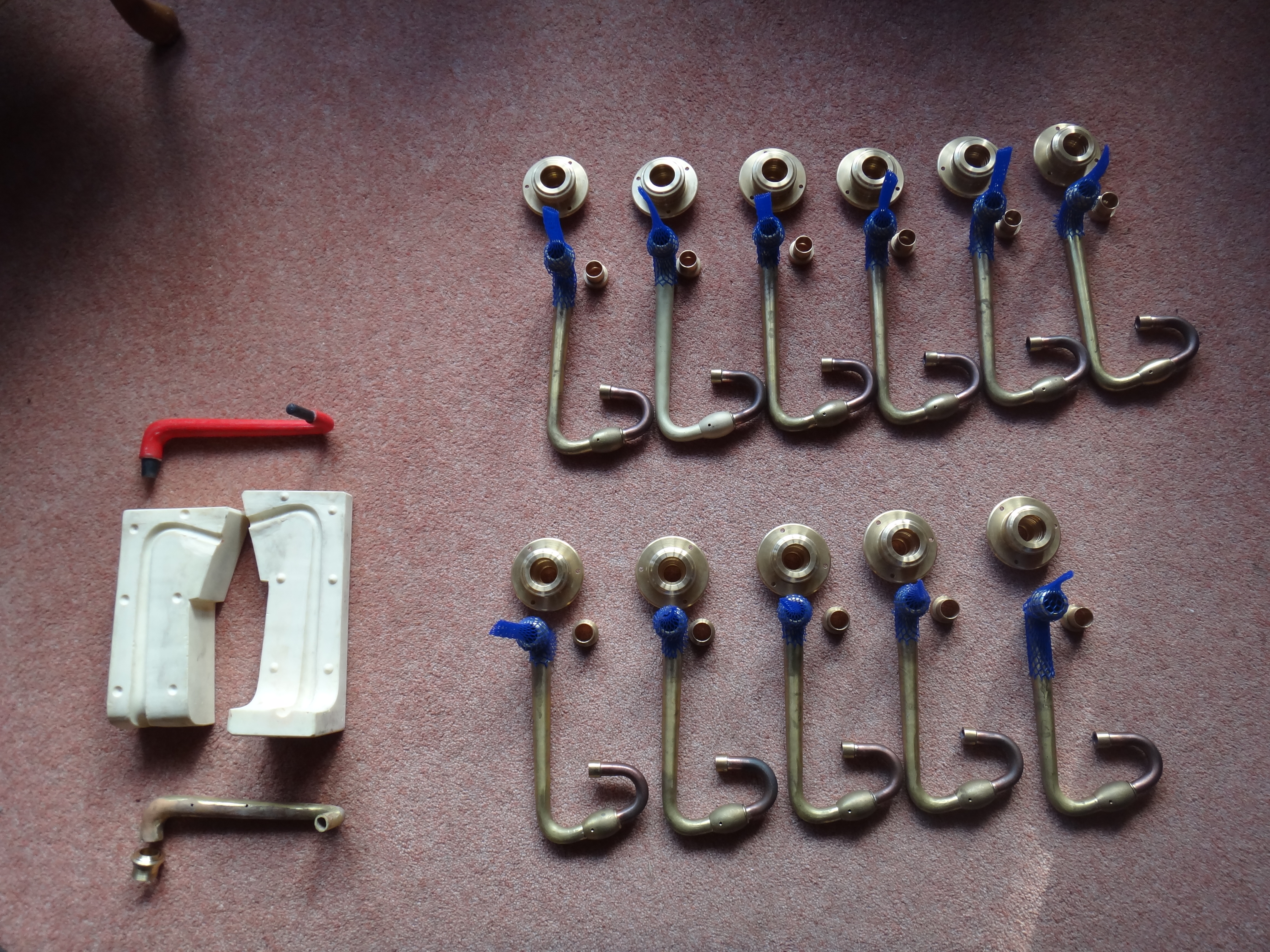

2. Pattern details and unplated tonearms.

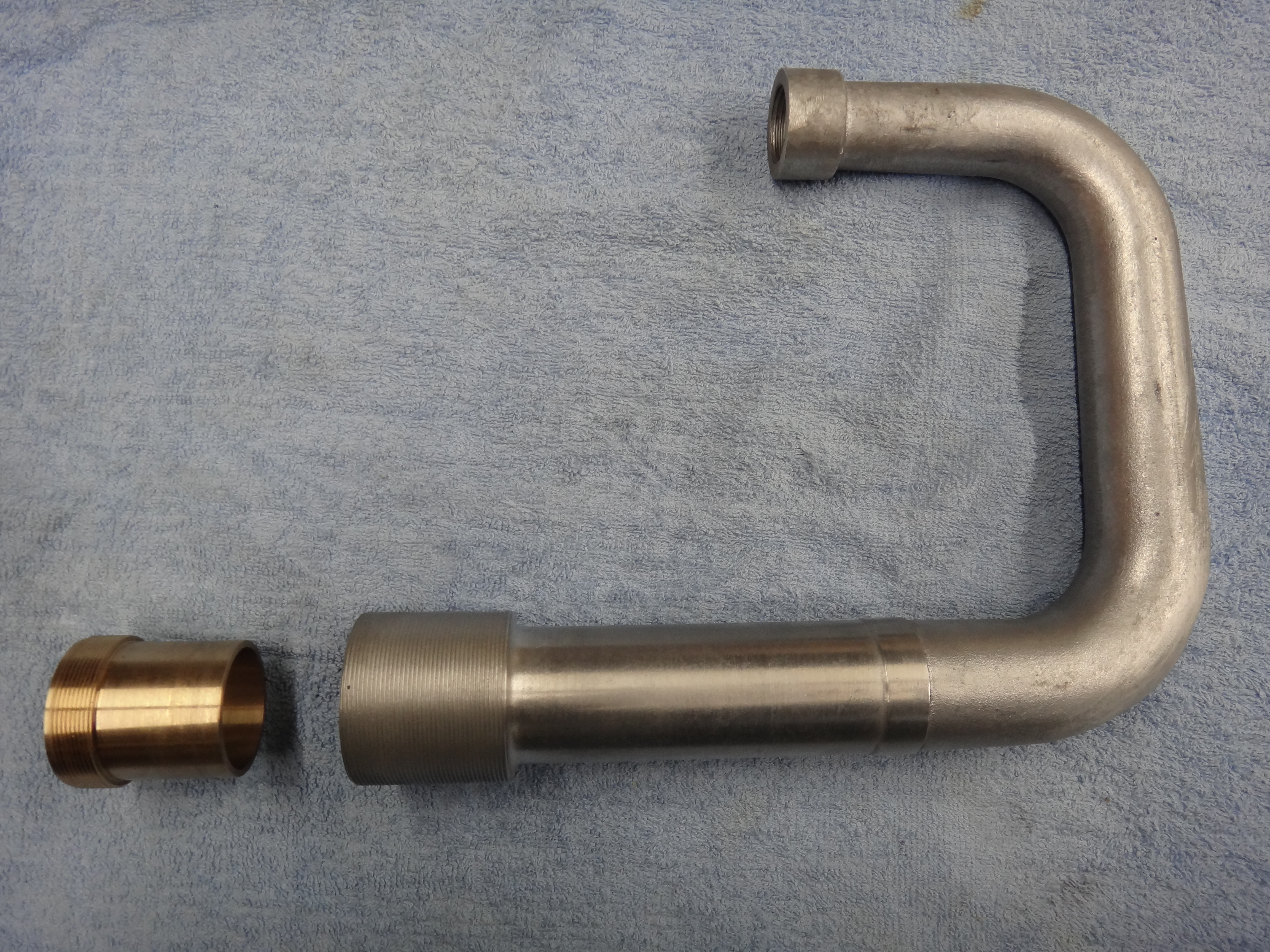

3. Extended spigot to produce air-tight connection under ball bearing.

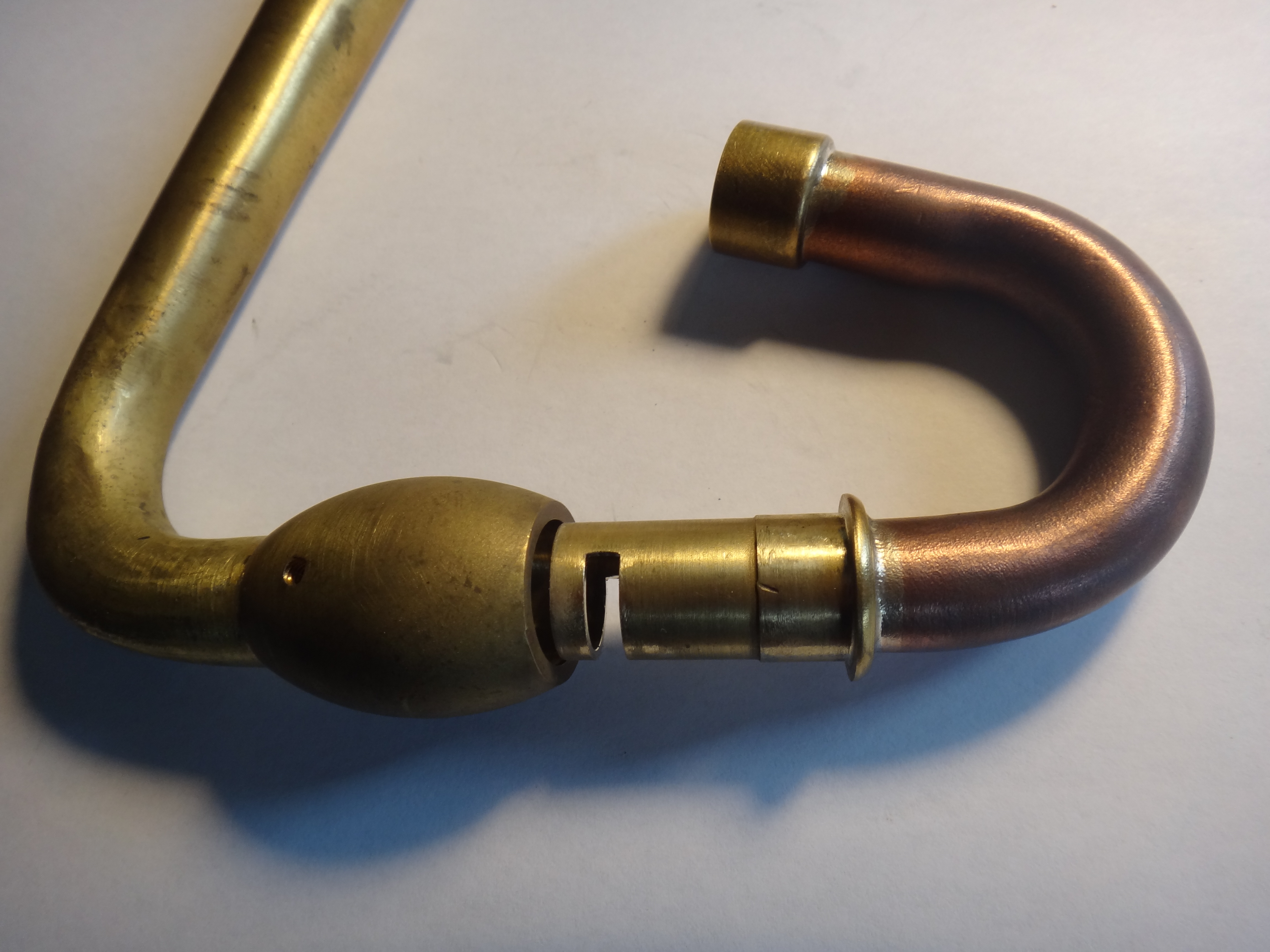

4. Swinging section of tonearm showing materials and slot travel limiter---4 BA machine screw.
5. Underside of bearing housing flange showing stamp of new 2023 production.

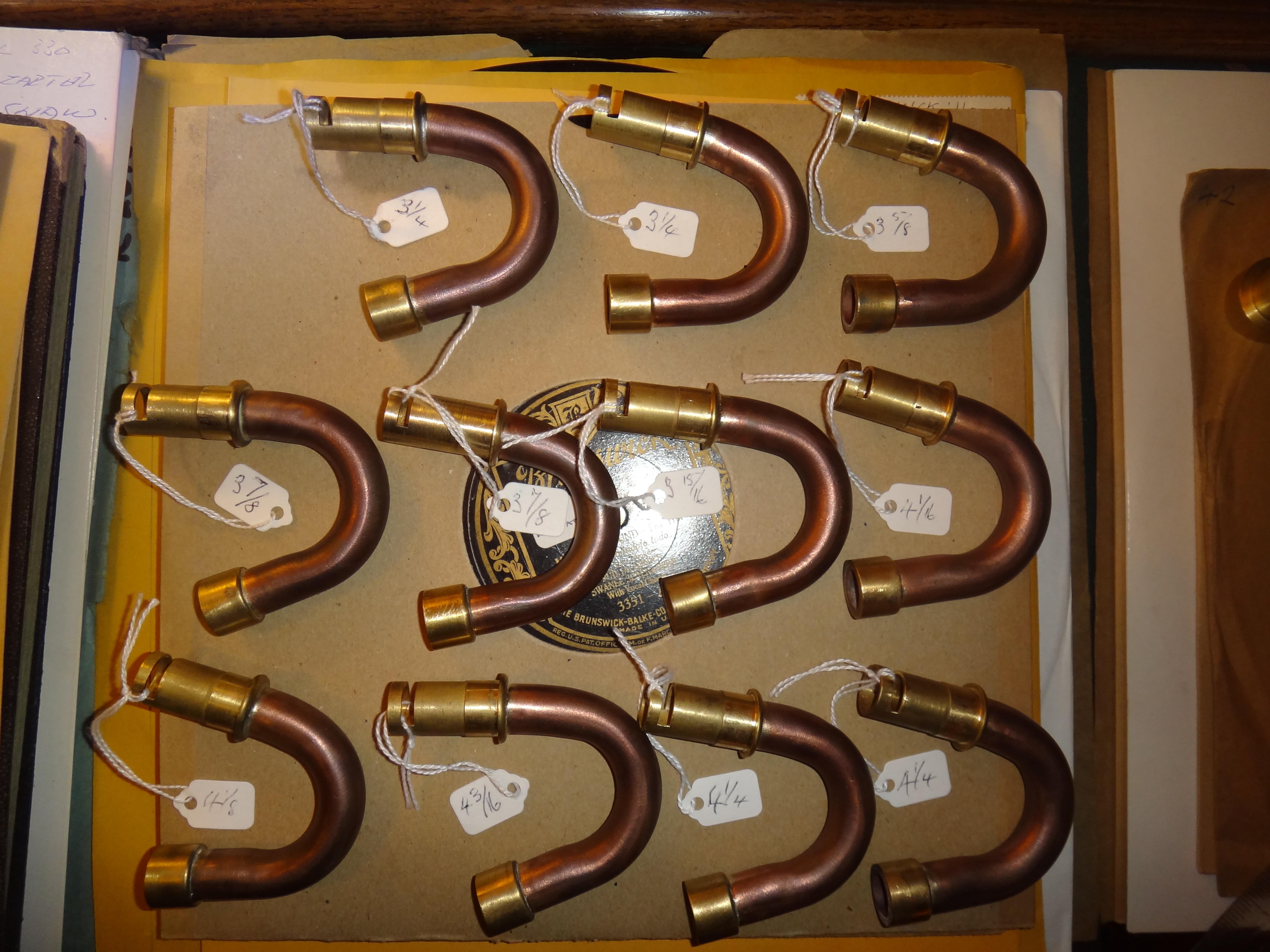

6. Tonearm swinging sections showing details of fine tuning required to produce ideal tracking---offset 3 ¾ inches.

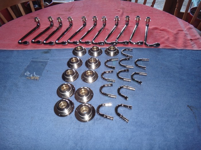

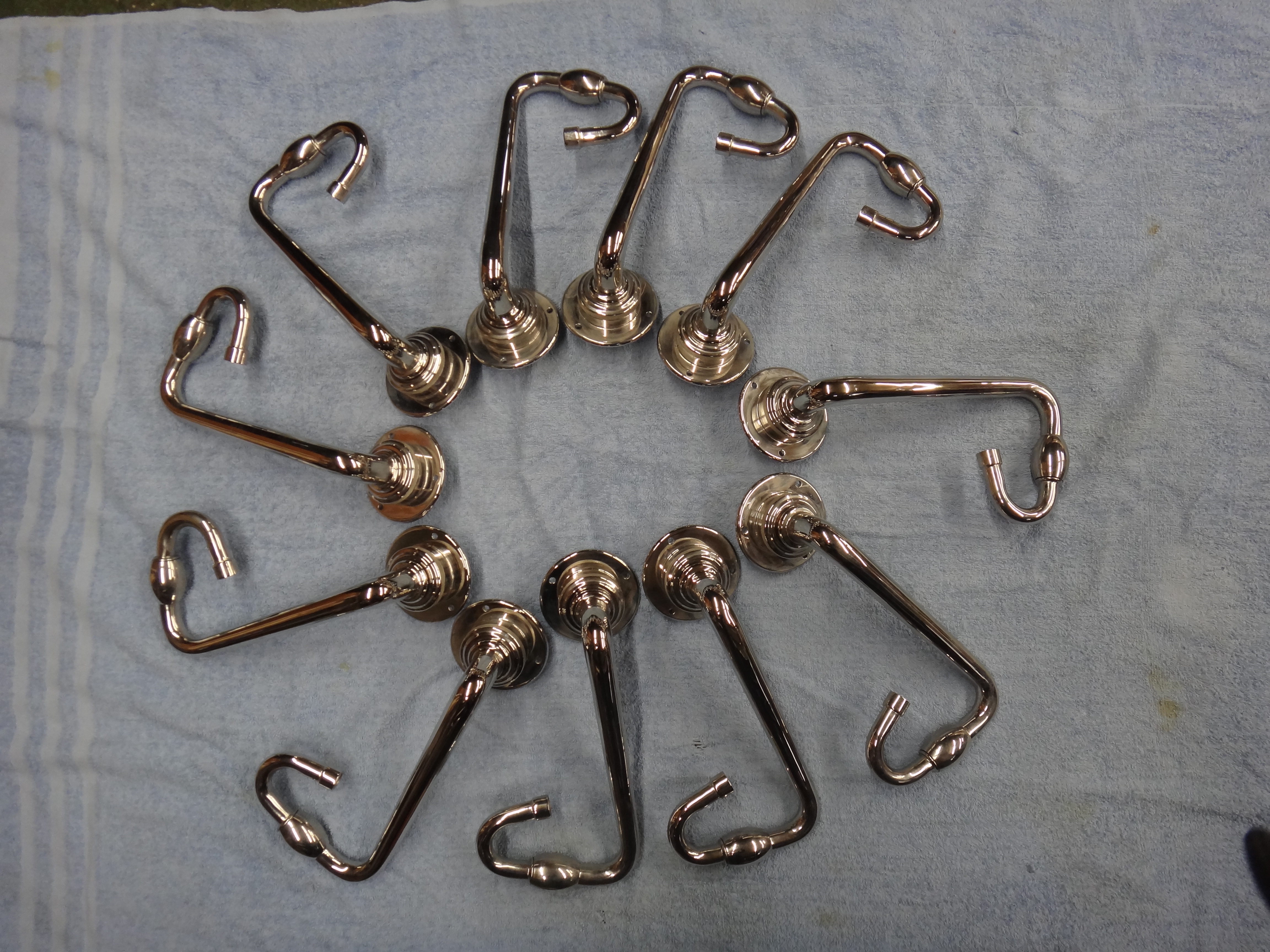

8. Eleven fully assembled tonearms.

I see the tags on the pieces in photo 6 have numbers that range from 3 ¼ to 4 ¼. What do those numbers signify? The pieces look too similar in the photo to have such a wide variation.
Is the fine tuning of the assembly done by setting the position of the pivot barrel along the tonearm to give the ideal 3 ¾” offset?
