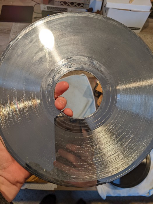

Exactly what the title says! Today, I acquired this original Brunswick master. It is matrix E-27953, "The Two Lives" by Frank and James McCravy, 1928. It's very dirty, pretty warped, and there's some corrosion on the surface outside of the play area. So what now? What's the best way to clean a master? What, if anything, do I do with the corrosion? What is the safest way to flatten the warp? Is there a way to press a new record from it, like what the Bear family did with the carter family masters, or should I try making a resin copy like Don Wilson? Any advice would be appreciated. Thank you!

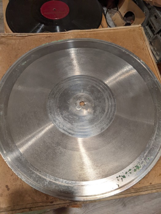

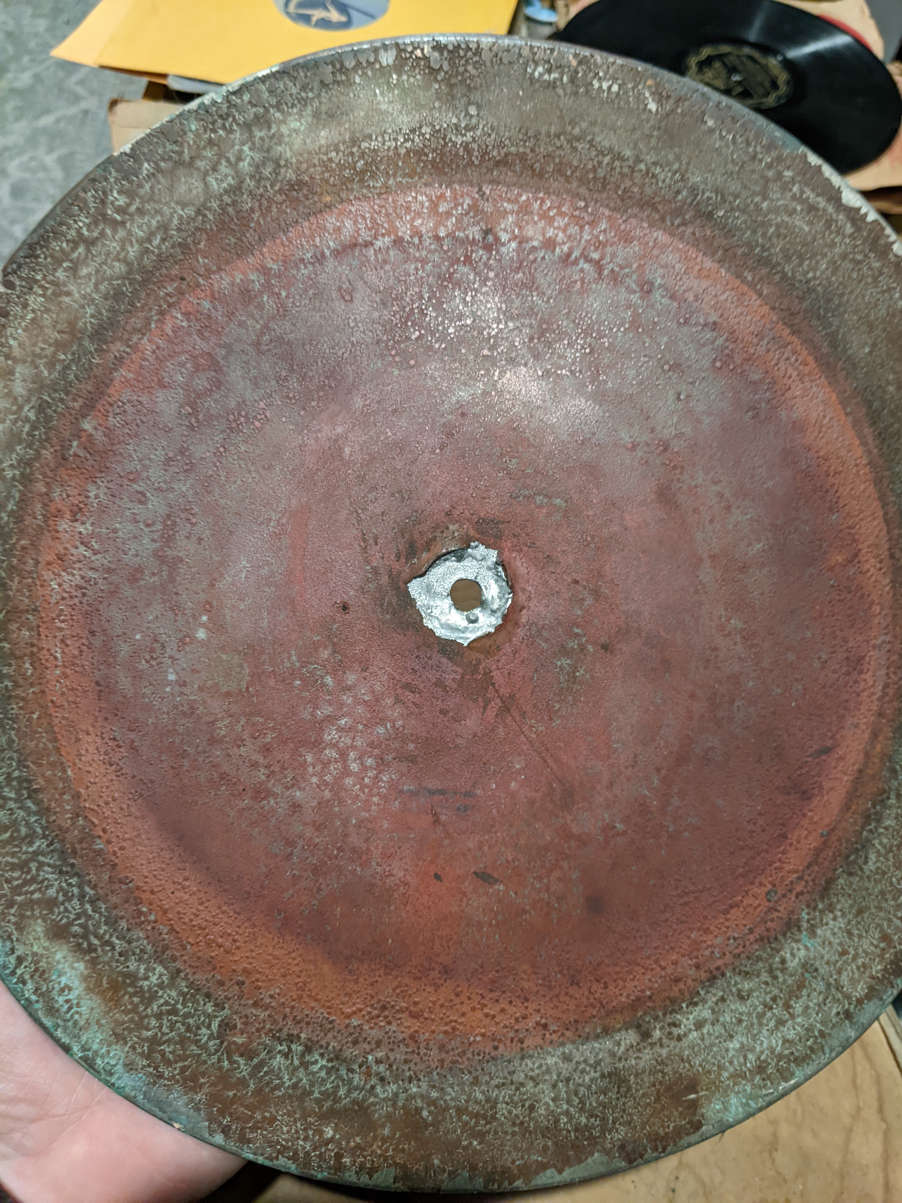

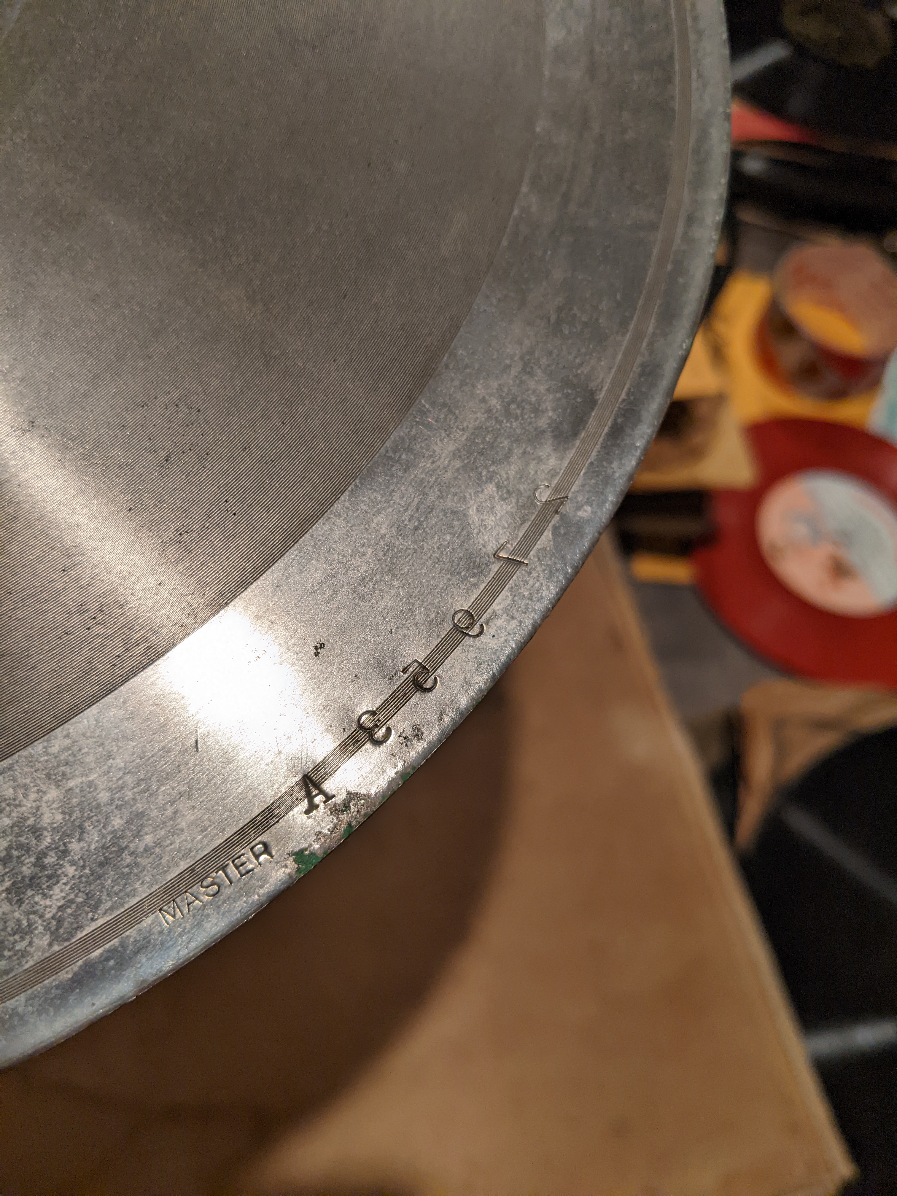

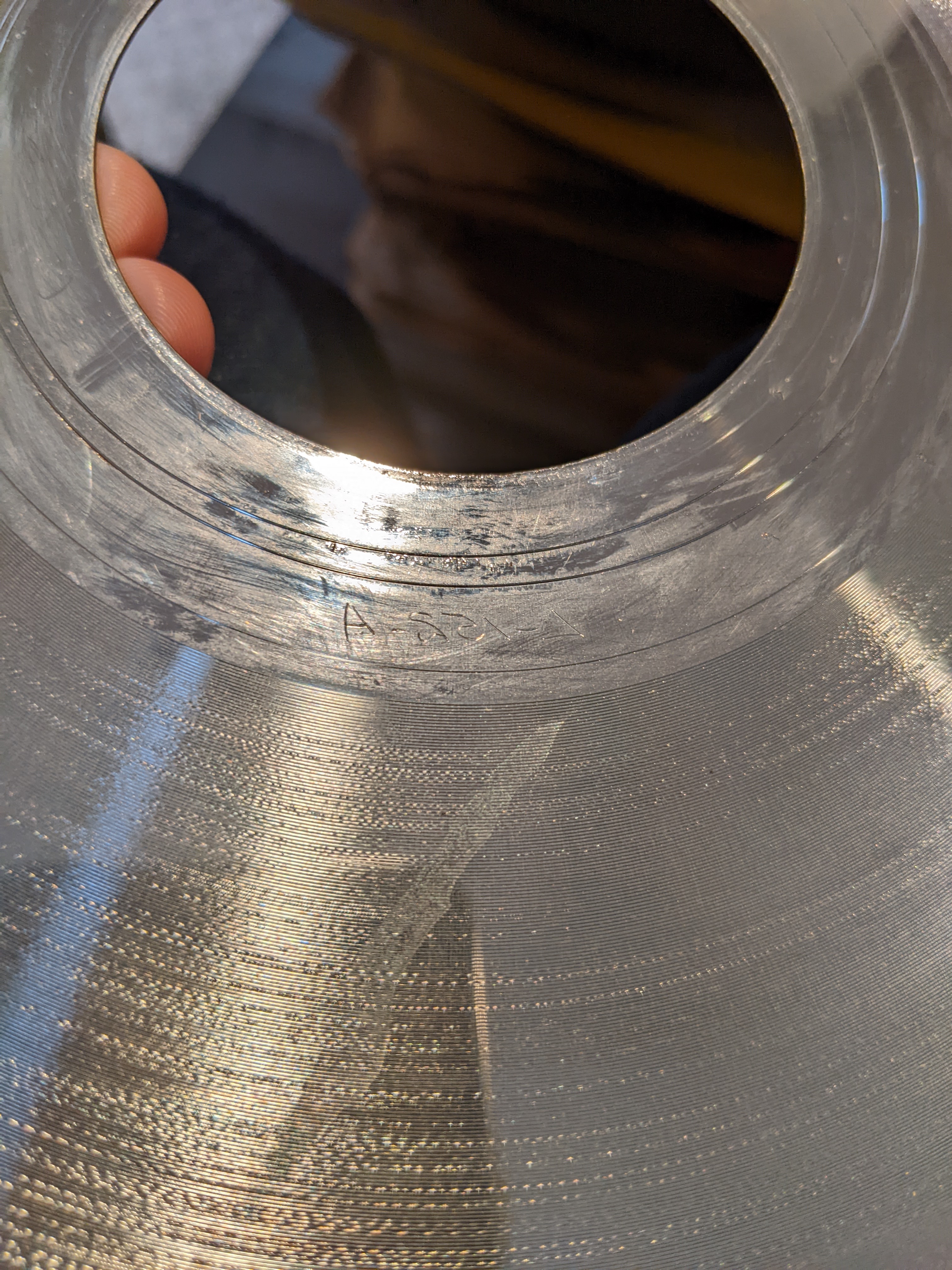

Here are some more pictures. They are raised negative grooves. I've held an original stamper before, that one had a smooth copper plate backing that was soldered onto the negative, not a rough surface like this one. This is also quite a bit thinner than a stamper. And it's stamped "Master", so that was the final giveaway. According to DAHR, this side was indeed issued, it would be interesting to find one in the future that was unissued!
The stamper that I'd mentioned handling, I'll hopefully be picking that up this Saturday. I couldn't find a match to the matrix on that one, so that may or may not have been issued. I'm located near Muskegon MI, where Brunswick was headquartered, and I've been scouring the area for more original metal parts, so hopefully more will come to the surface.

The master was often most flimsy of the stages and the mother mold was the only one that was handled to make stampers. I assume the back is copper and there would have been a thin protective nickle plating over the front as shown. As you note the rear of a master (and a mother) has no need to be smooth as it is only used for metal to metal copying of the music surface.
any flattening process risks the nodular back surface dimpling the front .
A metal to resin copy process is possible but needs the right release agent and a suitable jig to seal the center and the dam the edge to form a disc.
I have seen a process using white wood glue ( PVA adhesive) that might yield copy that could be played on a turntable with a light weight pick up.
a silicone molding would not stick but would be a bit soft to play I think.

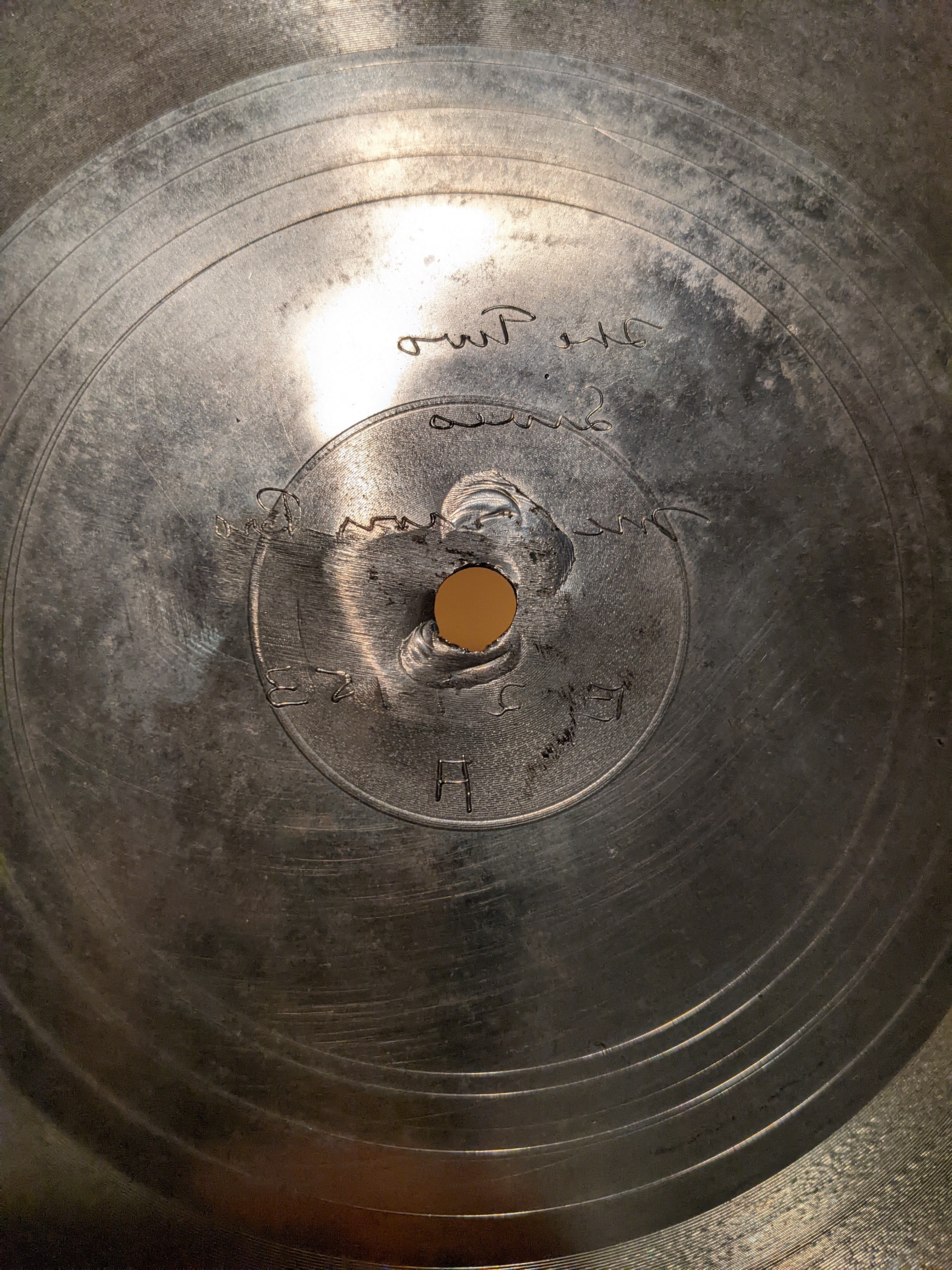

Got that stamper today too. Matrix is L-152-A, couldn't find a match for that online. Anyway, very different from the master.

looks like an unbacked stamper in one layer of cooper with possibly a chrome face? that would put it later than 1930 when the chrome plating process became practical. however I judge that but the bluish tinge on the metal and that could be a photographic artifact.
The recording looks loud and also suggests a later recording as does the mounting method.
It also looks like and eccentric groove at the end.

There is also a lead- in groove.
