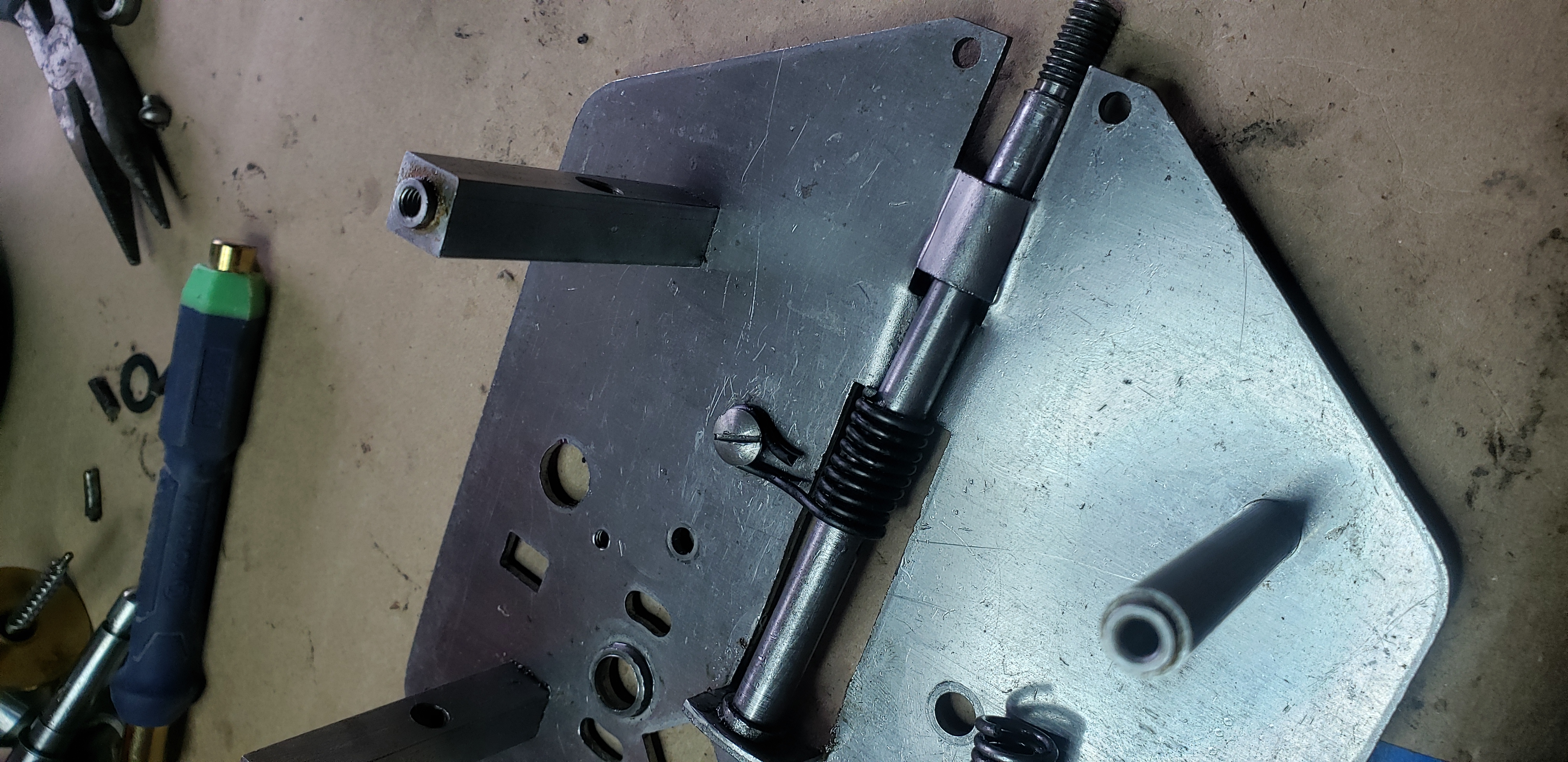

I am working on a Thorens portable gramophone, specifically the no526 motor.
My problem is with a small spring wrapped around the winding shaft that I suppose is meant to stop the winding handle from turning in reverse.
I've never repaired a machine with this type of spring, so am not familiar with proper nomenclature or even how this spring is supposed to work. The one on the machine is broken but it appears to have originally wrapped around a small screw to prevent it from turning. I've attached a photo of a spring that I've made based on what I think it should look like. However, my new spring doesn't create enough energy to allow me to remove the cranking handle once the machine is wound.
Is this what the original spring might have looked like? Should the other end of the spring be attached to something else?
Any help would be greatly appreciated.
Vince

Vince,
How tightly does the spring grip the shaft? I don't mean when it's supposed to be holding back the spring tension, I mean when you're cranking, and the "clutch" action is released. It's got to be a fairly snug fit, or it won't engage with the shaft firmly enough to wrap itself tightly around the winding shaft when reversed. You should almost have to unwind the spring a bit to get it over the shaft. As far as what you've made, it looks great and "correct".
I have a fair supply of new-old-stock springs like this. If you could supply shaft dimensions, spring length, etc., I may have one for you.

Post by Sidewinder »
It is a "non return spring" that as you mention, prevents the winder from unwinding. As to which way it should go, without a picture of one similar it could be trial & error. chances are 50-50. I could send you a photo from a Thorens motor, but due to travel, it could be only in about 2 weeks :-(
I'm not sure a home made one would work unless you are a spring making professional!

JerryVan wrote: Fri Jan 13, 2023 3:28 pm Vince,
That's exactly what the problem was. I remade the spring using a shaft with a slightly smaller diameter which made it fit much more tight on the proper shaft.
Thank you!
JerryVan wrote: Fri Jan 13, 2023 3:28 pm I have a fair supply of new-old-stock springs like this. If you could supply shaft dimensions, spring length, etc., I may have one for you.
The one I made seems to be holding for now but I'll get my measuring equipment out this weekend and see if I can get you that info.
much appreciated!

Sidewinder wrote: Fri Jan 13, 2023 3:57 pm It is a "non return spring" that as you mention, prevents the winder from unwinding. As to which way it should go, without a picture of one similar it could be trial & error. chances are 50-50. I could send you a photo from a Thorens motor, but due to travel, it could be only in about 2 weeks :-(
Thank you very much for the offer, I think we figured it out.
I made a few springs out of soft wire wrapped around a shaft, then hardened them by heating and quenching in oil. Trial and error until
I figured out a good temperature before the quench and then tempered the spring. So far it's held up to a few complete windings but I'm not
sure I trust it. I'll likely take Jerry up on his offer of a new one if he has it.

Mr Grumpy wrote: Fri Jan 13, 2023 8:37 pm
Thank you!
much appreciated!
Happy to read of your success! When you get those dimensions, also include one for the distance from the centerline of the winding shaft to the centerline of the anchor screw hole.
Hey Jerry, I finally found my vernier!!!!
Diameter of Rod is 6.97mm ( so let's say 7?)
Distance from centerline of winding shaft to center of anchor screw is 21mm
Length of spring is 14mm, but this is a measurement of the one I made, not sure about the original. This length, give or take seems to work.
