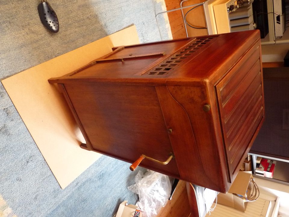

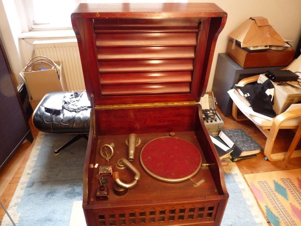

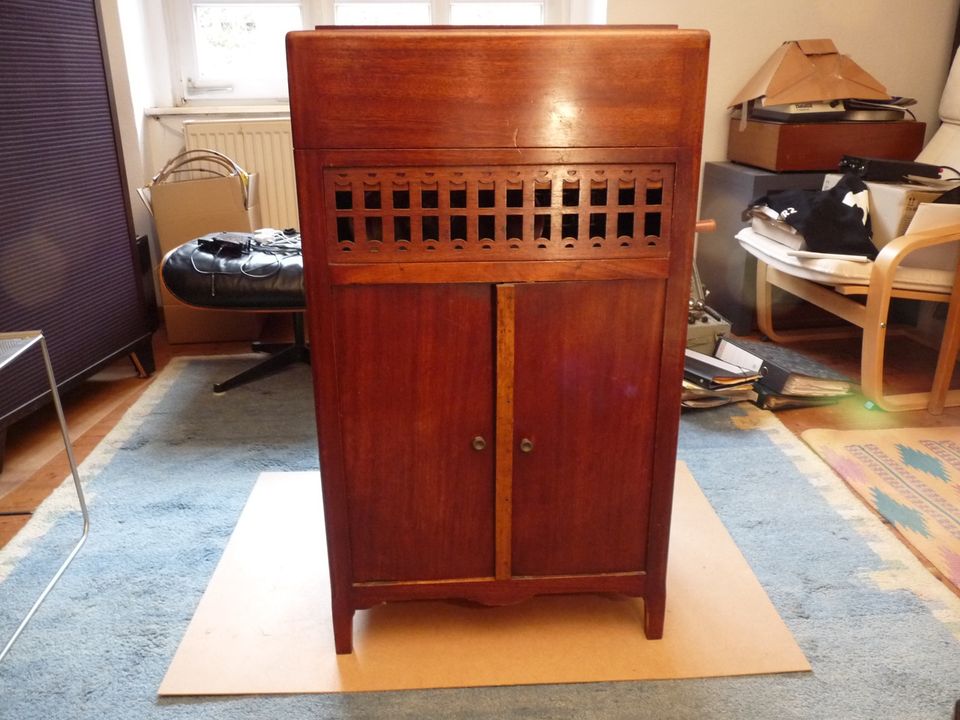

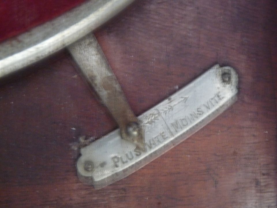

I am trying to identify this machine. Can't find out on my own what model this might be. I suspect its a Pathé, as states on the reproducer, as well the speed control is in French. I never saw a machine similar to this one among Pathé phonographs.
Doesn anyone has a clue on what is that machine?
Let me know please. It's quite far from a place where I live at the moment, but I am considering a trip.
Thank you.

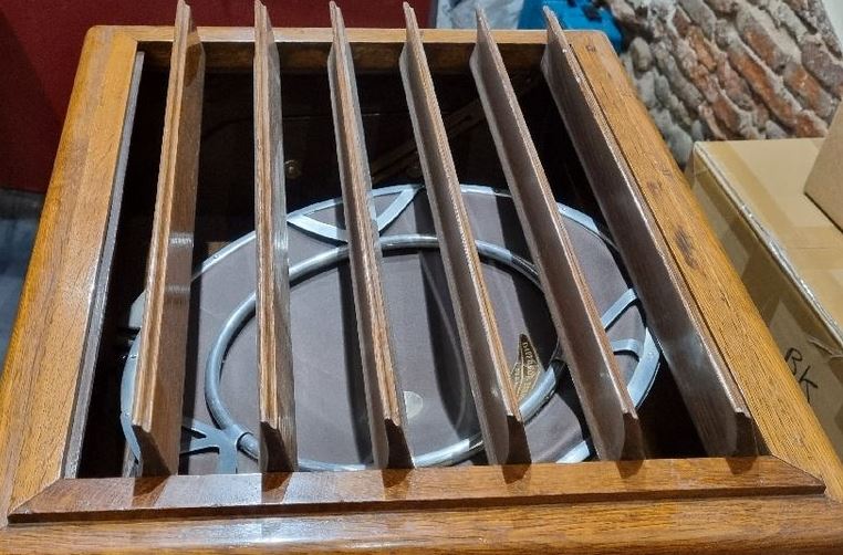

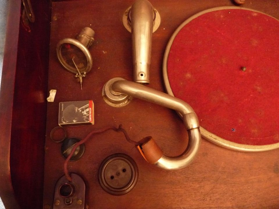

It is indeed a French Pathé. It has however been altered from its original configuration, that has a cone diaphragm together with the regular arm, and not the two arms shown in yours. The cone diaphragm (called Diffusor) produces the sound directly upwards, without passing through the horn, and it has its volume control louvers at the top of the machine. The arm is routed to the horn as a regular gramophone. The cone was intended to play vertical discs, while the arm was for lateral cuts - even though the cone could play lateral cuts as well with a steel needle, and Pathé had soundboxes for both types of cut for their arms. On your machine, the Pathé arm is the fatter one on the top, while the other arm probably comes from a portable.
- Marco Gilardetti
- Posts: 1516
- Location: Italy
Re: Help with identifying Pathé floor model
I would just add to Carlos' very informative message, that it appears obvious to me that the "thinner" tonearm was added at a later time only in order to carry the electric pickup (visible in photo, although detached from the arm) and connect it to the phono stage of a tube radio. I suppose it is not connected at all to the horn below, and that just a small hole to pass the cable through was drilled in the motorboard.

Not the same machine, but a diffusor cone can be seen in the photo of my "avatar" machine.
Yours is interesting--I've never seen a floor model diffusor type before.

You have probably been asking yourself why does the lid have a shutter system that can be regulated - its a volume control - Columbia had the same ideas with shutters in front of the horn.
Somewhere I have a catalog with the model number, I'll try locate it.
And of course it has an internal horn when one uses the tone arm. As pointed out it has an upgrade to use an electric reproducer. Are the electric pieces fixed to the cabinet or are they just extraneous items laying in the cabinet?
