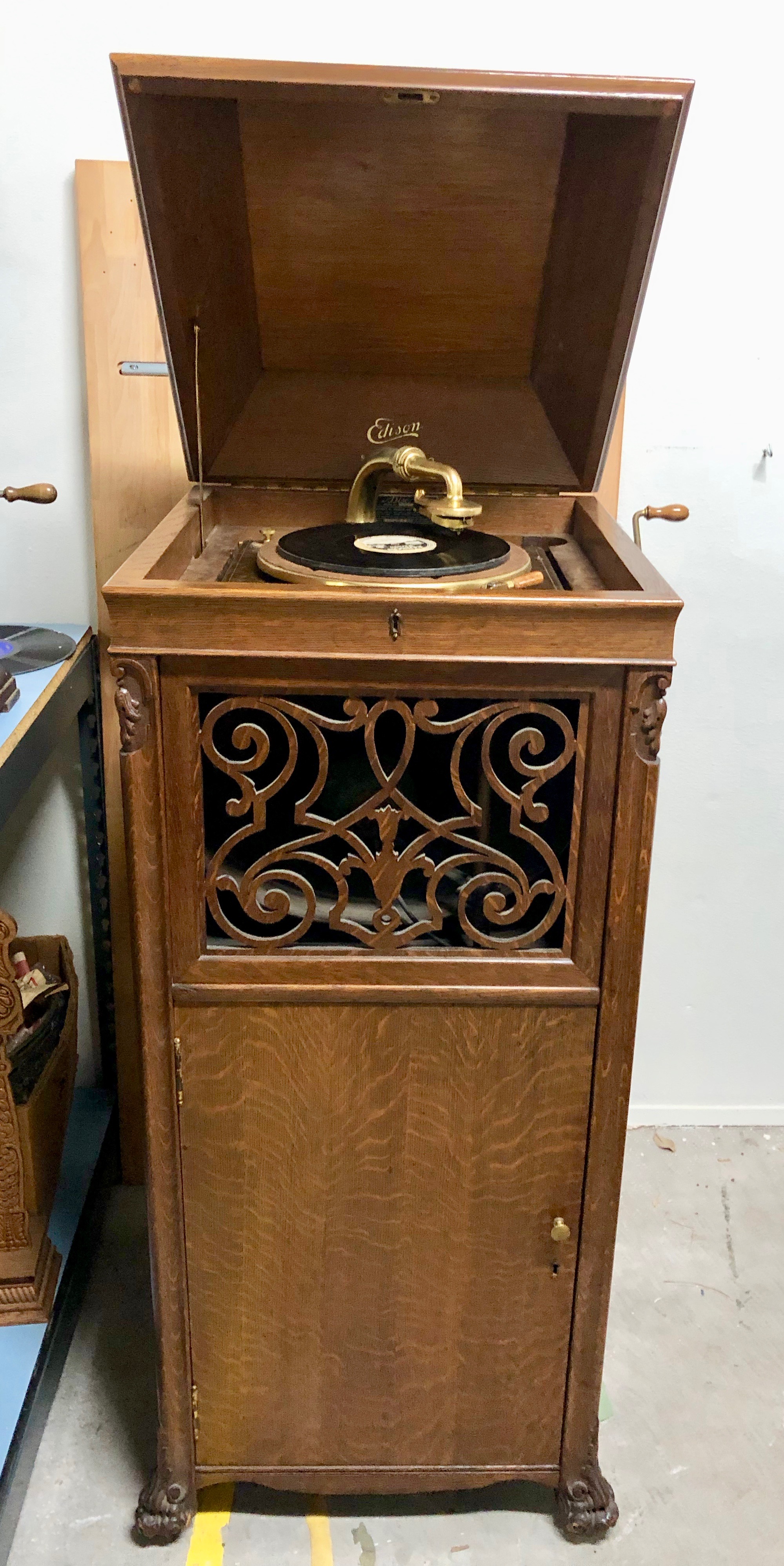

I was wondering what changes were made to the Edison A250 motor and cabinet when it changed to the B250. I've read that there were some cost-cutting measures done. I picked up this beautiful oak A250, and the cabinetry is better than I've seen in other Diamond Disc machines.

There is no significant difference between the cabinets of the A250 and B250. They are of consistently high quality, manufactured by several reputable furniture companies.
The major difference between the two models is the appearance of the New Standardized Motor in the B250. The motor plates of the B250 were painted a deep maroon (at least on the mahogany versions) and the paint holds up much better than that used on the A-series. The B250 horns and lift tubes are painted black, and handles on the cranks and lift levers phased to black paint rather than matched to the cabinets. During B250 production, the reproducers transitioned from the 4-screw plate plate style to the more common form with the stylus bar pivots integral to the weight.
The B250 is found far less frequently than the A250. If only they had retained the nice grained horns!
