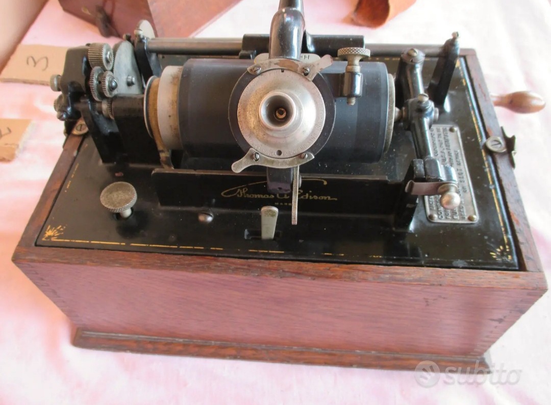

I kindly ask for an advice and opinion from expert people here about an Edison Standard 2 clip which I am evaluating to buy.

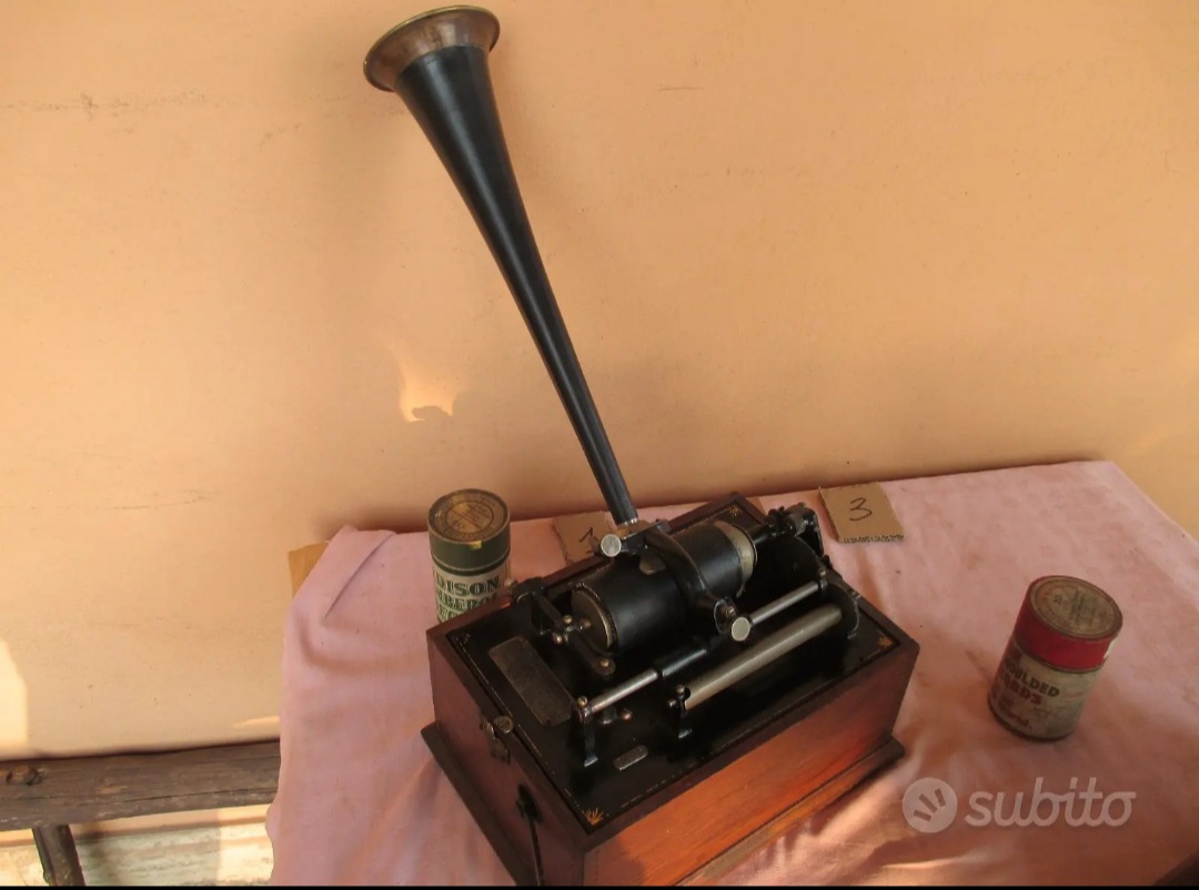

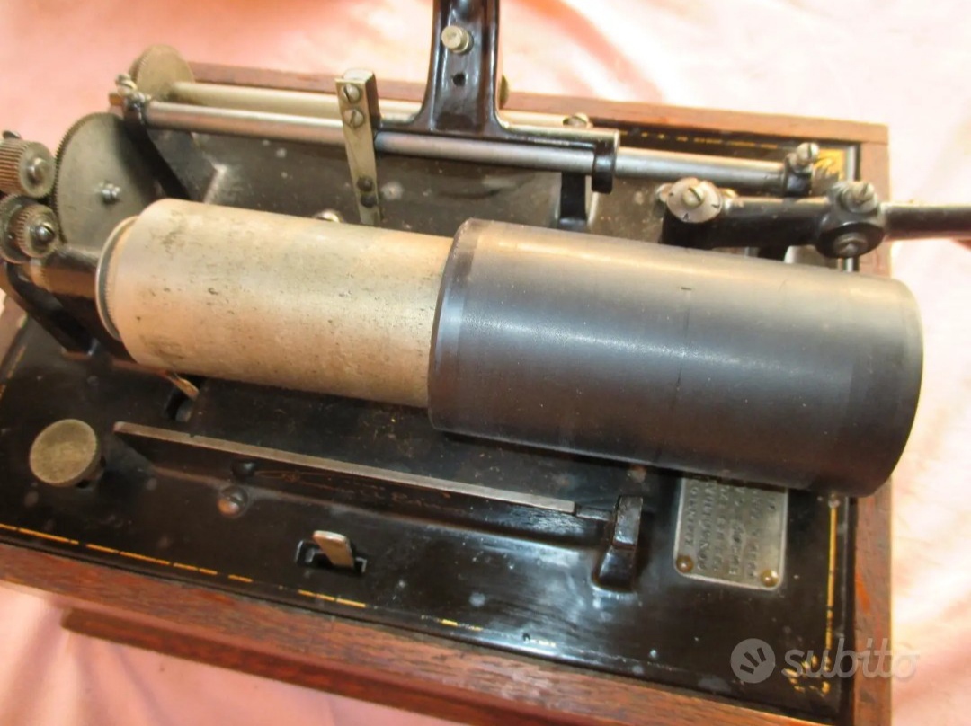

I attach here all pictures I have. I am thinking mostly about the horn and the model H reproducer (it seems to have a 4 minute upgrade) and also about what is visibile of the crank.

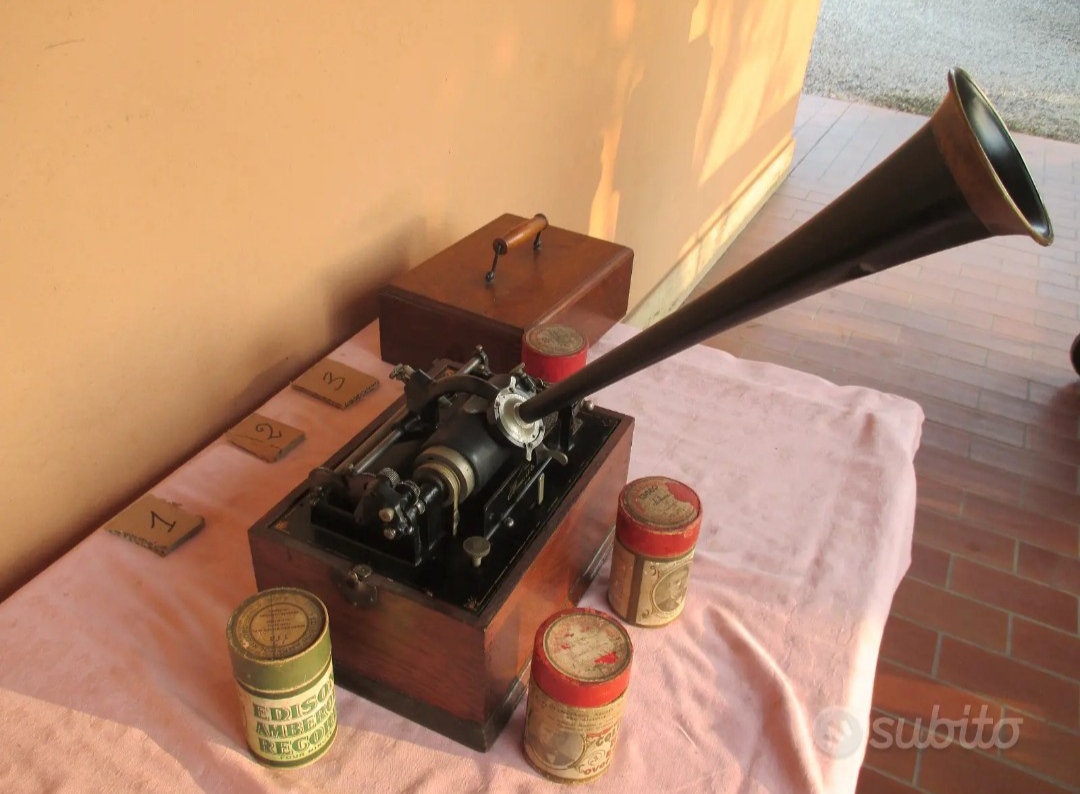

Also, are the 2 clips on the bottom case close to the original? From other pictures on the internet it does not seem to have the screw that goes vertically in the wooden box..
I already asked people about the patent plate and it turned out this was a UK-market (edison-bell).
Again many thanks for your expertise.

Not sure what your questions really are. The Model H reproducer has somewhat large hole in the 6 o'clock position. There should be a hole there, but this one looks too big. Like maybe a repair has been done the hinge block. Could be okay.
The horn is cut down from an automotive horn of the 30's or 40's. It's most likely not a phonograph horn.
The crank looks okay, from what can be seen of it.
The 2 vertical screws you refer to were probably a later addition. Possibly meant to correct a loose fitting top. Not a big deal. The clips look original, from what little can be seen. (If you get this, NEVER pick it up using the carrying handle. Neither the clips nor the old glue in the lid can be trusted to lift the machine. Okay to steady it with the handle, but support the machine from underneath.)
Overall, it's a nice machine. Personally, for an early Standard, I would prefer that it hadn't been coverted to 2/4 minutes, but that's my personal taste, which does not effect its value, unless you feel the same.

The bedplate is not hinged and would normally lift off of the case. I think the two screws you've asked about were added by a previous owner to keep it secure on the case.
I assume that you have seen this in person and it works well.

It looks like this is an earlier model series that takes a different straight gear cover than the later dog boned cover. Also I do not see any holes for the gear cover in the bedplate which was standard on the earlier models. This could be converted back to its original format by taking out the two/four minute gear attachment if you want. As Jerry says you will also eventually need another 14 inch horn for that phonograph. It looks like a nice two latch square box. If it runs and is between $ 400 and $ 500 it is not a bad deal. It would be nice if you told us what the asking price is. Also do not play brown wax cylinders on this without a standard reproducer. An C reproducer will hurt them. Edison made about 40000 of these and I believe that the ones that were sent to England were included in that total. Tom
