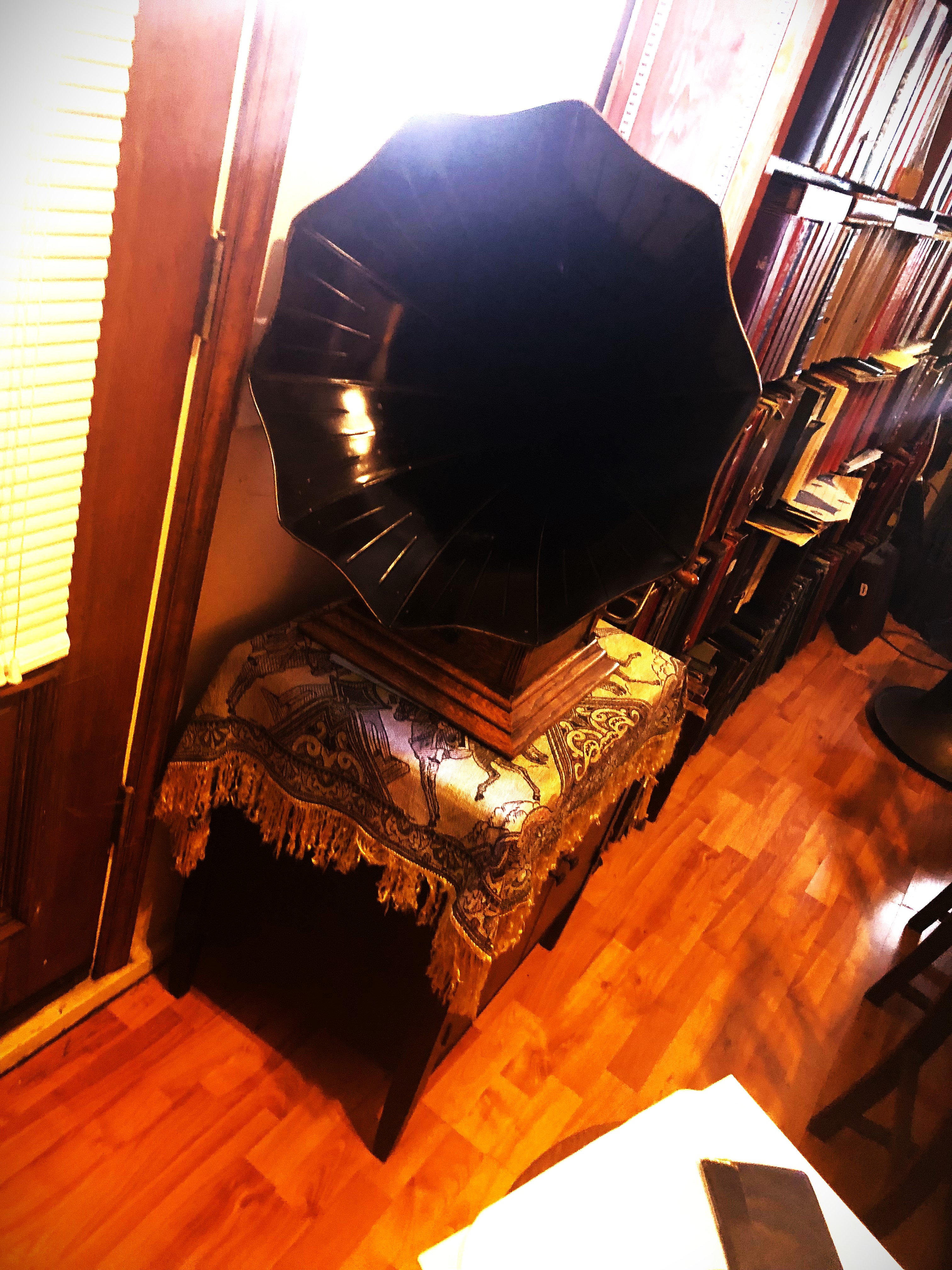

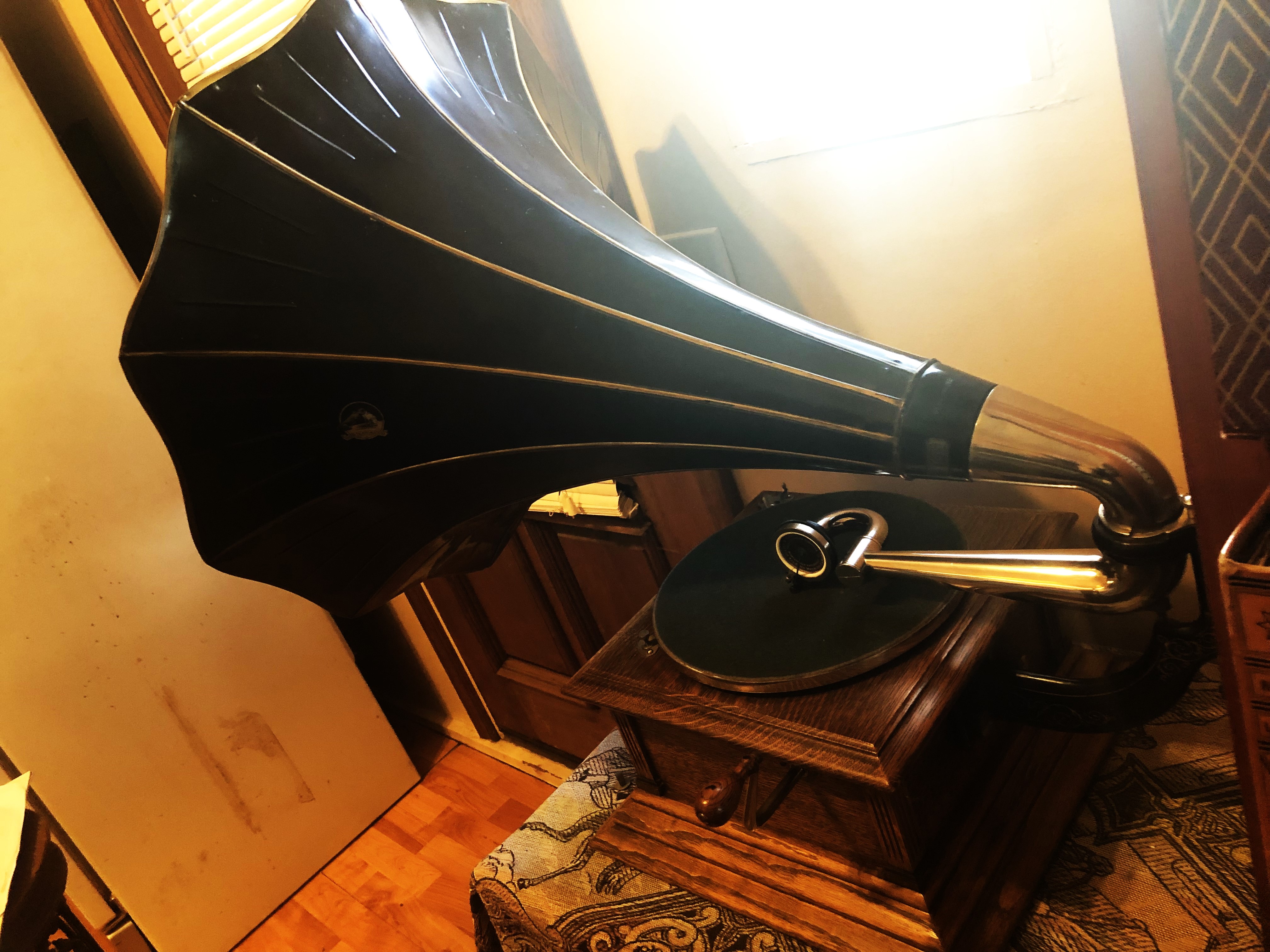

But seriously... here are the results. Unfortunately the machine sits in a place where it is hard to photo properly, with a window right above, hence the glare. Here are the "before" shots from Ken's ad:
And after the Curt A method:
