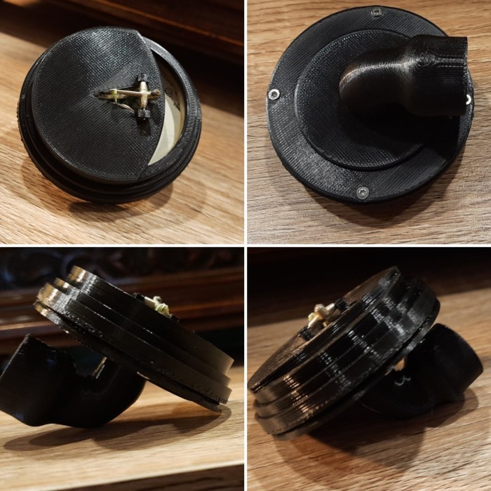

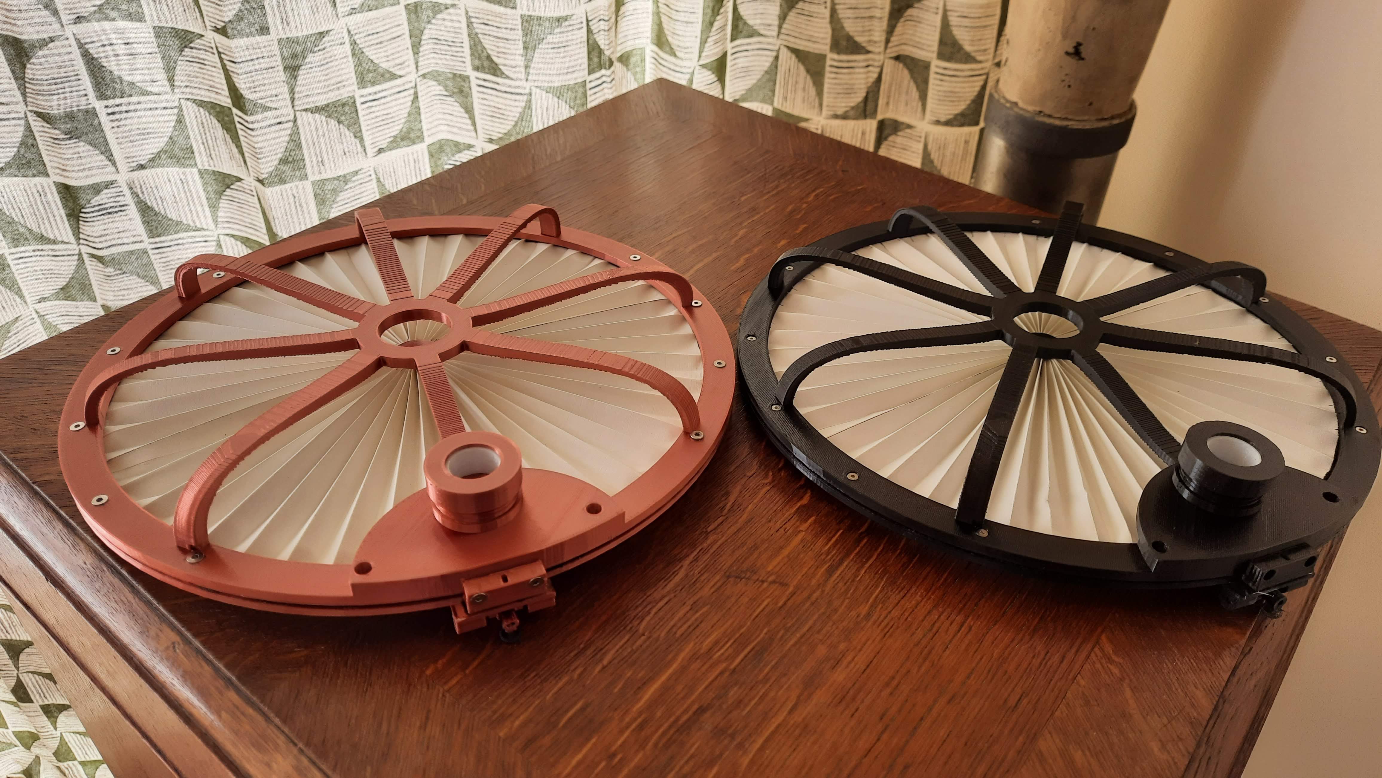

1- The Lumiere Attachement:
The idea was to build a Lumiere-eque attachment to go in place of the soundbox on a standard tonearm. Why, because why not!
The process was quite interesting, requiring a lot of experimentation with the needle bar materials, paper type and weight as well as number of folds/inch. The final result is here, and is every bit as picky about what records it likes as my original HMV 460: https://youtu.be/nDMsP2dDmZg
I used an HMV no.4 style needle bar pivot for my design, and a got some ideas for improving the design to achieve a fuller volume as and when I have some time

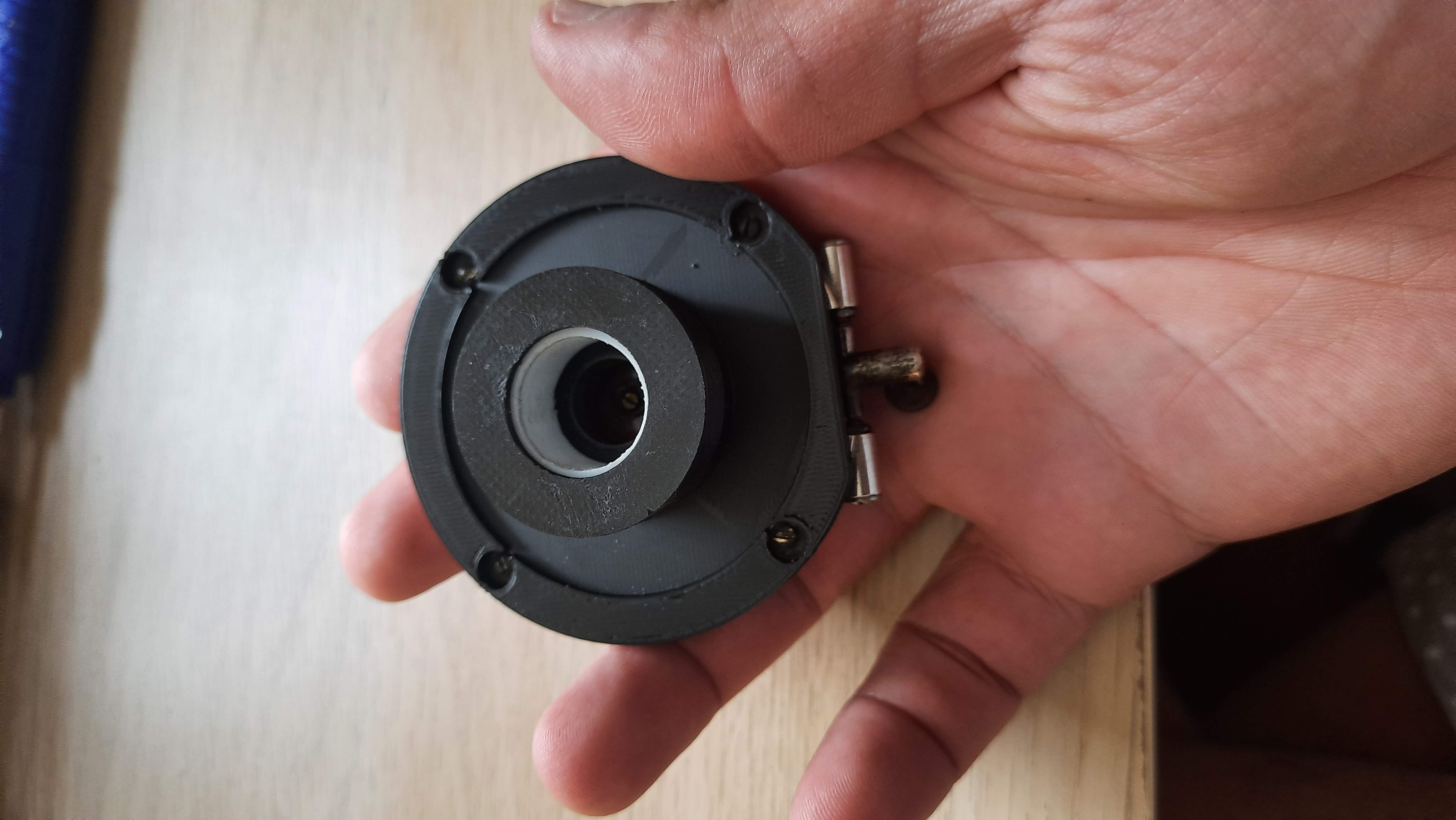

2- The Vicso-Not
That is an Edison Diamond Disc adaptor, using an original Edison stylus I had to hand. Video here: https://youtu.be/FQMg164C9Qs

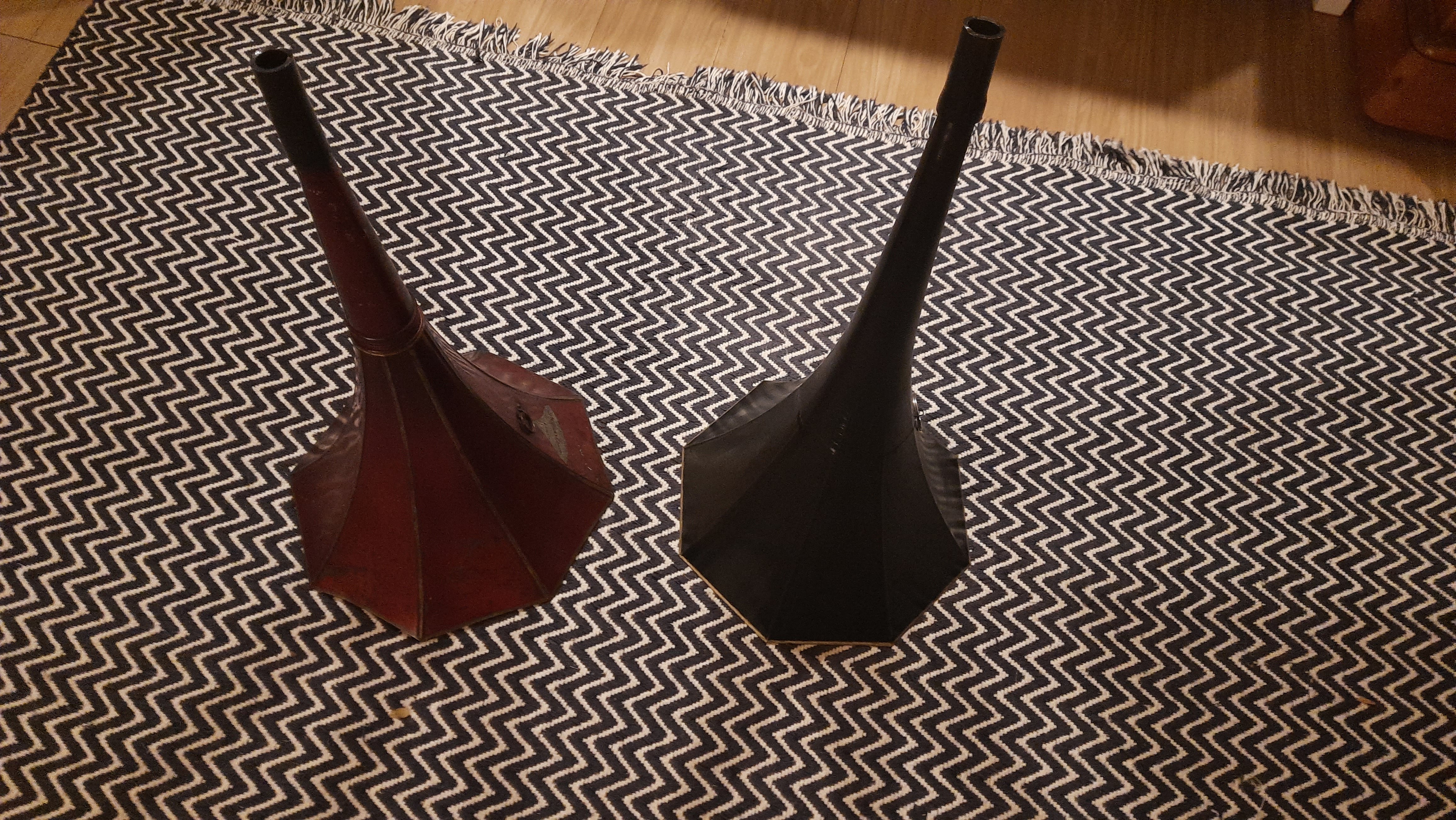

3- A Fireside horn
A friend was struggling to get a horn for his Fireside, so we decided to try out a fully 3D printed one. The result sounded a lot richer than the original and still lives on his machine. Video here: https://youtu.be/EJg7Tc9Hh7U

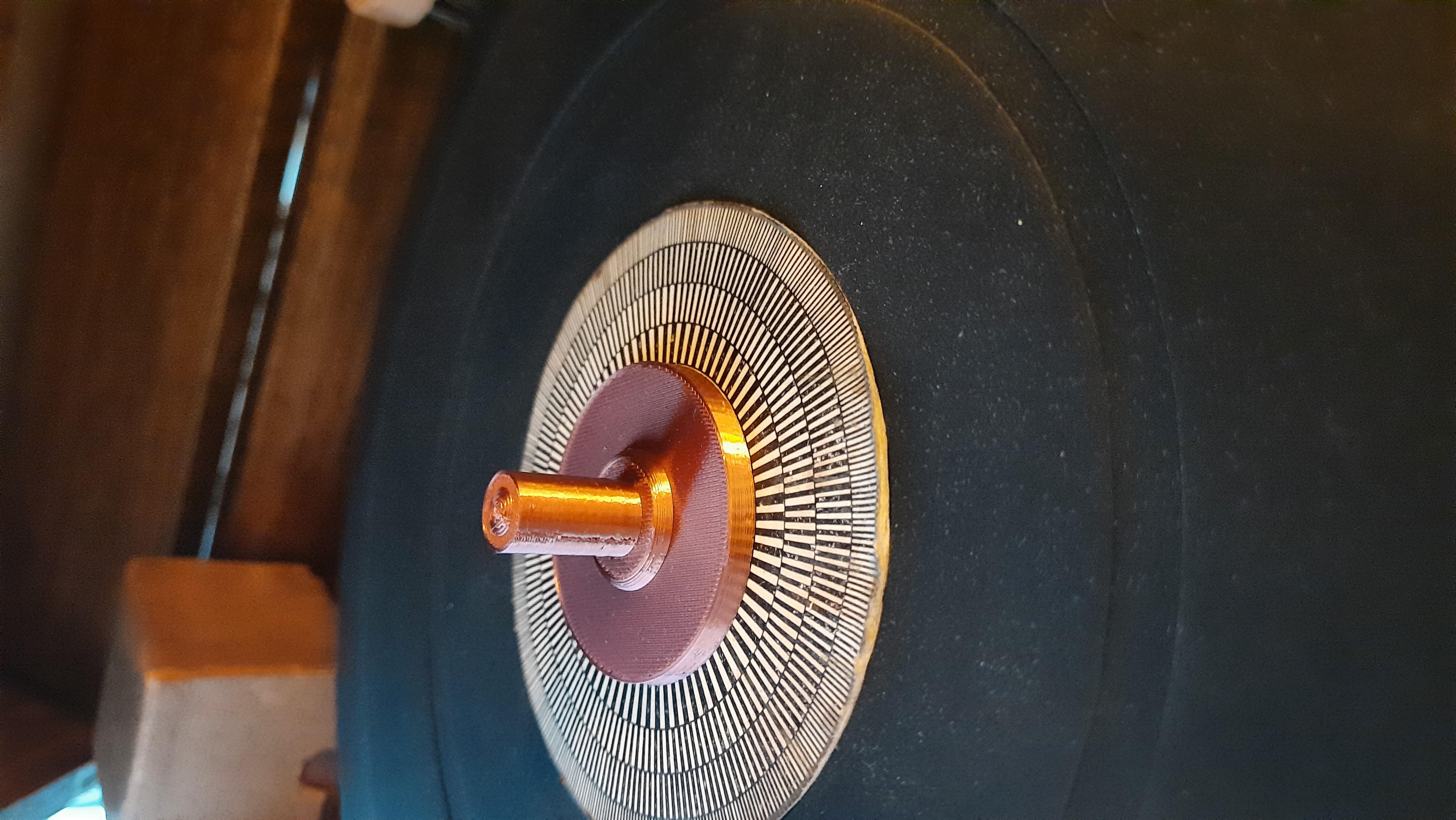

5- Soundbox savers!
Having had a little accident with my Expert soundbox, I wanted have a way of preventing it crossing the spindle should the needle jump out the runout groove. Two designs were tried out:
- A raised arm which attaches to the screws on the tonearm base, and nudges the soundbox back into the groove: https://youtu.be/OzQToQRnCDA
- A spindle topper, which is what I have on all my machines now and has saved my soundboxes from demise on more than one occasion

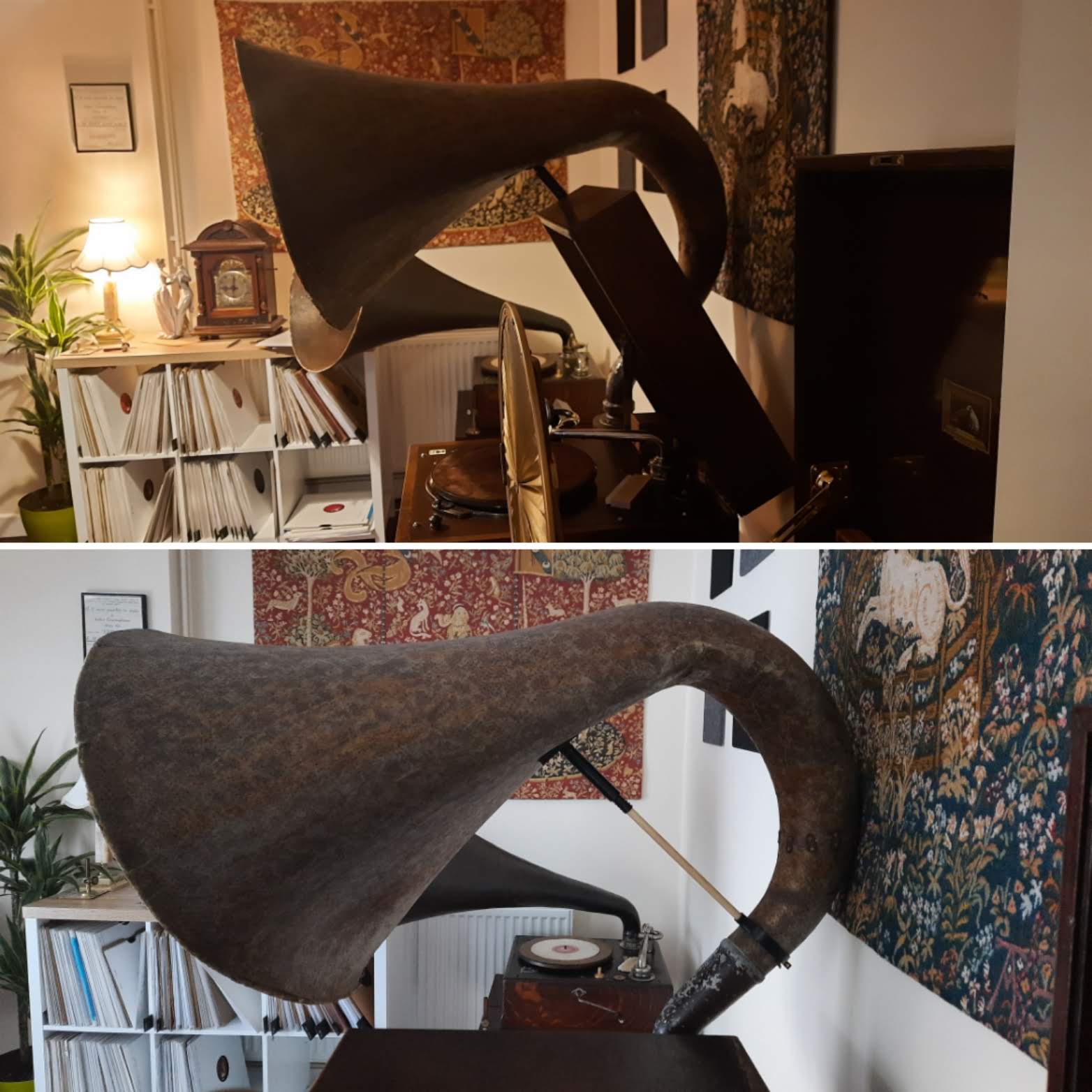

7- The Horn Pusher Upper 5000®
A height adjustable support for saggy Mk IX horns. My horn has since had some surgery and can stand up on its own without support, hurrah!

@Carlos, here is a close up of the first iteration of the Edison adaptor, which is the one in the video
