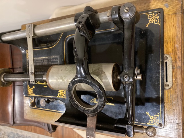

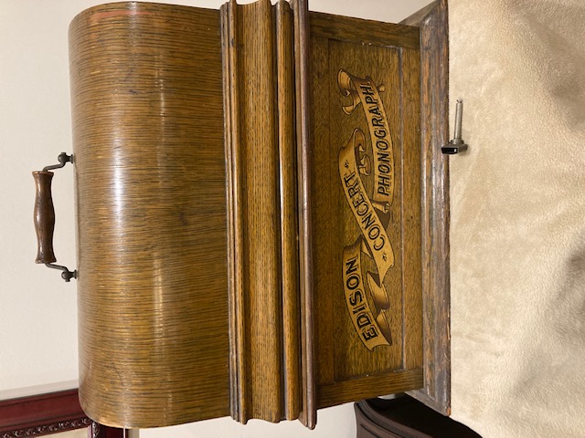

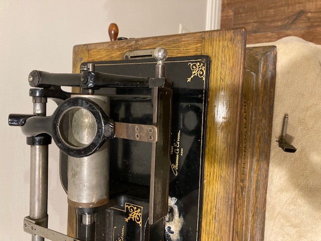

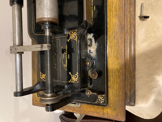

I just picked this Concert up yesterday, the case is in excellent original condition, the bed plate is also very nice, the white buildup around carriage standoffs comes right off so I think it will cleanup very nice, BUTTTT as you can see the machine does not have a concert mandrel and has some type of homemade attempt to make a reproducer carriage. My question is will it be impossible to find the correct parts to restore the mechanism? I only paid $125 for it but would like to get it back as it should be. Thanks Larry

It looked like someone wanted to play regular size 2-minutes on it instead of Concerts.
I hope you can find the mandrel and the original type of carriage because that is in very nice shape. The white buildup is probably related to rubber isolators breaking down, maybe?
At least this is the later one without the wooden drawer on the front of the case. For $125 I think you did extremely well.

Edison offered conversion kits to upgrade Concert machines to play standard cylinders, once the Gold Moulded records made Concert records obsolete (and too expensive). Edison dealers replaced the mandrel and shaft, and mounted a new reproducer carriage to bring the stylus down. This carriage kept the reproducer horizontal, as on the original. It looks like yours was done privately. Someone cut off the front part of the Concert carriage just below the reproducer, and mounted a jury-rigged metal bar to the front, which put the reproducer at an angle. I can only assume he somehow adapted a new mandrel as well.
It's going to be hard to find the original parts. Originally they were returned to the factory. Collectors have been hunting for these parts for years to restore such upgraded machines back to original configuration. Many years ago there were reproduction parts available but they are long gone.
Even as it is, it's a fascinating piece of phonographic history, showing how creative owners were in "modernizing" their obsolete machines. Obviously, for the price it was an absolute steal!

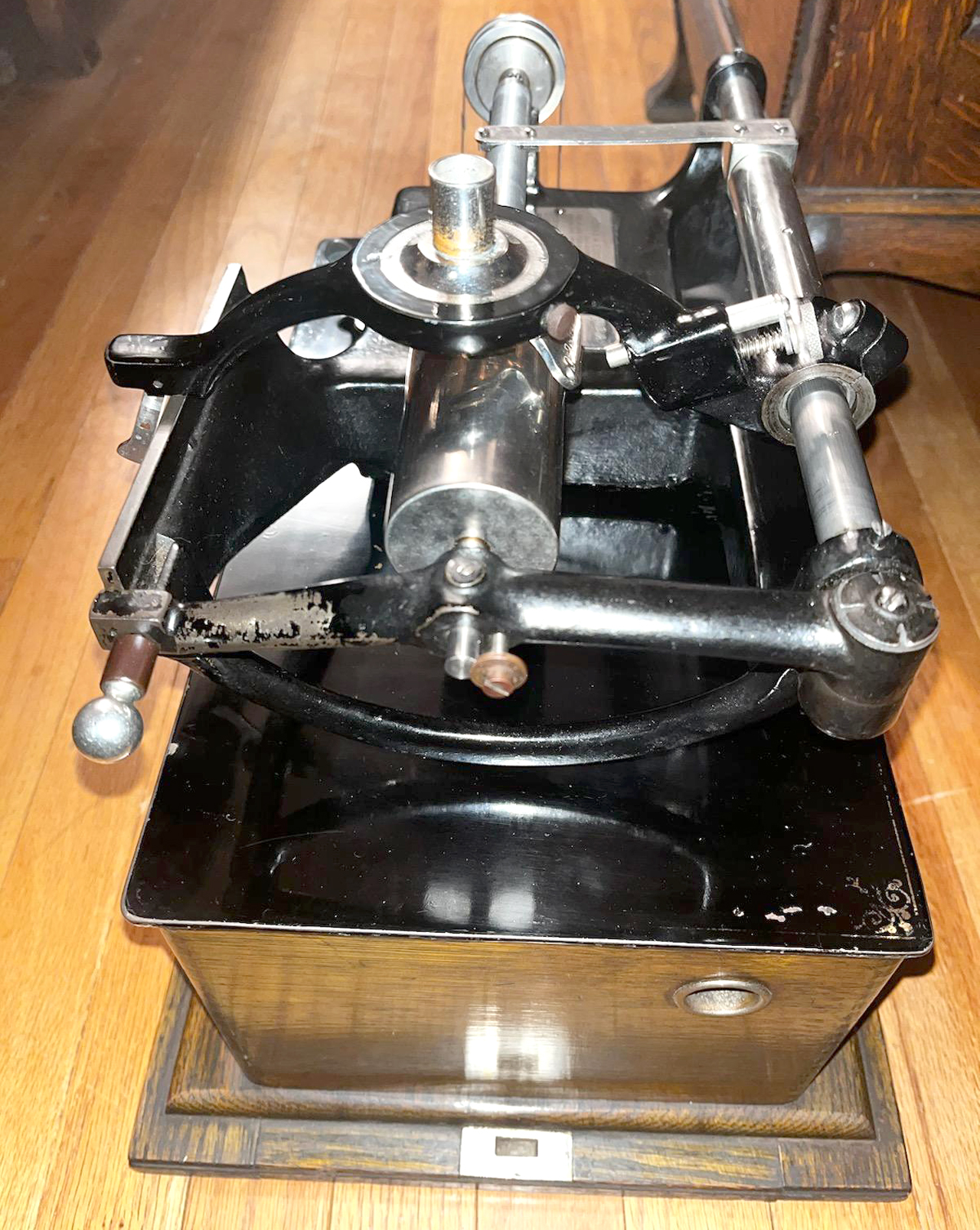

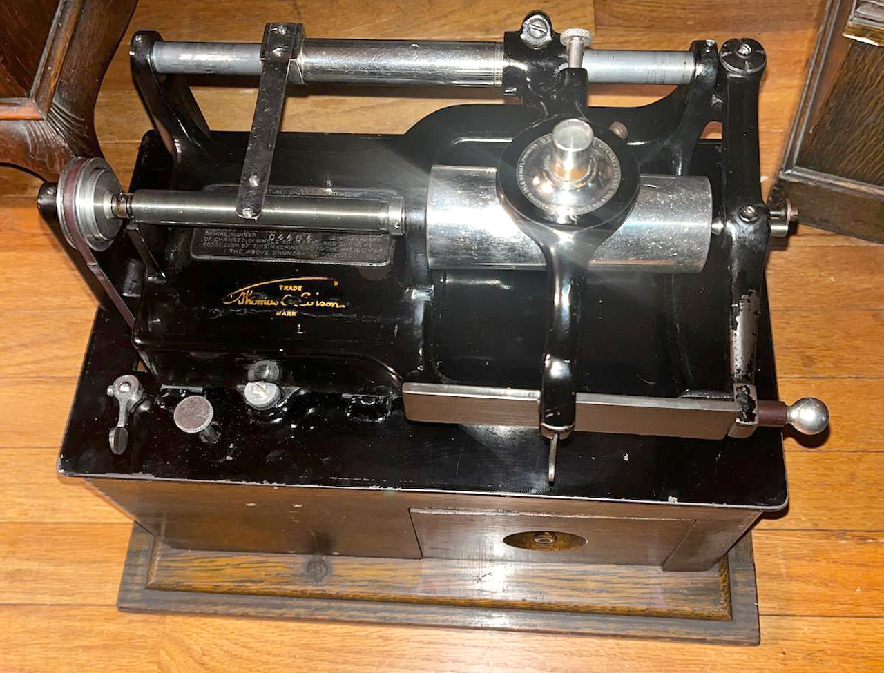

Larry,
Here are some pictures of an original upgrade to standard size cylinder Concert.
Interestingly I paid $100 for this one at a local auction about a year ago. I guess it helped that it wasn't advertised. Another plus
is it has a 2/4 minute attachment.

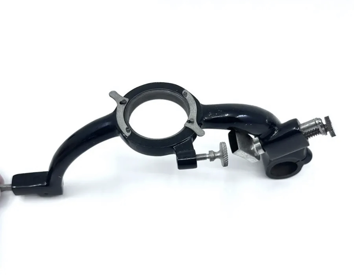

Hi Larry- I almost hate to do this, but two 5" arms and a conversion arm have sold on Ebay fairly recently. But...That means there is hope. They might not all have fit your machine, but...... Maybe another will turn up.

I just sold an Edison Concert 5” carriage on eBay 3 weeks ago $482.
