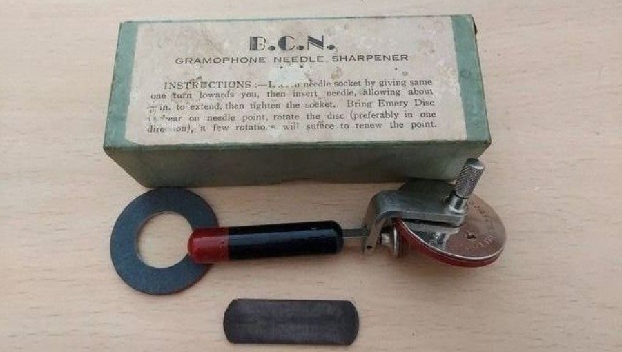

In the pictures, I also often see one or more emery board (like a small, short, broad fingernail board) with these machines. Mine has three or four of different grit. I do not know what these are for or if they are original to the box. Any ideas?
Here is a picture taken from an image search:
Also missing from mine is the red rubber ring that goes around the shank for the needle and protects the emery pad from contact with the metal. In some pictures, I see rings of different sizes. I will have to conjure up something to serve this purpose. I would assume that the rings of different sizes would control the bevel on the needle point.
Here is another picture taken from an image search showing the rubber ring intact.

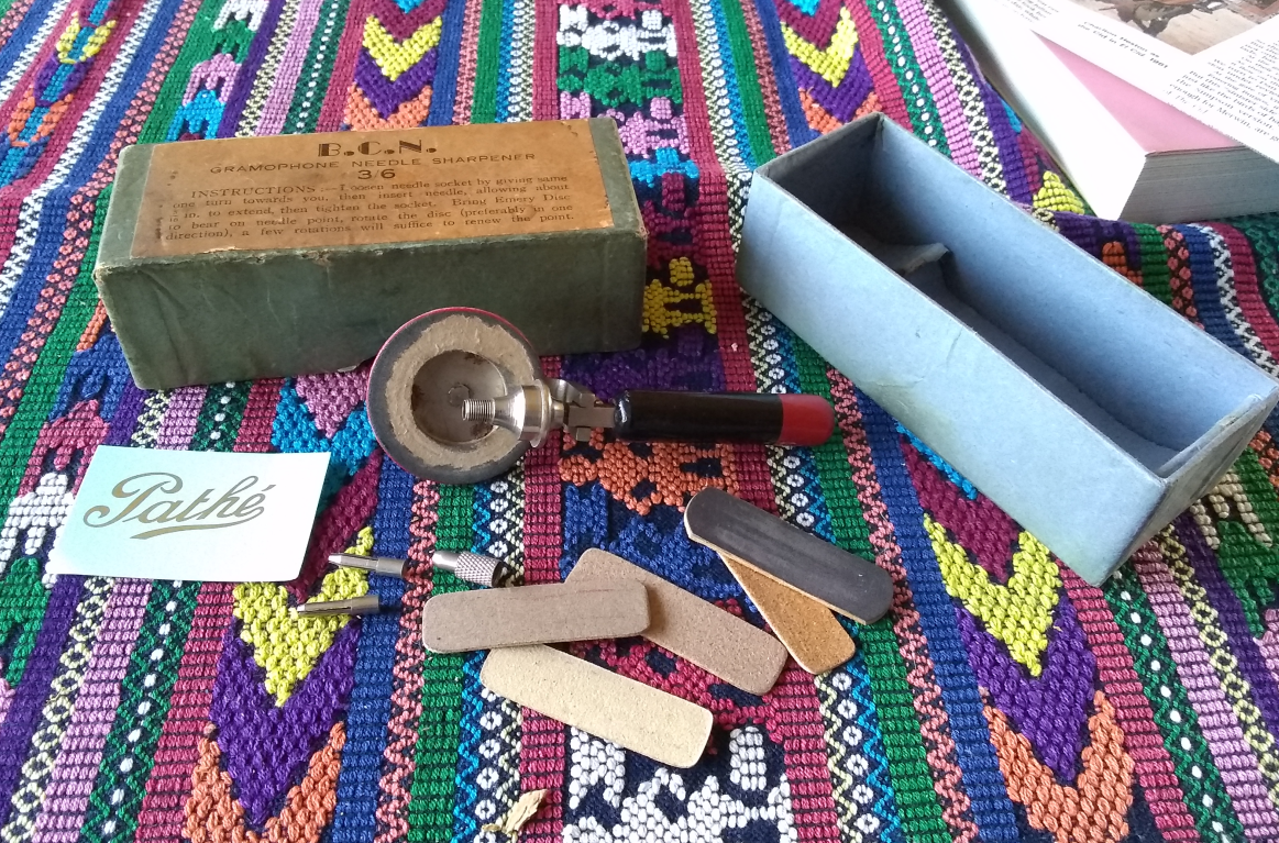

Again I've responded too soon before fully and carefully reading your post! The little things like nail files are the earlier more primitive means of sharpening thorn needles. You had to spin the needle in your fingers whilst stroking it to and fro at approximately the correct angle.
There's another type much less frequently seen which is a flat folded loop of emery paper with the abrasive surface inside - you inserted the needle, pinched the "sharpener" and turned the needle.

Here is what came in the box with my sharpener.
- The sharpener with two chucks.
- Five small rectangular emery boards of different grit, four double-sided, one single-sided.
- A small fragment of wood - looks like lauan veneer.
- And finally what appears to be a gold Pathé decal/transfer.

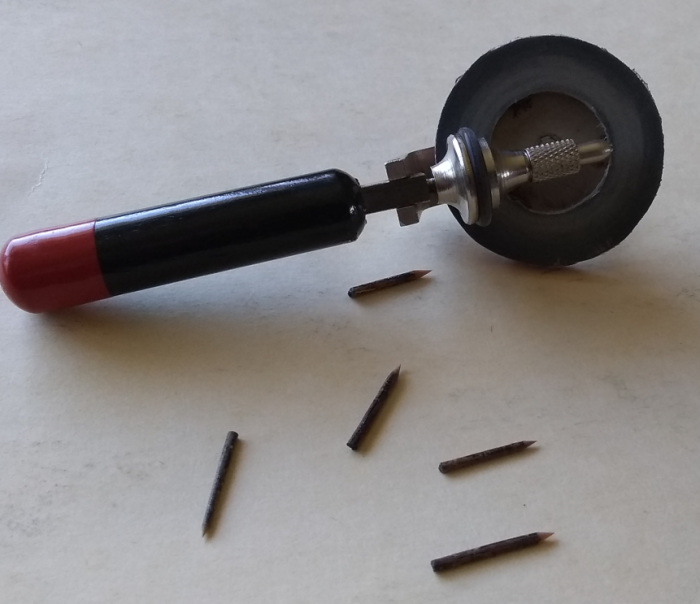

Done ... well ... at least for the first go round.
I ended up having to treat the surface of the cardboard ring with a cellulose filler to get the ruts out of it. I then finished it flat.
I found an envelope with about 30 sheets of 8" by 12" self-adhesive wet-dry emery paper in a box of stuff in my garage. It is too fine for the purpose at hand but it works well enough. I did a free hand circle cut through the back of the paper after tracing the disk on to it. It came out only a little more ragged than a compass cut might have, but then the cardboard ring is slightly out of round now, and I would have had to trim the emery paper anyway.
I gave up trying to find o-rings in the shops and just took the sharpener to my mechanic and hit him up for a couple of trial-and-error-fitted o-rings that seem to work OK.
I tested it with five used cactus needles I have had kicking around, waiting for a sharpener. It works very well but probably a little slower than with a coarser emery paper.
I examined the needles with my jeweller's loupe and decided to do a cork polish on them to remove the sanding dust.
