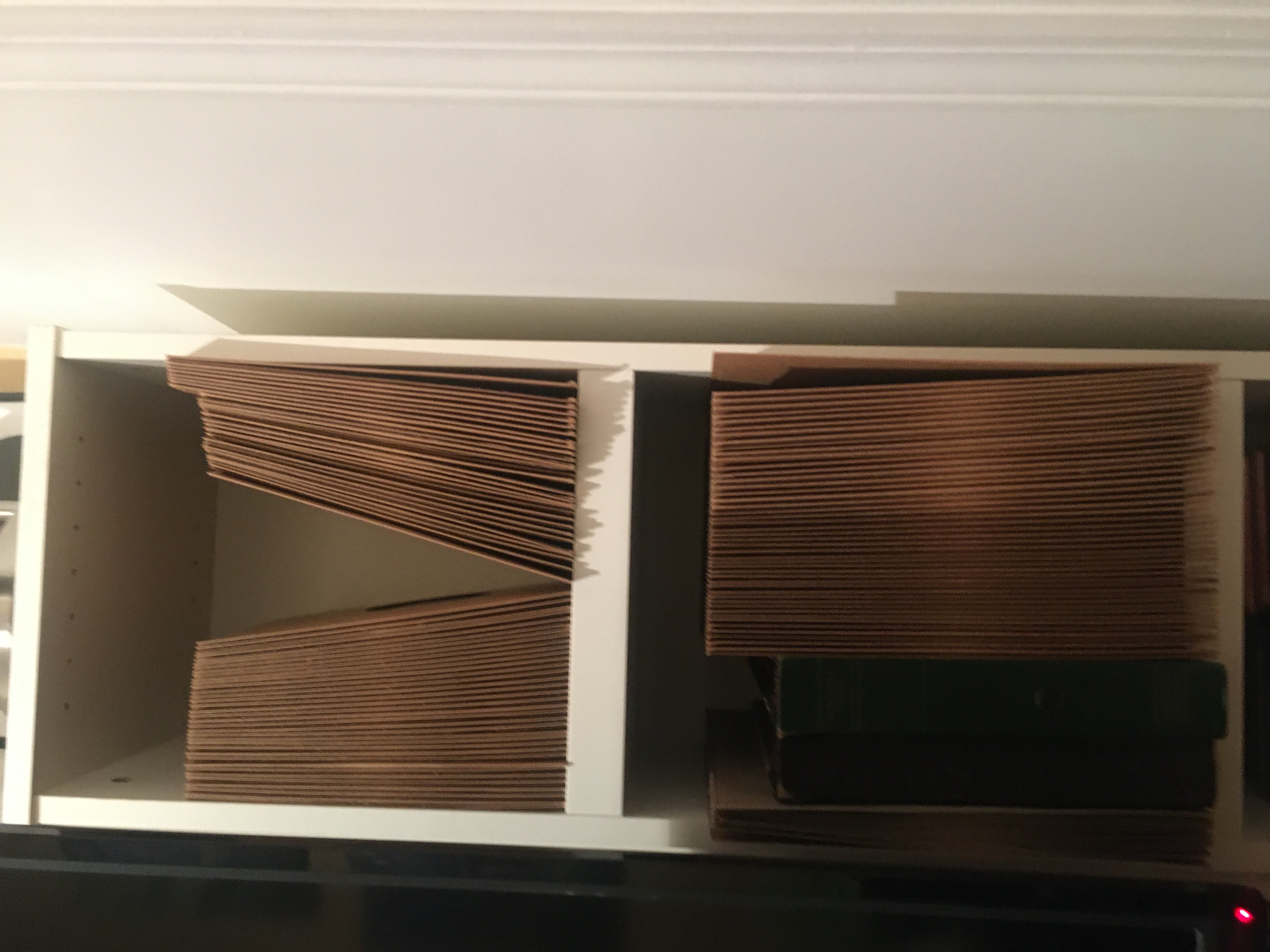

I also use Ikea units for 78’s.
I’m not sure which model this is, or if it’s still being made, as I got them at a thrift shop around the corner ten years ago for peanuts, but they have fixed shelves and the shelves are bolted in very well and are solid and thick. Never any worries about the weight. 48 x 14.
Steven
Steven

Re: Ikea Kallax shelves for 78's
Viva Voce, yours seems to be the Billy.
About the stiffening of the Kallax, the board at the back also serves as retention of the records, anti-dust, etc. But the stiffening function is the most important, for these shelves are very robust for vertical loads, but very weak against lateral loads.
