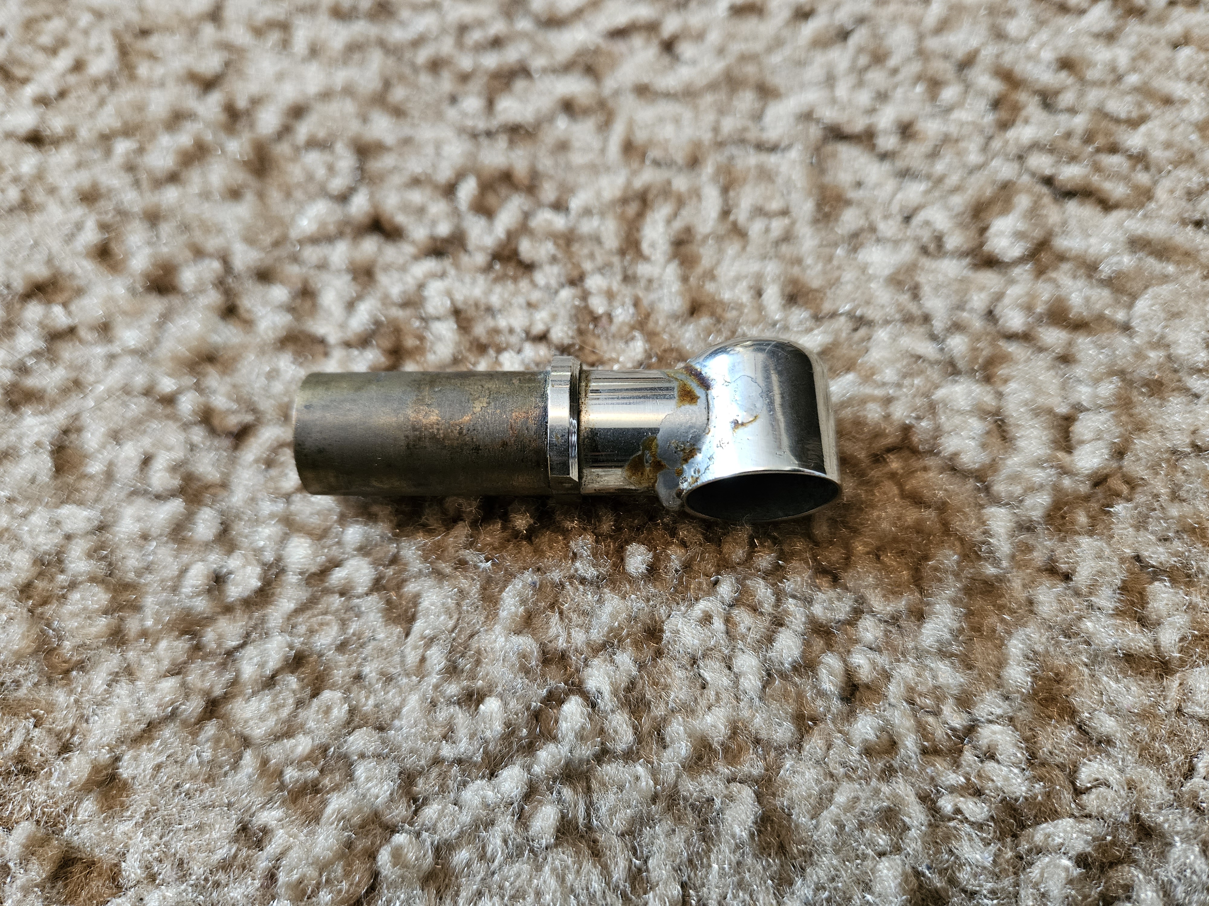

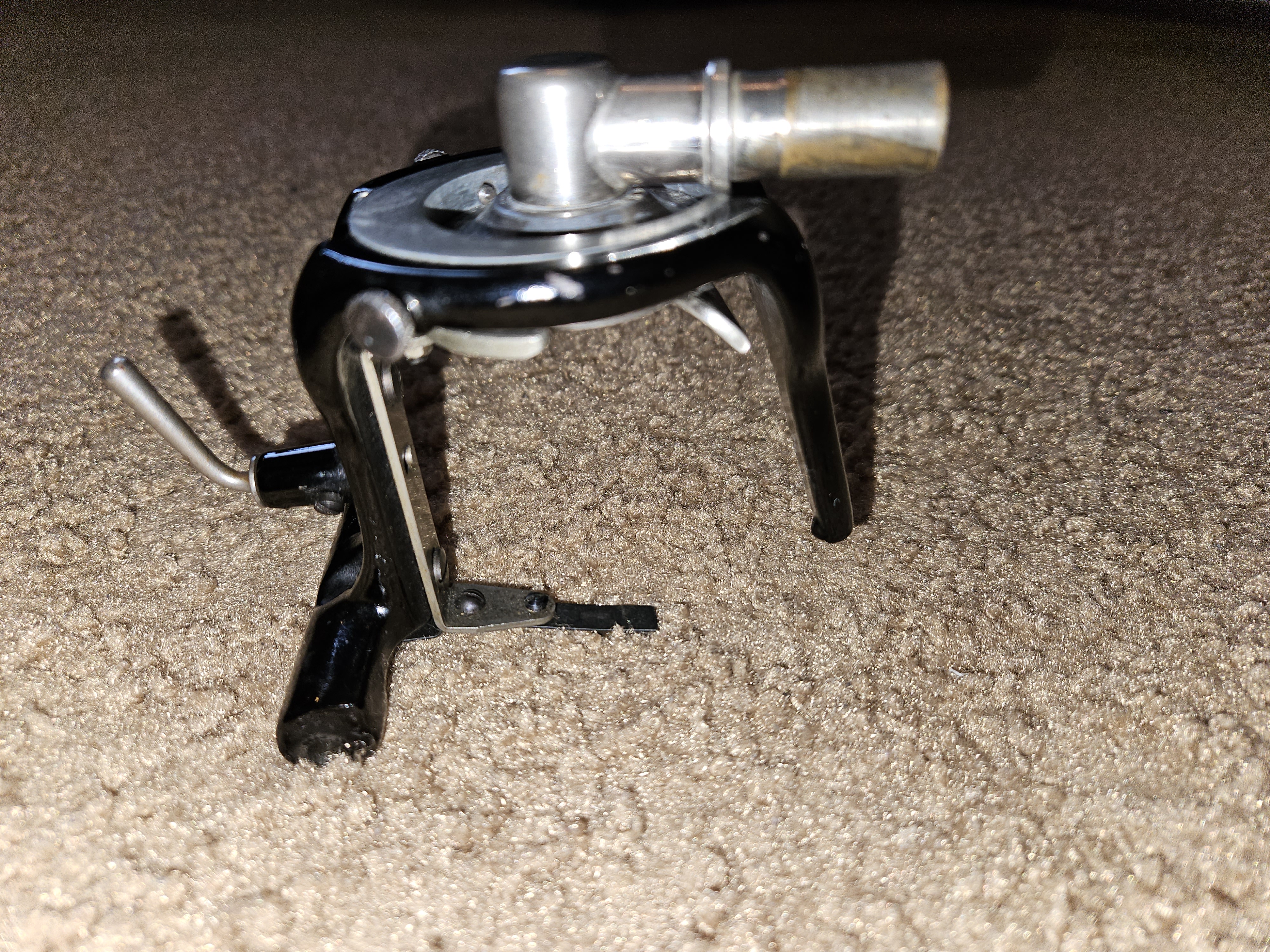

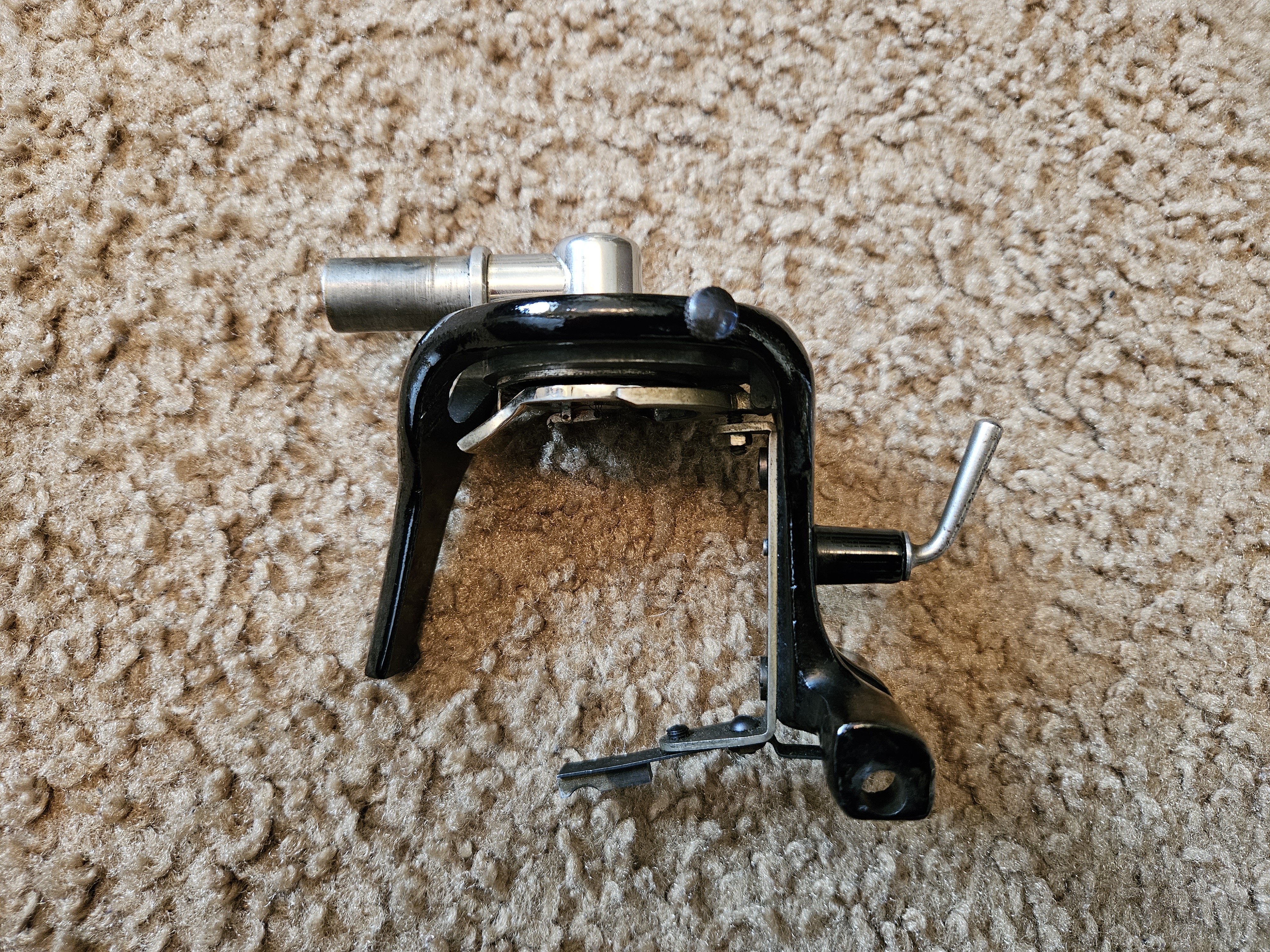

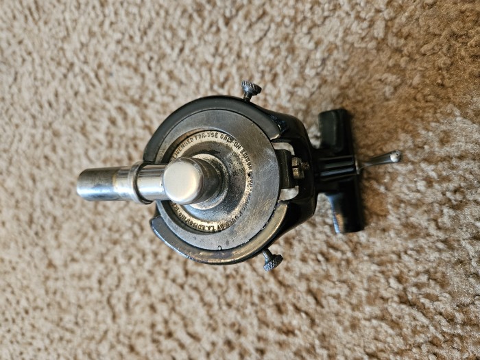

- Posts: 561
- Joined: Wed Mar 16, 2011 10:51 am
Re: ICS Amberola 30 Question

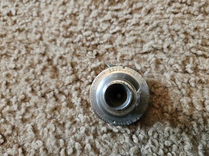

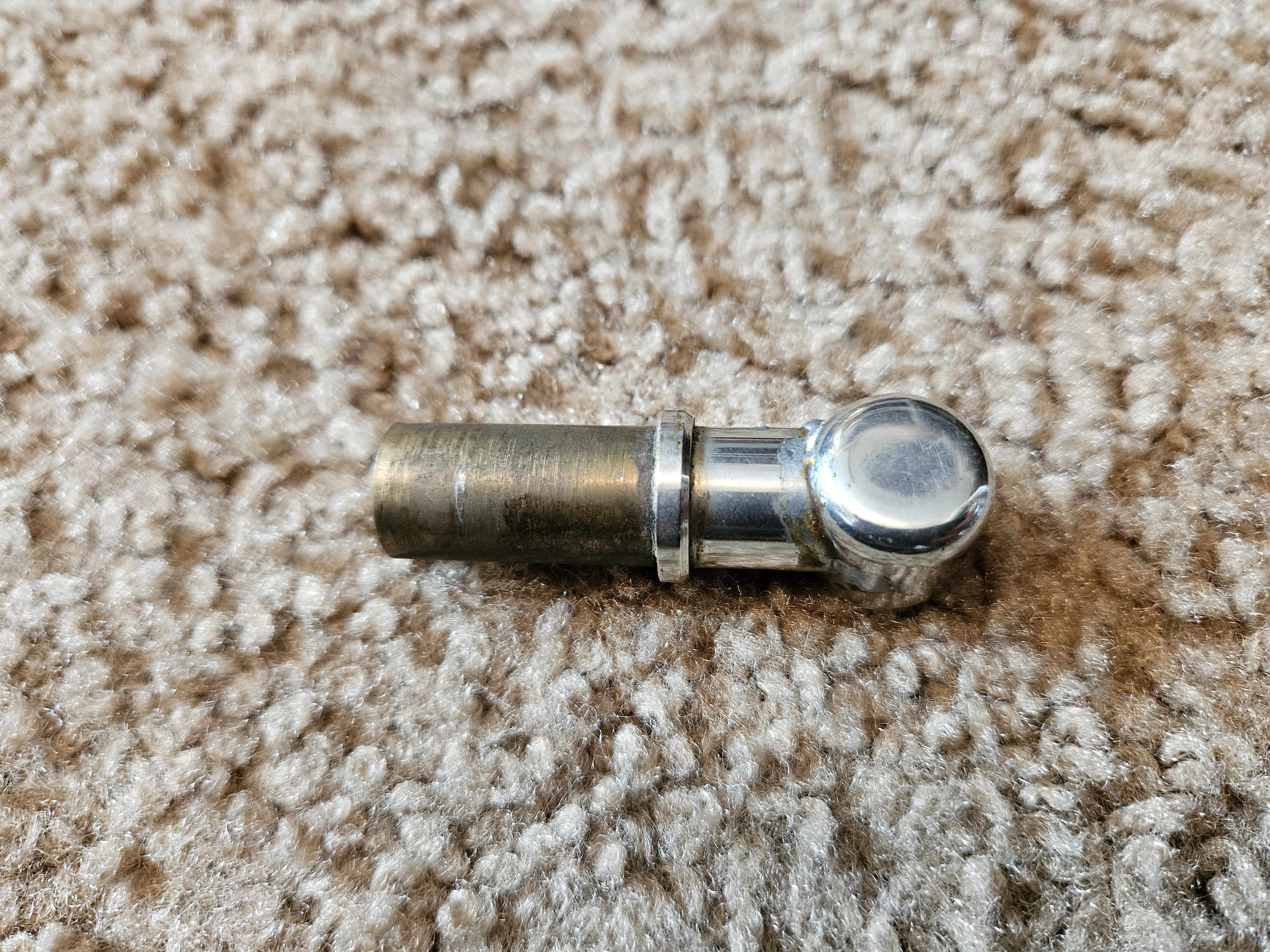

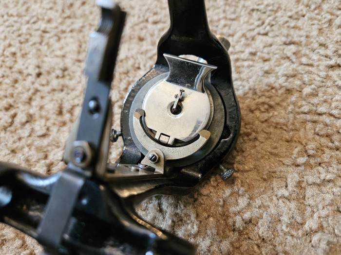

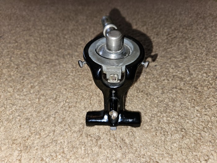

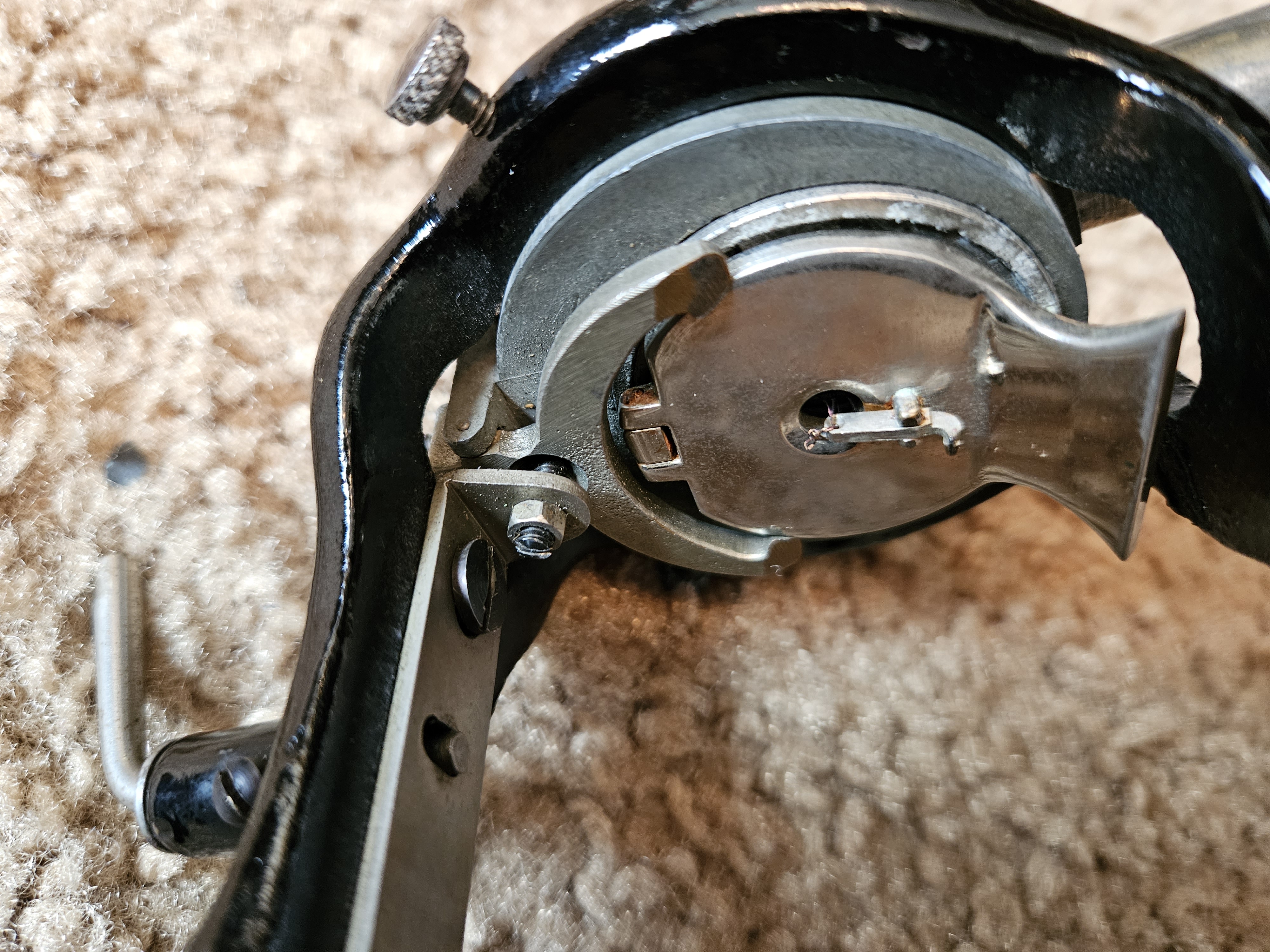

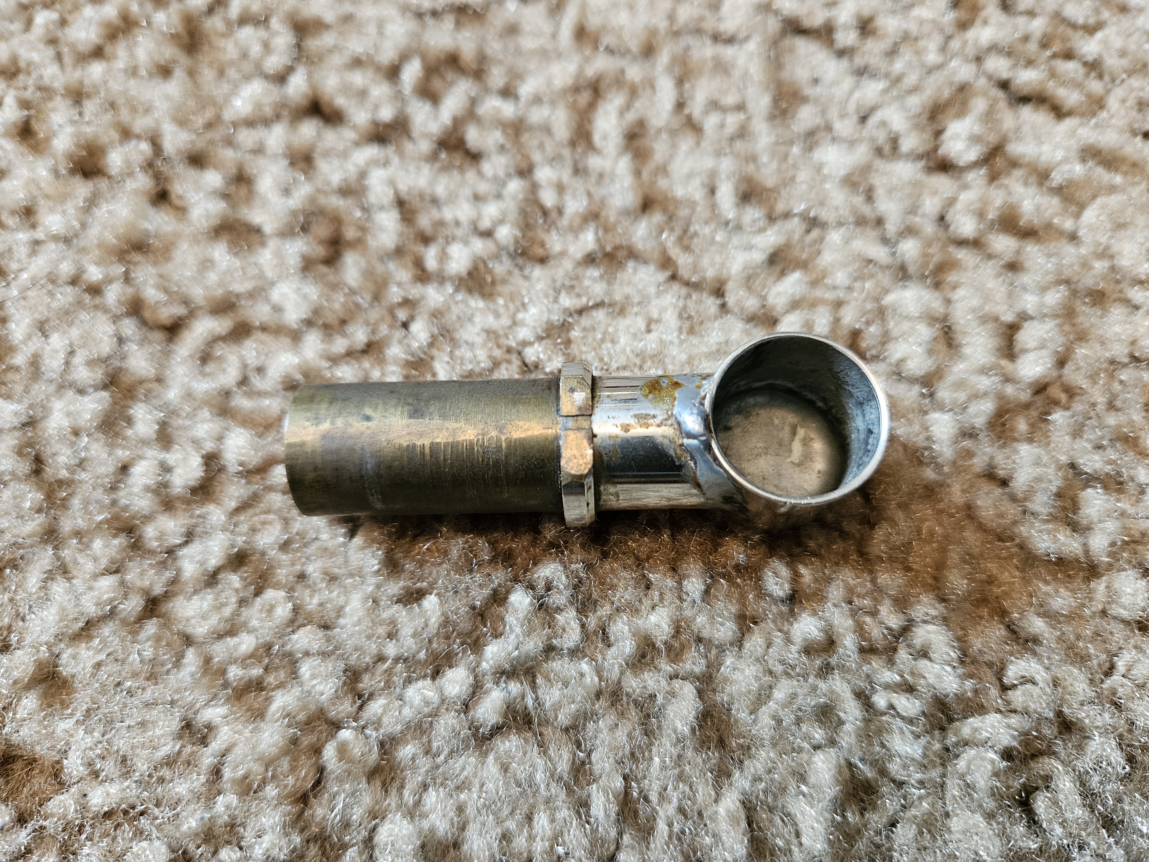

I have had an ICS Amberola 30 but any Amberola 30 can be converted into an ICS machine with the right components.
You need the reducing ring (not just any ring; it has a flipper that works with the Amberola lift lever to raise the reproducer up and down, a specialized Model H reproducer, and elbow.
The reducing rings are made of pot metal and most are chipped or broken and don't fit the phonograph carriage.
I have a complete ICS 30 carriage assembly which is pictured below for reference.
Finding one in good, operable condition is tough.
Scott
Scott
