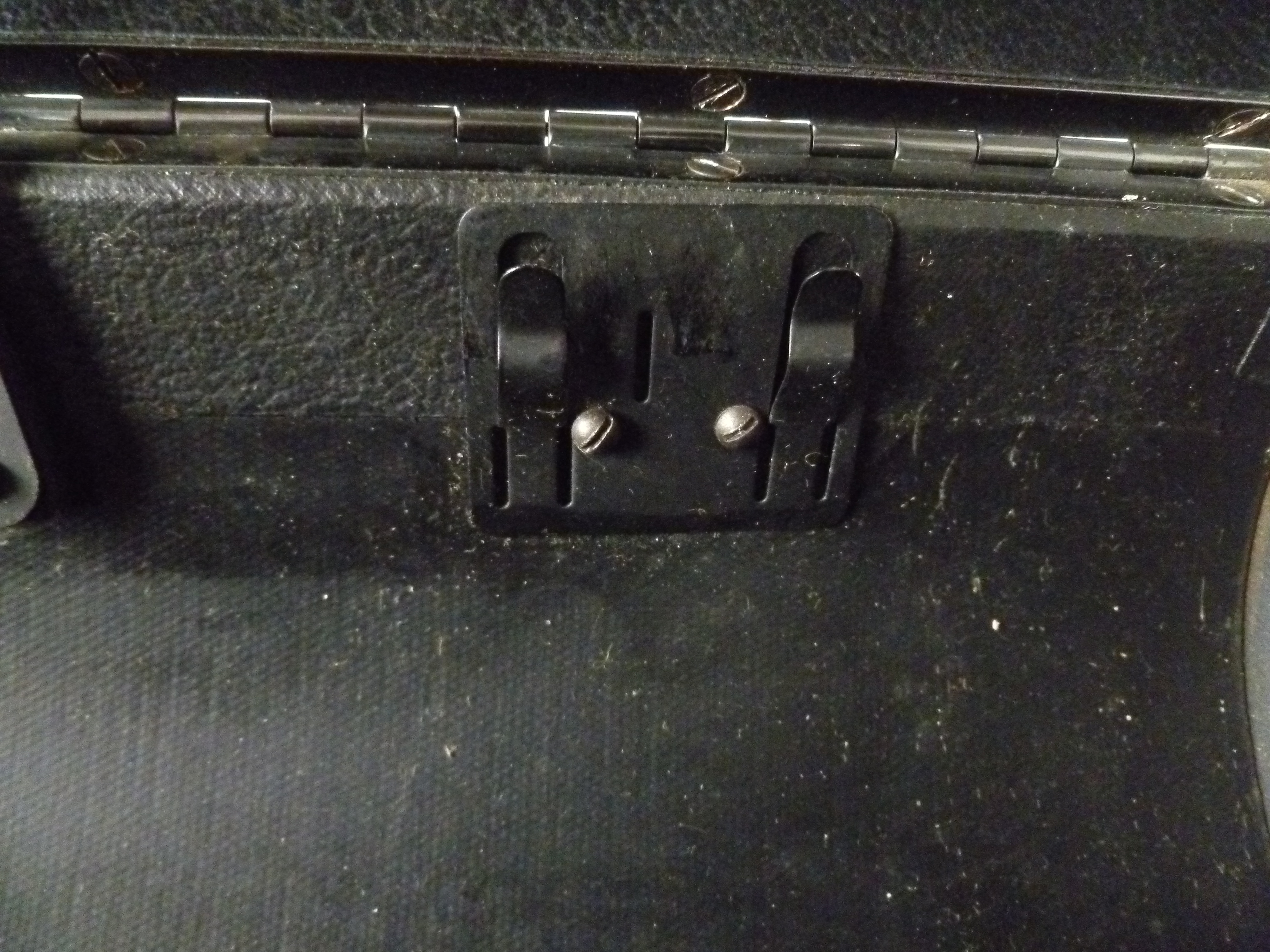

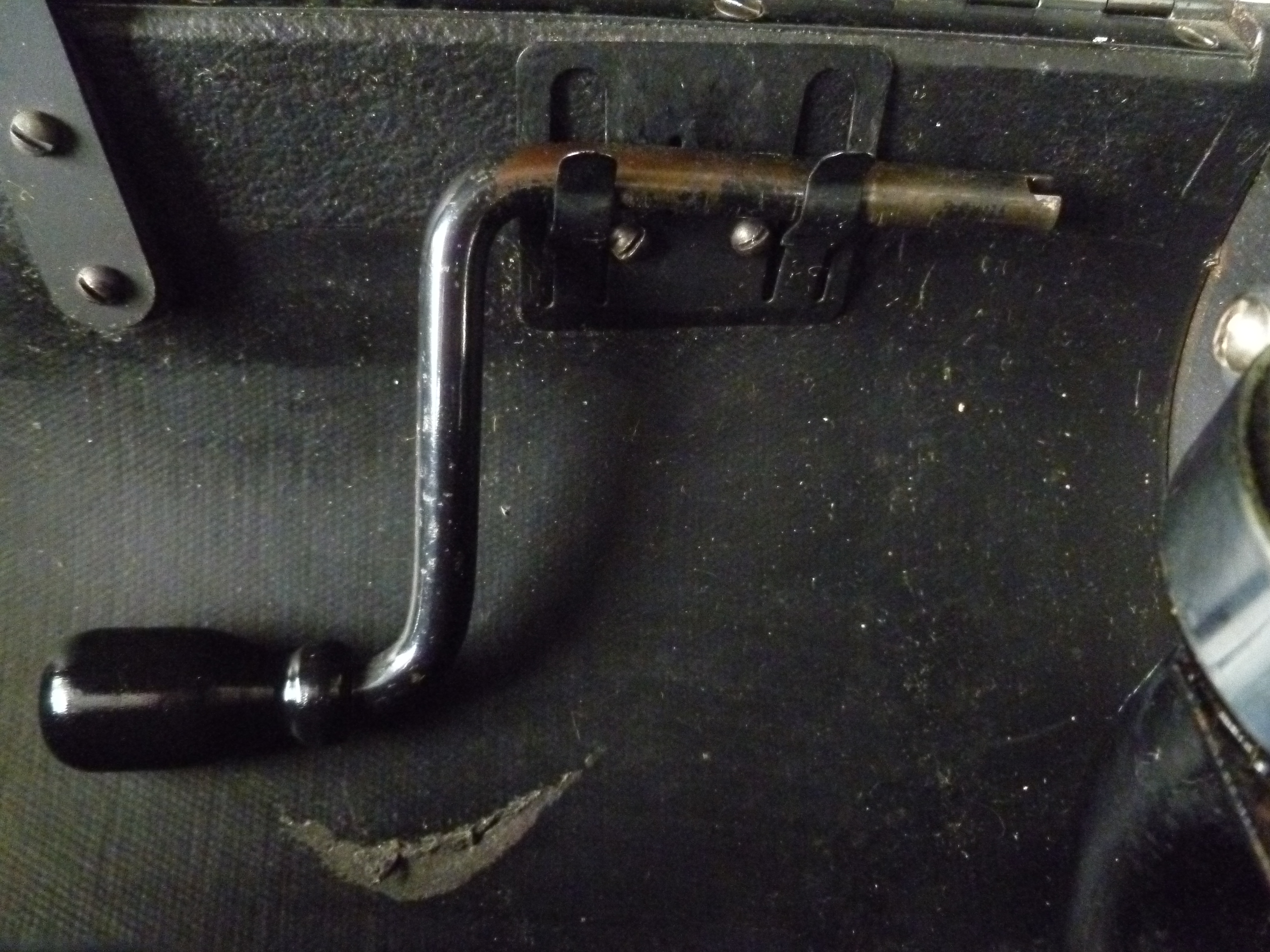

This is the clip you need. The photo is of the one on a Columbia 204, which has an identical clip, but is easier to photograph, because the HMV one is in a more awkward place to take a picture of. If your gramophone is black, this is the one you need, but if it is a coloured version, the clip should be chromium plated. On the 97, it is screwed on the left side of the internal horn, just below the back end of the lid stay. You should find the original screw holes there.Sherazhyder wrote: Sat Apr 15, 2023 12:04 pm If you send me a pic I will have a better idea about it.

Thanks for the pictures indicating the precise location of the storage. Yes , I found the holes for the screws of the clips in the body too. I hope this is going to make the search more easier.
