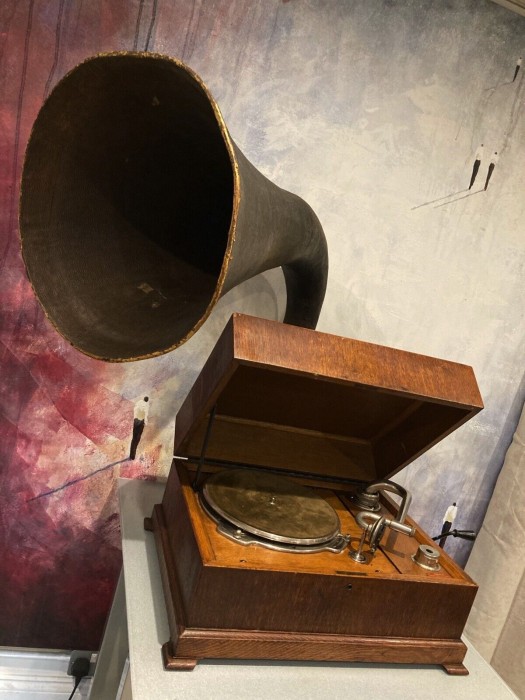

Maybe it will sell quite cheaply as there may not be an EMG soundbox ? Does it have a droopy horn / horn wilt ?
If you are the only bidder it could be yours for 99 pence ? Sadly no make an offer button

I've already pointed out the errors in their listing / thinking as they openly invited "experts to tell them what it is". Now it has bids, I'm not sure they can change the title......anyway, it appears to be an Expert Junior although the pictures are not very good so it could be a Minor. I've given them the horn measurements to check. The horn looks very small in some pictures and bigger in others!
I just HAD to correct them about the sound quality being typical of "100 year old gramophone". That is wrong on so many accounts. If it had the right soundbox it would wipe the smirk of the seller's face.
Don't be fooled. It'll make whatever these fetch today. The seller, although clueless, will not sell it for 99p to anyone. Its somewhat baffling how an uncommon machine can get so spectacularly into the wrong hands.

Apart from discarding that awful soundbox and replacing it with an Expert two-spring, I'm not sure what else can be done to improve it. The out of shape bell will probably have to remain.
Are we decided if its definitely a "Junior"? The seller has argued with me than it must be an EMG because it says E M Ginn on the plaque and apparently it dates from 1920! That makes it an incredibly early non-EMG, EMG.

CarlosV
- Posts: 2194
- Location: Luxembourg
Re: EMG Gramophone
Steve, from the photo the horn bell looks the size of a Junior (diameter slightly larger than the turntable case), but the back bracket is different from mine, that is two-stepped while the one in the photo has only one step (at the connection with the horn). Certainly an older version than mine. It is odd that the bell is not completely round, as the Expert horn normally has a metal ring at the rim that keeps the round shape. I also saw what looks like a used needle compartment, the first I see in an Expert or EMG - it could have been fitted by the owner. The case is also very different from mine.
