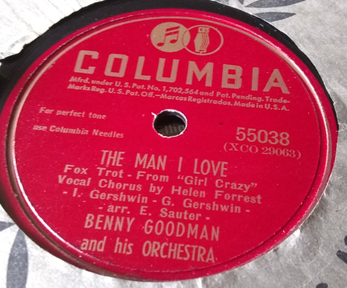

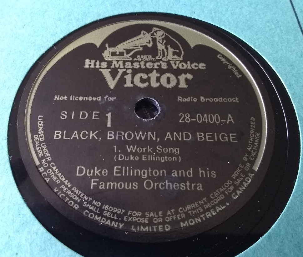

Here is a sample of the labels. I don't think they are vinyl-like records, at all, but the grooves do look smaller and closer together than is common for most 78s I own.
However, groove size may not be the problem.
I have noticed that some of the records in this large haul have an unnatural NOS look. This new-looking appearance is undermined by the very normal sound of loving wear. The records also have a slight waxy, greasy feel that transfers to the fingers if I handle the surfaces. There is no smell--the records have been in deep storage for a very long time. But I wonder if someone has not taken WD30 or a Pledge-like spray polish to the disks in the distant past. I started examining the stylus before and after play of these suspicious records, and I noticed that after play there was a lot of waxy crud building up in a ball around the stylus and that this was raising the stylus up out of the grooves on the records with narrower looking grooves. It wasn't as much of an immediate problem with shorter play 10" disks--a problem, yes, but an immediate problem, no.
So I gave the 12" Goodman disk a good scrub on my vacuum record cleaning machine using fluids safe for 78s and a boar bristle nail brush. I used lots of fluid and let it sit for a bit longer than I normally would with a 78 before vacuuming it dry.
The Goodman record plays fine now with the truncated elliptical stylus, and the stylus came up clean after play. I will move on to the others and see what happens.
