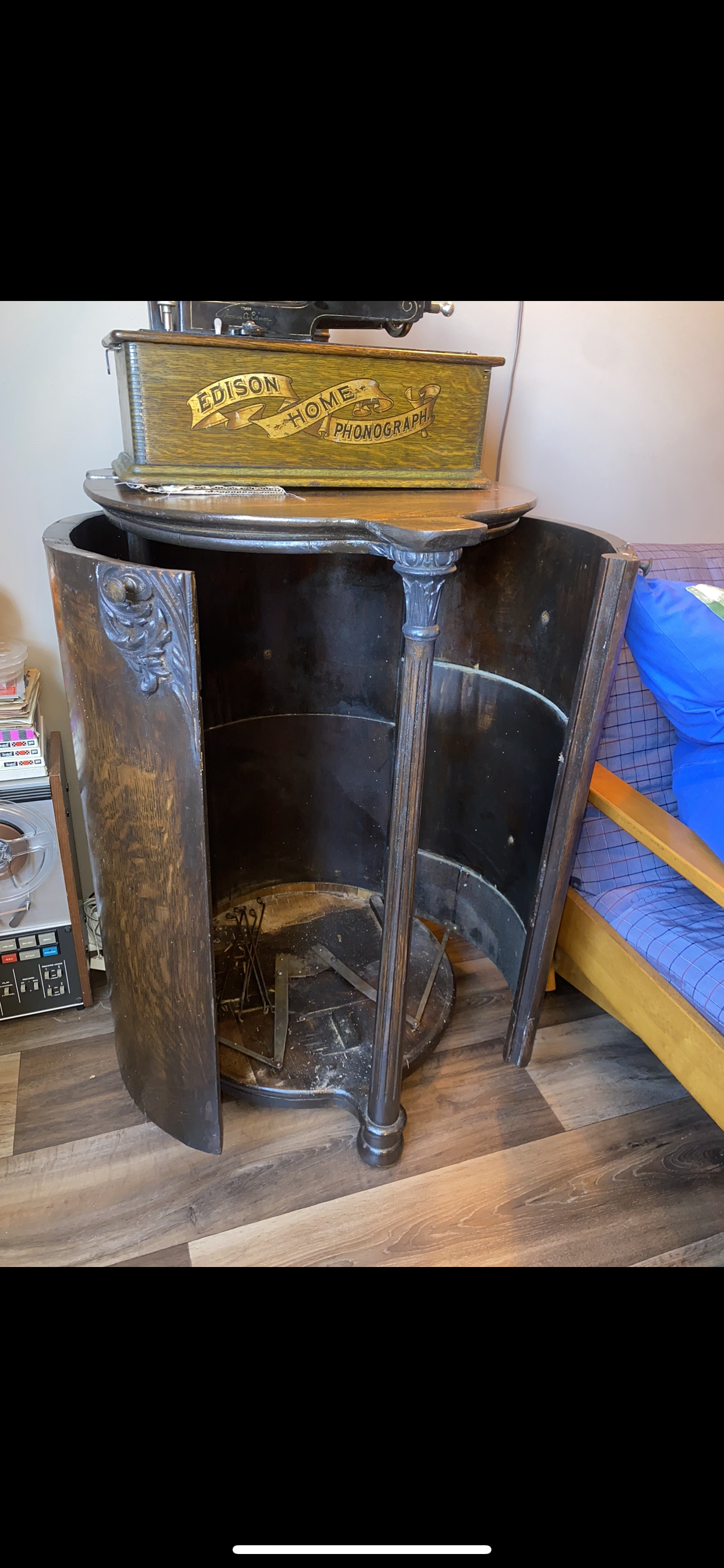

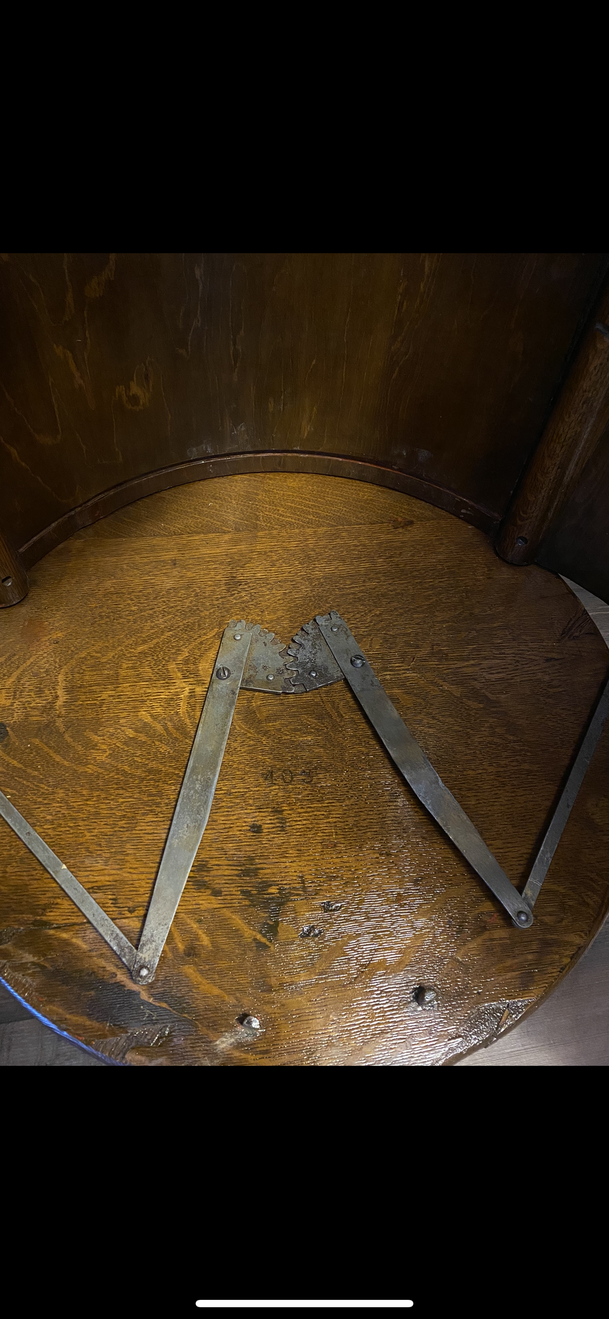

Hey everyone,
I had the chance to acquire another full barrel cabinet. Albeit it’s another huge project… but anyways it came with the original hangars and opening mechanism. So I installed it into the cabinet I restored, and the doors won’t close properly. I can’t see any other way this would go together… so anyone have some thoughts on why the right door won’t close equally with the left?
I still plan on making a brand new mechanism for this cabinet when I get around to making the shelves. I could correct this by making the right one slightly shorter…?
Any thoughts would be appreciated! The lady I got this from said she had some guy do something to one of the parts of the opening mechanism. I have absolutely no idea what he did so maybe that’s the issue?
David

David,
I would question whether or not the arms are attched to the doors in the correct locations*. Might also wonder if the gears are meshed properly, or are they "one tooth off"?
*I wouldn't be certain that just using the original screw holes, if they exsit yet, would be adequate. I don't believe these things were quite up-to-par as far the concept of interchangeable parts.

Re: Full barrel opening mechanism question
Post by Roaring20s »
JerryVan wrote: Sun Apr 23, 2023 4:08 pm David,
It does not look as if it was messed with, but the above thought is a good one.
Do the doors close properly without rods attached?
It's likely but, maybe the doors shrunk and/or warped a bit?

Those pictures of the opening mechanism are pretty good ones; I like the view of the teeth. You can probably trace these or use some sort of whatever-it-is in the university laboratory to copy them for your building a replica of these gears.

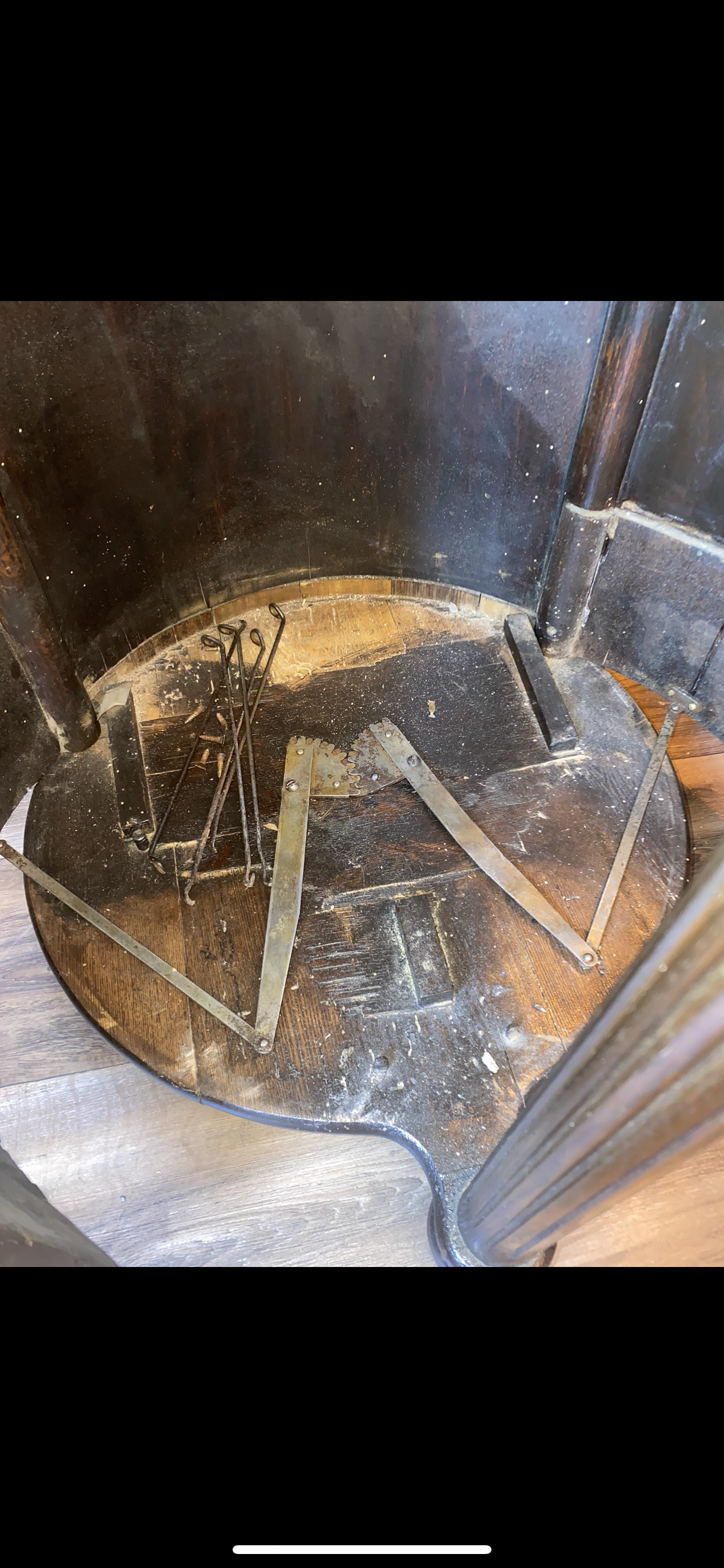

Well this must just be user error :? cause I put it back in the original cabinet and I’m having the same issue.
Anyone have thoughts? If someone who has a full barrel could post a picture of their opening mechanism that would be great….

JeffR1
Posts: 572
Post by JeffR1 »
As others said here, disconnect the mechanism from each door and make sure they both close, make sure the disconnected mechanism isn't coming into contact of the inside of each door and causing the problem, but from the looks of things, you should be able to swing the arms out of the way so both doors can be closed up to their respective "STOPS"
Now that each door can be operated independently, place strips of wide masking tape on the bottom and close that door.
Take a Sharpie and mark the edge of the bottom door in its fully closed position. (you may want to add some masking tape to the door itself as not to get ink on the door)
Do the same to the other side.
The marked edge of both doors will now give you a reference point where the arms should attach themselves.
This will also enable you to operate the mechanism by hand where you can use your reference lines to see if the teeth are not meshed properly and/or of the arms them selves are hitting each other if they are bent.
If someone mounted the ends to the doors in too high or too low of a position because the holes were stripped out, this may cause the arms to come in contact with each other.
With your reference lines there, they should point out where the fault is.
