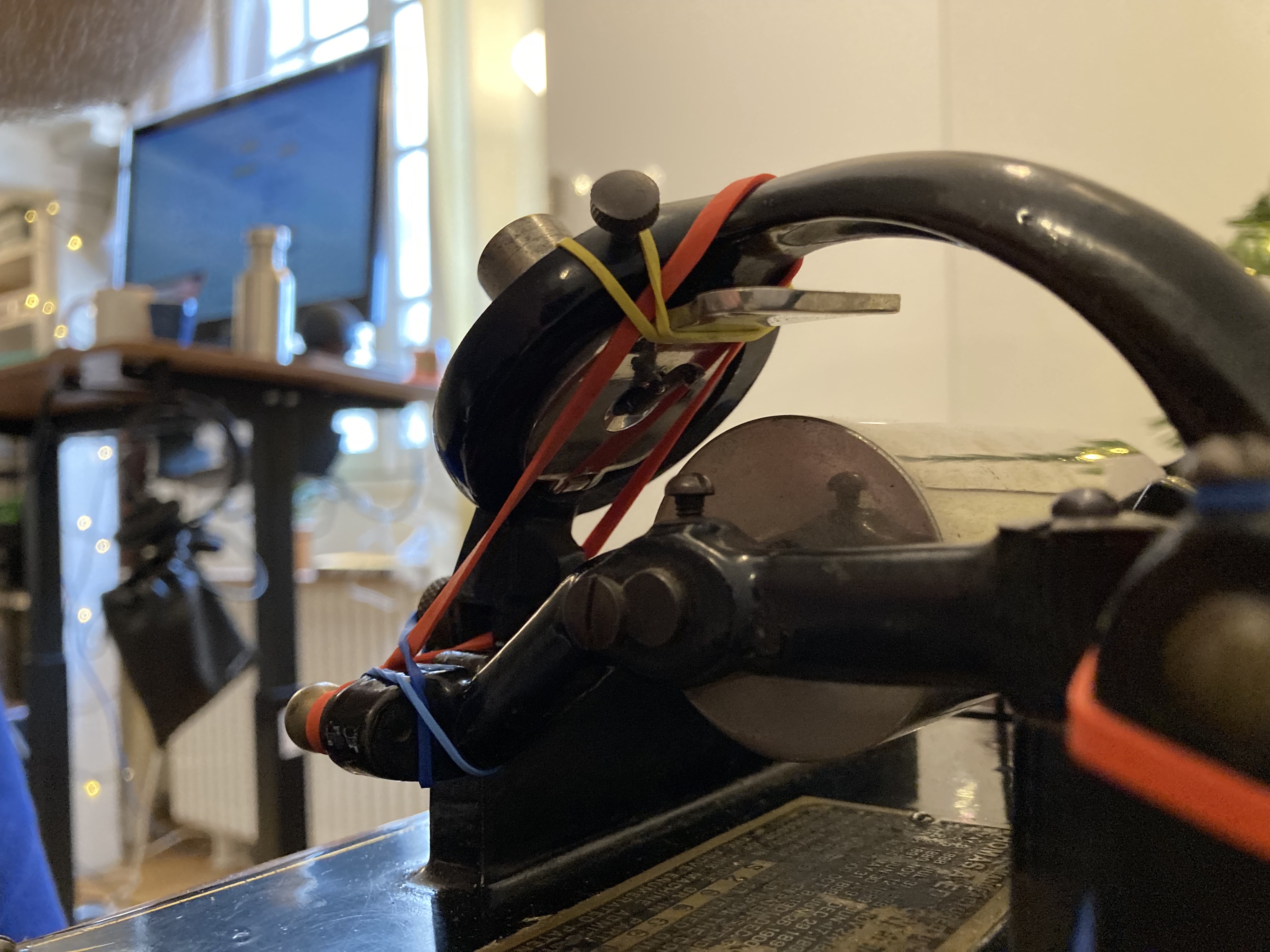

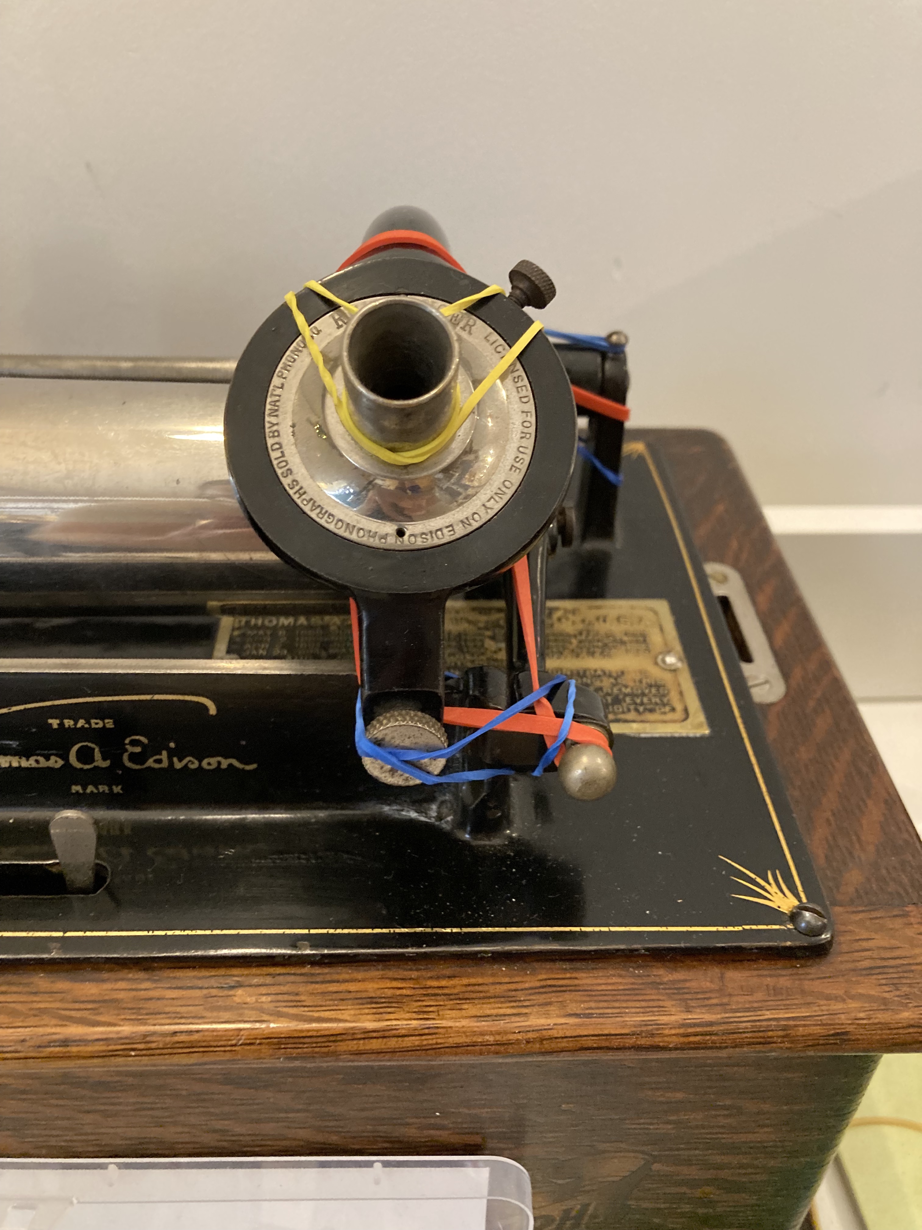

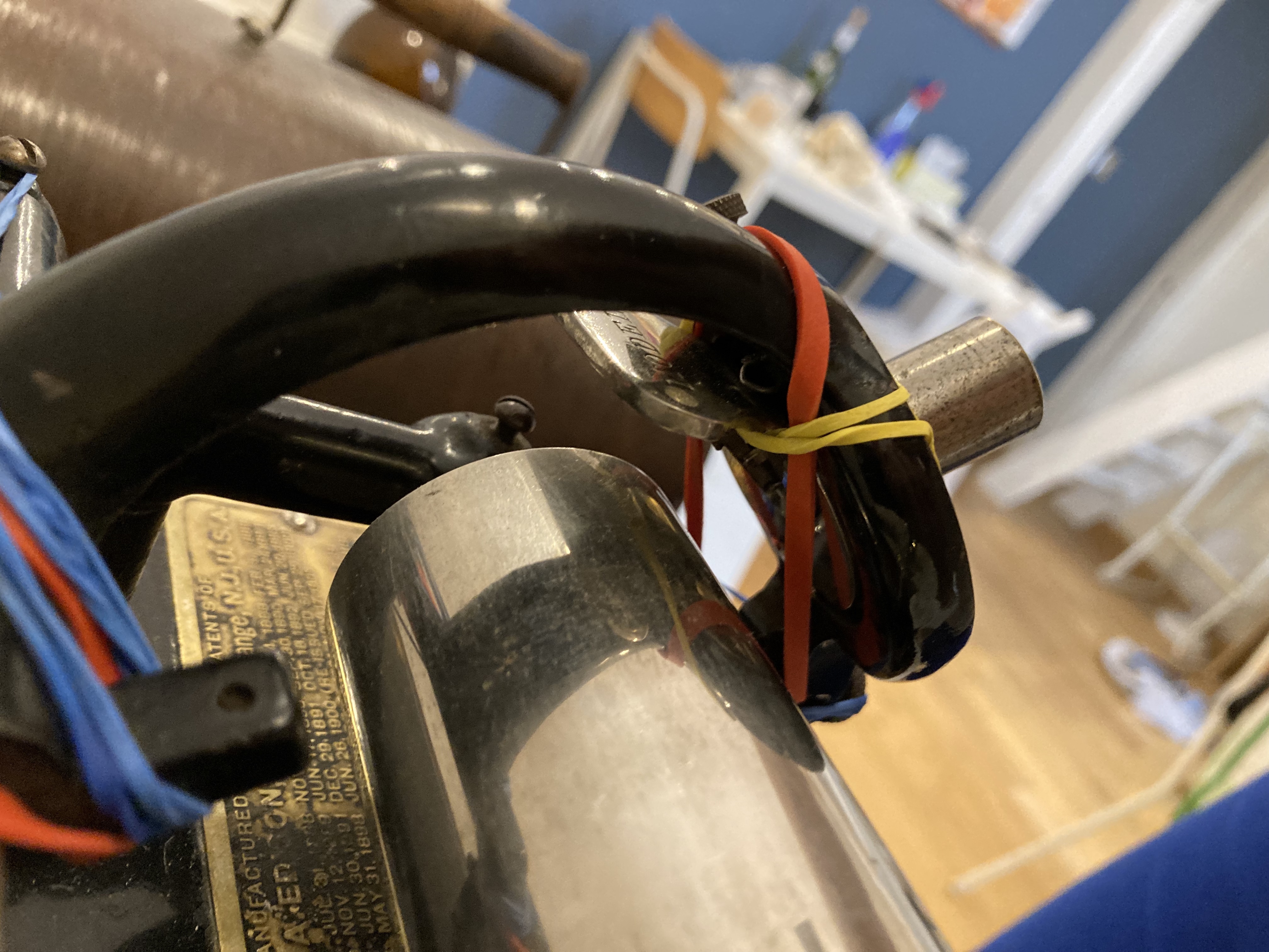

Ok, and one more question! I've been very strategic about rubber banding the reproducer in place (see attached photos). It once was digging into and damaging a 2-minute wax cylinder after a similar carry-on plane journey. After some adjusting and cleaning dust off the stylus, it played like normal. Although I'm not sure that's what fixed it... maybe the crank wasn't wound enough? What usually causes the stylus to dig into a wax cylinder (if I've already confirmed that the cylinder is the correct size for the machine).

A worn or broken stylus will cause it to cut/dig/damage a cylinder. No amount of cleaning or cranking will solve that. However, if it now plays a cylinder cleanly, perhaps a damaged stylus is not the issue.

Personally, I would take the reproducer out of the carriage and wrap it up separately.

And definitely have your stylus looked at; they should just glide over the surface without gouging.
