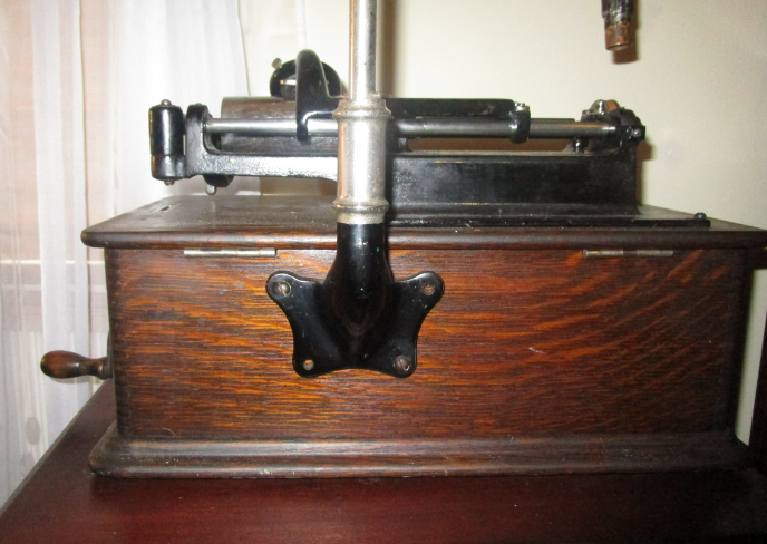

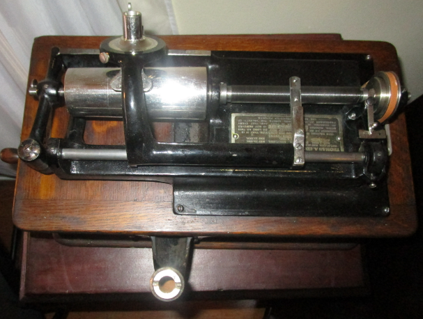

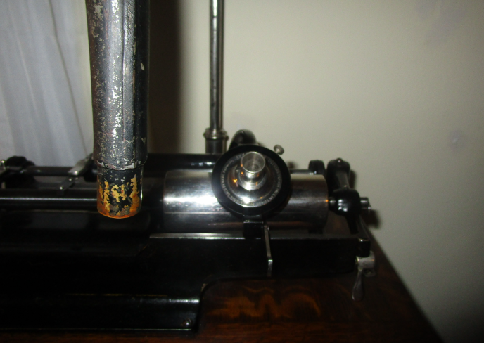

Got some pics!
Screenshot 2023-05-04 5.50.17 PM.png (459.68 KiB) Viewed 541 times
Screenshot 2023-05-04 5.50.29 PM.png (545.36 KiB) Viewed 541 times
Screenshot 2023-05-04 5.50.39 PM.png (475.92 KiB) Viewed 541 times
- Ben

If it works, it works. I would not redrill unless it is a problem.
blizz

Post by Roaring20s »
Oh, that is not good.
At least one of the holes will be covered when it's corrected.
James.
Most un-reamed cylinders sit closer to the right of the mandrel and that make it a bit further out of place. :coffee:
James.

Re: Early style cygnet horn.
Once the new location is planned, I would use a razor blade and cut a section (larger than the new hole) and use it when you fill the old hole. :coffee:
James.

Posts: 6825
Don't do anything until it's proven to actually be a problem.
The "little gadget that slides in & out" is called a Tiz-It. It's an aftermarket accessory that's particularly helpful for this style of horn.
