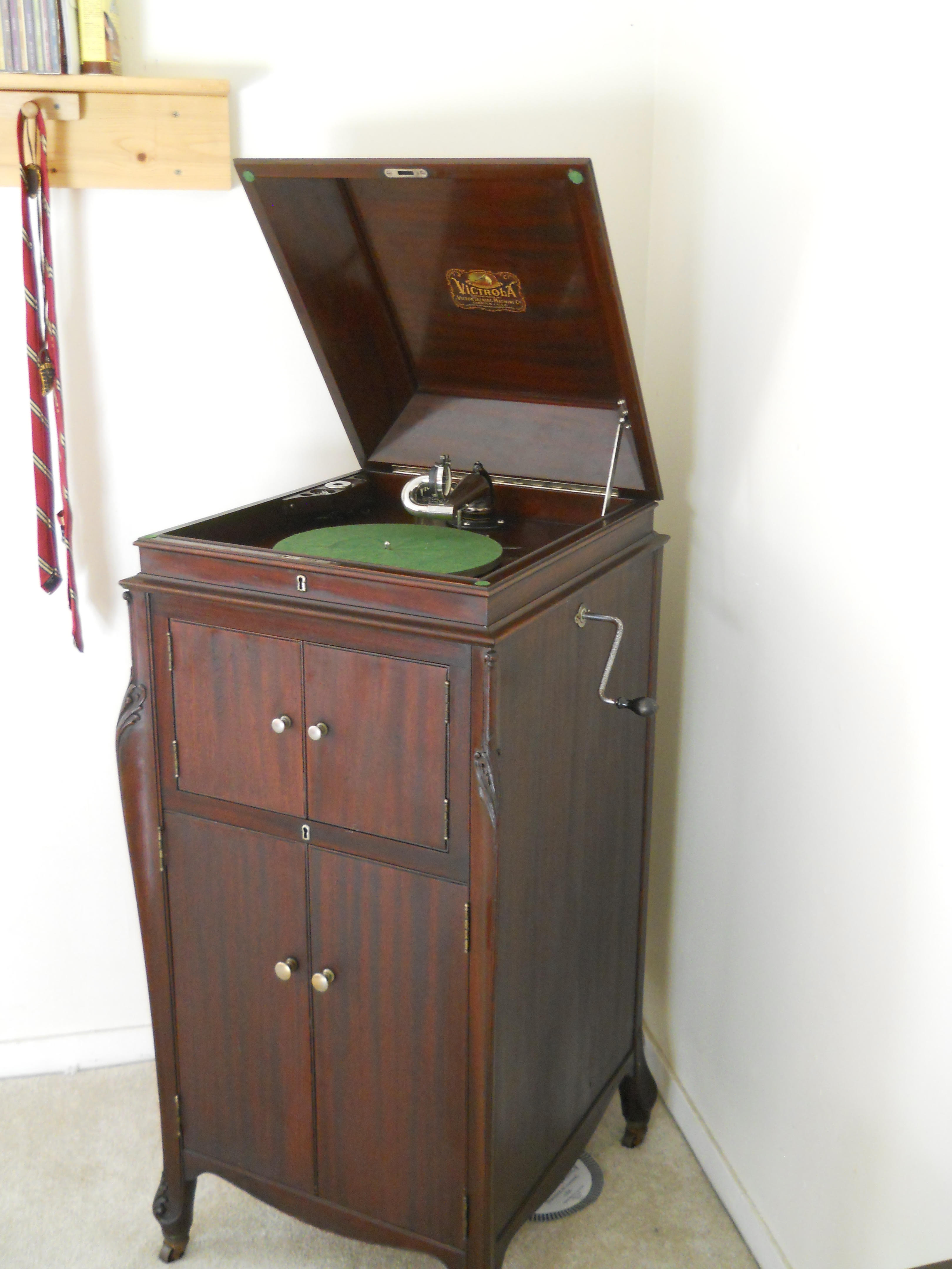

This is the first phonograph I ever bought, when I was in high school in 2016ish. And I've gotten plenty of good use out of it since for my 78s. Even though I picked up a Panatrope, a Victor III, and other great phonographs I still enjoy the XIV.
It is a 1914 VV-XIV, E series, large crescent speed indicator and 3-spring motor. It's "restored", a little, I guess. I fixed it up when I was inexperienced and it was the first phonograph I'd ever seen that wasn't in a museum or anything. Bought it to keep the antique dealer in town from cutting it up and making a file cabinet out of it. She had been selling it at a high price but couldn't get rid of it because it looked kind of garbage and came with a plastic bag of broken parts.
I put a while into it and got it going. But I'm redoing the motor soon. I was taking it apart to service the mainsprings when I found one was cracked partway across. It's too close to the inner coils to repair, and I might as well change all three.
The speed indicator is also a mess; it works but the leather is shot.
I'm not sure if I'm going to do anything to the cabinet.

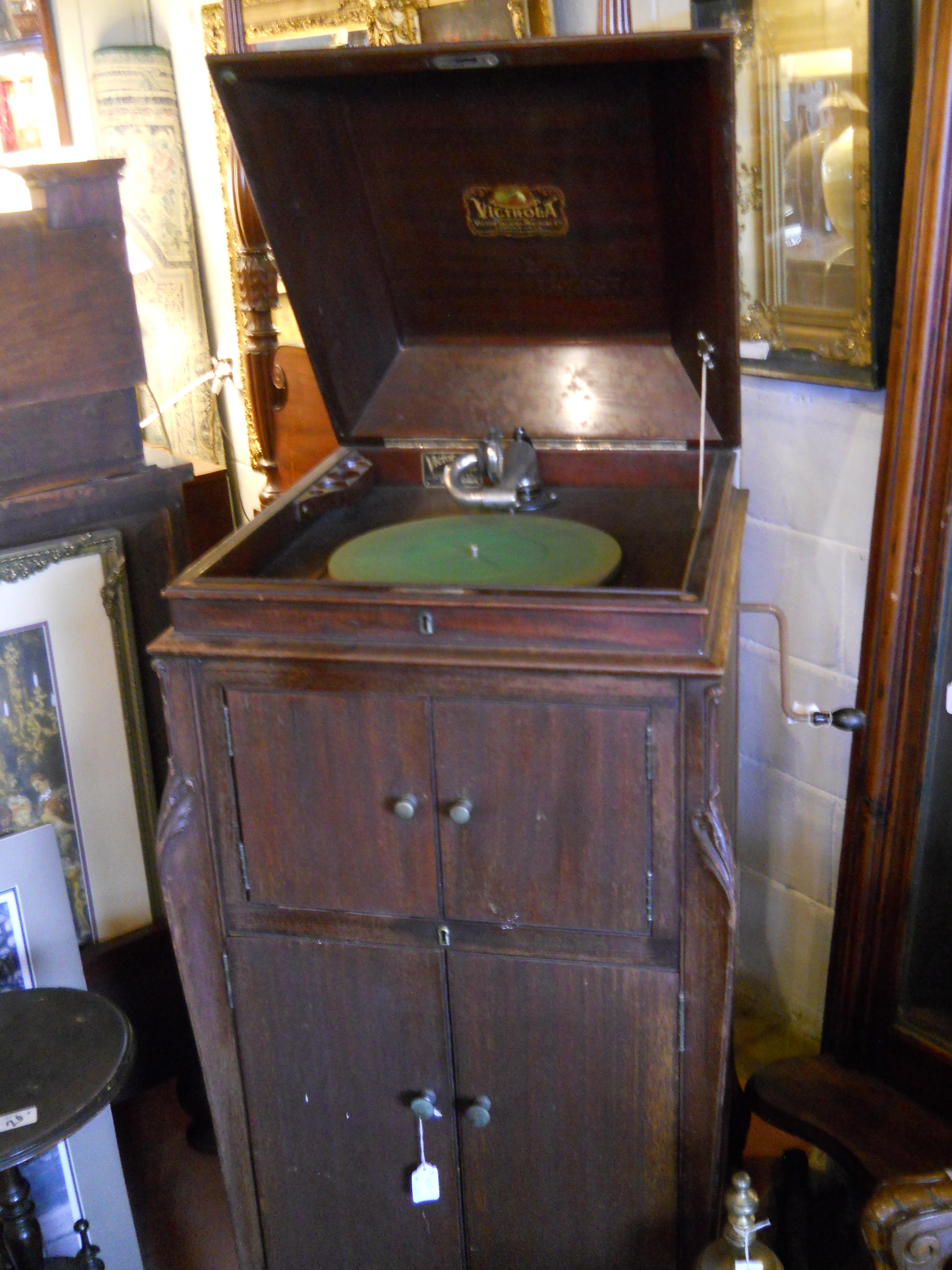

This is what it looked like when I found it. Admittedly this is pretty awful. I thought I'd found a prize, but realized pretty quickly, reading Paul Edie's "The Victor-Victrola Page," that this was definitely a fairly common and not particularly desirable Victrola, and was quite old. Instead of being from the 1920s it was more like 1914. Did not expect the Exhibition soundbox to work that well--of course I'd never heard a Victrola except for one time in an antique store so anyway.
I spent weeks and dollars on it--got the motor going first, then rebuilt the reproducer and tonearm, then replaced the missing back panel and finished it to match. I glued down loose veneer, tightened a back leg that was threatening to fall off, reinstalled the wooden back to the album shelves in it, made a new indicator card for the speed dial, rebuilt the governor and packed stuff with grease that looked like it could stand some grease.
When I got done, the old Victrola looked a bit more like this:
Right now, though, it's been in rather shabby condition as it has gotten dents and dings in it, has had stuff piled on the lid of it-- Life has not always been easy, and it hasn't exactly been kind to the Victrola either. I may actually re-amalgamate the finish instead of using Howards' Feed-n-Wax and all that. The ultimate would be to replate the knobs and the turntable, or all the brightwork all over it--it's all wearing. The crank was so badly rusted when I got it that I had to scrub it within an inch of its life, and though I was going to replace it I figured I'd keep it as it still winds it up anyway.
