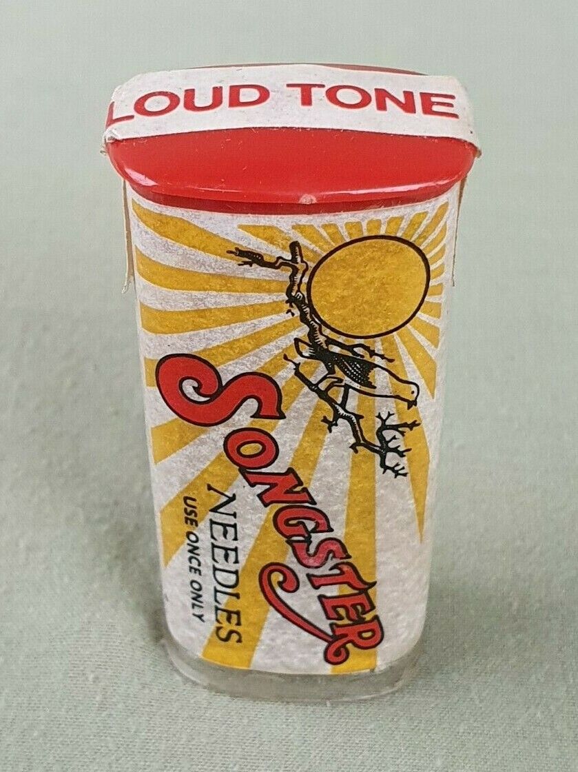

I wouldn't like to guess at the reason in this case, but this reminds me of a problem with newly-made needles I experienced 15 or 20 years ago. I bought a quantity of needles from a UK producer - they were in rigid plastic tubes with the old Songster design on them. They would never last a side. I spoke to a technical manager who immediately became defensive, almost belligerent, insisting this was impossible, and I had the impression it wasn't the first time such a comment had been received.
They still turn up on eBay from time to time; these look identical https://www.ebay.co.uk/itm/164521113005 but in all fairness, they might be OK, who knows.
