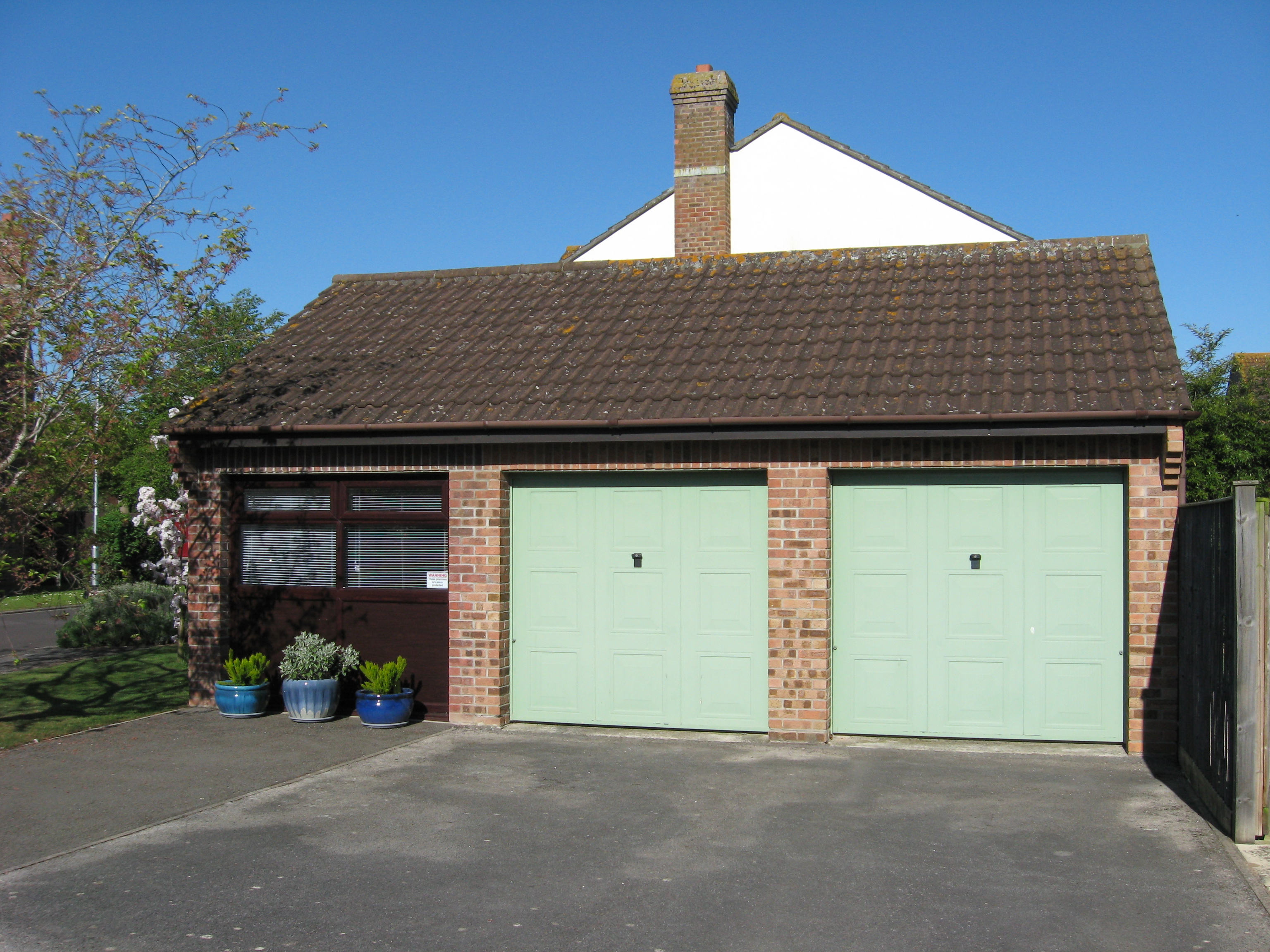

Even storing machines in a loft is risky because of the extreme range of temperatures.
A wooden outbuilding should be fully insulated and have a low level heater for the winter months.
My house has a block of three brick built garages with tiled roofs, one double and one single. When I downsized from three cars to two (one modern and one classic) I converted the single garage to what my grandchildren call "Grandad's Den". The up-and-over door was replaced by a double glazed window and lower panel, the walls and ceiling were dry lined and insulated, the floor was insulated and covered with a heavy duty vinyl. A night storage heater was installed as I am on the Economy 7 tariff, there being no mains gas in my village.
The conversion was not cheap but has proved very well worth the cost. I can work in there whatever the weather.

Very interesting indeed. This looks like the ideal place to store gramophones and a magical place to be.epigramophone wrote: Mon May 29, 2023 2:54 am Even storing machines in a loft is risky because of the extreme range of temperatures.
Thank you very much for taking the time to share this epigramophone.
