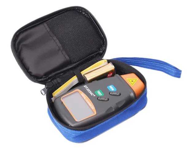

I bought a cheap generic/white-box digital laser tachometer today, a DT-2234C+. It cost $27.00 CDN or about $20.00 US. I bought it from a guy running a business out of his garage. I could probably have gotten it cheaper online, but hey ....

I have that exact tacho. I found the battery ran down quickly, because the buttons aren't very well protected. If the unit is placed upside down, or something put on top of it, the buttons are pressed (the grey ridge before the orange tip isn't big enough to protect the buttons). I made a plastic cover with some raised supports inside, to fit over the tacho so the buttons are protected. It fits within the zip cloth cover.

My tach did not work properly out of the box because the device seems to need a battery with a full charge. The cheap no-name, presumably Chinese-made and obviously slightly swollen, battery that came with it did not register a full 9 volts on my cheap, but long-lasting and durable (if somewhat mildly inaccurate with very small voltage, amperage, ohm, and capacitance readings), Chinese-made multi-meter. It's all good (so far) with a fresh Home Depot purchased, Defiant brand, Chinese-made battery. :lol:

AudioFeline wrote: Sun Jun 11, 2023 4:52 am I have that exact tacho. I found the battery ran down quickly, because the buttons aren't very well protected. If the unit is placed upside down, or something put on top of it, the buttons are pressed (the grey ridge before the orange tip isn't big enough to protect the buttons). I made a plastic cover with some raised supports inside, to fit over the tacho so the buttons are protected. It fits within the zip cloth cover.
Having had to rely on battery operated tuners, metronomes, effects pedals, etc, I never leave batteries in anything, except remote controls and flashlights, and even with these two types of devices, I am sorry sometimes. I am still trying to clean the corrosion and battery puke out of the remote control for my expensive CD deck, and these batteries were premium name-brand alkaline ones. But then, I suppose you can never really be certain about anything anymore--there are a lot of knock-off products floating about.
As said above, my tachometer does not seem to work unless the battery has a full charge. The LCD panel will light up, but the laser light only comes on momentarily and the device reads nothing, if the battery is not strong.

Like AudioFeline, I have not had issues with mine either. I have the original, poorly, written instruction sheet and it tells you to disconnect the battery when not in use. I have had it for over 5 years and am just now on the second battery. Really like the unit and it works well.

I had the exact same experience. Mine works fine. After the first battery drained quickly while in the case, I now remove the battery after every use. It make sense since I only use it a few times a year. No problems since.
