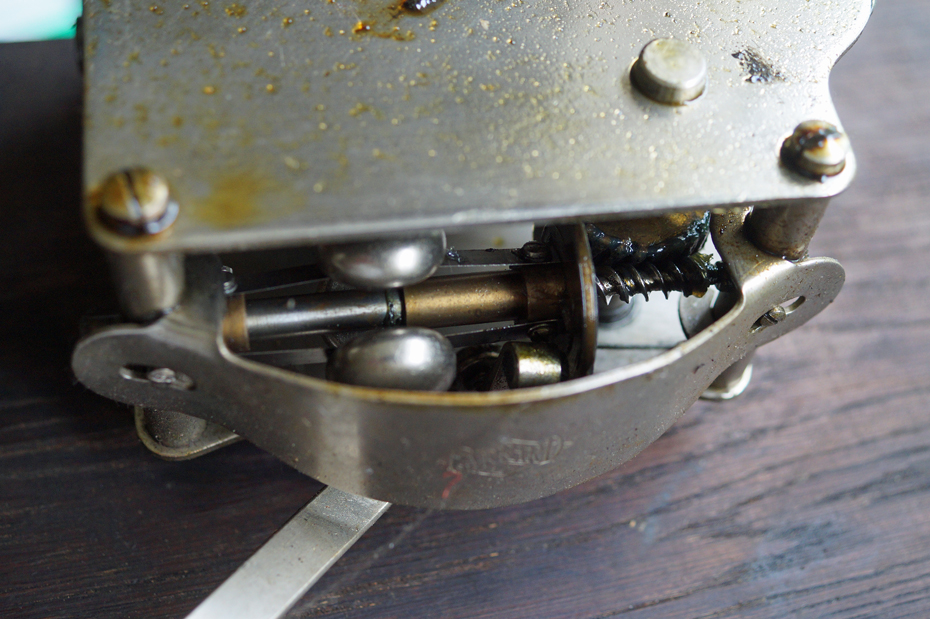

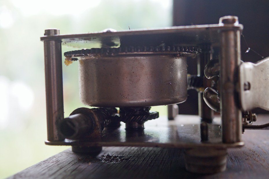

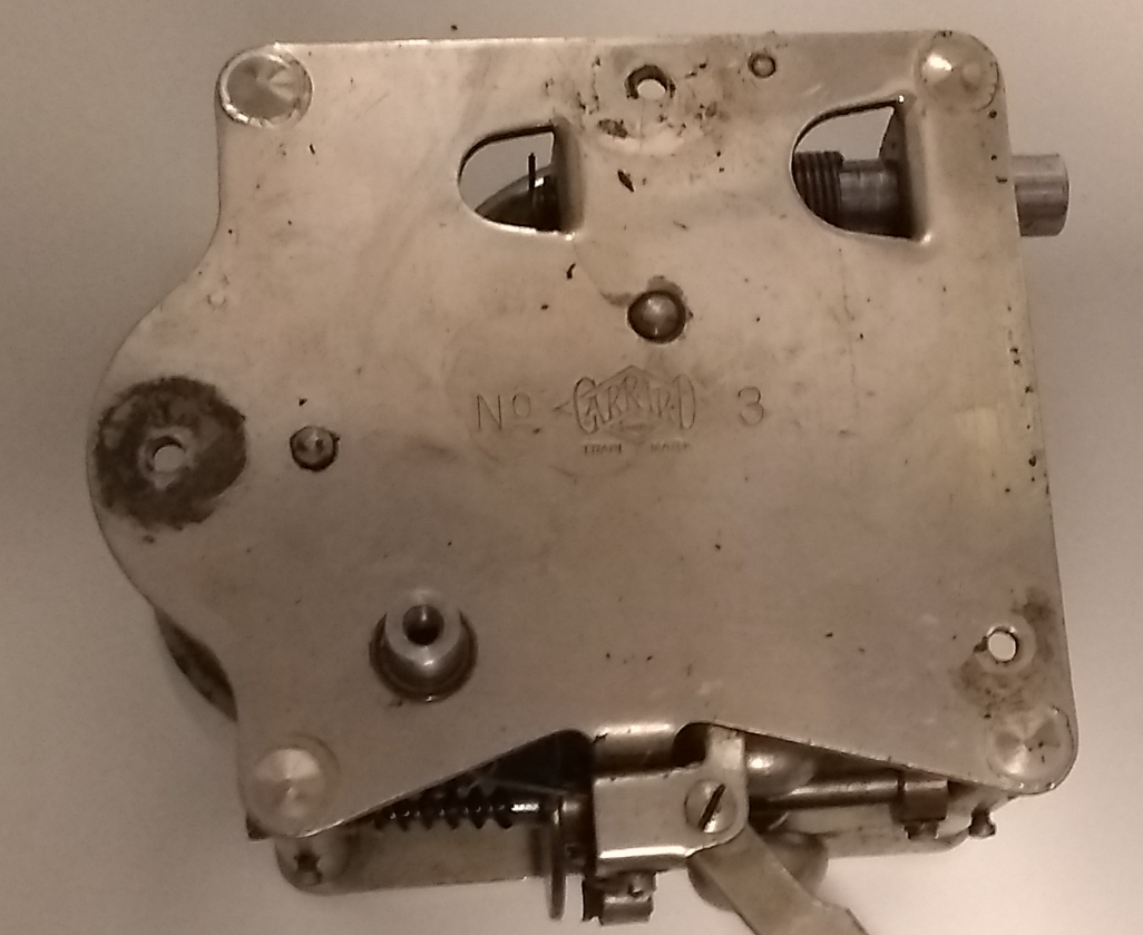

I haven't seen a garrard motor like this one before.
Does anyone know the model number or any other information about it I wonder ?
Please id this Garrard motor

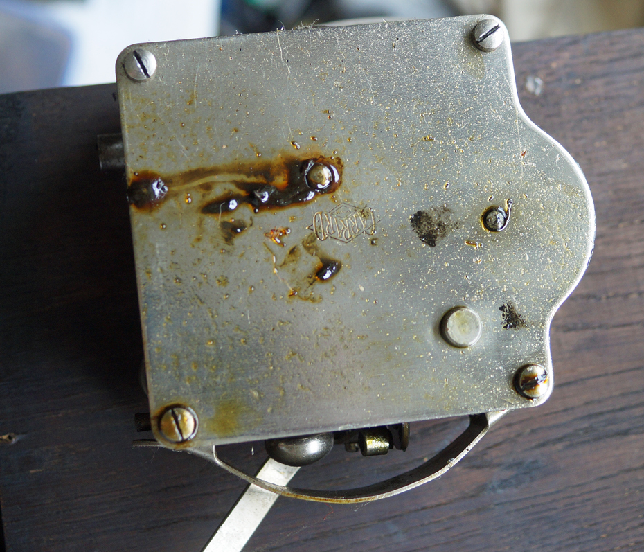

It's a Garrard 3a with a curved plate to protect the large open gear in the Garrard 3.
I haven't seen the other side plate before. Can I pinch the pics for my site?

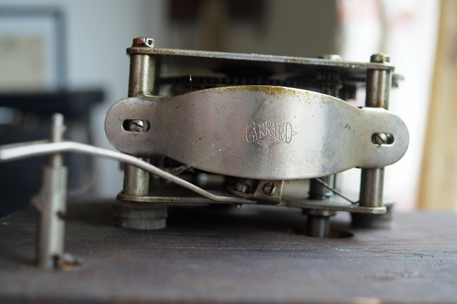

The curved plate is not protecting the large gear, it's protecting the governor. Why? Well I suggest that, as Garrard motors were available for all and sundry to fit to their gramophones, Garrard thought it advisable to put this protective guard around the governor, in case some inexperienced gramophone assembler forgot to allow for the expansion of a governor when running at full speed, and left too little space for it, particularly in a portable with a close-fitting internal horn. The 4A, a double-spring version of the same motor has the same guard.

I came across another garrard motor with this metal 'guard.
So, of the two motors I have, one is in a 'miniature' floor standing 'Perophone' and the other in an early 'reflector' type 'Selecta-phone' portable.
I thought that it was worth mentioning that there seems to be a common reason for this guard.
This is, that when operating normally, both of these 'run the risk' of the user touching the motor with their fingers.
So, I guess that this is the main reason for the guards.

My Garrard 3 has the top and bottom plates that curve out over the large drum gear to protect it, but there is no longer (or never was) an externally mounted plate to protect the governor mechanism.
I am certain from the condition of the lubricants in the machine (not great but not dried up either--no spring clunking) and the screw driver wear on screw heads that the motor was serviced in the distant past. If there ever was the external plate, it was not put back.
