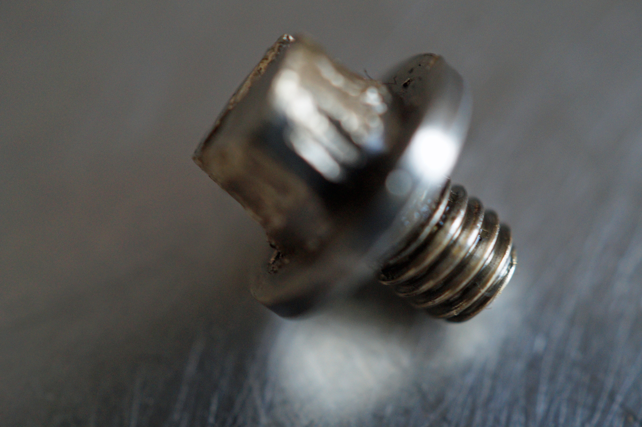

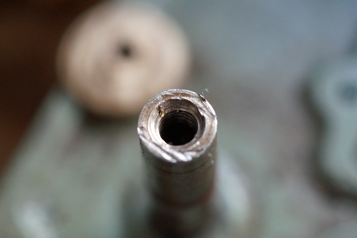

Sadly my newly acquired Collaro A27 motor has a broken 'non-return' spring.
It has snapped near the top.
Can anyone advise please if the can be repaired or where a new one might be available from ?
Oh, I also notice that this motor spindle attaches to the turntable using a seperate screw fit attachement. (Did I use the correct words there ?). I assume that this was standard for the Collaro A 27 ? Photographs 'below'. (It was very difficult to unscrew to release the turntable so I damaged them a bit - hard banging with a hammer and the end of a scew-driver, using pliers etc). :roll:
Thanks as always for any help anyone can give.
