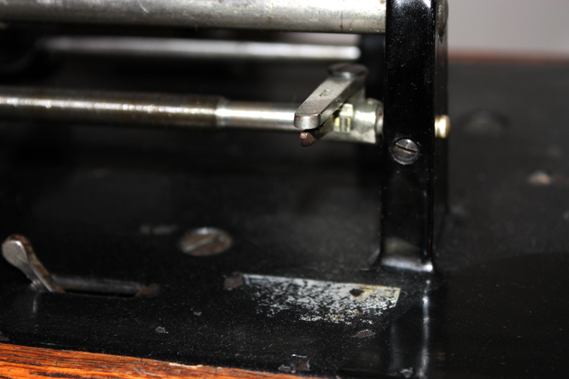

I've a Columbia BC with the 2/4 minute gearing. It uses a pretty ingenious method that either couples the drive directly to the feedscrew (2 min) or couples the drive through a collar with a planetary gear that is locked to the machine frame for 4 minute. A little lever makes the direct coupling or locks the collar to the frame through a slotted stud. The little lever engages the feedscrew end via a slot in the exposed end of the feedscrew. (2 Min)
And theoretical combination 2/4 minute stylus. I understand what they did with the stylus, but never thought it would work very well. Does it? I've never heard one in person.

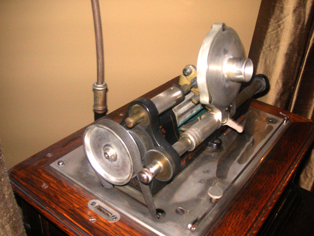

The 4 min attachment for the BO is the same as used on BK, BQ type machines except that the feed screw is longer to match the 6" mandrel on the BO.
My BO is 2 min / 3min (using the 6" long cylinders) The 4 min gearing and 4 min reproducer could be added later.

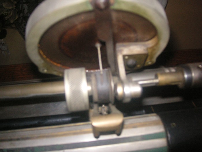

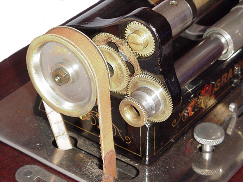

Here are pictures of unusual combination attachments on a BM and BC.
BM Model, the reproducer has a universal type stylus that will play 2 or 4 minute celluloid type cylinders.
BC Model, reproducer has an unusual turnover stylus similar to a Model O
Odd stylus assembly (Sorry about quality)
