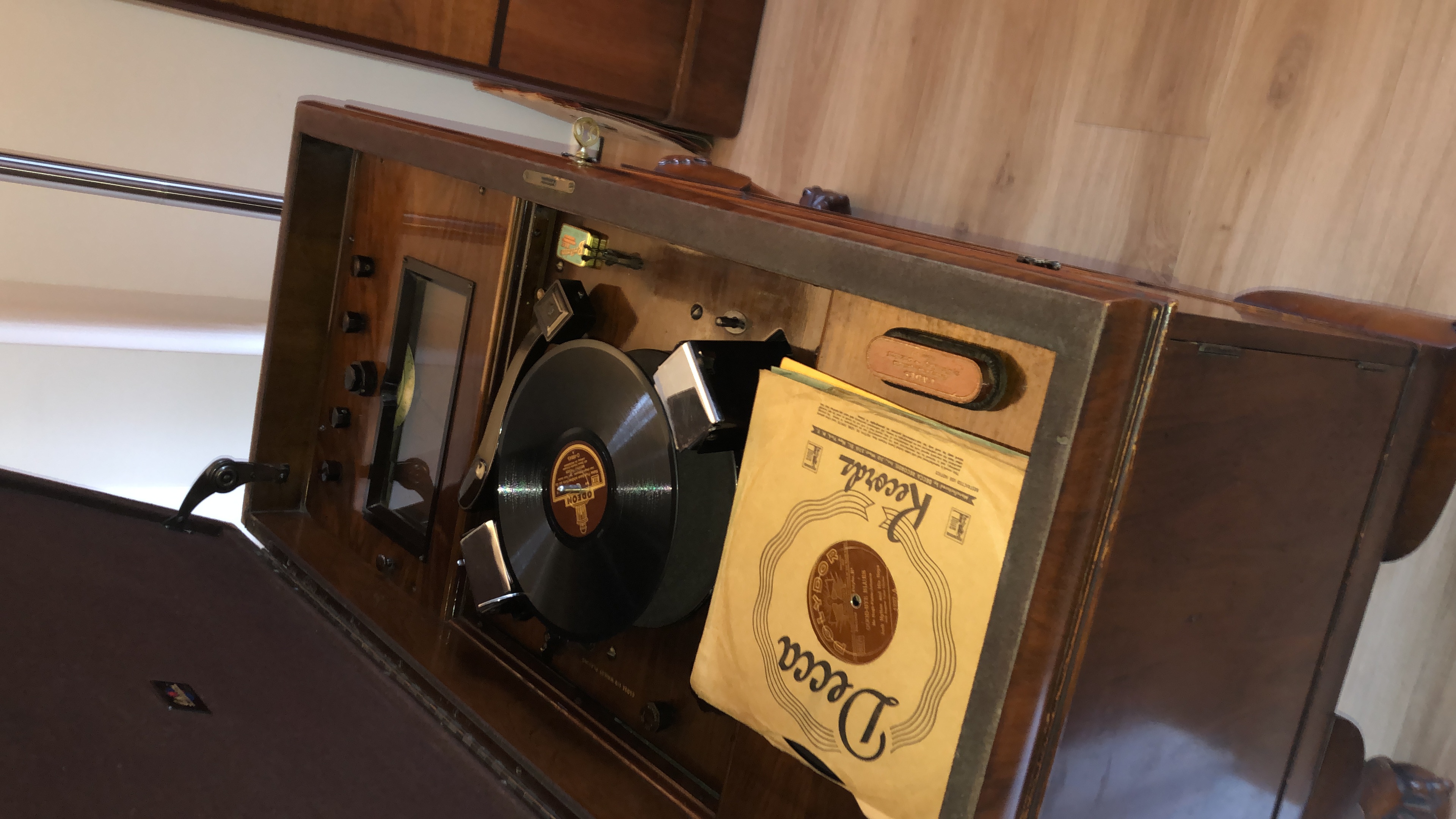

Dear all,
my latest acquisition is a Marconiphone 563, from 1937. The individual components work perfectly and the sound is stunning, due to the bass and brilliance controls.
However, the beautiful machine has two blemishes…

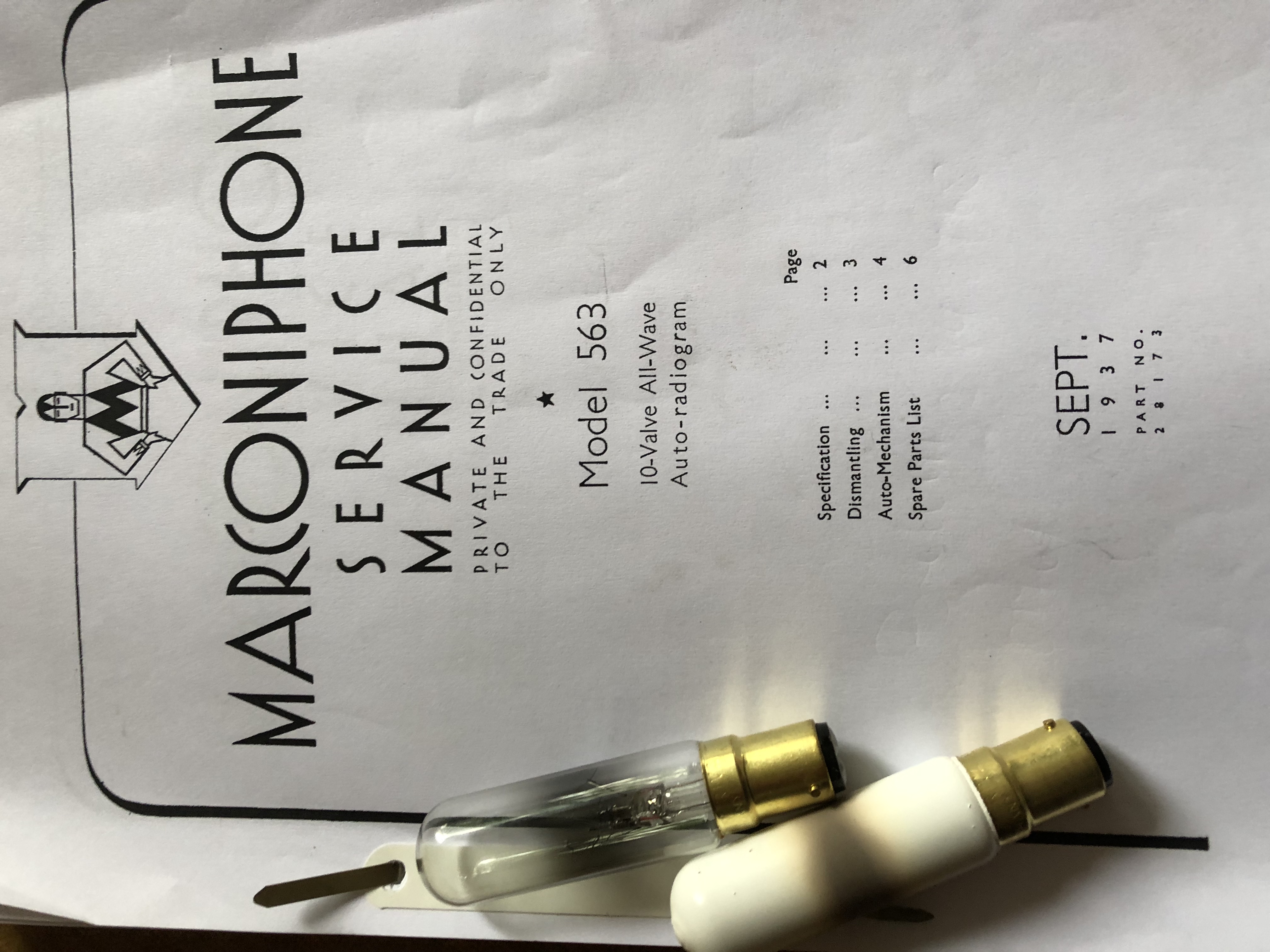

I cannot find a new/old pilot lamp for the scale of the radio. It has to be a lamp (a long tube, frosted glas) with a bayonet socket (220V/15W)…

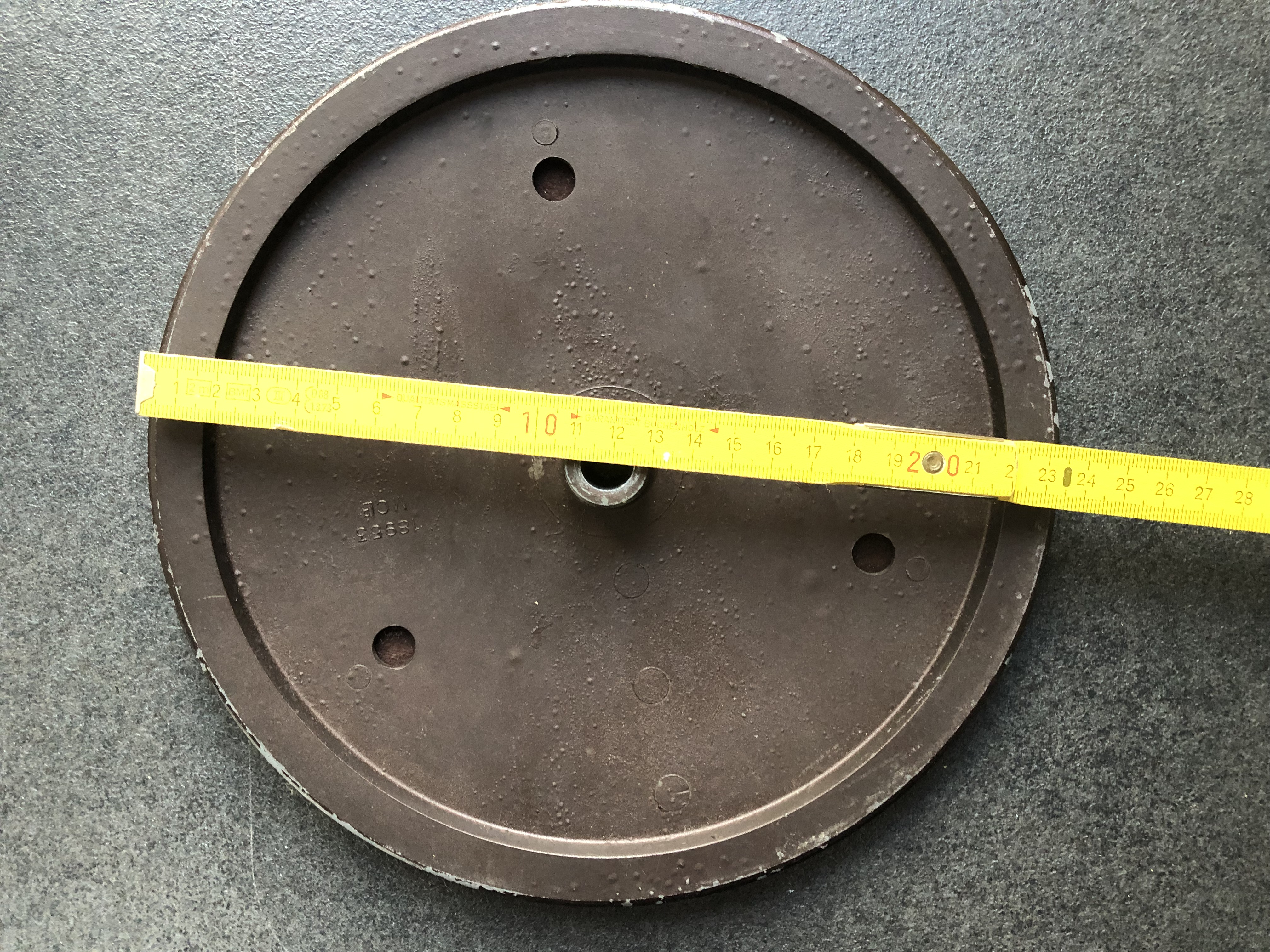

The other problem is to find a replacement for the original turntable. The weight is 1,4 kg and the material is cast… maybe, you know the problem with cast? The turntable, of my radiogram is unfortunately deformed ne has to be replaced.
I hope, that someone can give me a tip, how to fix these blemishes, or has a matching pilot lamp or one of those heavy turntables lying around?
Thanks and best regards
Martin
Otherwise, I am still looking for an HMV 660 radiogram ;)

Why not rewire and upgrade the socket to accept a modern bulb?
Is the turntable pic yours? If so, what is deformed?

thanks for your message. I want to keep the radiogram as original as possible, so I'm trying to find one of the original lamps. The turntable I s the one that comes with the unit, but unfortunately, it is warped down at the edges.

Can you find the same shape voltage and wattage bulb but with a screw base- carefully remove the screw base as you won't need it again but you don't want to break your new bulb -desolder the leads from your good bulb base- carefully break your old bulb free from your good base- then use a good glue to attach your good bulb to your base and at the same time, resolder the leads to your base contacts? Sounds complicated I know, but i've done it before.
A picture of your old bulb, measurements, and the bottom of the base would be welcomed

Some things are not currently made to fit obsolete electronics, but maybe I'm wrong. Check an antique radio collectors site and inquire or follow the path of connecting the old bulb socket with a modern bulb as suggested. If that doesn't work, rewiring the socket may be your only choice and I doubt that it would take away from your machine.
What does the bulb illuminate anyway?
An idea for your turntable (since finding an original is probably unlikely) is to place it on a belt sander and sand the warp flat. If necessary, a piece of sheet metal could be cut and epoxied to the top before putting new felt in place... no one would ever see the repair.

Dear pallophotophone,
thanks for the tip about the lamp rework, but unfortunately that's too complicated for me. I've tried everything, with adapters for the socket and different bulbs. The original pilot lamp, which unfortunately was no longer in the radiogram, must have been around 15 cm long and illuminating the complete radio dial. Now I've put in a short lightbulb. Maybe, someday I will get the original one, or I use a second socket?

sanding down the turntable is a good idea, I'll try that.
I also wanted to have made a new one, but in Germany we will soon have no longer any craftsmen and those who still work have no talent for special new work. bad times...

HMV_Electrola wrote: Wed Aug 02, 2023 1:20 pm Dear pallophotophone,
Tanks a lot!
Martin
If you like to send me one of your old bulbs- your choice- I could give it a try. I'd genuinely welcome a little challenge !! But if it looked as though I couldn't do it successfully , I'd send it back to you intact

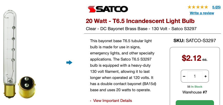

This is a link to a 20 watt bayonet base bulb, which is approx. 13.7 cm long. The only problem is that it is 130 volts. You would need a voltage converter IF your socket is using a full 220 volts.
https://www.1000bulbs.com/product/54252 ... S3297.html
