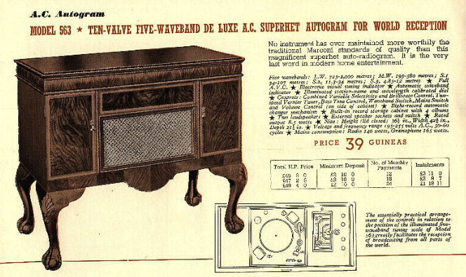

my latest acquisition is a Marconiphone 563, from 1937. The individual components work perfectly and the sound is stunning, due to the bass and brilliance controls.
However, the beautiful machine has two blemishes…
I cannot find a new/old pilot lamp for the scale of the radio. It has to be a lamp (a long tube, frosted glas) with a bayonet socket (220V/15W)…
The other problem is to find a replacement for the original turntable. The weight is 1,4 kg and the material is cast… maybe, you know the problem with cast? The turntable, of my radiogram is unfortunately deformed ne has to be replaced.
I hope, that someone can give me a tip, how to fix these blemishes, or has a matching pilot lamp or one of those heavy turntables lying around?
Thanks and best regards
Martin

Why not rewire and upgrade the socket to accept a modern bulb?
Is the turntable pic yours? If so, what is deformed?

thanks for your message. I want to keep the radiogram as original as possible, so I'm trying to find one of the original lamps. The turntable I s the one that comes with the unit, but unfortunately, it is warped down at the edges.

An idea for your turntable (since finding an original is probably unlikely) is to place it on a belt sander and sand the warp flat. If necessary, a piece of sheet metal could be cut and epoxied to the top before putting new felt in place... no one would ever see the repair.

by Curt A
https://www.radiomuseum.org
- Screenshot 2023-08-01 at 9.17.35 PM.png (608.99 KiB) Viewed 8190 times

sanding down the turntable is a good idea, I'll try that.
