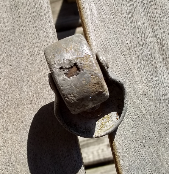

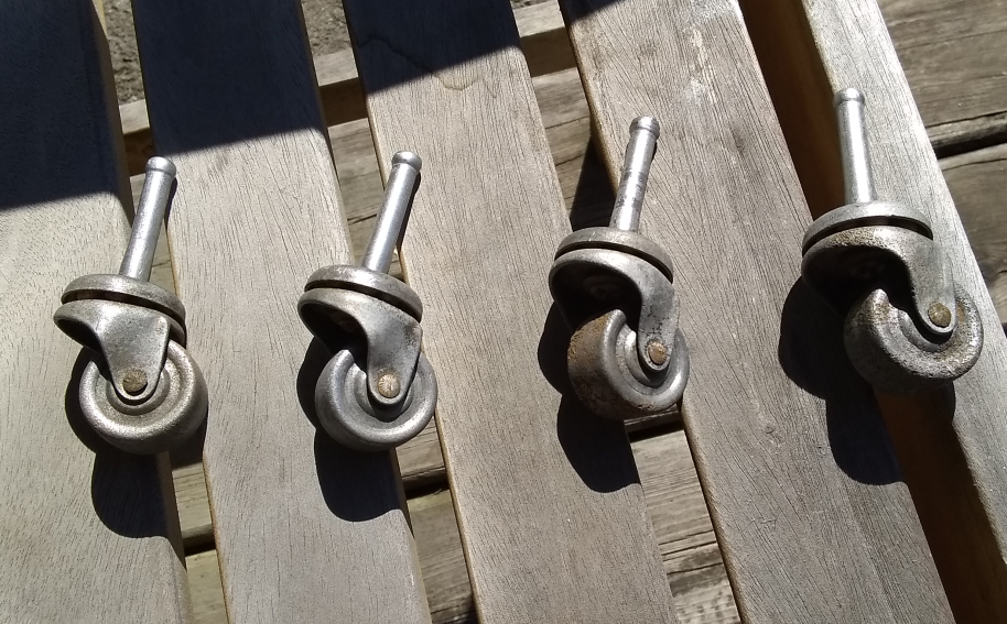

These are what mine look like now after their rust remover bath, a water rinse, and a bit of steel wool touch up. They are basking in the sun to keep them drying
You can see how pitted some of them are.
One of them was obviously dragged around with a seized up wheel over something like concrete. There is a flat spot in the wheel, and you can see that the wheel has a wooden core. The flat spot was not so apparent initially with all the crud that was on it.

Nice job, they cleaned-up nicely.
A light spray of dark bronze colored paint will hide the pitting.
To protect your floors, I'd fill in the pictured large hole on the wheel bottom, the glue a thin grey colored felt around the wheels.

With a small spade style cutting head on the Dremel tool to scuff that area up and the wood core for support, some JB Weld should work very well there.
Some careful filling to make it round.

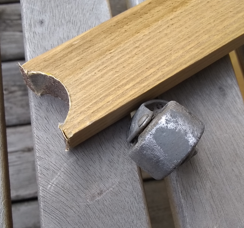

The damaged caster (or castor
) now with the JB Weld patch, posing next to the worn-out, purpose-built sanding tool.
I am wondering about the wisdom of mixing up another bit of JB Weld, spreading it thinly on a piece of plastic, rolling the caster through it to coat the surface of the wheel, and then re-sanding the dried finish smooth. The wheel is quite pitted. There would a lot of footholds for the epoxy to hold onto.

If the pits are clean it will stick.
Clean the castor in lacquer thinner with a small stainless brush to get into the pits as best as possible.
The cured JB Weld will not be effected by the thinner.
If you roll it on a smooth surface as it is now, is it very out of round ?

Thanks for the reply.JeffR1 wrote: Sun Aug 06, 2023 11:35 pm If the pits are clean it will stick.
I will try this. I think I have some lacquer thinner in my garage at the back of a cabinet.
It is quite in round--the sanding tool ensured this outcome. However, there is still one small impact dent on the opposite side of the wheel that I should probably fill in. The dent does not affect the rolling much but it is noticeable and would probably be more noticeable under the weight of the AV machine, not that I plan to be rolling the machine around on these castors over the hardwood floor on which it sits anyway. The vintage castor project here is mostly for show/display, not function. If I wanted function, I would put modern sensible castors on the machine--I have a drawer containing a number of perfectly fine salvaged sets. The machine with its vintage castors finally installed will probably sit with floor-protective furniture cups under its wheels.JeffR1 wrote: Sun Aug 06, 2023 11:35 pm If you roll it on a smooth surface as it is now, is it very out of round ?
After mulling things over, I think I will try "painting" the JB Weld onto the wheel with a soldering flux brush, rather than rolling the wheel through it. The bristles of the brush are stiff enough that I should be able to work the epoxy down into the pits while at the same time getting a fairly even coat over the wheel. If this works well, I will try the same on the other wheels, as well.
I like Roaring20s' idea of the felt strips and the dark bronze paint. After the rolling surfaces of the wheels are done, I will probably mask these surfaces off along with the shafts, paint the castors with something like Krylon hammered dark bronze (which should "sort of" match the tarnished look of the ferrules on the ends of the AV machine's legs), and then apply a final coat of JB Weld to the rolling surfaces and fuse the felt into the JB Weld while it is still tacky.Roaring20s wrote: Sun Jul 23, 2023 6:05 pm A light spray of dark bronze colored paint will hide the pitting.
