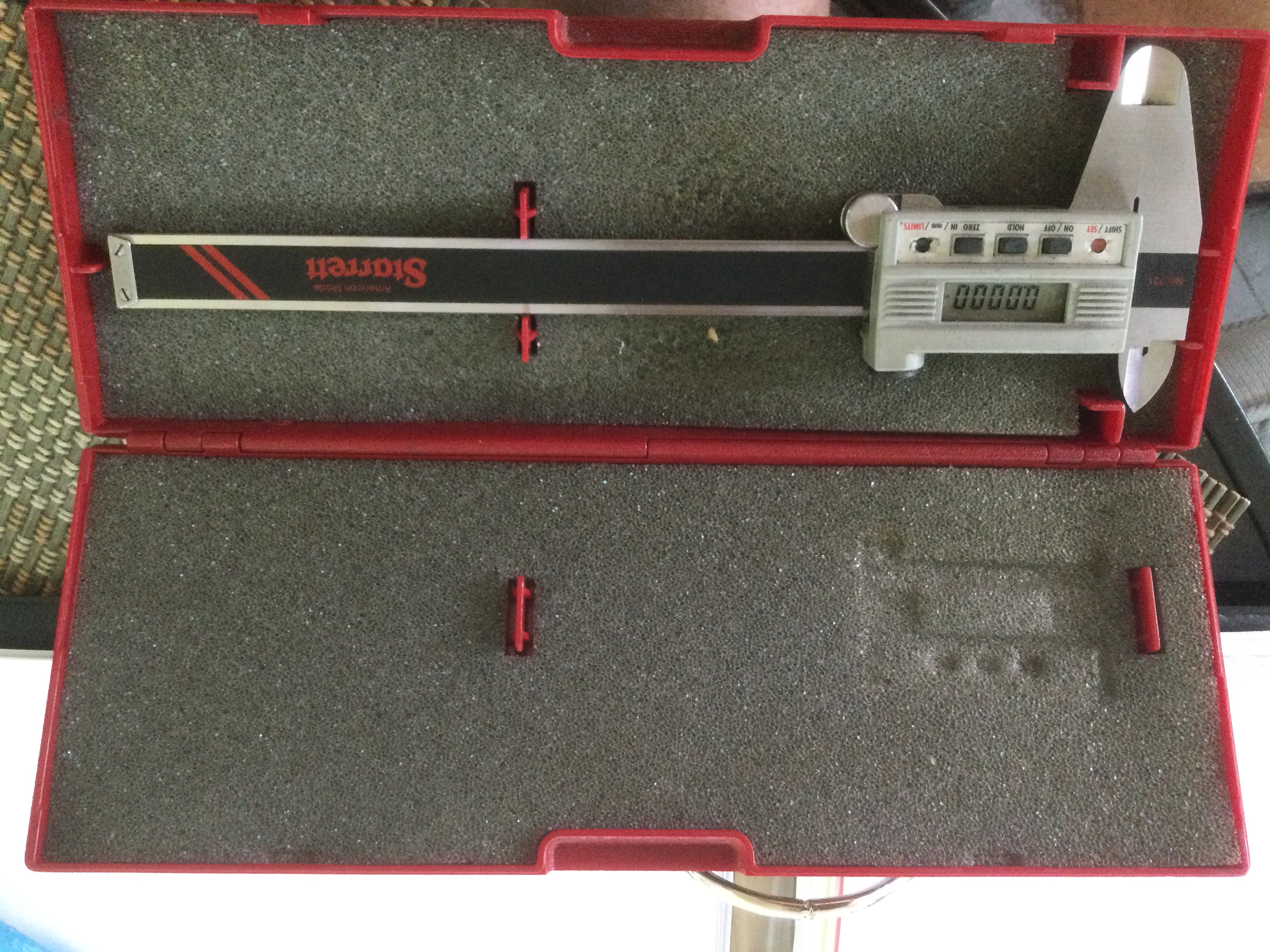

Everyone working on machinery should own a simple vernier or digital caliper. Here is good reason for you to buy one.
Measure your wood screws if you have a sample and post the dimensions here and reference the sizes so that we can all benefit.
Mark

I got lucky today and found some extra screws on a dead case. They are pretty good as far as condition and yes I actually do own a digital caliper, but without screws to measure, I didn't have anything to go by.
Now that I've found a few of those screws I can get to that but I have to find where I boxed up the caliper first. Probably somewhere I would remember where it is, which is going to take awhile to locate.
